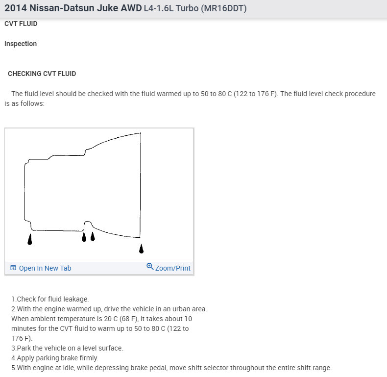

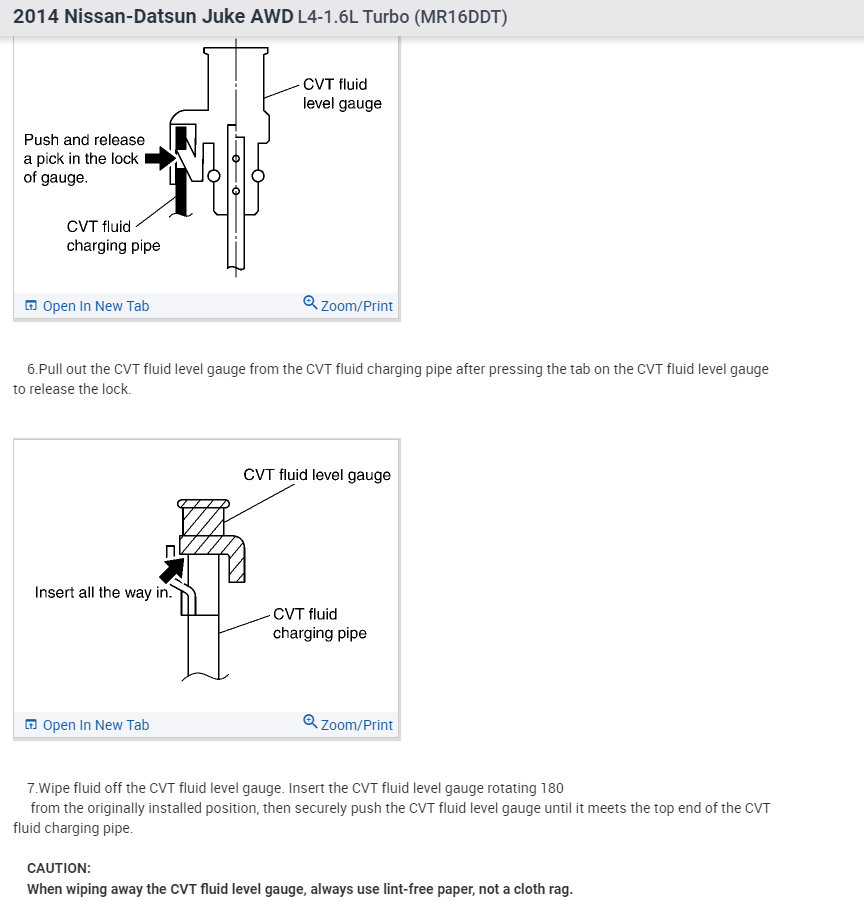

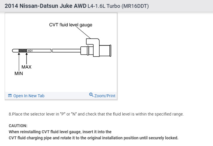

Also keep in mind if you were to add the stop leak, you do not want to overfill the transmission. Only added to the full mark.

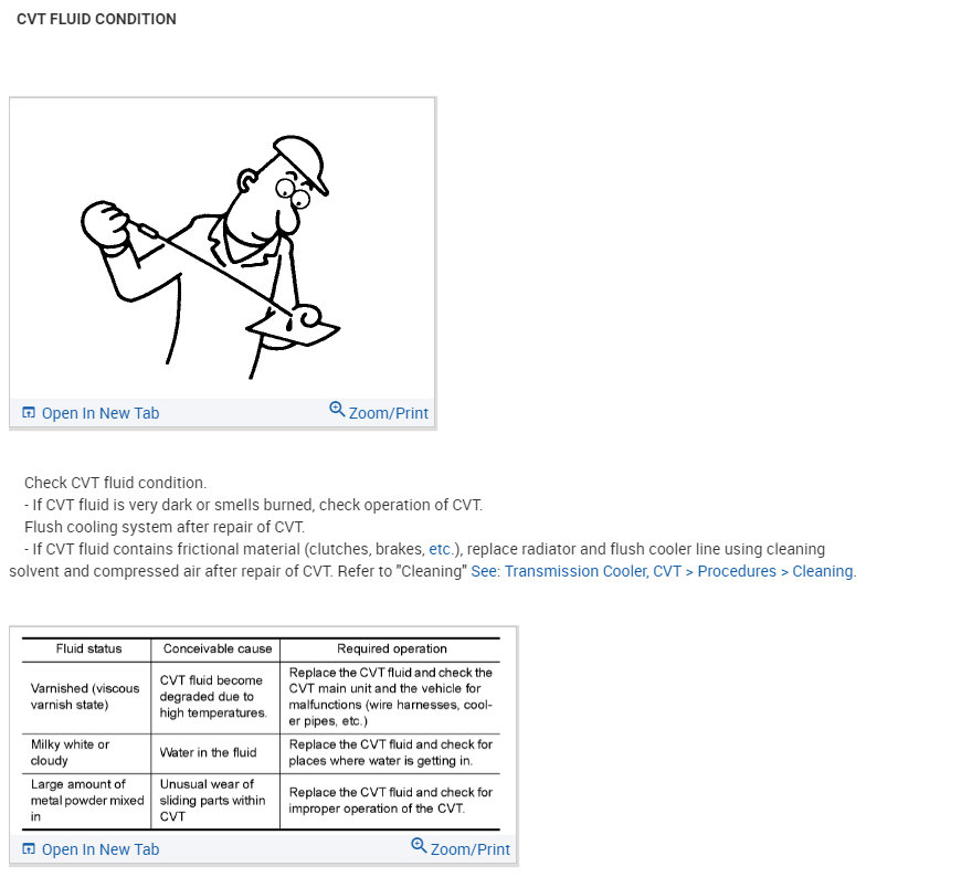

Another thing to keep in mind that your vehicle is equipped with a CVT transmission, if you were to add any type of fluid you want to make sure it is compatible with CVT transmissions.
