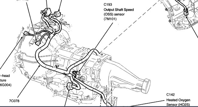

I replaced my transmission on my car listed above. since replacing the transmission the speed sensor when connected is reading 120 when i'm actually going 20.

Good afternoon,
What year and model did your donor transmission come from?
I attached a picture of the speed sensor for you. If the transmission is different from the original, it will not read correctly. The sensor goes over a tone wheel inside the transmission to produce the signal for speed. If that tone ring is different, this is the result.

I appreciate the help, would you be able to post the picture again but a full diagram so i can see the enitre wiring diagram?
Nov 2, 2020 at 6:33 AM
You would need to find a speedometer guy that can fit an adapter for you to get the correct speed. The only other way is to either get the correct transmission or replace the shell inside the transmission.
That is the largest I can make it without distorting it.

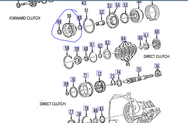

What part of the original transmission is the shell located?
Nov 2, 2020 at 6:43 AM
It is internal. The transmission has to be disassembled to access the shell that holds the clutches and planetaries.
I attached a picture for you to view.
You need to do a Google search in your area for someone who does speedometer repairs.

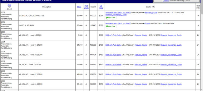

Yes, did you get a 4R70 or 4R100?
Nov 2, 2020 at 7:17 AM
I attached some possibilities for you to view. The site www.car-part.com is very good.
