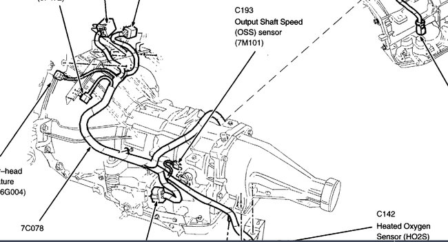

Good afternoon,
What year and model did your donor transmission come from?
I attached a picture of the speed sensor for you. If the transmission is different from the original, it will not read correctly. The sensor goes over a tone wheel inside the transmission to produce the signal for speed. If that tone ring is different, this is the result.

I appreciate the help, would you be able to post the picture again but a full diagram so I can see the enitre wiring diagram?
Monday, November 2nd, 2020 AT 2:33 PM
  • 52,797 POSTS
You would need to find a speedometer guy that can fit an adapter for you to get the correct speed. The only other way is to either get the correct transmission or replace the shell inside the transmission.
  • 52,797 POSTS
That is the largest I can make it without distorting it.

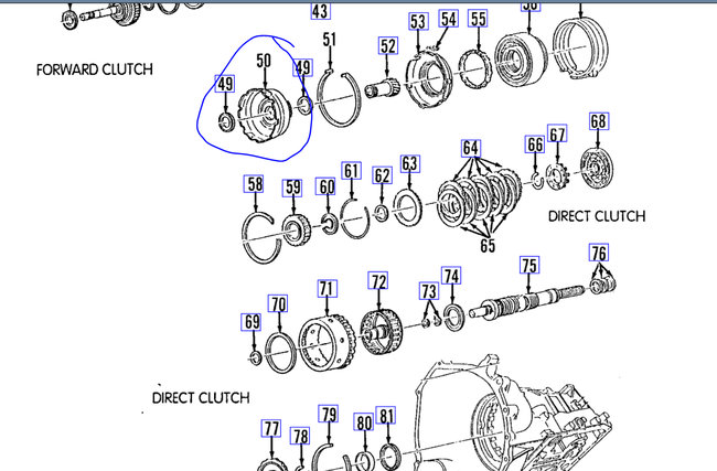

It is internal. The transmission has to be disassembled to access the shell that holds the clutches and planetaries.
I attached a picture for you to view.
You need to do a Google search in your area for someone who does speedometer repairs.

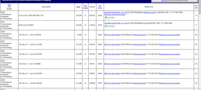

2003 Mustang transmission will be the correct one?
Monday, November 2nd, 2020 AT 3:08 PM
  • 52,797 POSTS
Yes, did you get a 4R70 or 4R100?
Monday, November 2nd, 2020 AT 3:17 PM
  • 52,797 POSTS
I attached some possibilities for you to view. The site www. Car-part. Com is very good.
