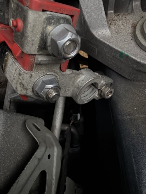

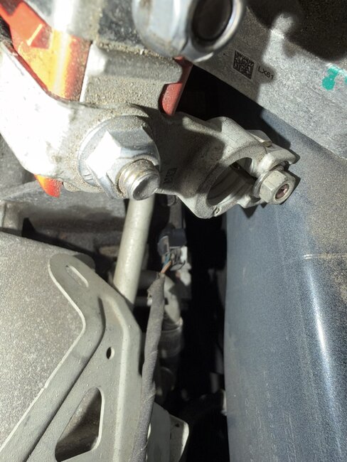

Apologies if this is a repeat, not sure if other one went through. SEL eco boost, looking to replace transmission speed sensor, very little info on internet, says on back of transmission, drivers side, I see one directly below air filter housing, is this the only one, did not see any other. part is hard to find.

Which engine do you have so we can better assist.

1.5L

There are three transmission shaft speed sensors, turbine, output, and intermediate. Here are the locations for all three. Two out of the three are inside the transmission.
