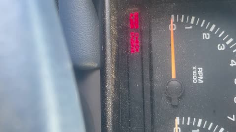

FARR2007
  • 244 POSTS
This is what flashes I’m getting on dash.
I’ve attached a video.

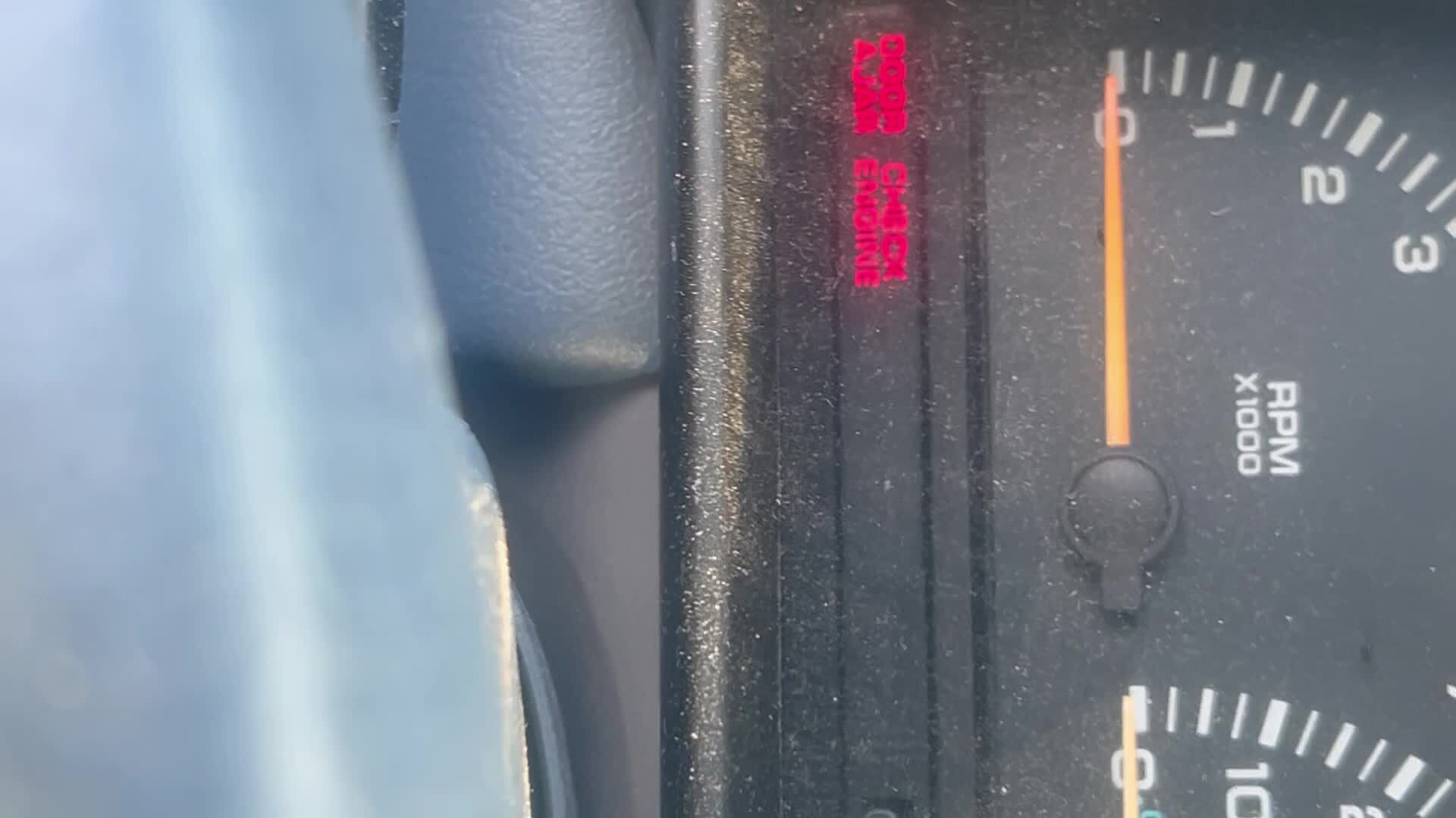

FARR2007
  • 244 POSTS
I uploaded the check engine light flashes in a video so you can have a better idea and tell me if there is a problem.

CARADIODOC
  • 34,321 POSTS
I forgot about code 12. What I saw was code 12, then code 55. Both of those can be ignored. I like to say, "bail out and duck for cover!", but it's really nothing to pursue. Code 12, depending on where you read the definition, means 12-volt power was lost to the Engine Computer. In other words, you turned the ignition switch off. Code 55 means it's done flashing fault codes. Here's how they're shown on our list:
12 - Memory to controller has been cleared within 50-100 engine starts.
55 - End of message.
Where code 12 becomes useful is when you have an intermittent stalling while driving problem. Most often this is due to a failing crankshaft position sensor, or to a lesser degree, a failing camshaft position sensor. Signals must be received from both of them for the Engine Computer to know to turn on the automatic shutdown, (ASD) relay which sends power to the ignition coil pack, injectors, alternator field, fuel pump, and other places. These two sensors are responsible for roughly 95 percent of intermittent stalling issues.
It's when we don't find a problem with those two circuits that we need to look at other possible causes. The idea here is we would start the engine, then erase the fault codes, including that code 12, then go out on a test drive. There's two ways to approach this, but both require a scanner or at least a simple code reader. Once the stall has occurred, it's important to not turn the ignition switch off as that will automatically set code 12 again. Instead, we want to read the codes that just set, if any, during the stall. If code 12 is set, that tells us to look at the 12-volt feed circuit to the computer. That includes the ignition switch, connector terminals, and wiring. If code 12 did not set during this event, that rules out one circuit from the list of suspects.
The better approach is to use a "record" feature found on most high-end scanners. You drive with the scanner connected and set to record mode. When the problem, the stalling in this case, occurs, you press the "record" button. That captures up to about five seconds of data that you can scroll through slowly, later, to see what changed or which signal dropped out. Because that data travels through the scanner's memory, the recording actually begins a couple of seconds before you pressed the "record" button.
After looking through the list of fault codes, I did see there is nothing on a '94 model to indicate you need to read codes in the Transmission Computer. You will have to find someone with a scanner to do that for you. You can ask at some auto parts stores, but your van might be too old for their equipment. Another option is to visit a community college with an Automotive program. They will have some scanners that work on '95 and older models.
Be aware that for now, it is important to not disconnect the battery or let it run dead as that will erase the fault codes, then that valuable information will be lost. If that does happen, you simply need to drive the van until the problem occurs again. At that point the code(s) will set again and can be read.
Let me know when you have those code numbers. As another hint, it can be very helpful to know exactly when a code sets, or in this case, bangs down into limp mode. For example, if you start the engine right after erasing the codes, and immediately you see on the scanner that one or more of them set again before you even shift out of "park", it has to be an electrical problem. We'd expect to find a grounded wire, corroded connector terminals, or a defective solenoid in the solenoid pack.
If no code sets until you shift into "drive", the problem involves something that turned on at that time. We'd look at pressure sensors and the fluid circuits they monitor.
