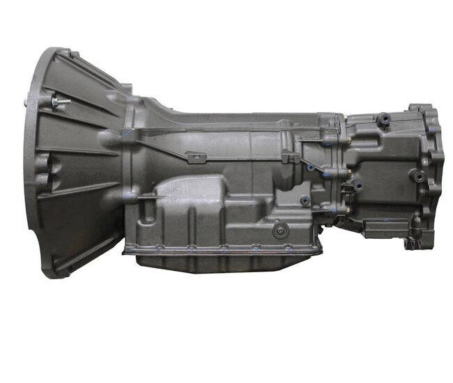

Need help locating. Ill attach image of the transmission, please circle/highlight where the INPUT TRANSMISSION SPEED SENSOR should be at.

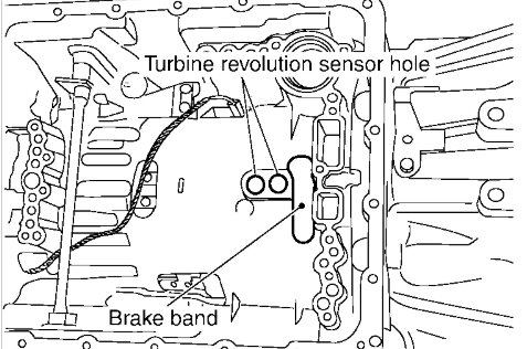

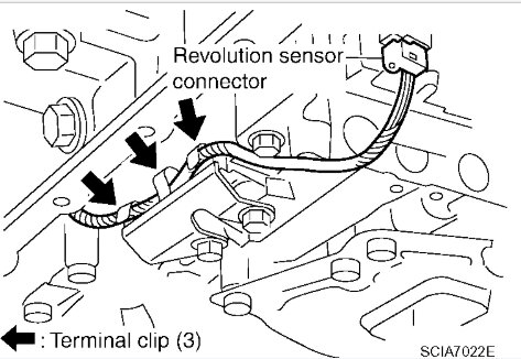

There are two of them inside the transmission, you will need to remove the pan to get to them. Turbine Revolution Sensor 1 and Turbine Revolution Sensor 2. Here are both sensor locations. Check out the images (below). Let us know if you need anything else.

I was told it could be replaced from the outside of the transmission, that's not true?
Aug 16, 2025 at 2:10 PM
  • 55,628 POSTS
Yes, that is not true, sorry.
