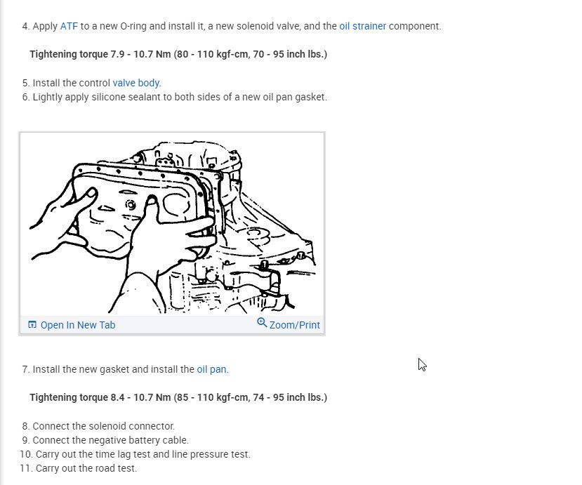

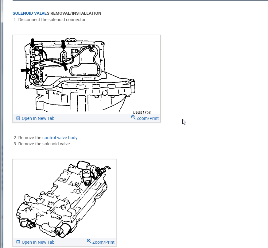

I'm having problems with my transmission on the vehicle listed above lx model.So I want to check the transmission solenoids with a multi-meter but I only see two.Question, how many transmission solenoids are on this vehicle?

I attached the removal process for these. Looks like there are three shift solenoids total. Take a look at this process and we can go from there. Check out the diagrams (Below). Please let us know if you need anything else to get the problem fixed. Thanks
