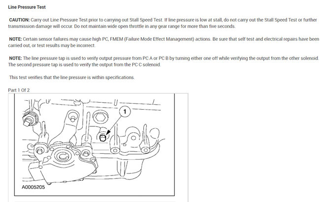

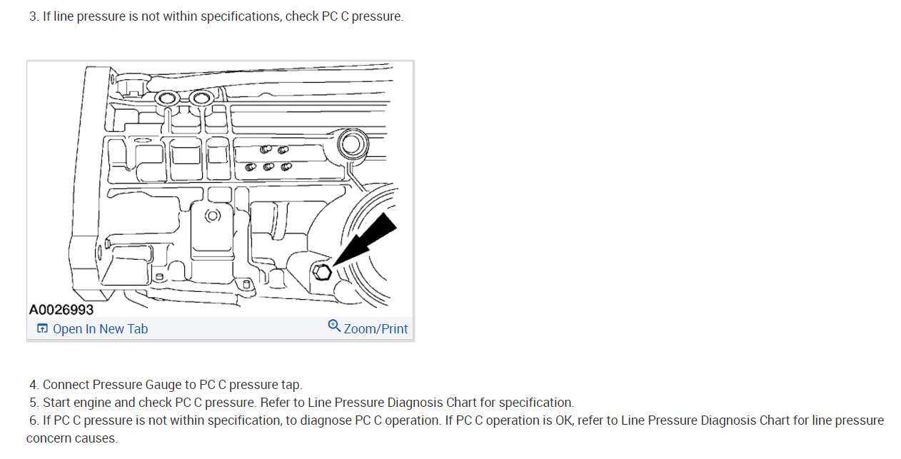

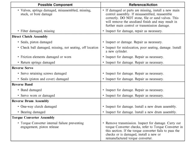

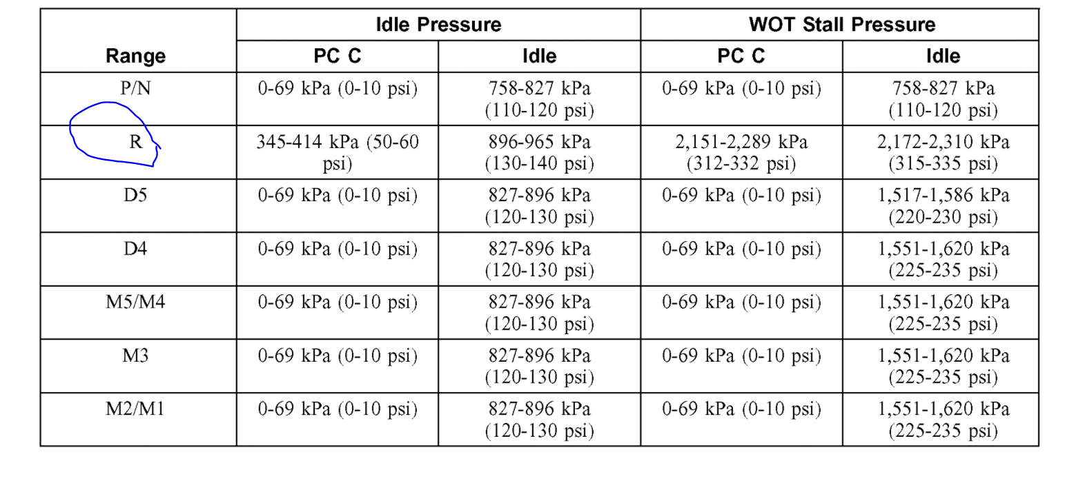

I changed the transmission fluid and now it won't shift into R. Transmission solenoid pack.
Tuesday, April 27th, 2021 AT 11:50 PM
MECHANIC
52,797 POSTS
Good morning,

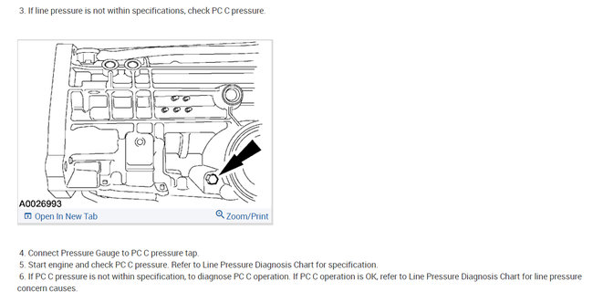

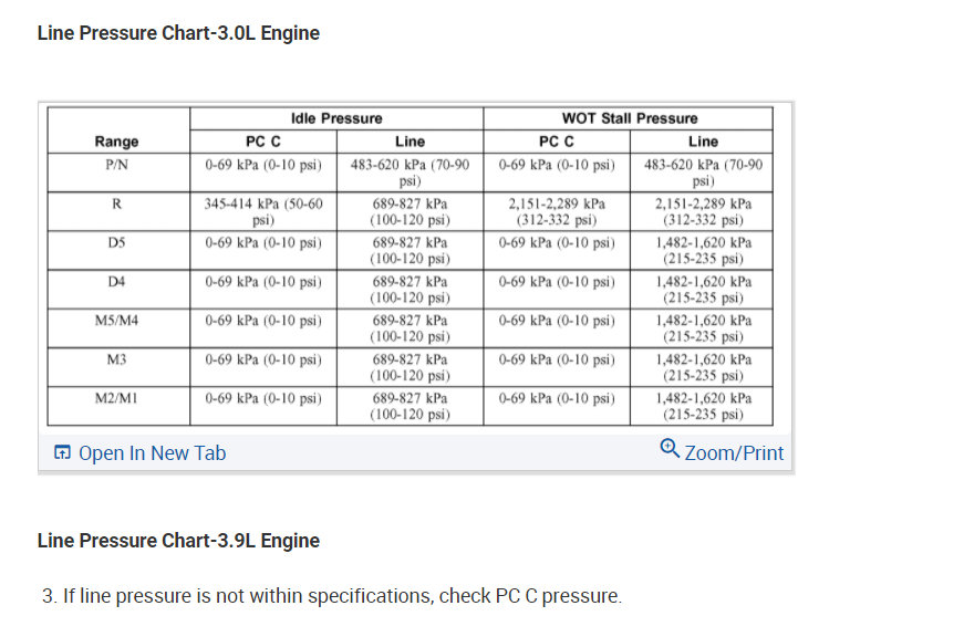

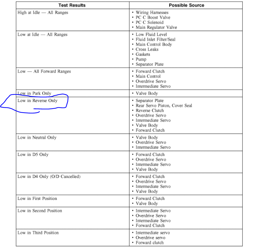

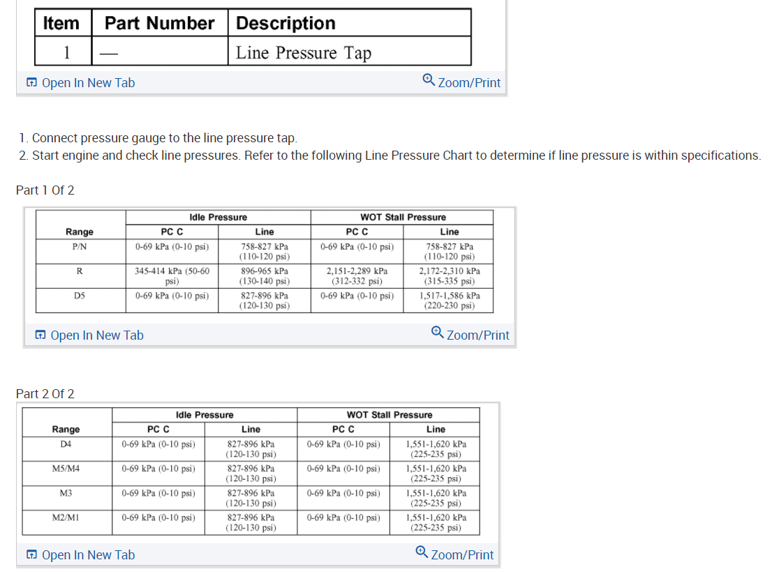

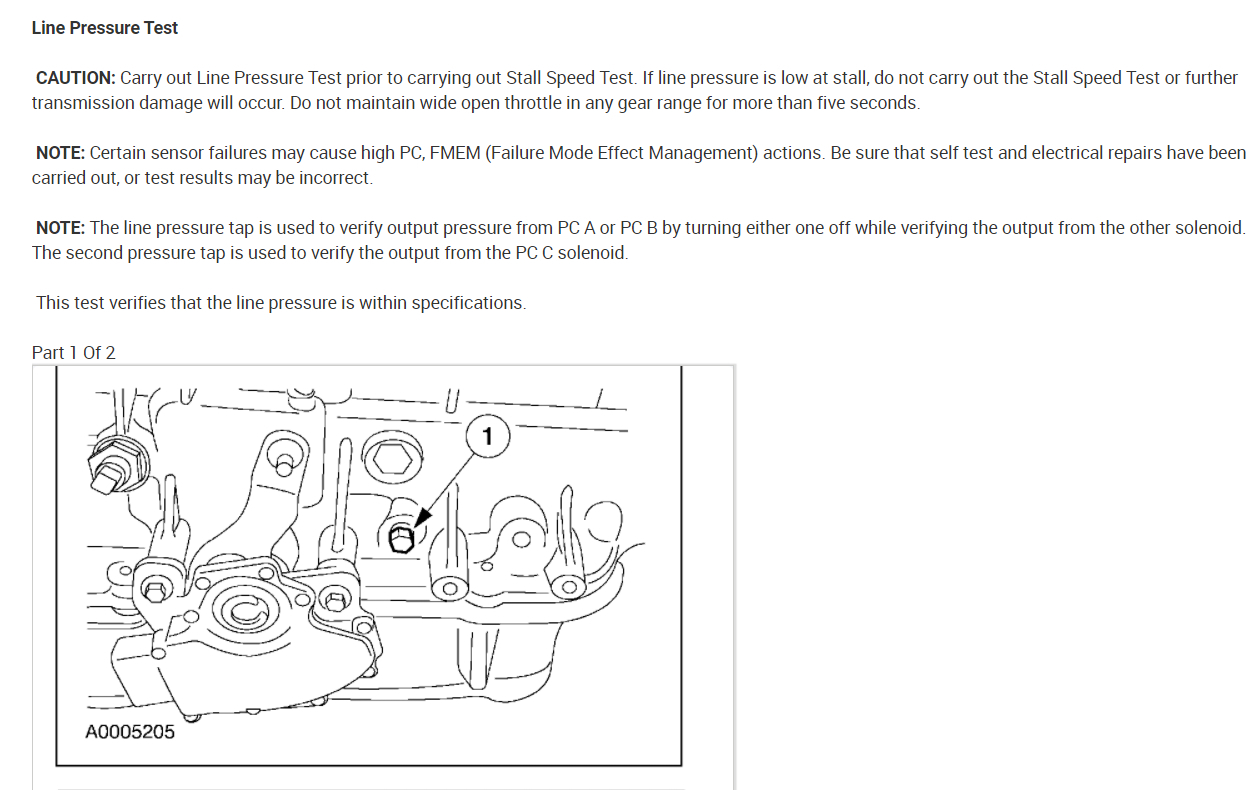

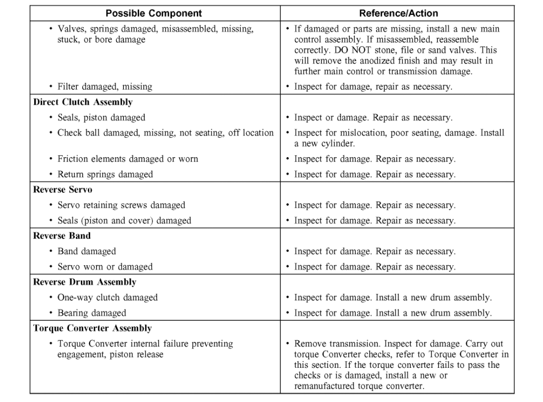

Engagement of reverse is mechanical, not electronic. I attached a chart of the possible issue for not going into reverse only.
I attached testing for the mainline pressure below to determine if it is an internal issue.
