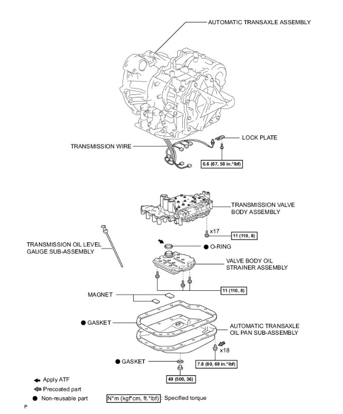

My question is related to my brother's car listed above. The other day his car stopped when backing out and wouldn't move after. Scanned it for codes and they were:
P0741 Torque Converter Clutch Circuit Performance or Stuck Off
P2714 Pressure Control Solenoid D Performance or Stuck off
P0776 Pressure Control Solenoid "B" Performance (SL2 Solenoid)
We took it to the dealer of course they suggested replacing the entire transmission but when he said he would just look into getting something else the mechanic told us to try replacing the fluid and filter and the solenoids related to those codes.

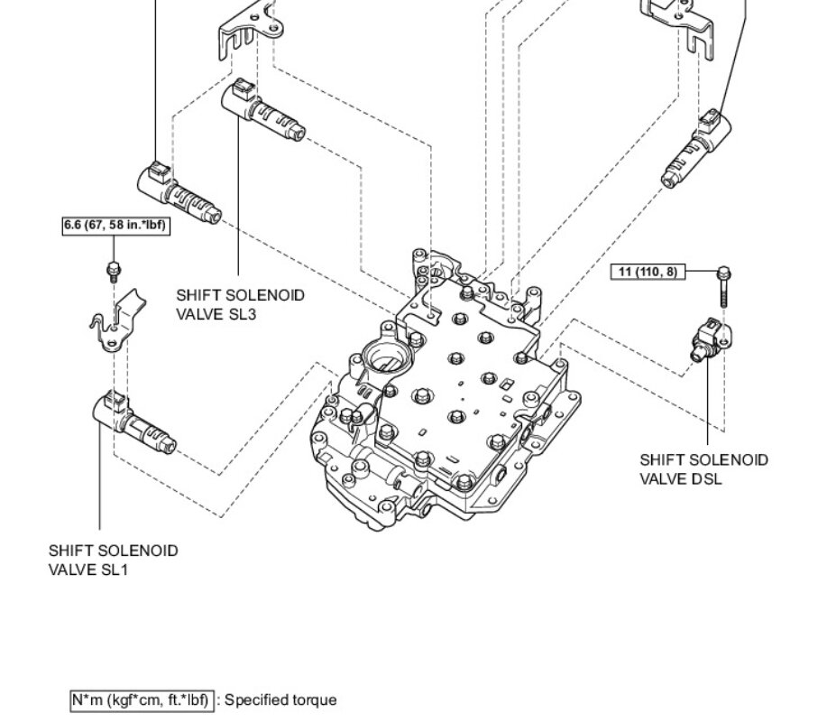

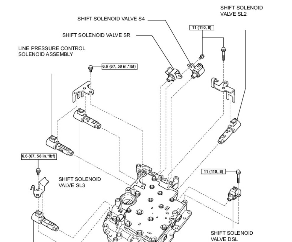

Where are the solenoids located on this vehicle?

Welcome back :) Sure, here is the location of the shift solenoids which should fix the problem. You will need to remove the fluid pan and filter to do the job. Check out the images (below). Please let us know what happens.
