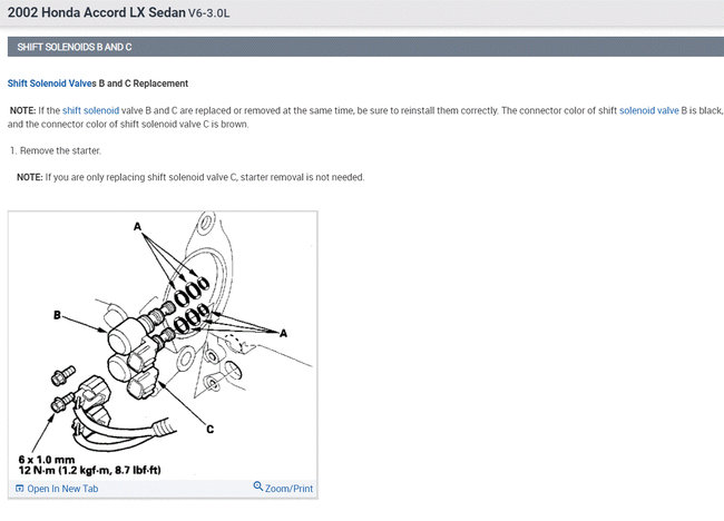

I'm trying to get transmission solenoid B out, but it is stuck and won't come out. Any suggestions would be appreciated.
Mar 29, 2022 at 11:19 AM
  • 110,244 POSTS

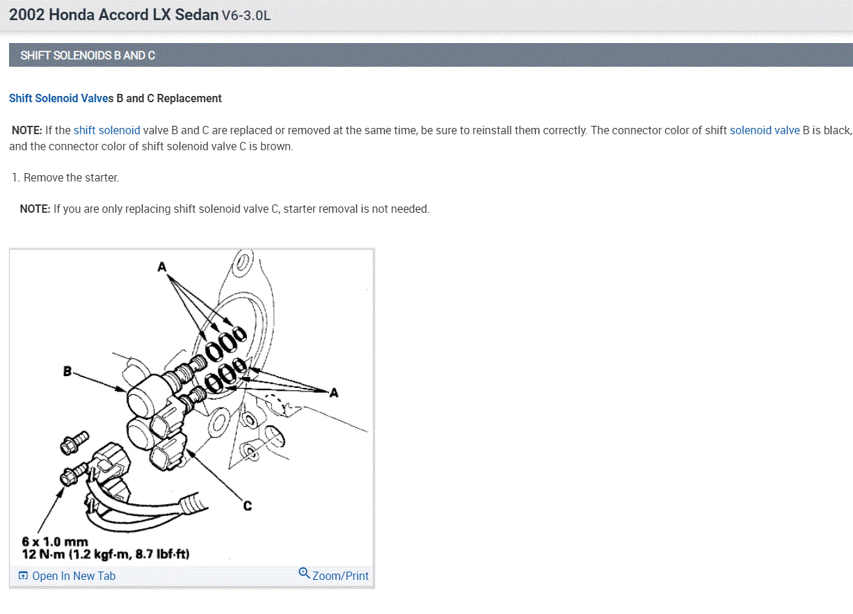

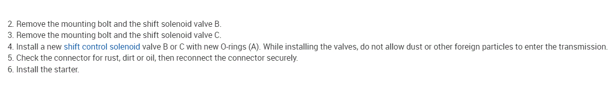

I attached the directions below. There are retainer bolts that need to be removed, so confirm they are out. If the solenoid still won't come out, gently wiggle it and twist it to see if you can loosen it. Chances are there is a build-up of corrosion causing it to stick.
Let me know if this helps.
