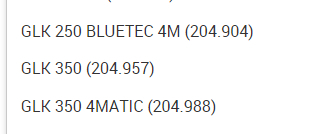

Okay. I attached a pic below. Which one do you have? There are three different possibilities. I believe there is a way to check the level without going to a dealer.
See pic below.
Nov 28, 2023 at 8:37 PM
CRACKERMAN
  • 5 POSTS
GLK 4 Matic.

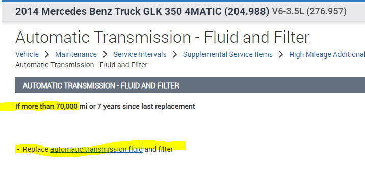

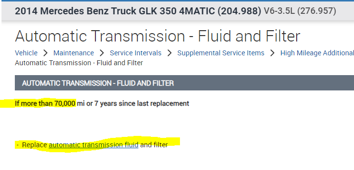

  • 110,194 POSTS
Interestingly, I found a notice that if the fluid hasn't been changed in 70,000 miles, the filter needs to be changed as well. See pic below.
Also, you are correct with this vehicle. It needs to be checked. I have no idea why this has changed other than someone is trying to make more money.
If you haven't serviced the transmission at this point, it needs to be done.
See pic below.
