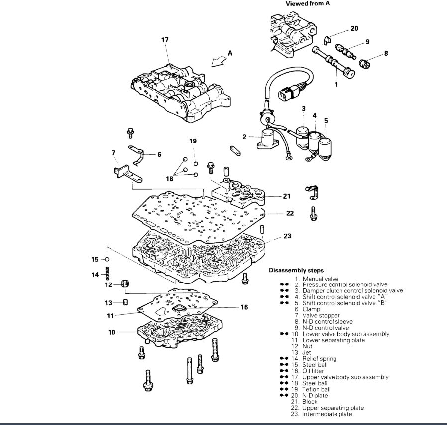

It sounds like you have a pressure control solenoid that is not working right, do you have a check engine light on? Here is a guide and diagrams below to show you the solenoid location:

  • 5 POSTS
I did have previously error code P1750. I replaced the solenoid pack already and there are currently no error codes on my car

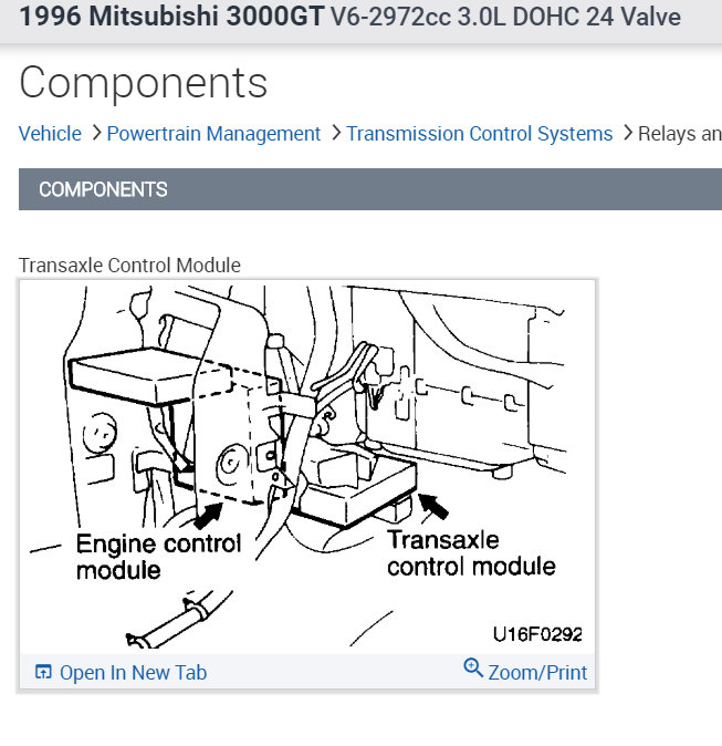

  • 55,224 POSTS
How is the condition of the fluid? smell burnt? brown or black in color? Can you please shoot a quick video with your phone so we can see what's going on, that would be great. You can upload it here with your response.

Could it possibly be the TCU?
May 21, 2019 at 11:20 AM
  • 55,224 POSTS
Yes it can be. lets try swapping it out for a used or rebuilt unit. Here is the location. Check out the diagrams (below). Please let us know what happens.
