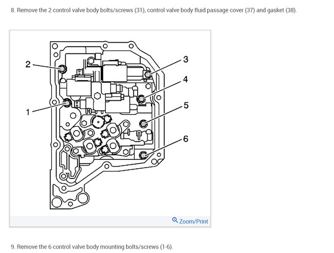

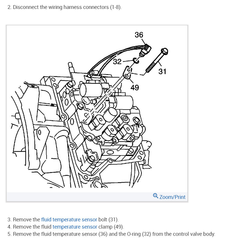

Transmission slipping in all forward. Obd2 codes p0970, p0974, p0977, P0302.
Someone did my repairs on the timing gear, belts, water pump and both cylinders replaced all valves, push rods, lifters etc. On both heads. He also mentioned the solenoid 2, 3 needed replaced. I did not have transmission problems until he did these incomplete work after eight months I ask how much longer it will be? He put the engine back together and returned this to my wife. I drove the car and was misfiring. I checked the codes and these came up. I changed the spark plugs and wires.
All said low fluids, check wiring.
I replaced the fluids three times and fluid is good.
I am trying to replace the re-manufactured valve body that I ordered.
Do you have a video or images on this transmission? It is my fault and loss but, now I am thinking to replace the whole valve body. Any suggestions will be much appreciated.

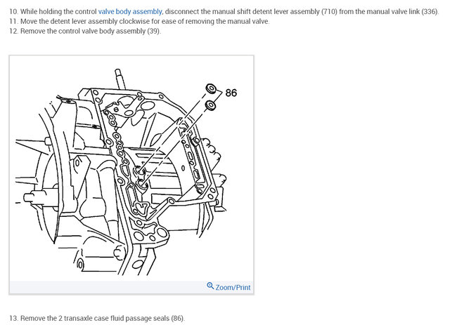

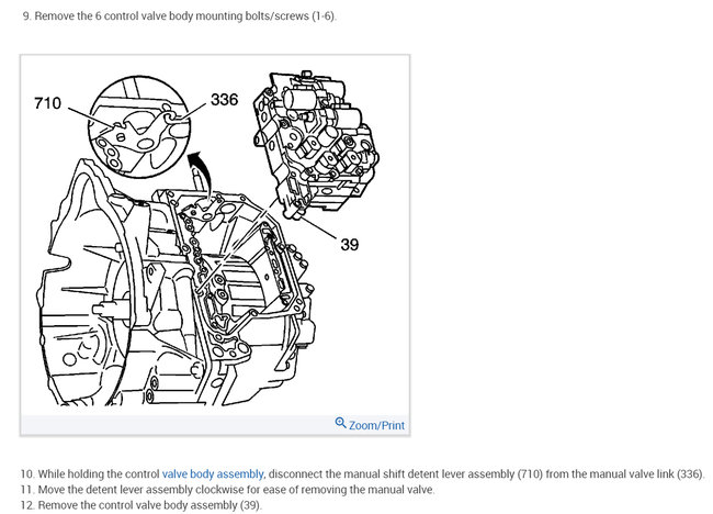

Yes, here are diagrams on how to remove it and the in the instructions on how to reinstall it with bolt tightening specs:
1. Install 2 new transaxle case fluid passage seals (86) into the transaxle case fluid ports.
2. While holding the control valve body assembly (39), connect the manual valve link (336) to the manual shift detent lever assembly (710).
3. Install the 6 control valve body assembly to transaxle case bolts and hand tighten.
4. Notice: Refer to Fastener Notice in Service Precautions.

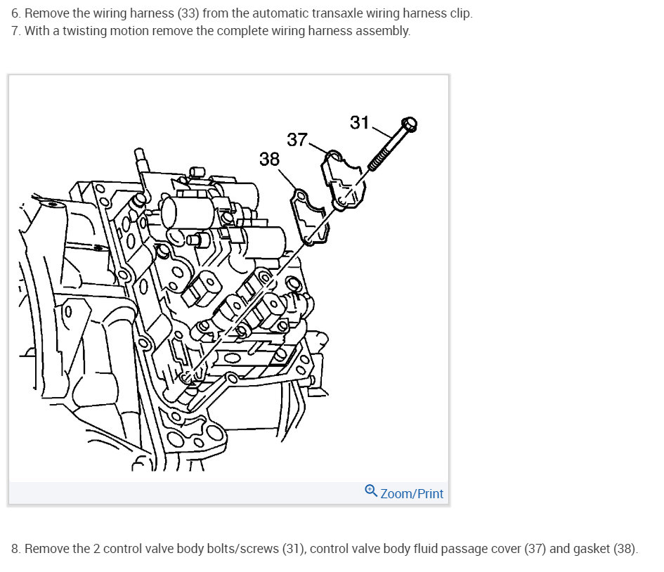

5. Install a new control valve body fluid passage cover gasket (38).
6. Install the control valve body fluid passage cover (37).
7. Install the 2 control valve body bolts (31).

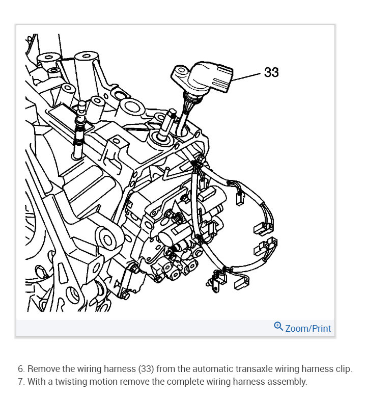

8. Apply GM T-IV automatic transaxle fluid GM P/N 88900925 to a new transaxle wiring connector O-ring seal (46).
9. Install a new transaxle wiring connector O-ring seal (46) onto the transaxle wiring harness assembly (33).
10. Install the transaxle wiring harness assembly (33) into the transaxle case through the wiring harness bore.
11. Apply GM T-IV automatic transaxle fluid GM P/N 88900925 to a new transaxle fluid temperature sensor O-ring seal (32).
12. Install a new transaxle fluid temperature sensor O-ring seal (32) into the groove of the transaxle fluid temperature sensor (36).
13. Install the transaxle fluid temperature sensor (36) into the front control valve body fluid temperature sensor bore.
14. Install the transaxle fluid temperature sensor clip (49).
15. Install the fluid temperature sensor bolt (31).

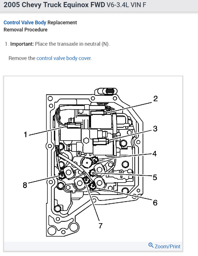

16. Connect the 8 solenoid wire connectors as follows:
^ 1 blue
^ 2 black
^ 3 green
^ 4 black
^ 5 blue
^ 6 gray
^ 7 brown
^ 8 black
17. Install the control valve body cover.
18. Perform the transmission adaptive learn procedure.
