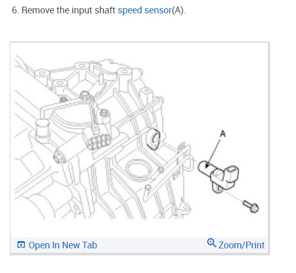

When I'm taking off from being fully stopped and get to about 20 MPH, my car revs up loud and you can't give it any gas. I have to let up and it will kick back into gear, and I can gas it again. so, I'm finding myself having to gas it a lot when I'm starting off. Do you know what my problem is?

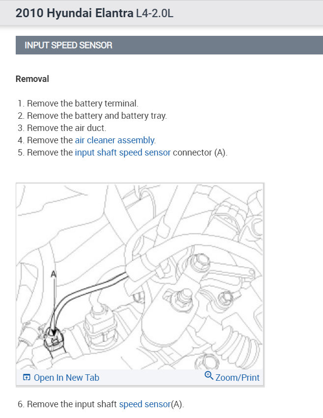

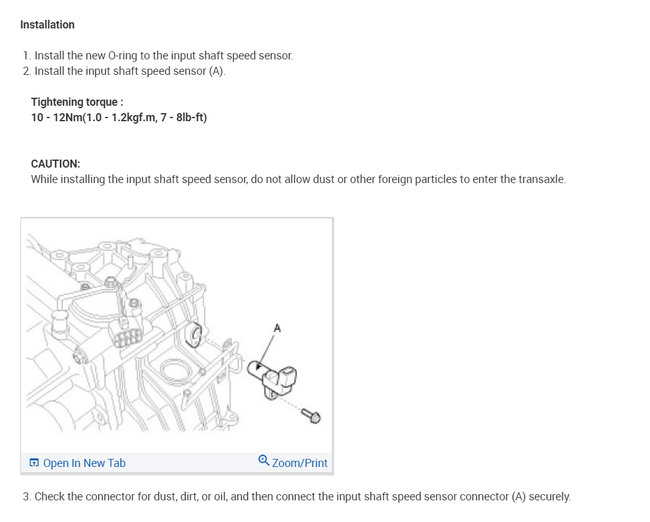

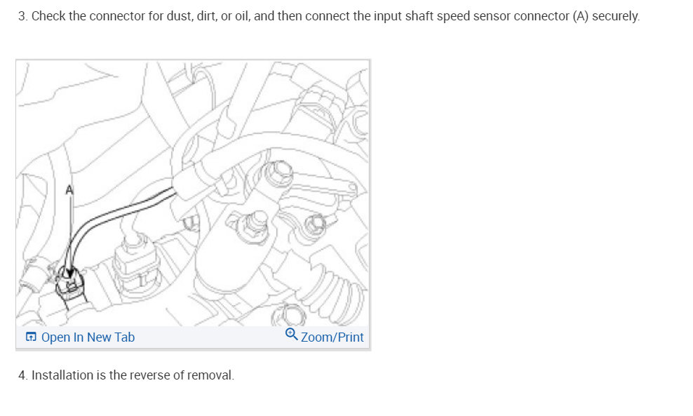

I have also seen the input shaft speed sensor cause this issue as well. Check out the diagrams (Below). Please let us know what you find. Check #36 on the last image to see the fluid dipstick.
