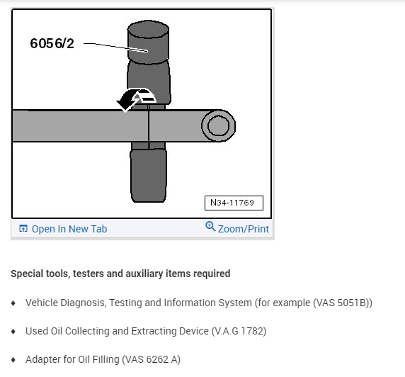

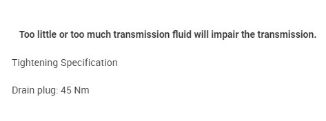

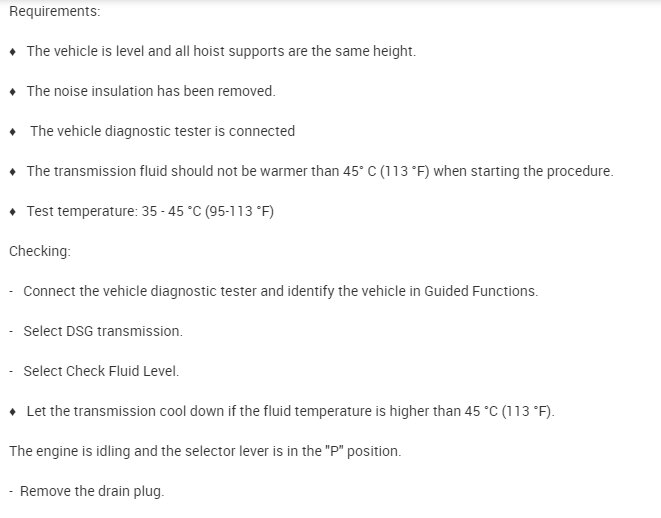

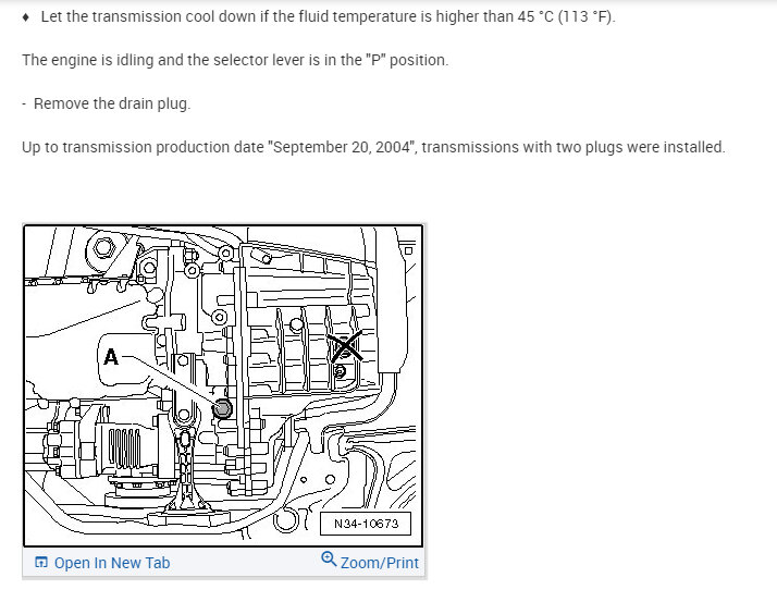

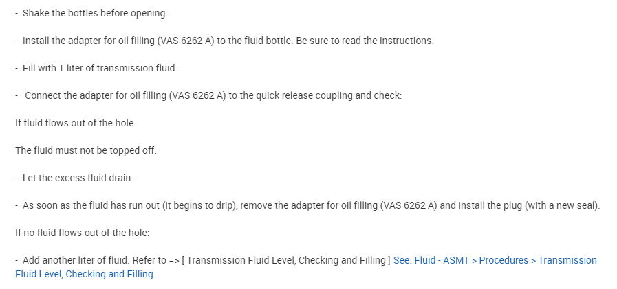

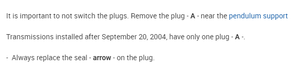

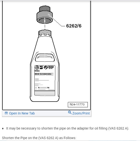

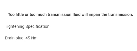

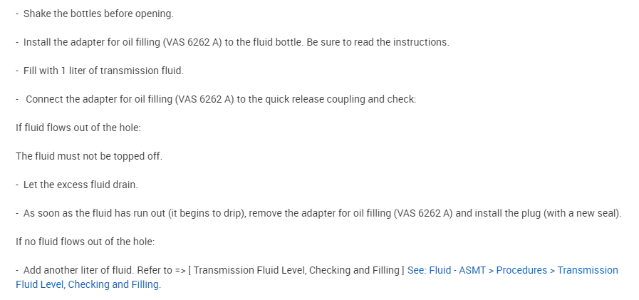

The engine seems to rev but there is no acceleration. Doubt if the fluid and filter has been changed regularly on this car like recommended. Engine also sounds noisy on top end, but I don't really know about these diesels, so I have nothing to compare to. Would you start by checking the fluid level, which by the way is a pain. Why would manufacturers stop putting dipsticks on transmissions? Does fluid absolutely have to be added from the bottom? I have seen where some add it through the filter cup before putting the filter in. Others say there is a fill port with a plastic cap on it.
Oct 22, 2022 at 2:12 AM
  • 110,240 POSTS

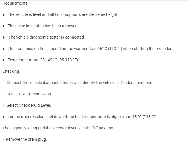

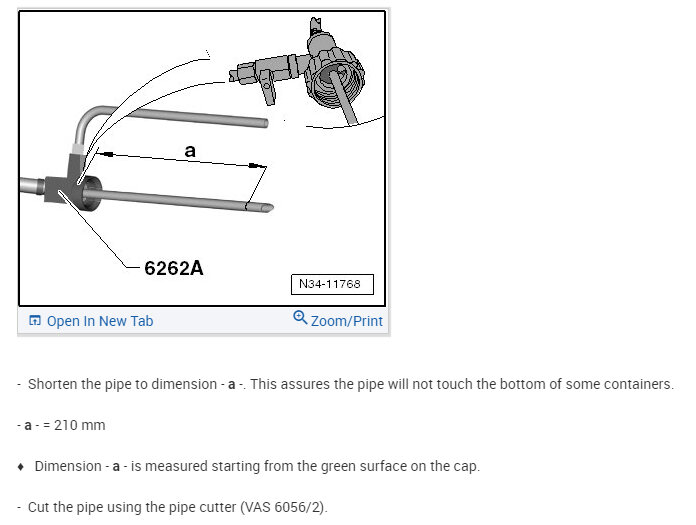

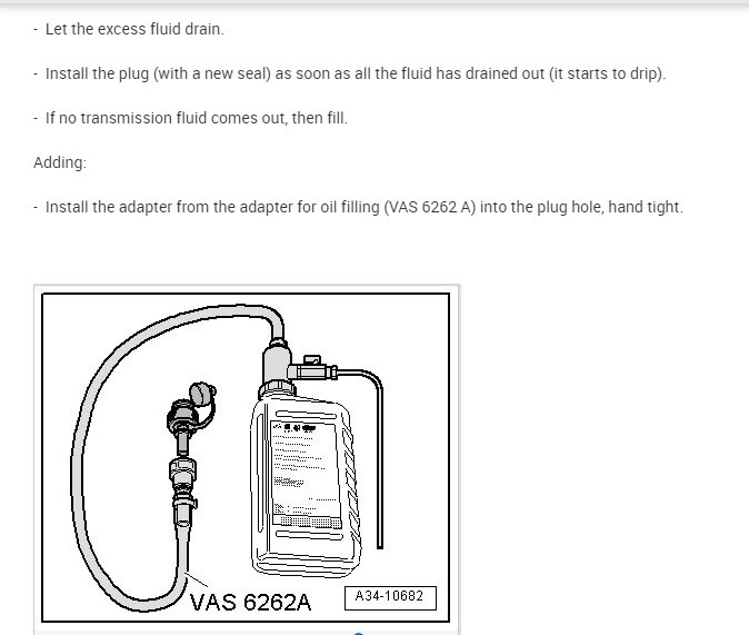

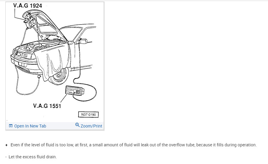

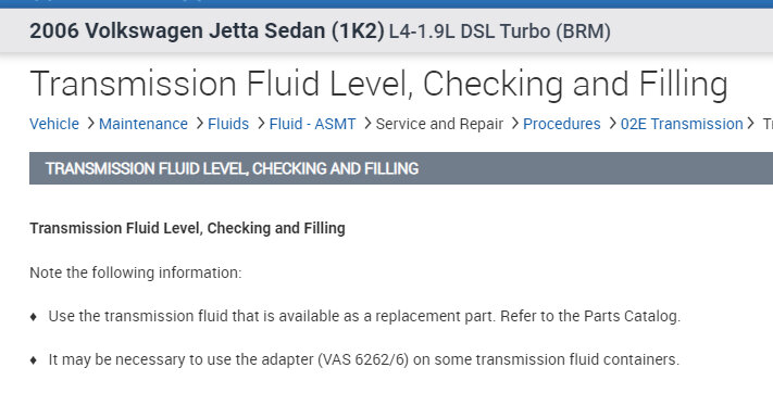

First, I attached the directions for checking and adding fluid below. As far as your question related to a dipstick, I wish I could answer you. Other than the desire to have the vehicle taken to the shop for service, nothing else makes sense.
When you place it in gear, does it do anything? If not, check to make sure the shift linkage is properly connected.
