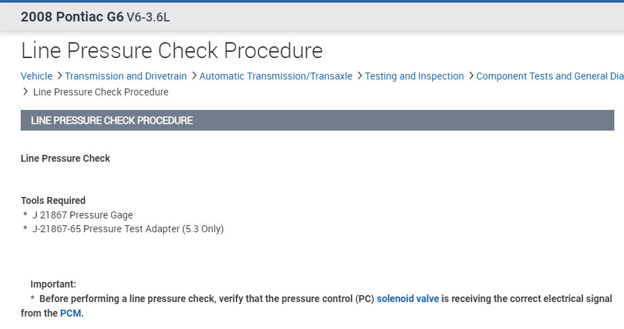

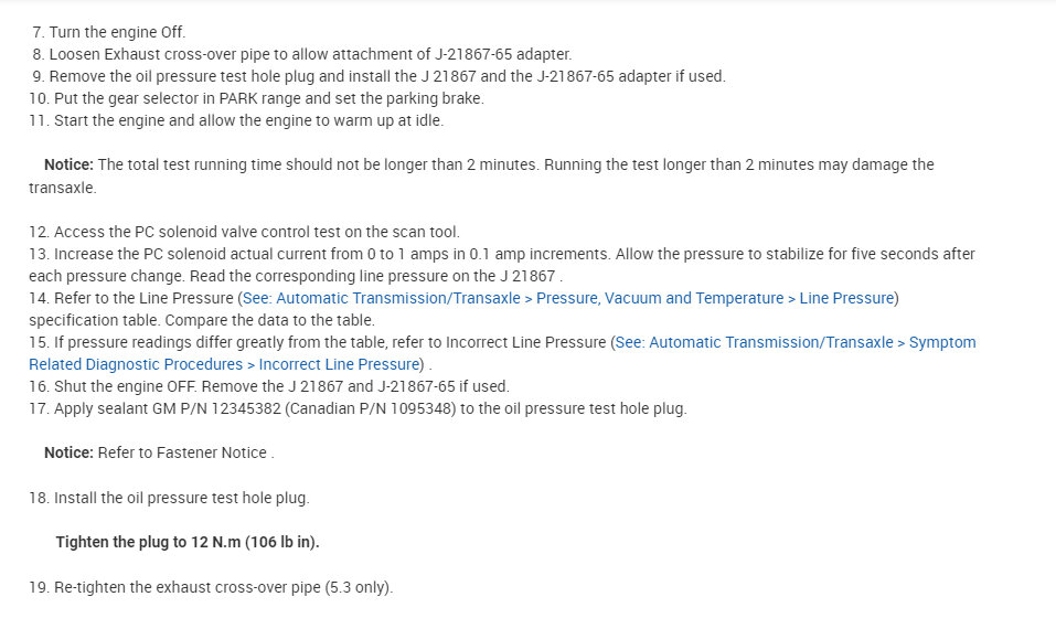

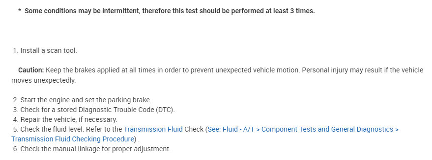

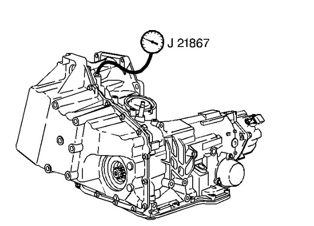

That sounds like low fluid, but if you just replaced the filter and fluid, I suspect it is correct. That leaves line pressure as the next suspect. If it is too low, this can happen.
I attached the diagnostics for testing line pressure below. You will need a pressure gauge for transmissions. However, oftentimes a parts store will lend one to you.
Take a look at the directions and let me know if this is something you can do or have done.
