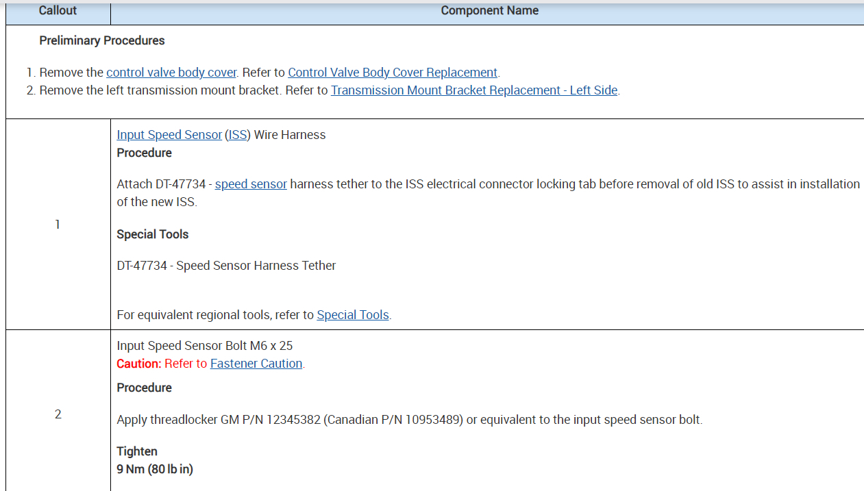

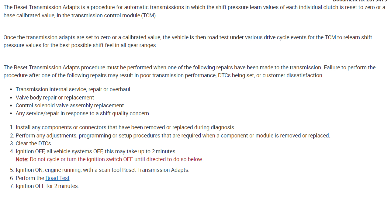

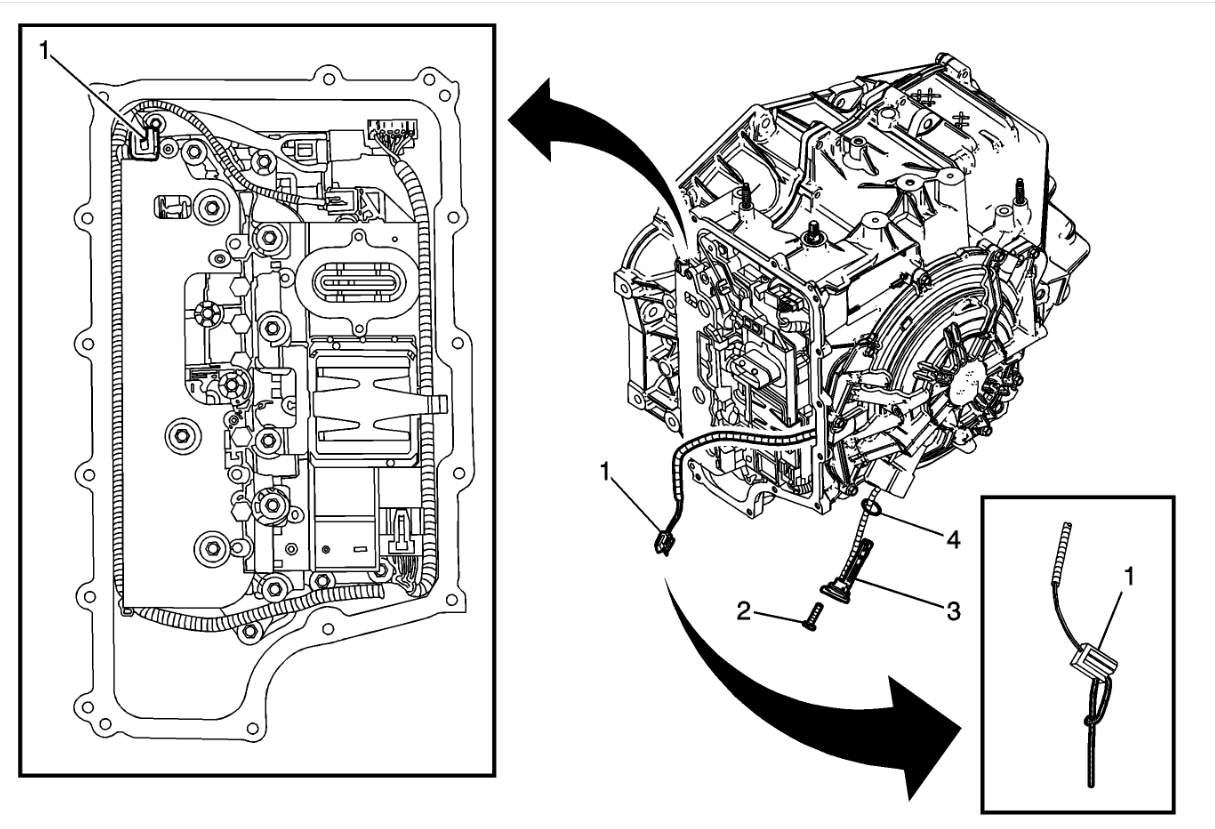

I changed the fluid twice and added instant shudder fix, but i still have a shudder. It is better than before but shudders at same speed around 30-40 when am letting the RPMs go below 2. No issues at take-off or highway speeds. No slippage or jerking or thuds. It's so annoying. I only driven about 40 miles with insta shudder, do you think it takes time? Also, is it usually the torque converter doing this? And if replaced most likely will fix the issue? I may end up doing that if i have no success with it. No engine or transmission codes per can scan.
Jan 13, 2024 at 10:56 PM
  • 55,214 POSTS

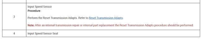

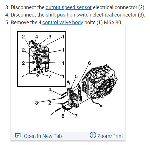

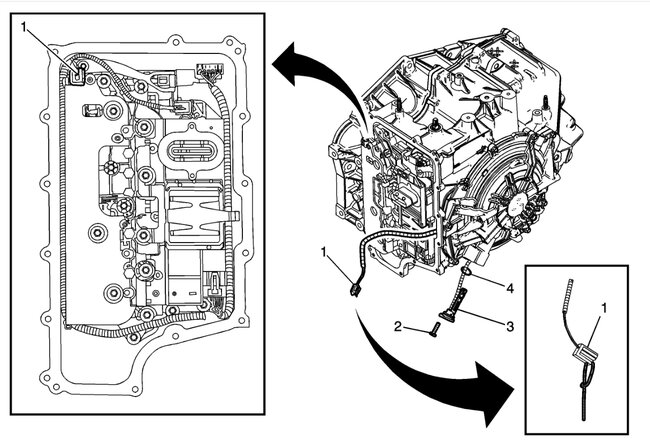

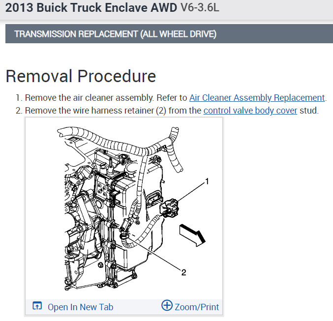

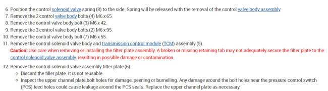

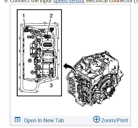

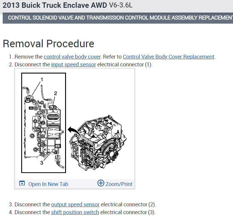

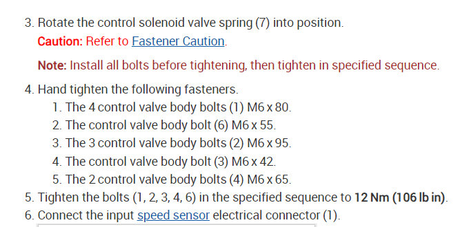

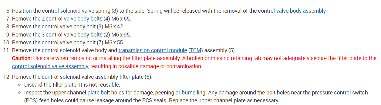

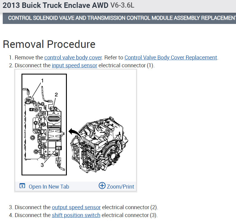

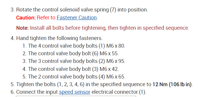

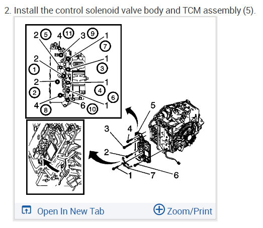

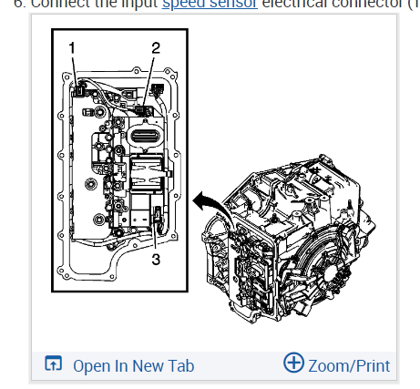

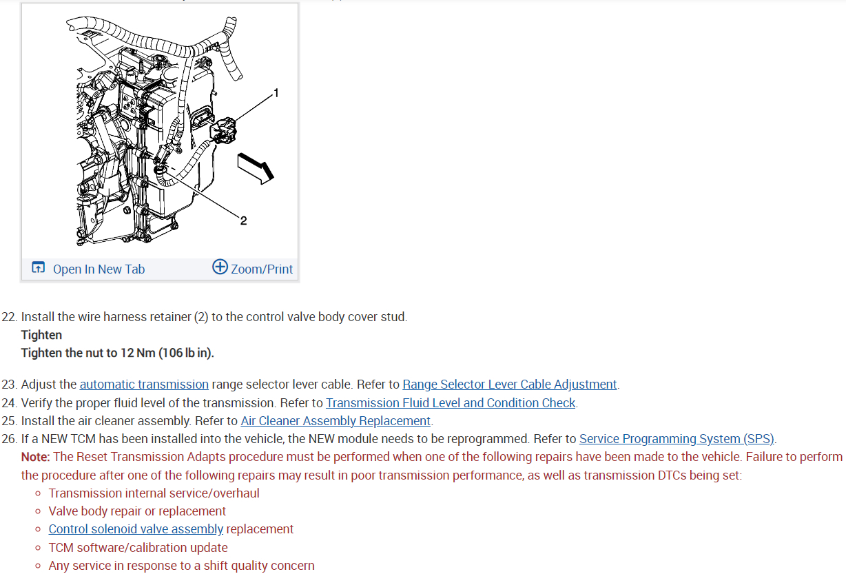

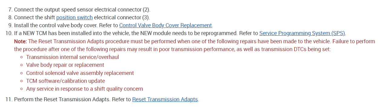

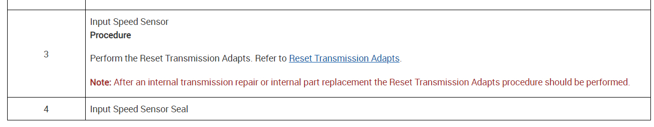

I have seen the transmission control module (TCM) cause this problem as one of the pressure control solenoids is weak and starts to shut down. I have also seen the input shaft speed sensor do this as well, here is the location of the sensor if you want to swap it out. If that doesn't fix it I would do the TCM which I have included as well.

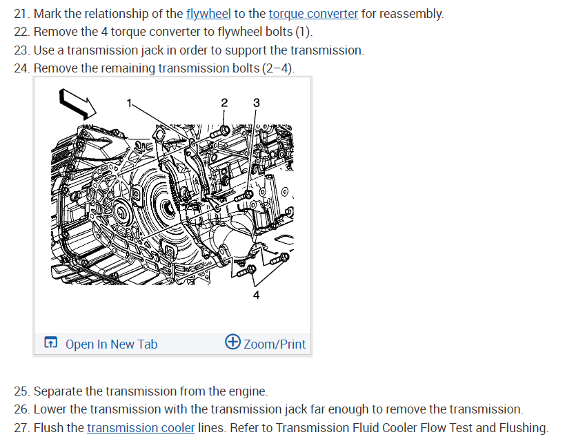

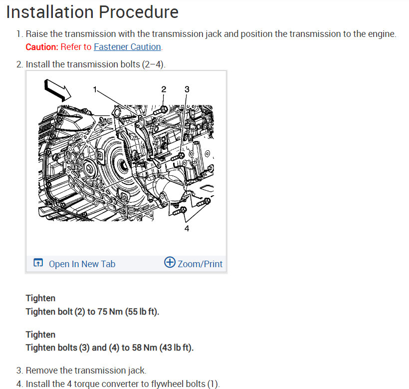

The noise is coming from the mechatronic unit area, similar to the sound of a dry power steering reservoir, but only when put in gear. I would hate to change the tcm and the sensor and then it turns out something else is bad so its safer to change the whole transmission. What about the torque converter? Seen videos showing the center has play, not sure what that can cause.
Jan 14, 2024 at 8:13 AM
  • 55,214 POSTS

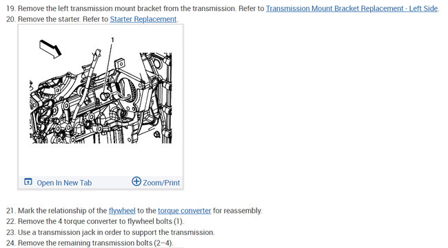

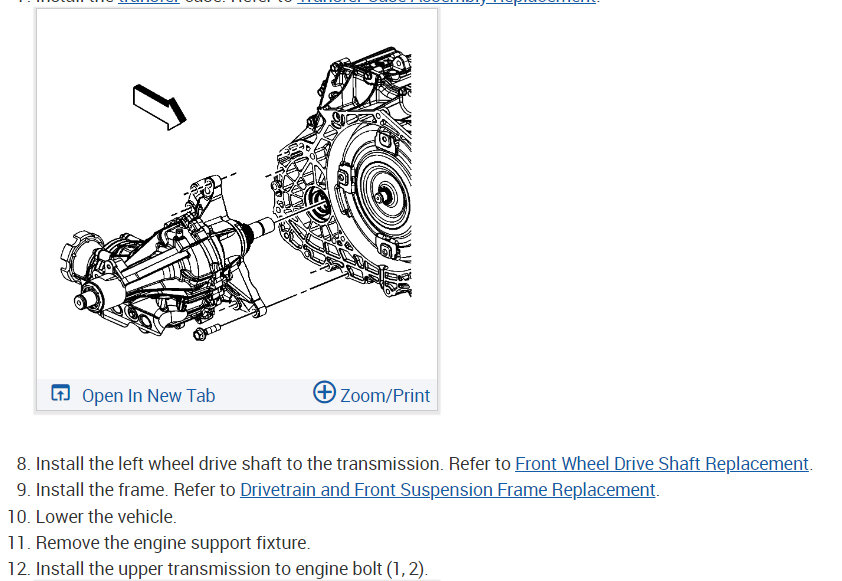

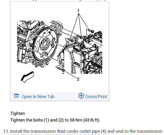

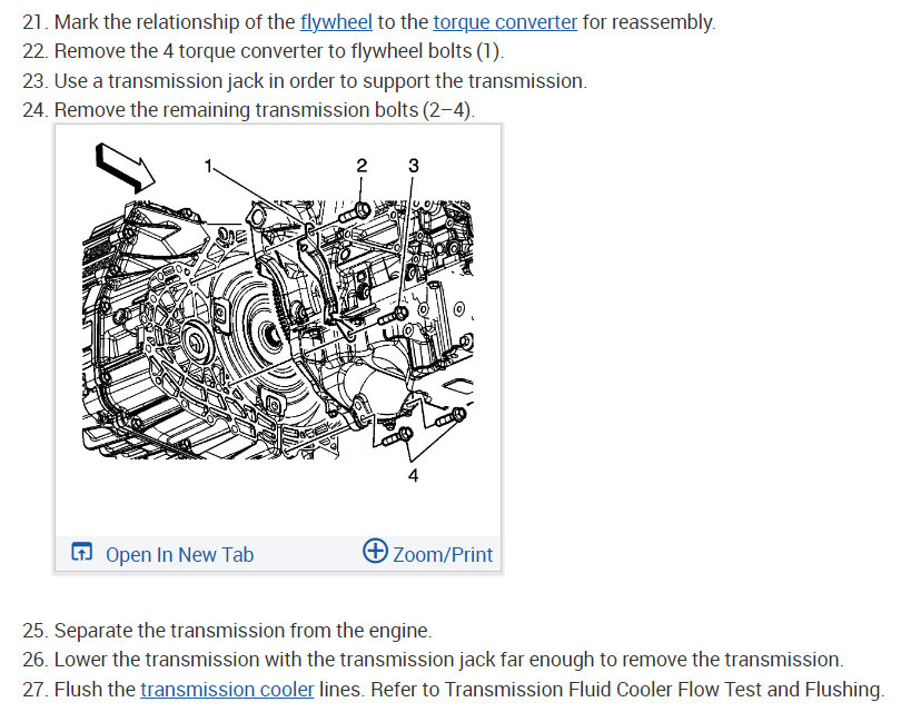

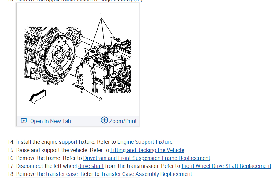

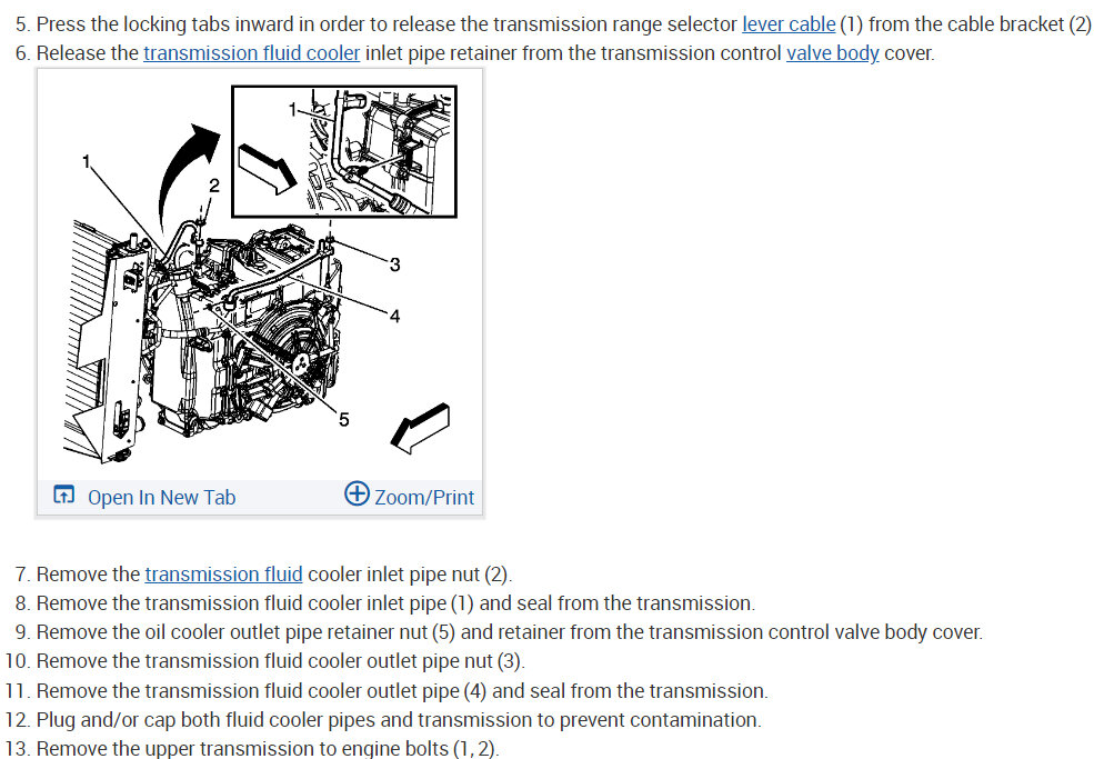

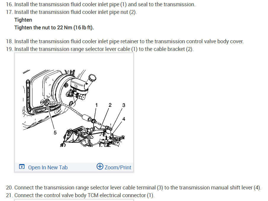

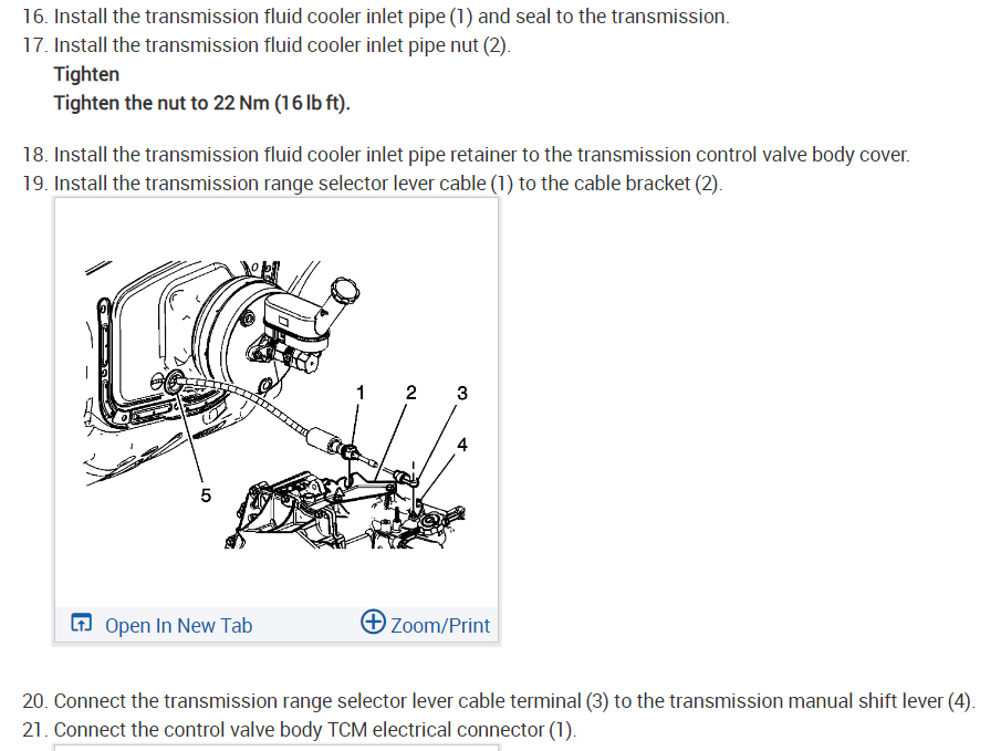

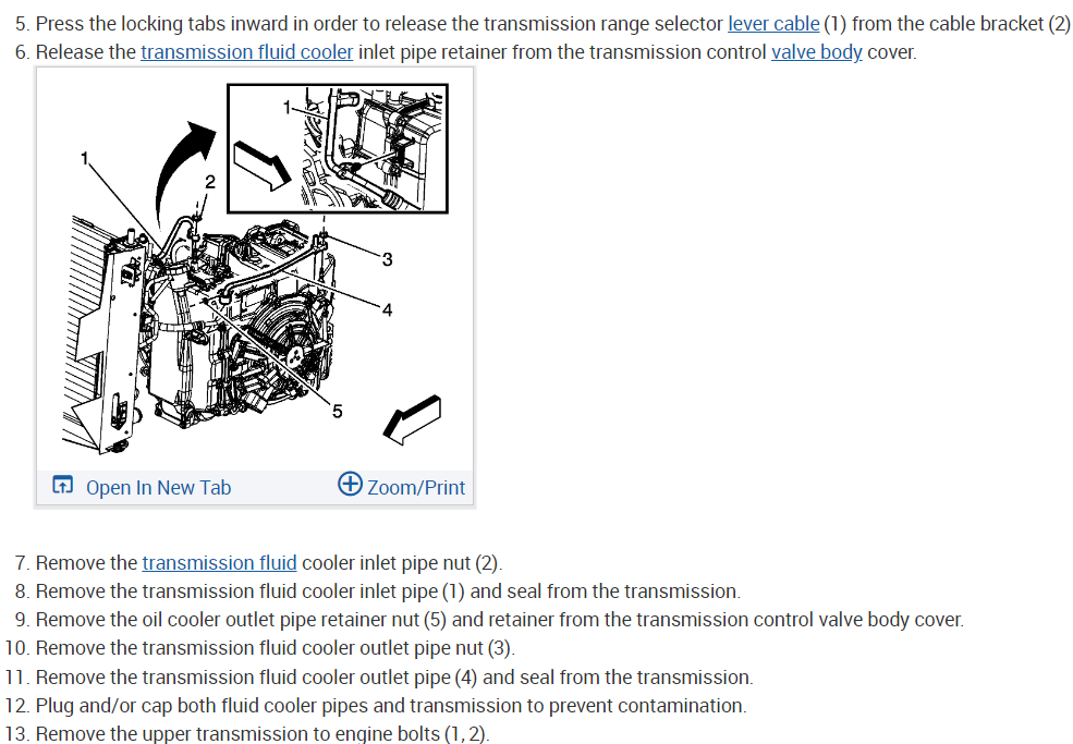

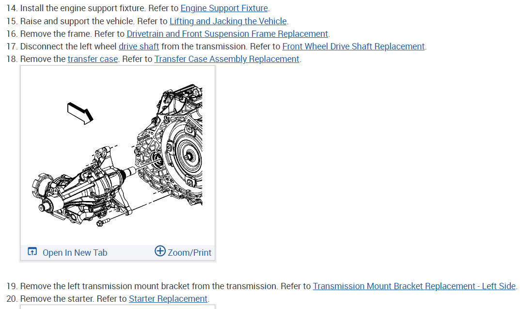

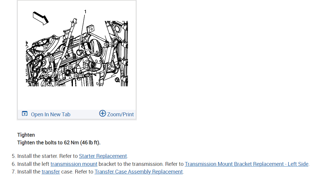

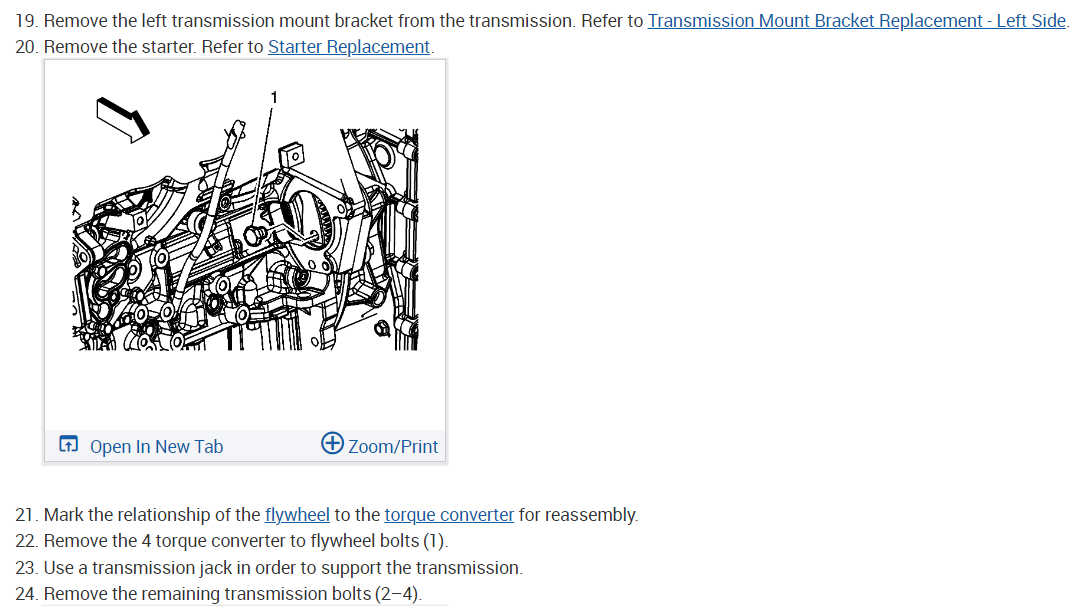

Yep, the noise is not good, to be safe with this many miles I would change out the transmission with torque converter to be safe. Here are the instructions on how to do so. Check out the images (below). Please let us know what happens.

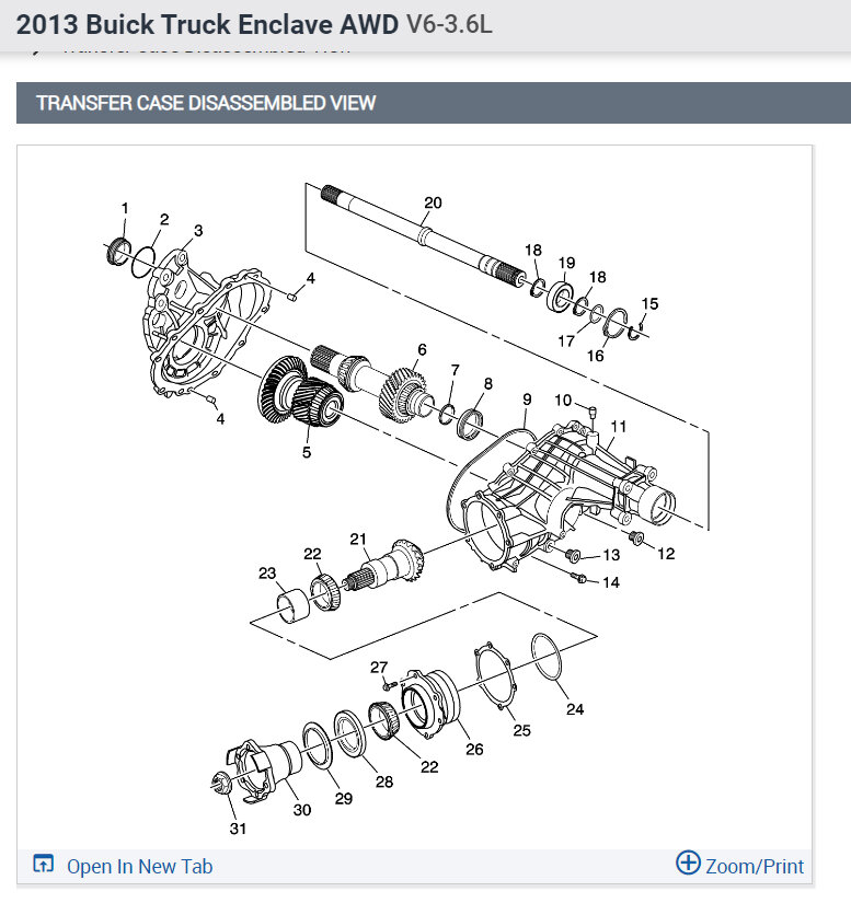

I am starting to think it may be the transfer case causing all that. Had 2 BMW x3 that did that as well as a 4 series.
Jan 19, 2024 at 4:41 AM
  • 55,214 POSTS

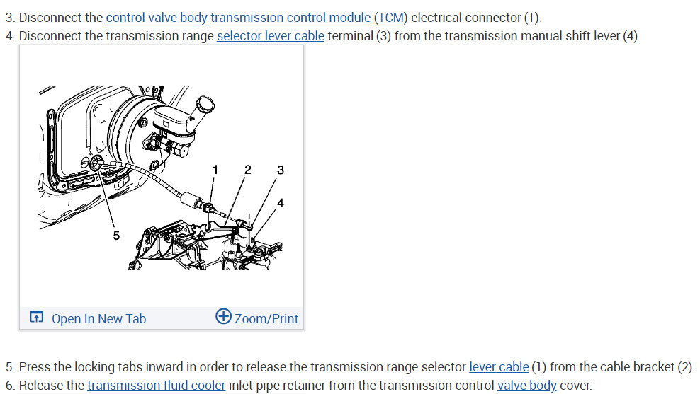

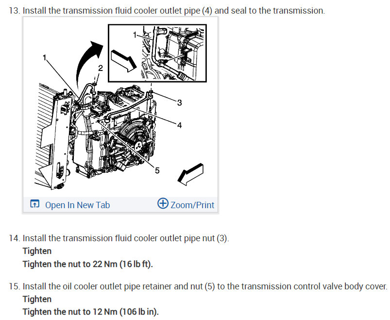

There is no clutch inside the transfer case just gears, unless one of the main bearings is going out but you should be able to hear that. Check out the images (below). Please let us know what happens.

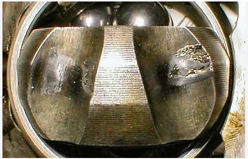

Oh yes, when a CV axle wears it will create grooves inside the cup which makes the CV joint bind, does the sensation go away when you let off of the throttle?

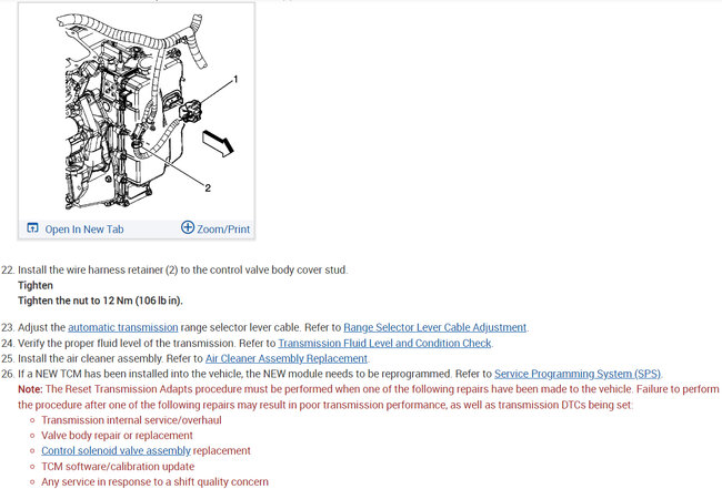

Did you take apart the CV joint because the wear is inside the carrier. Check out the images (below). Please let us know what happens.
