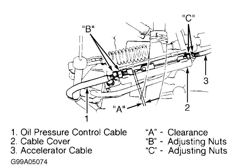

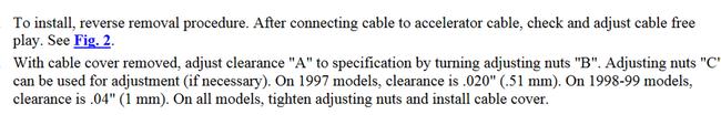

if you aenot getting second gear even when putting it in low then 2nd then I'd check for something in the valve body like metal shavings due to the broken pump gear. the sprag works for drive initially but after 2nd it doesn't but check it anyhow it . also make sure your throttle cable is adjusted properly as it may not have enough pressure when you take off andcheck the governor for junk in it as well. If you used the original torque converter tht ai where your junk came from and if you didn't have it replaced or cleaned out at least youll have to clean out your lines as well because torque converter goes to cool to rad right away.
