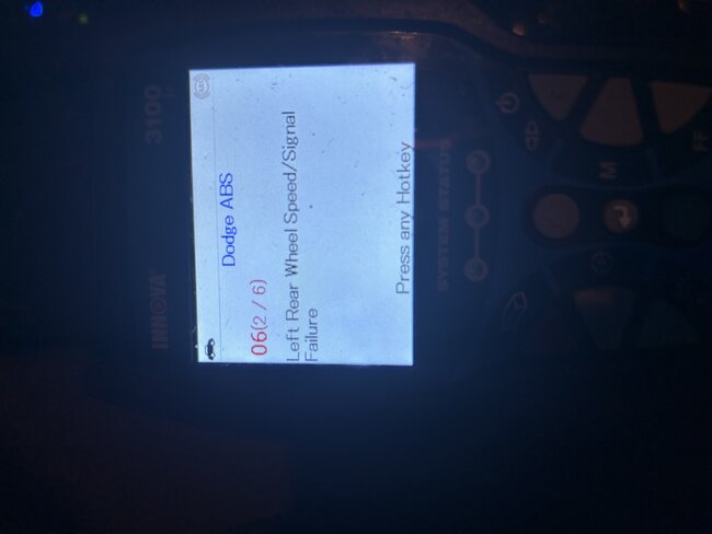

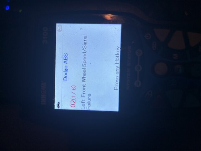

The van was level and fluid was cold when I checked it. There’s a mark level for both warm and cold reading. Fluid is still reddish color, but it does smell a little off. I’m guessing from driving with high RPMs? I’ve been temporarily pulling off the road and erasing the codes so I can make it to my destination while trying to figure this out. Probably not a good idea I suppose but don’t have any other option.

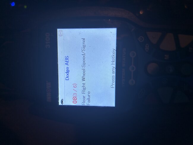

Also have ABS code errors telling me all wheel speeds they have a signal failure.

It sounds like this is a sensor-related issue. Could you send me the codes that you are getting for the wheel speed sensors? It may help me figure things out or at least point me in the right direction.

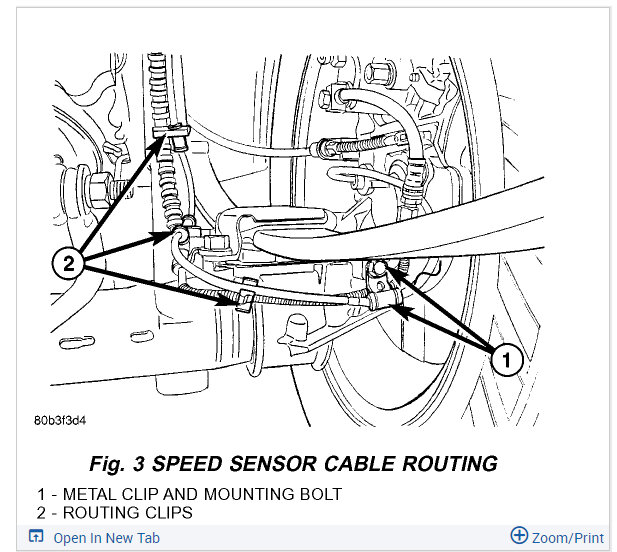

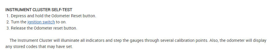

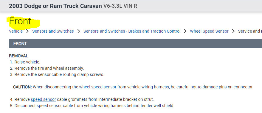

Did you inspect or replace the wheel speed sensors that are indicated? Also, try resetting the cluster to see if that changes anything. I attached the directions below.
See pic below.
Nov 26, 2023 at 8:35 AM

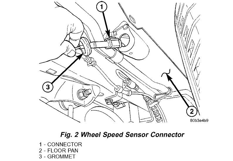

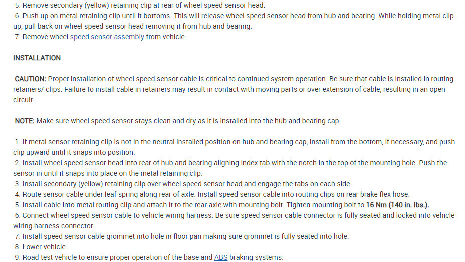

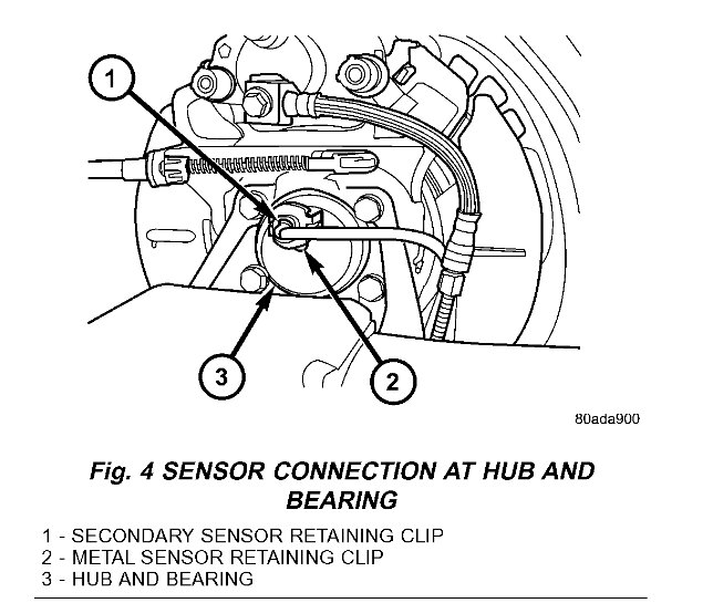

DOT2DOT
Hi Joe,
I reset the cluster and no change. I’m currently waiting for my order for the wheel speed sensors. I’ll let you know how things turn out once installed. Thanks again.
Nov 28, 2023 at 3:42 AM
  • 110,248 POSTS
Thanks for the update. I was hoping the reset might help. It never seems to be that simple. LOL

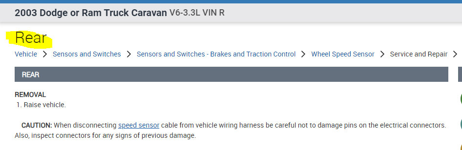

As far as the wheel speed sensors are concerned, here is a link that explains in general how it's done. I don't know if you need it, but thought I would add it. If you have any specific questions, let me know.
https://www.2carpros.com/articles/how-to-replace-an-abs-wheel-speed-sensor

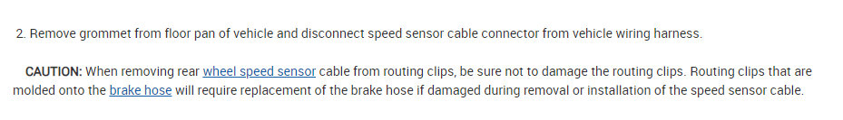

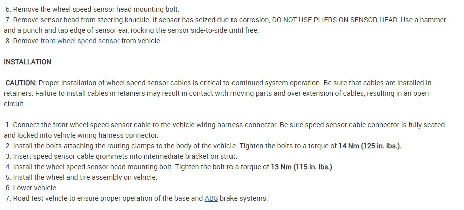

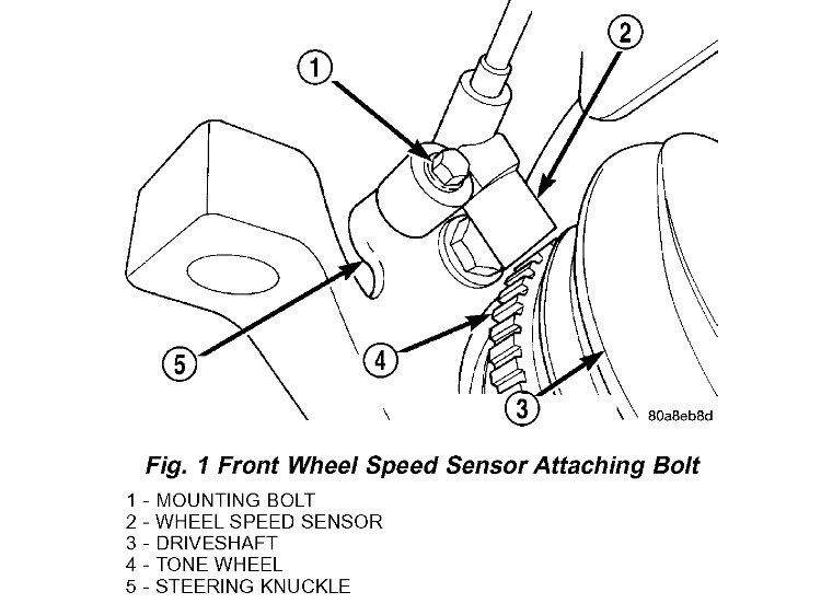

I also attached the manufacturer's directions below. When you remove the original ones, chances are they will be corroded and difficult to remove. Take your time. If you have penetrating fluid, you may want to start spraying them down now, so it has a chance to work.
Make sure you don't pry the sensor on an angle. It will break and then it will be much more difficult to remove. Gently twist it back and forth once it starts to move, then while twisting it, gently pull it outward.
Let me know how things turn out for you.
