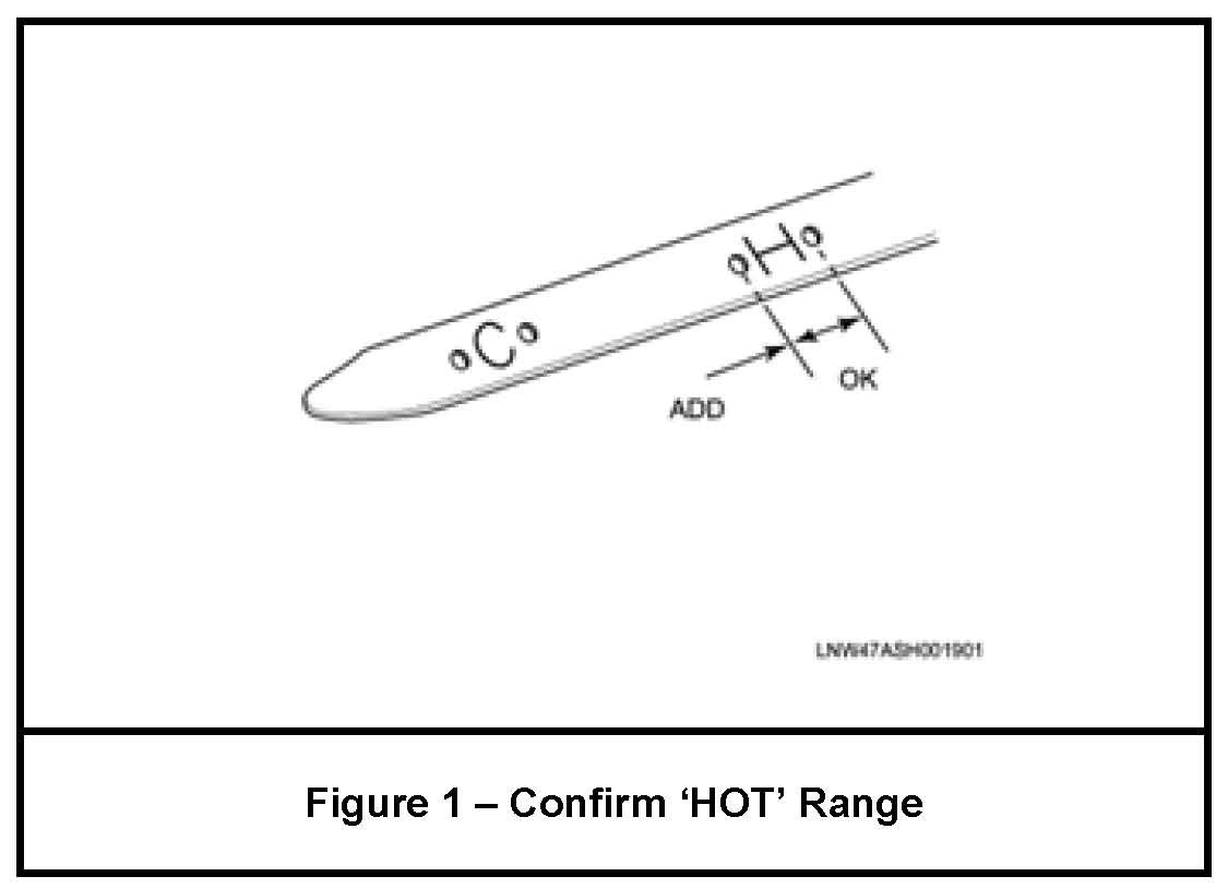

Okay, if the engine RPM's are increasing but the vehicle isn't, it almost sounds like the transmission is slipping.
I need you to check the transmission fluid level to confirm it is clean and full. Here are the directions for doing it.
____________________________________
Engine RPM must be at idle before starting the level check. Keep the transmission fully warmed (valve body ATF temperature: 158-176°F/70-80°C) during the procedure.
1. Park the vehicle on level ground, set the parking brake, block the wheels and start the engine.
2. With the engine idling and regular brakes applied, shift the gear slowly in every range from P to 1 range, and return to the P range.
See pic 1
3. With the engine idling, remove the level gauge and clean off any fluid or foreign material. Insert the level gauge, remove it again, and confirm that the oil level is within the 'HOT' range.

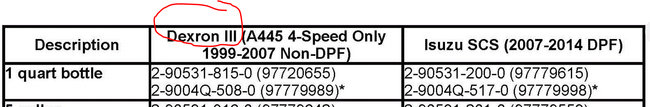

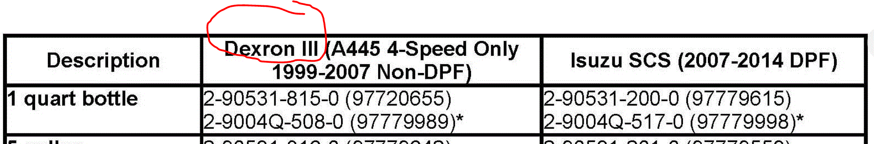

I checked. It's not in the 'H" range. What oil shall I use?
Friday, April 10th, 2020 AT 7:25 PM
  • 109,867 POSTS
What I am seeing for a 2001 is Dexron III. See attached picture.
Is the fluid clean? (Red in color)
