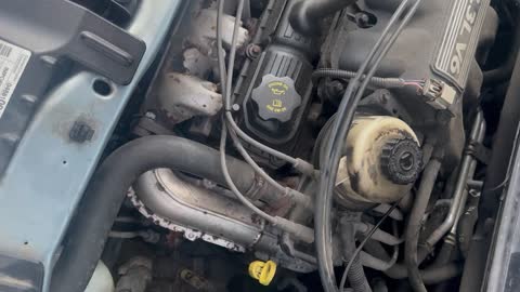

Hi Ken, thanks for getting back to me. After your suggestion of new solenoid could be bad, I decided to call the manufacturer for warranty info and/or replacement. The tech said it sounds more like the trans pump. Here is a video of engine idling along with the sound it makes.
Nov 26, 2025 at 4:44 AM
  • 55,433 POSTS
Yep, good call on the pump, but this can be the filter is clogged or the filter has come lose from the case and the pump is sucking in air. I would check that first. Thanks for the video it helps.

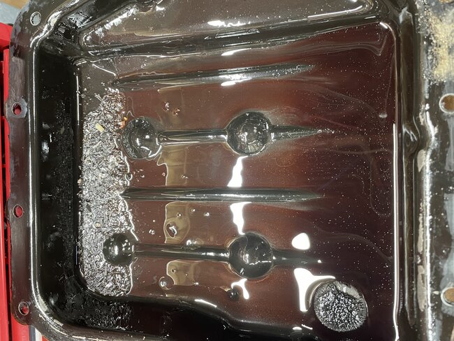

MGOBLUE78
  • 21 POSTS
Oh no! This ain’t good!!
Nov 29, 2025 at 4:03 AM
  • 55,433 POSTS
Yo no! is right, that transmission is done and needs a rebuild or another unit :/ Sorry, but it looks like you found the problem.
