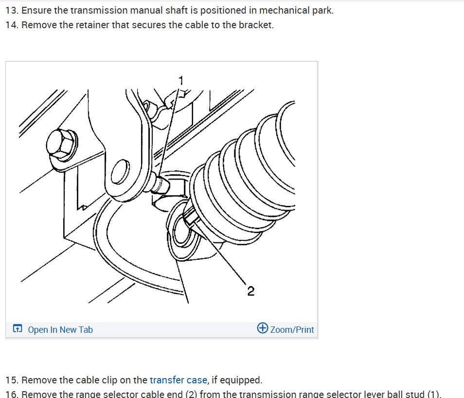

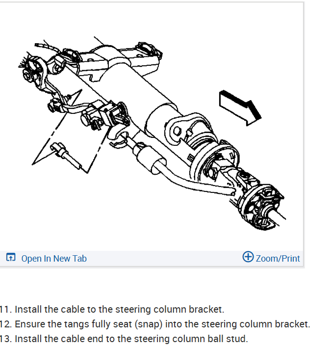

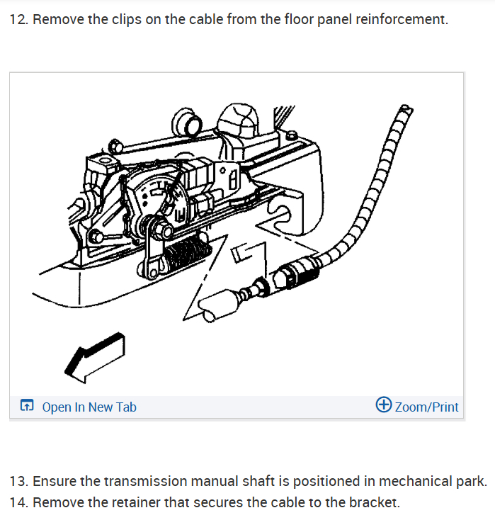

We are replacing the cable but we can't get it to connect correctly and change gears
Sep 18, 2026 at 4:33 PM
Experienced Mechanic
55,748 POSTS
Can you upload images of the problem or a short video so I can see what is going on? Here are some instructions to help in the meantime. Let me know
