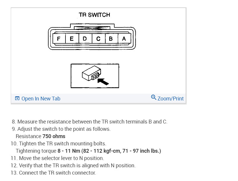

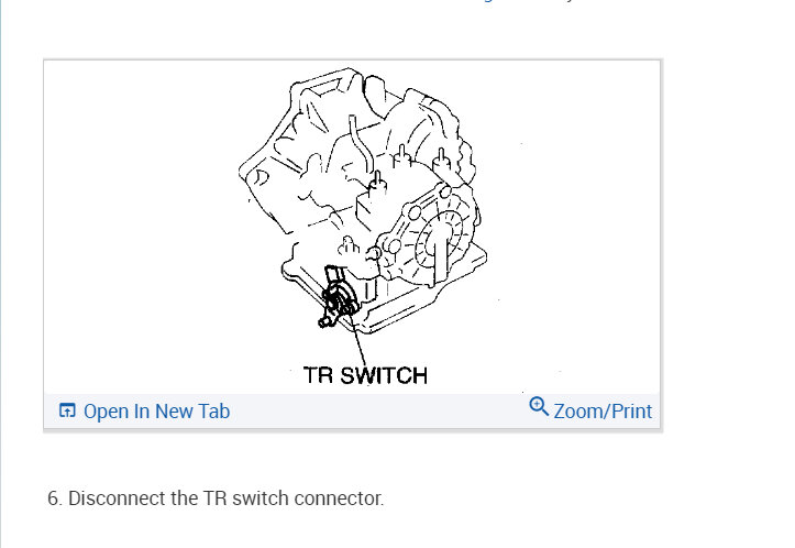

When shifting to drive, the indicator shows rapid change from 1,2,3, but not moving and when it reaches 4 the transmission works but hard to get its power to move.
Oct 28, 2022 at 11:07 PM
  • 55,412 POSTS

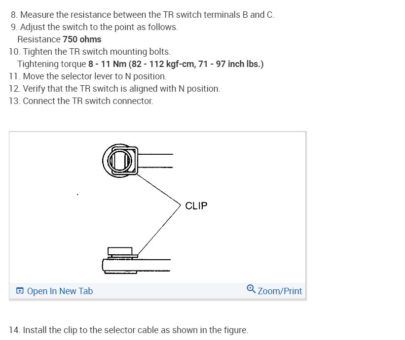

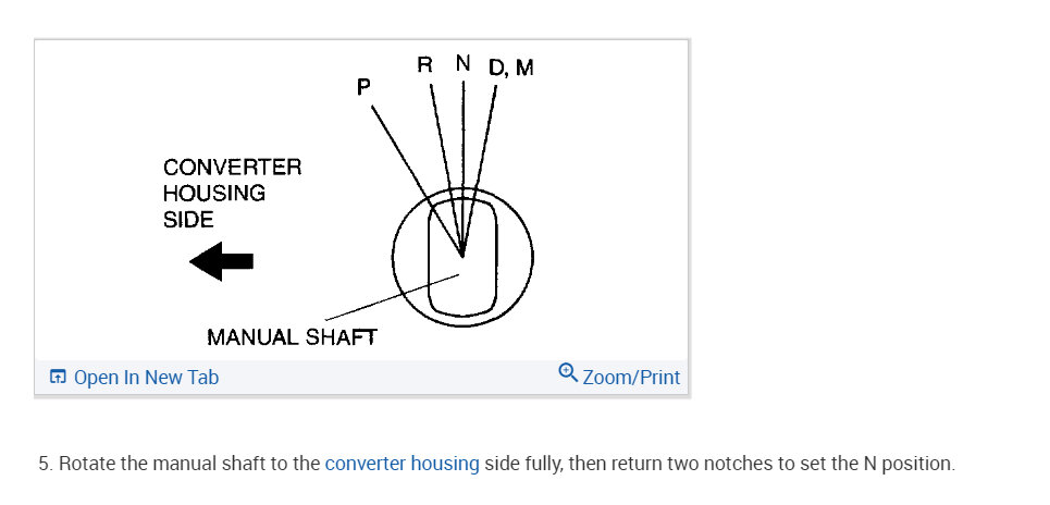

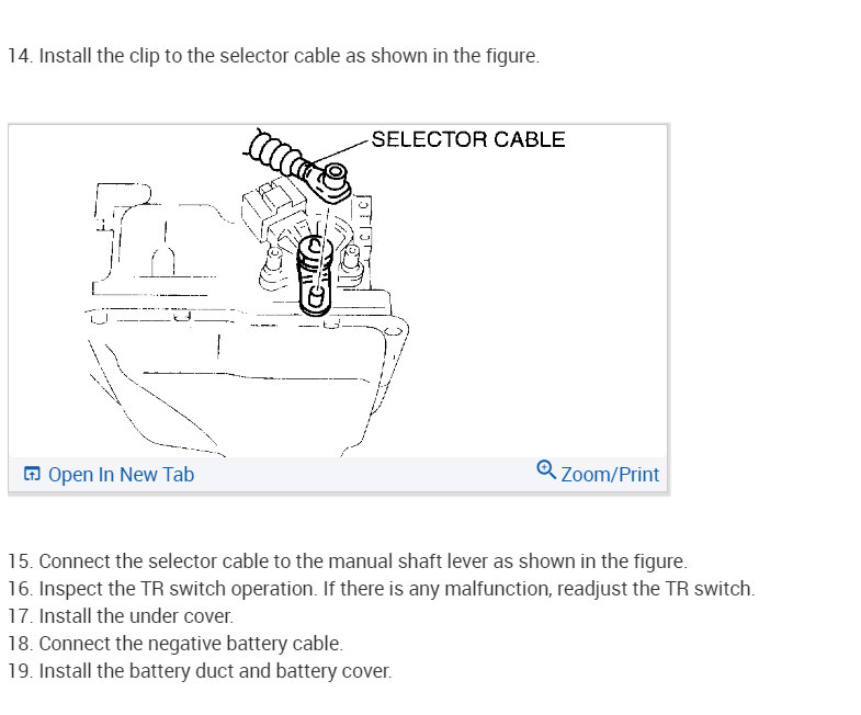

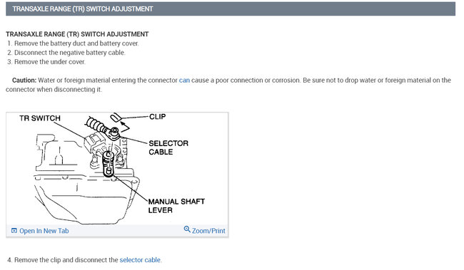

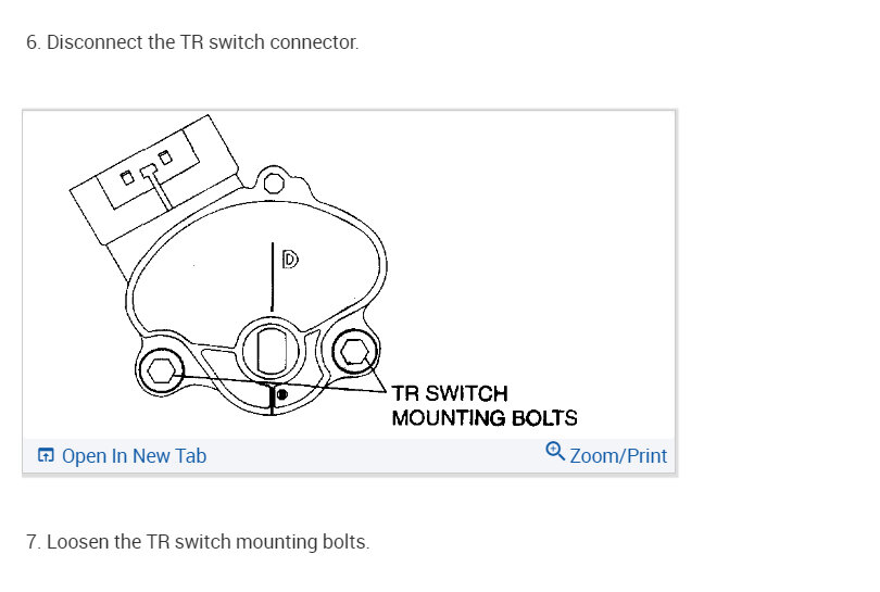

It sounds like the transmission range sensor is not working correctly but to be sure we need to do a CAN scan which is easy to do. You can get a CAN scanner (Controller Area Network) from Amazon for about $36.00.
https://youtu.be/u-4syLc-ifQ
and
Amazon CAN scanner link for about $35.00.
https://amzn.to/3R9lJ60
Just us case I have provided the location of the sensor so you can check it out. Check out the images (below). Please let us know what happens.
