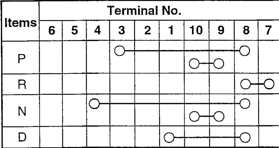

How do I test the Shift connector on top of transmission. What power conditions do I expect to see at the connector at the different shifter positions.
I need a wiring diagram
Thank you
PS: I have replaced both Input and Output sensors but same issues.
P0755 and P0766 Codes

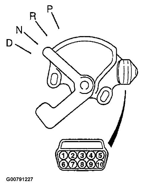

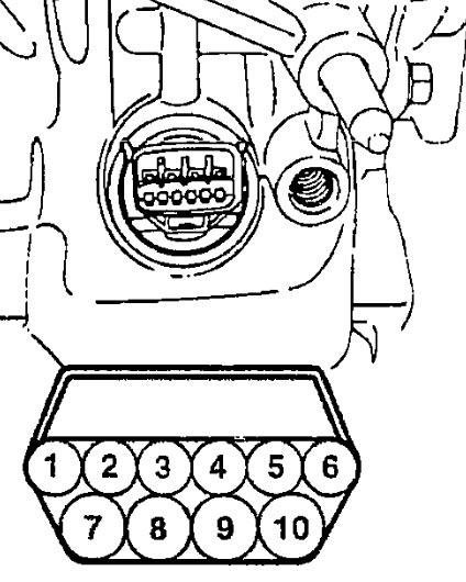

see if shifter on trans actually moves check for continuity see pics..... your trans is probably shot though

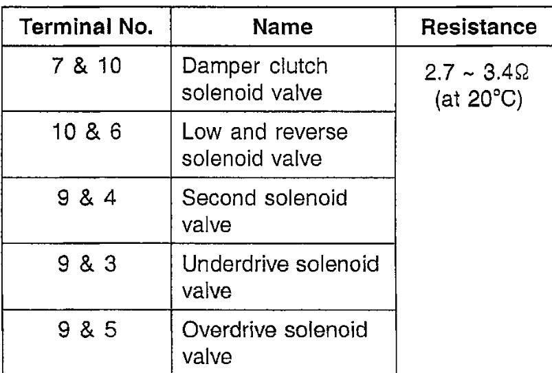

Check engine light came on and DTC above (P0755, P0766) came on. Have removed shift solenoids and tested solenoids good.
I need to test my shift solenoid connector if it is supplying the power needed for the solenoids.

there are no voltage tests for what you want it's all resistance see pics. check resistance of connector to tcm as well should not be over 5 ohm

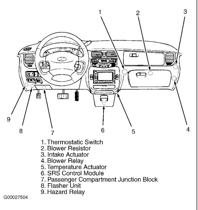

I apologize for being so dumb but where is the AT relay located. I did not see one in the fuse box by the battery and there was none in the one by the driver left knee.

PS: how do I disconnect the TCM to test the harness. Is there a clip or push latch and where exactly is it located?
My solenoids tested 3.6-0hms each at the solenoids but now I need to test the solenoid through the harness as you suggested.

ay is located below center of dash near srs control module. tcm below center of dash no pic for either pic is where srs module is.
