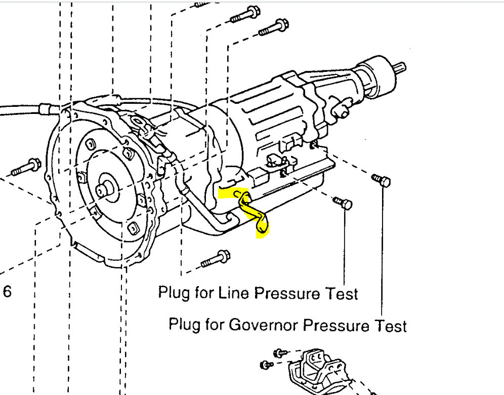

Where is the transmission shifter shaft seal located? Drivers side,or passenger side?

The shift lever is on the driver's side. I attached a picture to help locate it.
