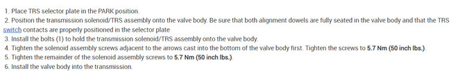

I was having an issue with the shifting where my truck would get stuck in 4 gear and I was getting the code P0700 and P0734, so I figured the shift solenoid pack was bad. so, I replaced the filters, the solenoid pack and the transmission fluid. The truck was driving fine and shifting good, till I was about back home after 20 minutes of driving, then it stopped shifting into 4th and then 3rd, and now I have the codes P0700/P0733/P0734 for incorrect gear ratio for 3rd and 4th gear, I’ve reset the TCM by disconnect the battery for an hour and having the positive and negative cable touching so that it all drains completely. Still having the same issue, I’m thinking I got a bad solenoid pack.

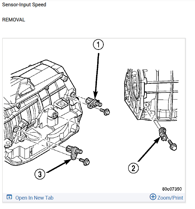

Yep, I agree with you that you may have a defective solenoid pack, but I would double check the wiring connector to see if it is clean and tight. Also, It could be the turbine sensor is off and causing this issue.

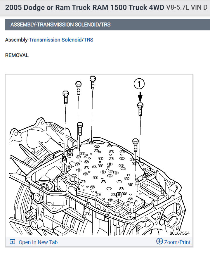

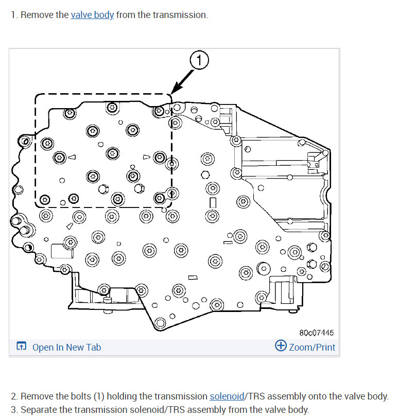

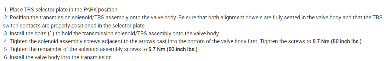

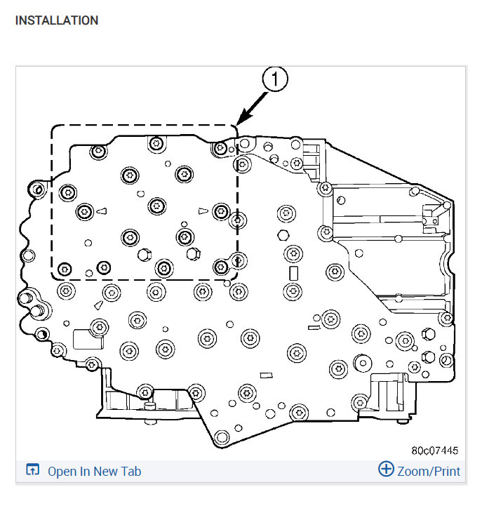

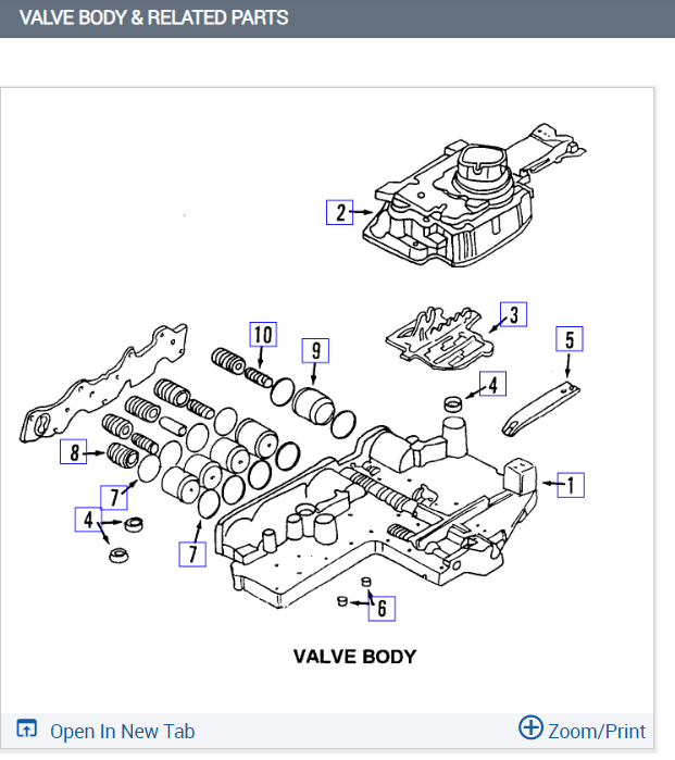

The solenoid pack has a torque setting that must be used. Swap out the unit and then clear the codes to see what happens. Check out the images (below). Please upload pictures or videos in your response to the problem so we can see what's going on.

Everything was torqued down to specs, do you think there’s a possibility that because it was a new solenoid it shorted the speed sensors causing them to stop working hence why the truck isn’t shifting into the higher gears, or even the oil pressure sensor for the transmission.

Yes, these are all possible, but since they are ratio codes, I would do the speed sensor first. Does the transmission slip at all when it was working?

Yep, I would try the sensor and if that doesn't help you have a defective solenoid pack.

I replaced the speed sensors and that didn’t fix it, I just replaced the solenoid pack and I’m still having P0733 and now I’m getting a P0750, I’m a little lost at this point and I’m unsure what to do.

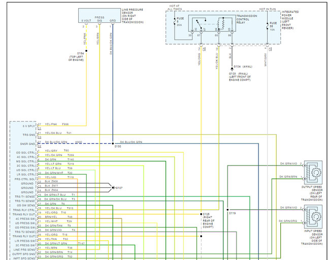

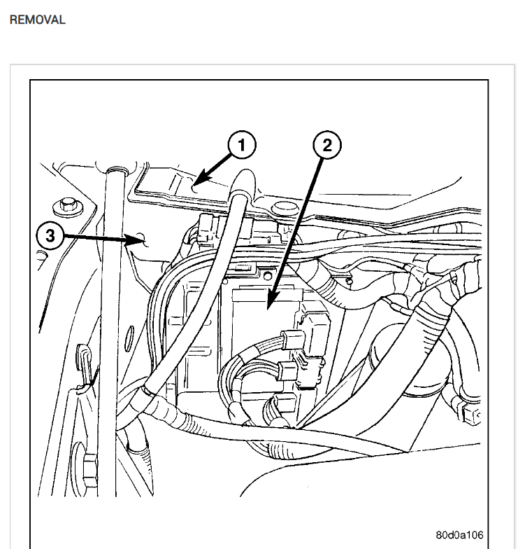

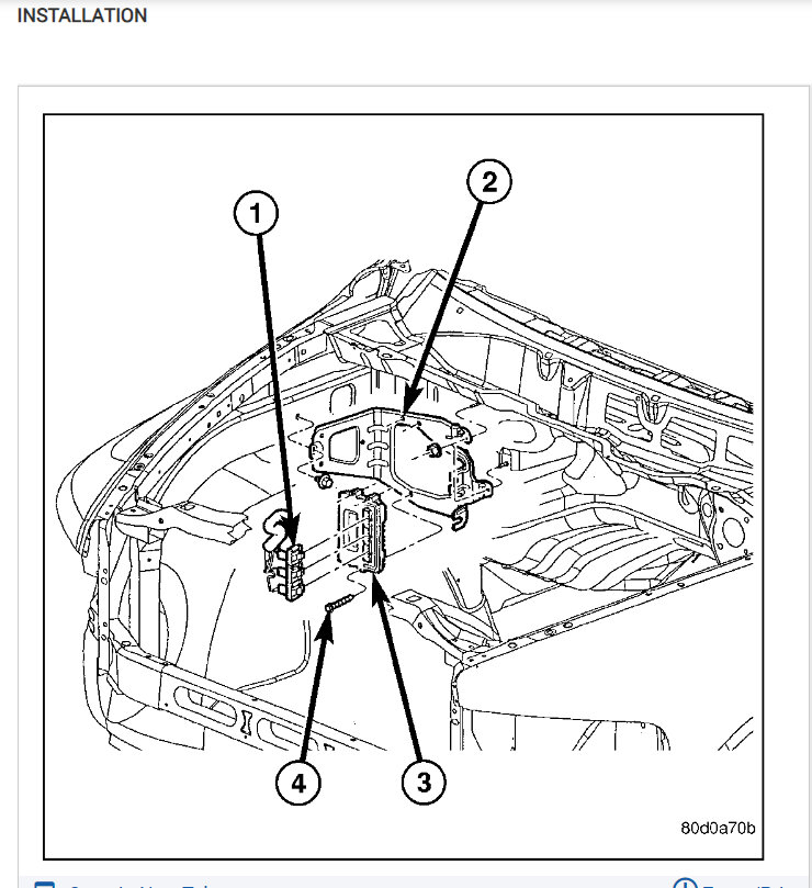

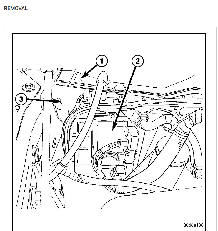

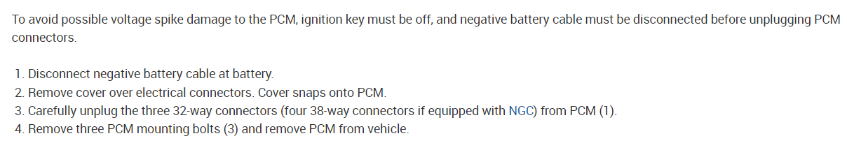

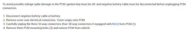

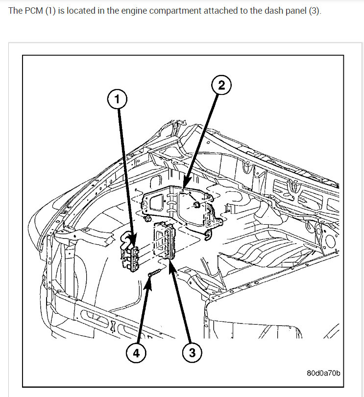

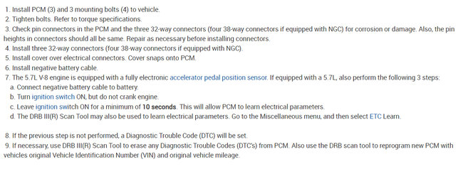

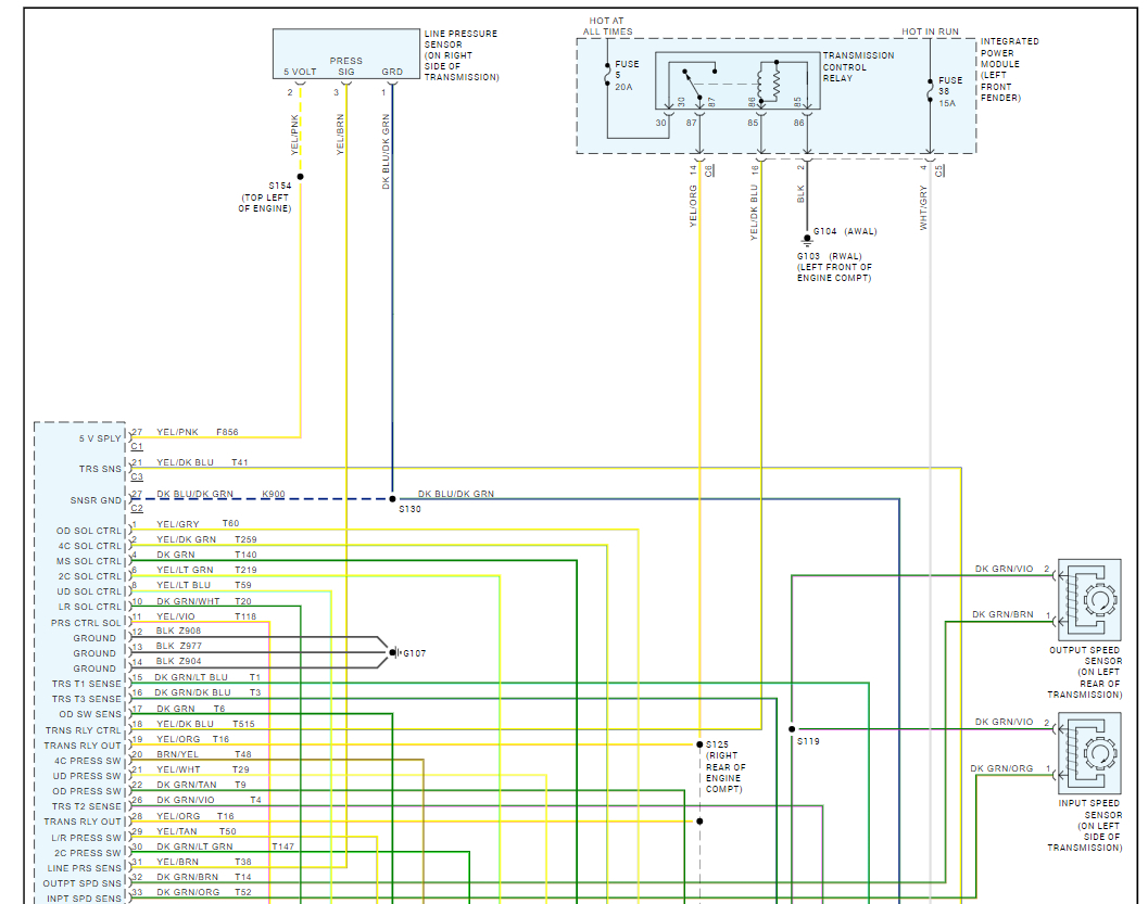

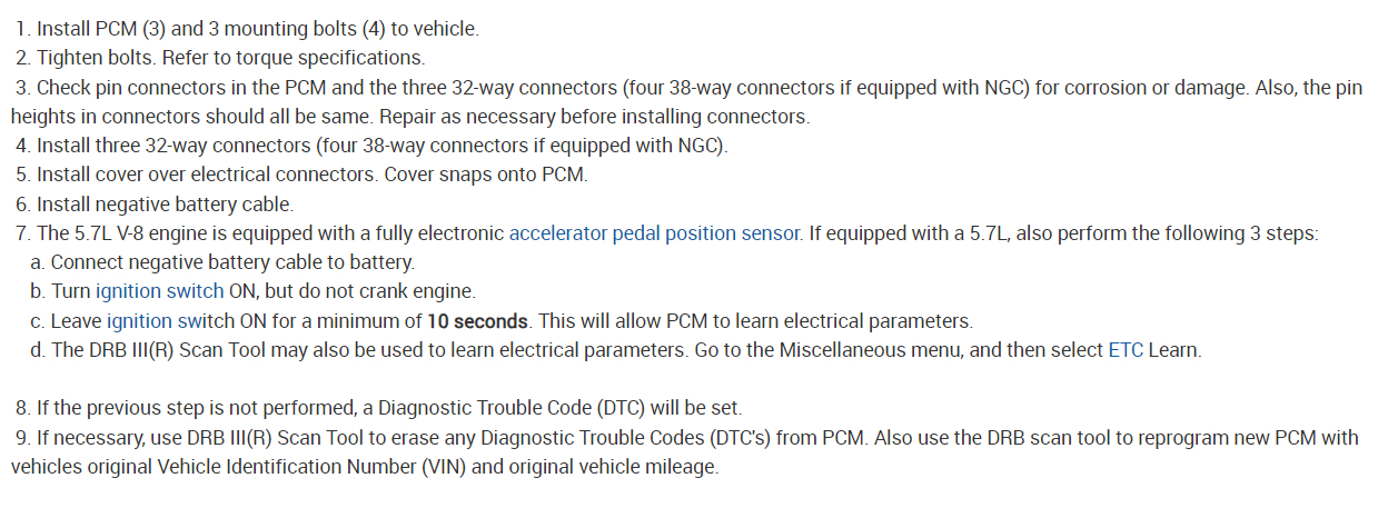

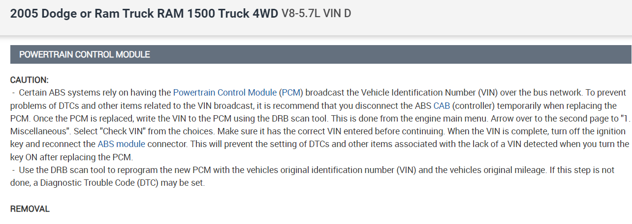

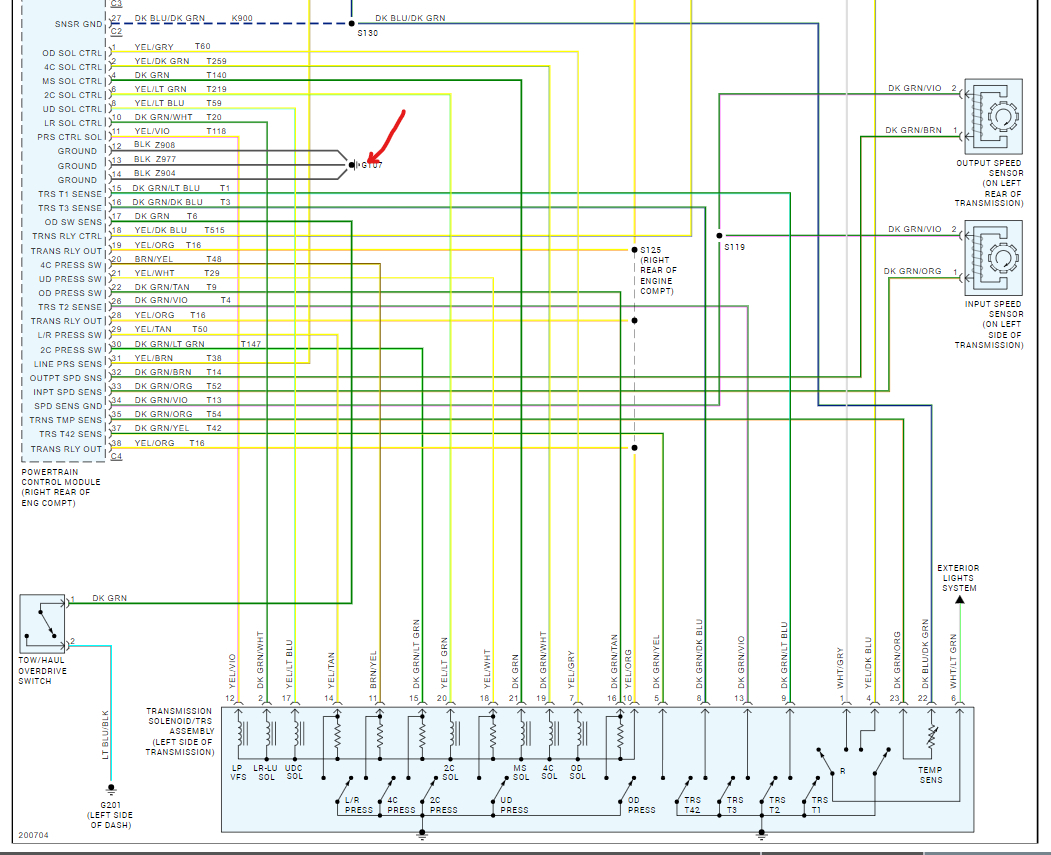

Code P0750 in the context of a 2005 Dodge truck refers to a problem with the "Shift Solenoid A" So are these rebuilt part or used? You may have a bad PCM. Lets check the wiring between the PCM and transmission. This guide will help and if the wiring checks out I would replace the PCM, I marked the ground to be checked as well, you can get a preprogrammed unit by searching Google or Ebay.
