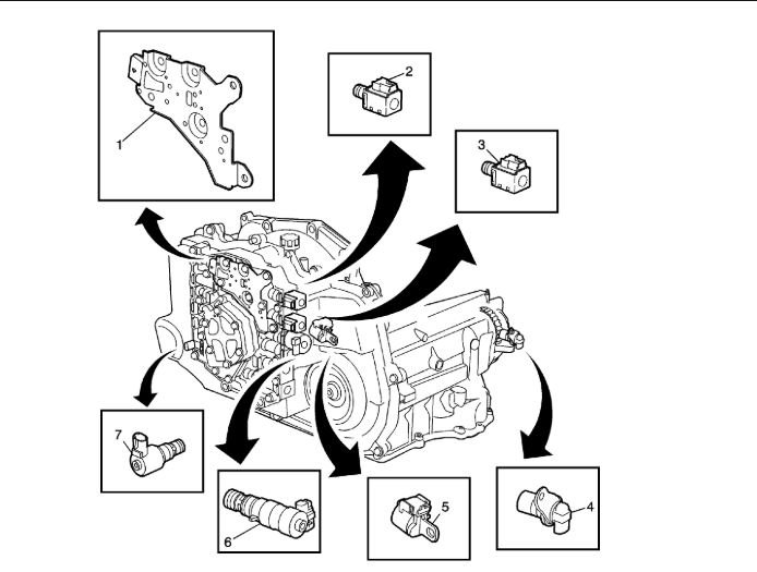

I am replacing the two to three shift solenoid, but I need to know, from the top of the transmission to bottom, how the solenoids are numbered. I believe I know, but I want to be absolutely sure. Thanks!
Oct 9, 2018 at 7:11 AM
Good morning.
Below is the identification and attached is the solenoid arrangement.
1 - Automatic Transmission Fluid Pressure (TFP) Manual Valve Position Switch
2 - 1-2 Shift Solenoid (SS) Valve
3 - 2-3 Shift Solenoid (SS) Valve
4 - Vehicle Speed Sensor (VSS)
5 - Automatic Transmission Input Shaft Speed (ISS) Sensor
6 - Pressure Control (PC) Solenoid Valve
7 - Torque Converter Clutch (TCC) Pulse Width Modulation (PWM) Solenoid Valve

So, which one is Shift Solenoid A?
Oct 9, 2018 at 10:40 AM
The one marked 2-3 shift valve as you requested. Number 3.

It was also throwing up a code about shift solenoid A. So, which one is that?
Oct 9, 2018 at 1:32 PM
What is the code?
Please include as much information as you can.
Oct 9, 2018 at 1:34 PM
RILEYATKINSON2
  • 5 POSTS
It is code P0973- Shift Solenoid A Control Circuit Low.
Oct 9, 2018 at 1:39 PM
Possible issues attached. You will need to do electrical testing.
P0973
Descriptor
Probable Causes
1-2 Shift Solenoid
1-2 Shift Solenoid Valve Control Circuit Open or High Resistance
1-2 Shift Solenoid Valve Control Circuit Short to Ground
2-3 Shift Solenoid Valve
ECM/TRANS Fuse
Ignition 1 Voltage Circuit Open or High Resistance
Ignition 1 Voltage Circuit Short to Ground
Torque Converter Clutch Pulse Width Modulated (TCC PWM) Solenoid
Transmission Control Module (TCM)
Transmission Internal Harness Assembly
