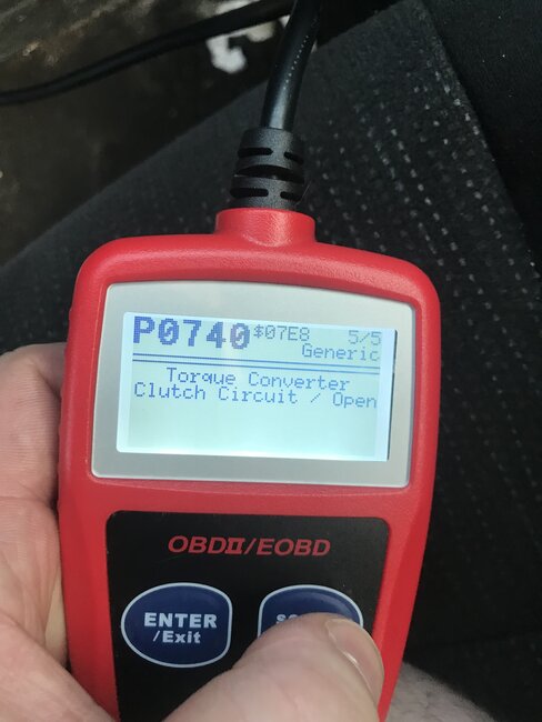

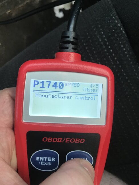

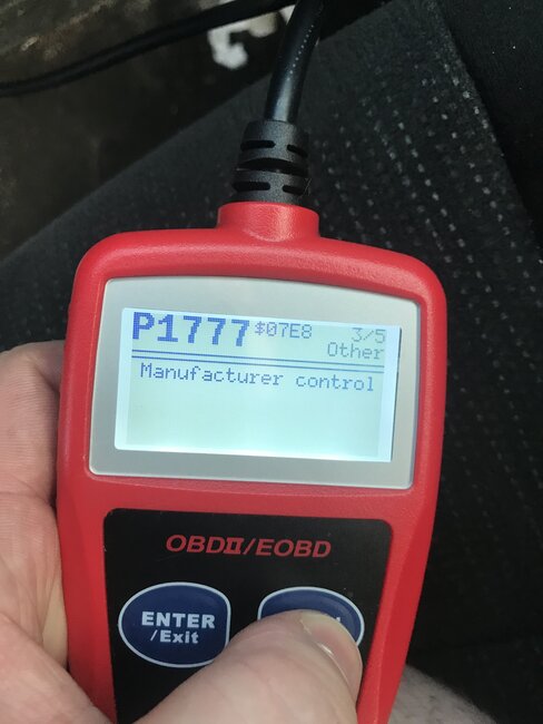

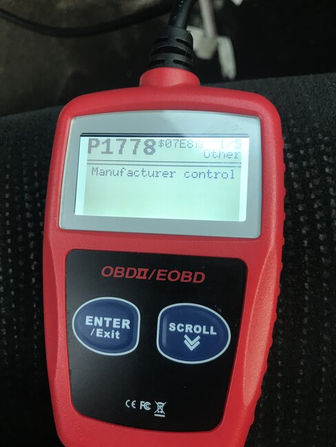

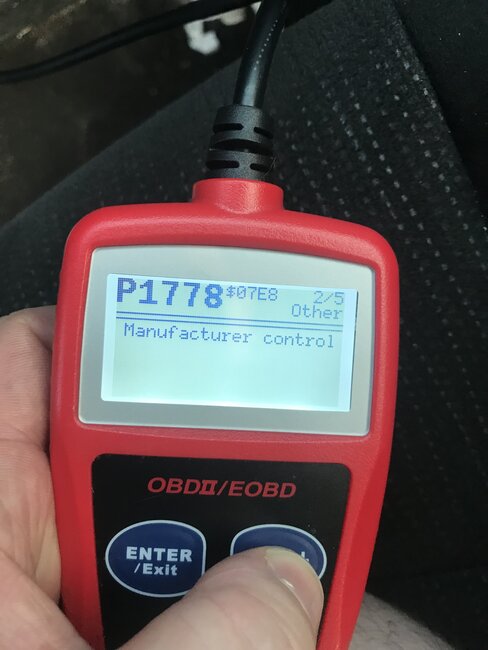

I need to know what these codes are and how to fix it! I have attached pictures.
Jun 10, 2023 at 7:50 AM
  • 55,433 POSTS

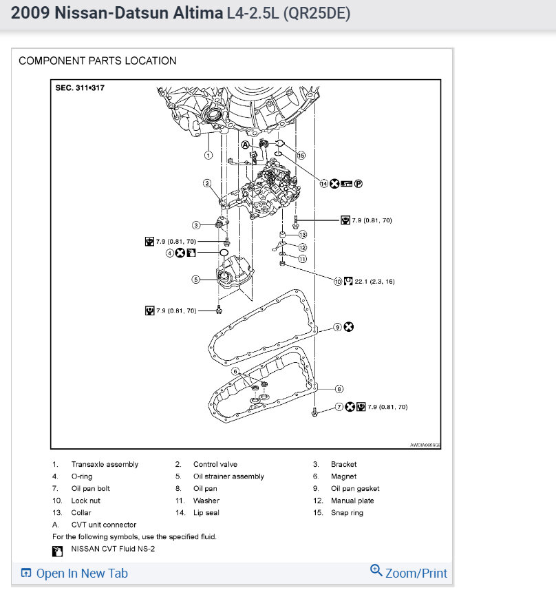

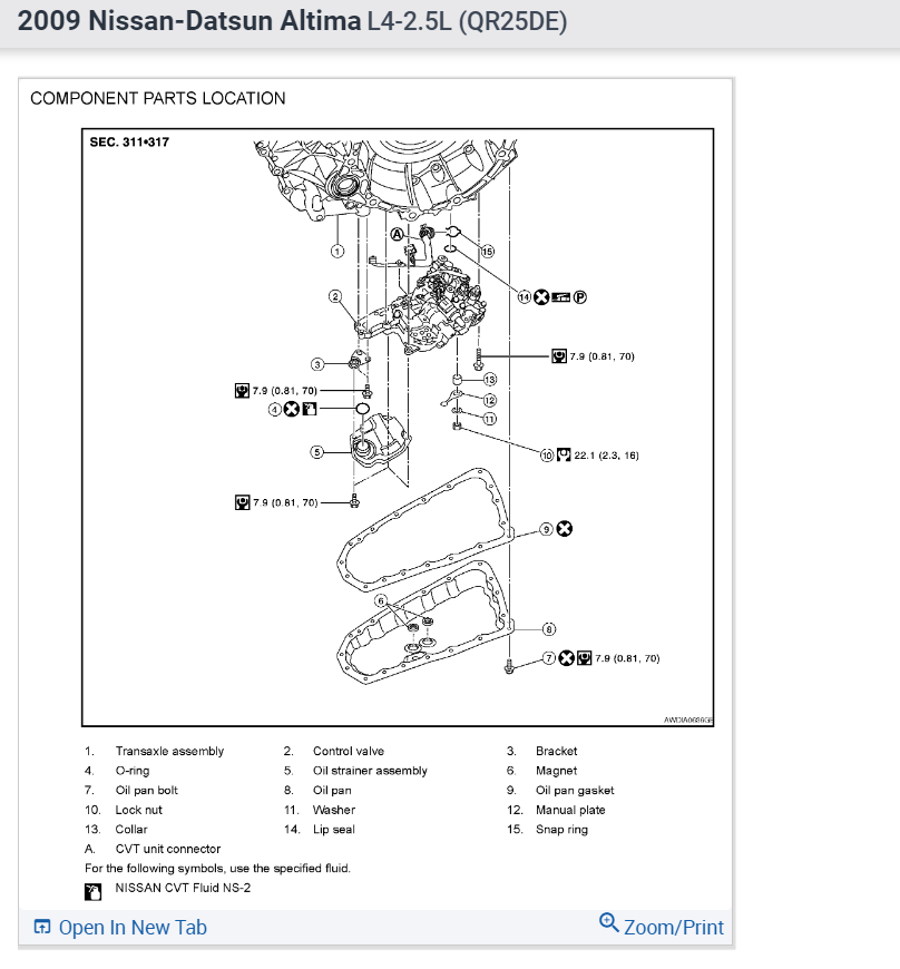

The P1740 code in a 2010 Nissan Altima refers to a problem with the torque converter clutch solenoid circuit. Here is the how to change the valve body out and clear the codes once the repair is complete. Check out the images (below). Please let us know what happens.

  • 55,433 POSTS
There might be but our information does not show individual parts, I would contact the dealer to see if they can get parts individually.

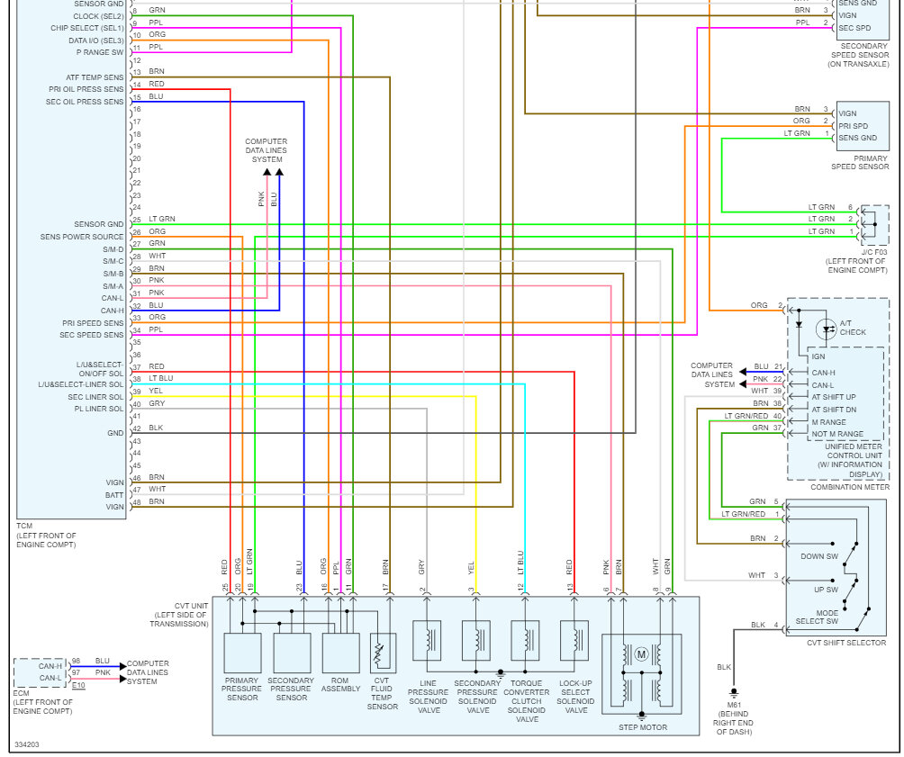

Where is the solenoid converter clutch located the solenoid? Is there a possibility the harness is bad or not making a connection good.

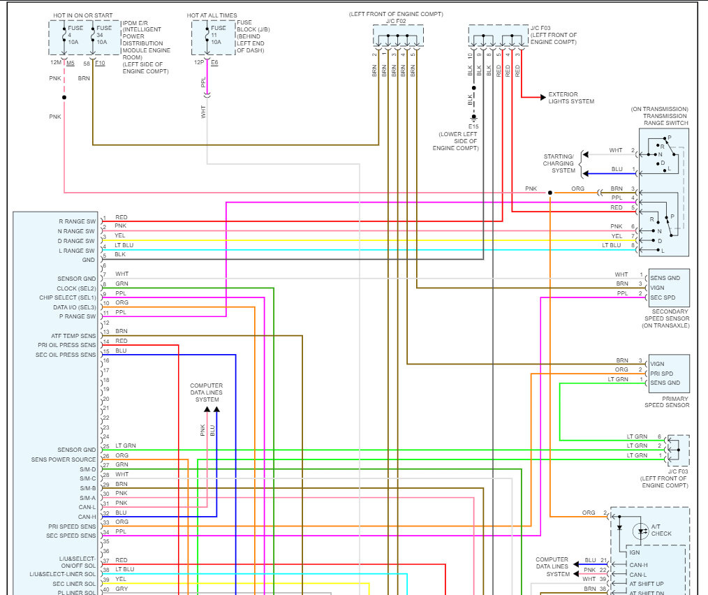

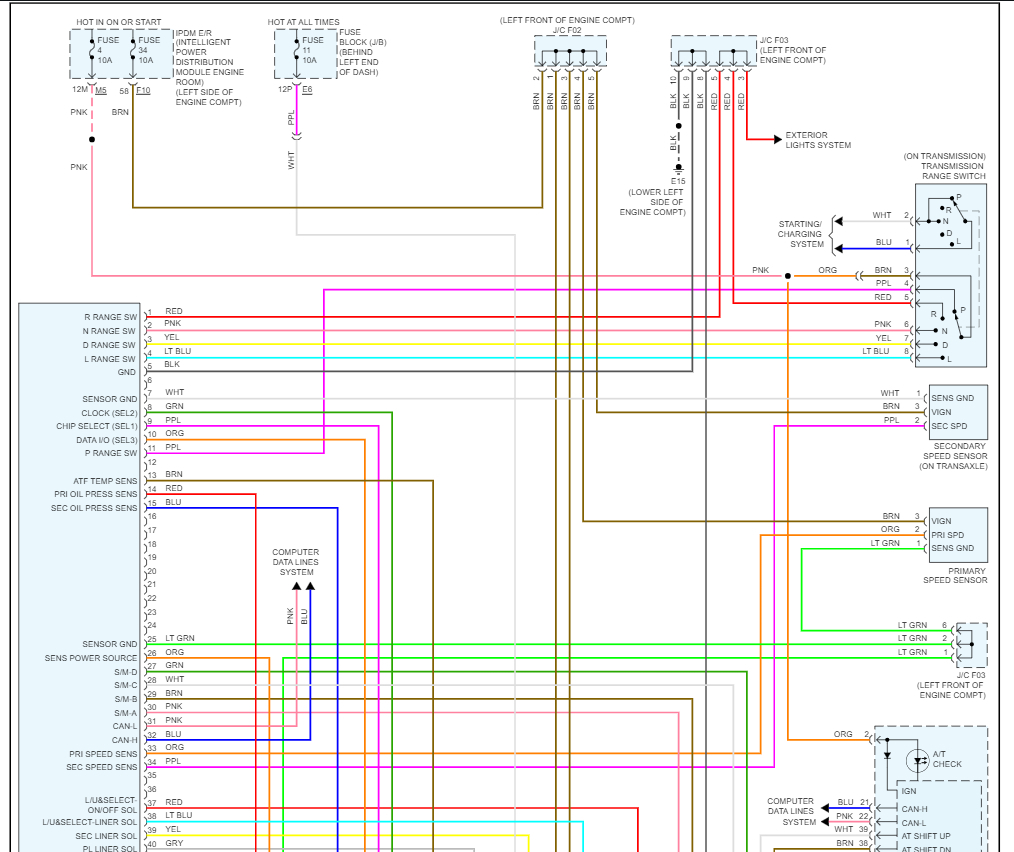

  • 55,433 POSTS
The TCC is located on the valve body, and it will have a LT/BLU wire going to it and it is possible the connection is no good which will cause the malfunction. I would check for power at the fuses in the wiring diagrams below, I have included the transmission wiring diagrams so you can see how the system works. You may have an IPDM going out if there is no power at the fuses.

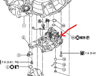

  • 41 POSTS

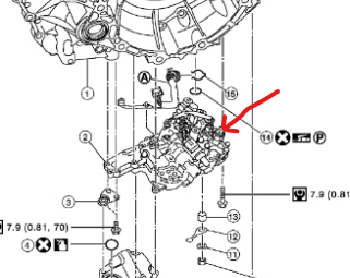

Where is the torque converter clutch solenoid located?

  • 41 POSTS
Can you explain that diagram please where am I supposed to look?
Jun 24, 2023 at 6:43 AM
  • 55,433 POSTS
The part I have a red arrow to is the valve body it will be in there.
