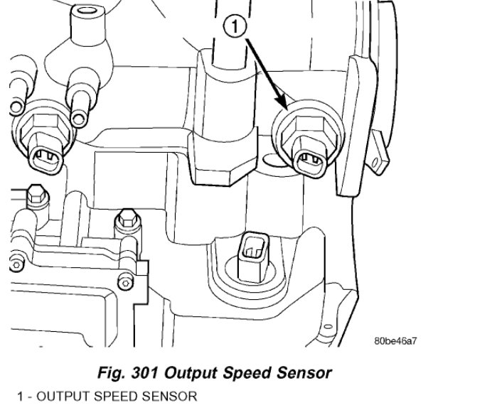

Transmission will sporadically downshift when in high (fourth) gear, momentarily, with or without cruise control. No check engine light comes on. I added some K&W Trans-X slip-stop which helped sluggish shifting but did nothing for downshift problem. Rpm's do not jump too much while this happens.

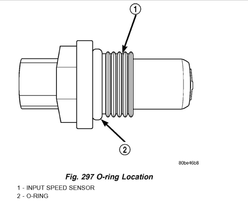

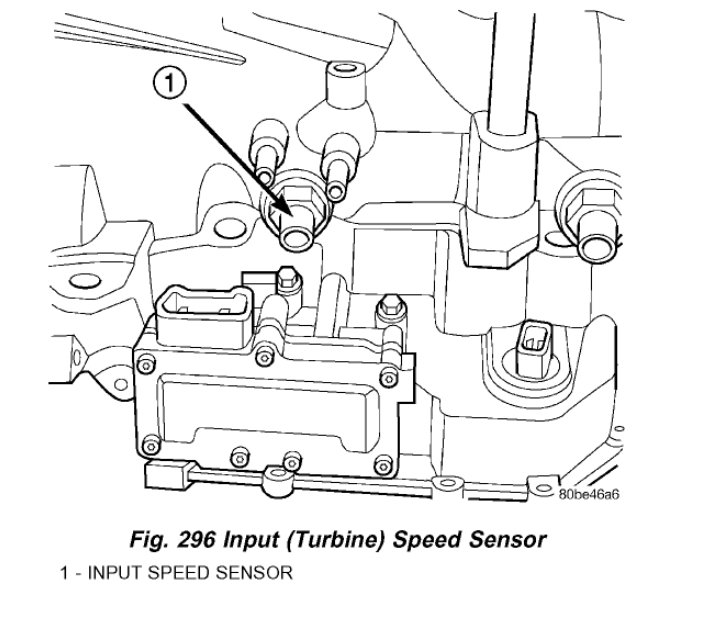

"My car has about 180000 miles on it so probably needs a tuneup." I like to make sure the car is up on its service so we don't chase your tail this is why I suggested it.
It is starting to sound like a shaft speed sensor can be causing the problem. When these go out they may or may not trigger a check engine light.
Here are there locations (below)
