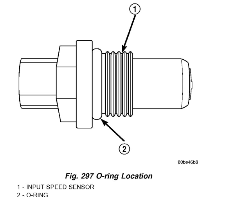

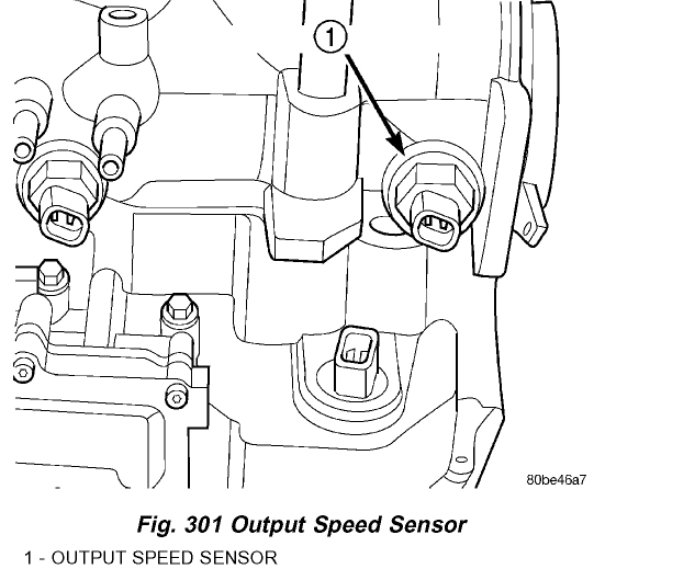

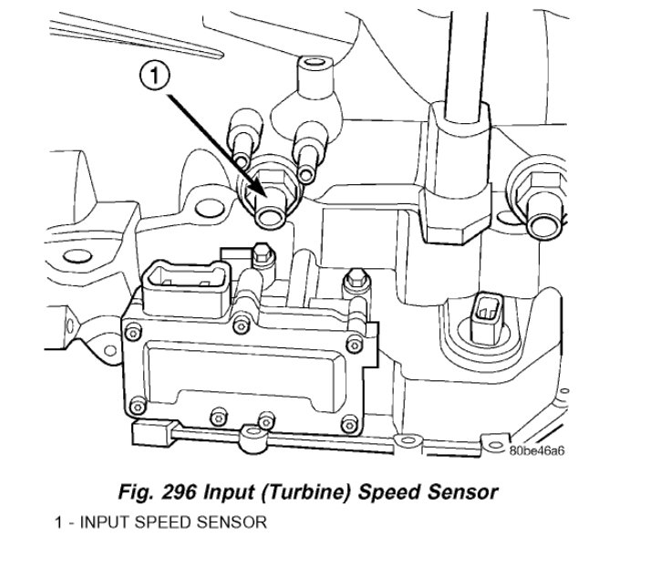

It is starting to sound like a shaft speed sensor can be causing the problem. When these go out they may or may not trigger a check engine light.
Here are there locations (below)
