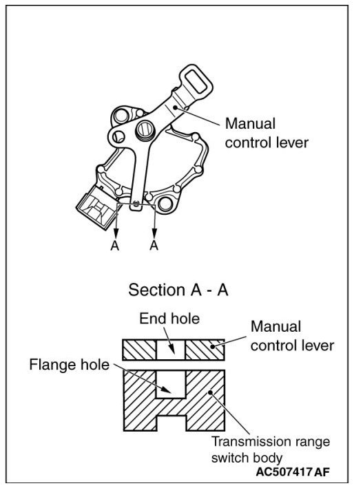

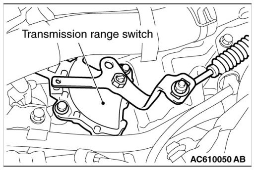

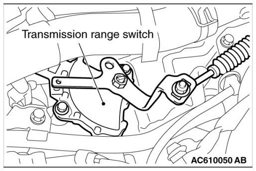

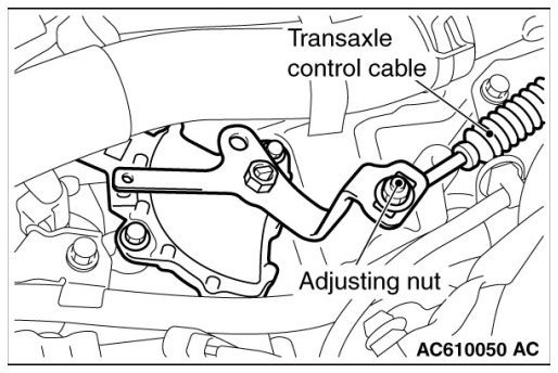

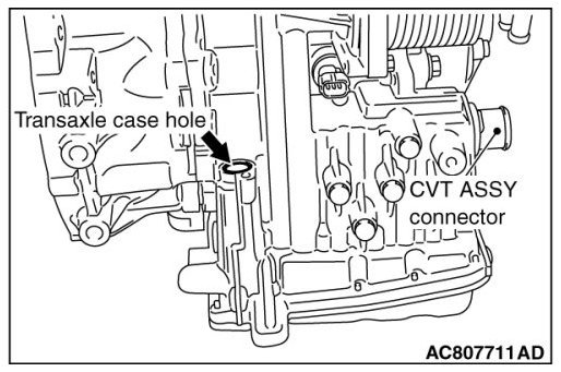

TRANSMISSION RANGE SWITCH AND CONTROL CABLE ADJUSTMENT
1. Move the selector lever to the N range.
2. Loosen the adjusting nut so that the manual control lever moves freely.
3. Move the manual control lever to Neutral position.
Picture 1
4. Align the hole at the end of the manual control lever and the hole in the transmission range switch body flange (section A - A).
NOTE:
Insert a dia.5 bar into the aligned holes in the transmission range switch body flange and on the tip of the manual control lever to position the transmission range switch body.
Picture 2
5. Use the adjusting nut to tighten the transaxle control cable to the specified torque.
Tightening torque: 9.5 ± 3.5 Nm (84 ± 30 in-lb)
6. Make sure that the selector lever is in the N range.
7. Make sure that the transaxle-side ranges that are corresponding to the transmission range operate and function without fail.

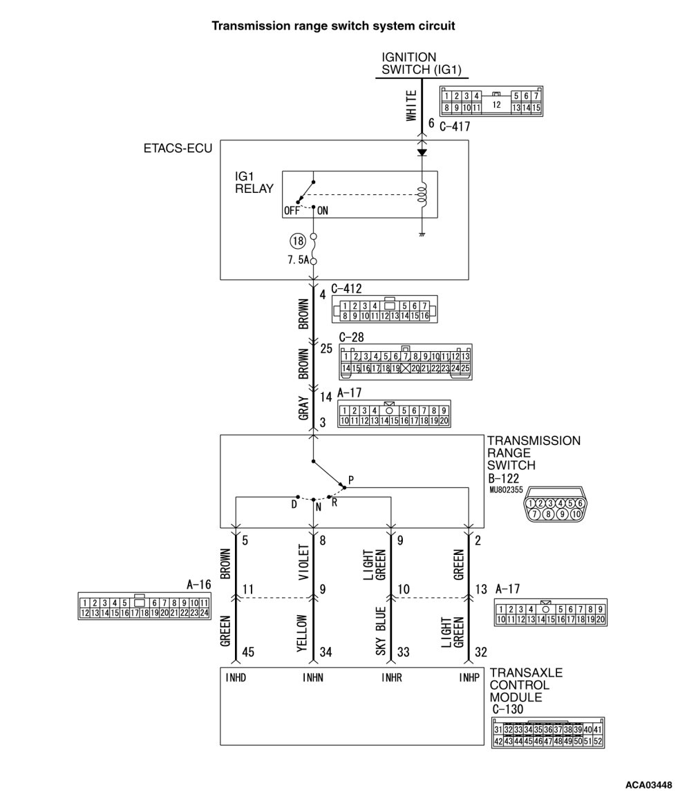

______________________________________________________________

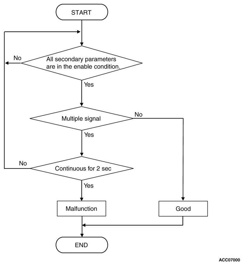

DTC P0705: Malfunction of Transmission Range Switch
Picture 1
Picture 2
Picture 3
Picture 4
Picture 5
Picture 6
DIAGNOSTIC FUNCTION
TCM monitors the signal from the transmission range switch, and determines if the abnormal input is present or not.
DESCRIPTIONS OF MONITOR METHODS
- TCM does not detects the transmission range switch input signal for 5 seconds when the vehicle speed is 1 km/h (0.6 mph) or more for 10 seconds continuously.
- TCM detects the multiple inputs from the transmission range switch for 2 seconds.
MONITOR EXECUTION
- Vehicle speed (no-transmission range switch signal input): 1km/h (0.6 mph) or more for 10 seconds continuously
- Vehicle speed (transmission range switch signal multiple input): No conditions
- Throttle valve opening: 1/8 or more
- Engine speed: 450 r/min or more
MONITOR EXECUTION CONDITIONS (OTHER MONITOR AND SENSOR)
Other Monitor (There is no temporary DTC stored in memory for the item monitored below)
- P0712, P0713: Malfunction of the transmission fluid temperature sensor
- P0715: Malfunction of primary pulley speed sensor
- P0720: Malfunction of secondary pulley speed sensor
- P0725: Malfunction of engine speed
- P0740: Malfunction of lockup solenoid valve
- P0745: Malfunction of line pressure solenoid valve
- P0840: Malfunction of secondary pressure sensor
- P1777: Malfunction of stepper motor
- U0001: Malfunction of CAN communication circuit
Sensor (The sensor below is determined to be normal)
- Primary pulley speed sensor
- Secondary pulley speed sensor
LOGIC FLOW CHARTS (Monitor Sequence-Input Other Rationality)
Picture 7

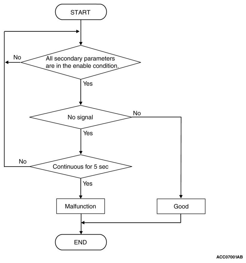

LOGIC FLOW CHARTS (Monitor Sequence-Input Open Circuit)
Picture 8
DTC SET CONDITIONS
Check Conditions
- Vehicle speed over 1 km/h (0.6 mph): 10 seconds or more.
- Throttle position sensor voltage: 1.37 volts or more.
- Engine speed: 450 r/min or more.
- Voltage of battery: 9 volts or more.
- Voltage of battery: 16 volts or less.
Judgment Criteria
- Transmission range switch: multiple signal. (2 seconds)
- Transmission range switch: no signal. (5 seconds)
OBD-II DRIVE CYCLE PATTERN
Transmission range: D (Drive the vehicle for 10 seconds or more while the accelerator opening angle is 20% or more)
PROBABLE CAUSES
- Malfunction of the transmission range switch
- Improper adjustment of transaxle control cable
- Damaged wiring harness and connectors
- Malfunction of TCM
DIAGNOSIS
STEP 1. Scan tool data list
Item 49: Transmission range switch
Check that the service data changes when the selector lever is moved to all ranges.
OK: The service data changes in response to the selector lever operation.
Q. Is the check result normal?
YES Intermittent malfunction
NO Go to Step 2.

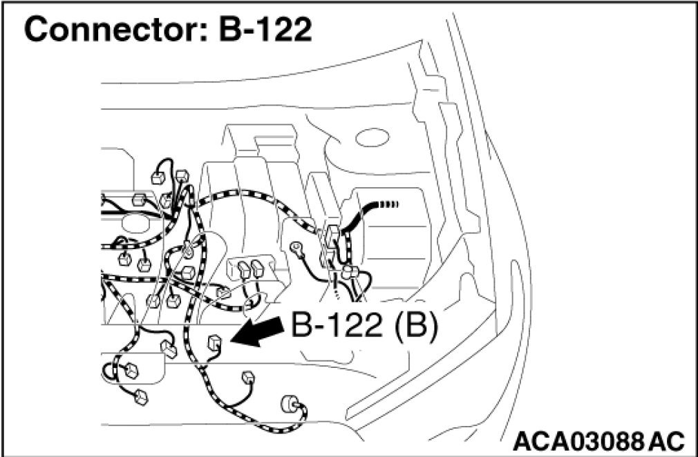

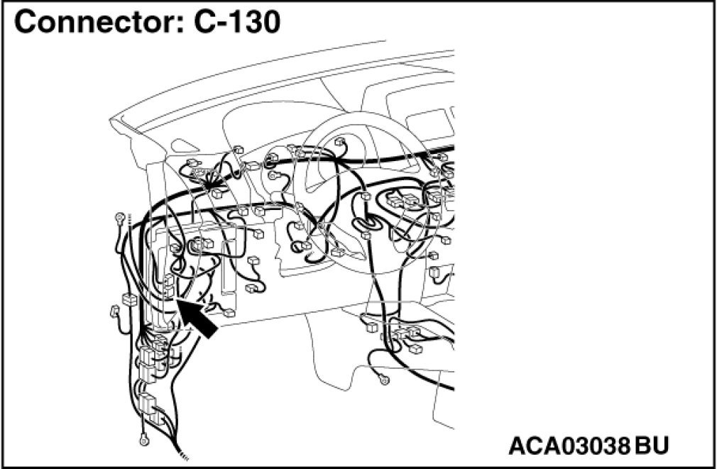

STEP 2. Check the following connector:
- B-122 transmission range switch connector
- C-130 TCM connector
Check the terminals for a contact status problem and internal short circuit.
YES Go to Step 3.
NO Repair the defective connector.

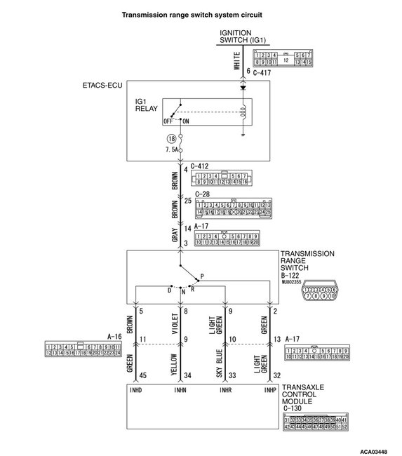

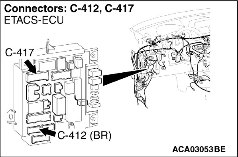

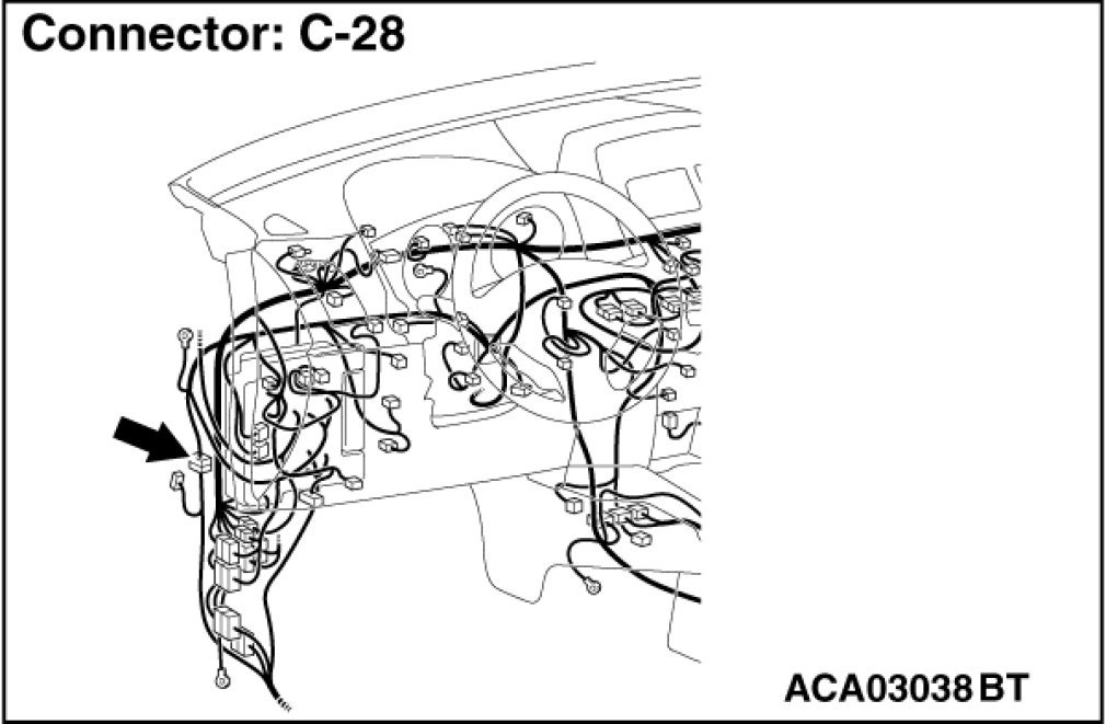

STEP 3. Check for open circuit in wiring harness between the ETACS-ECU connector and the transmission range switch connector
Between the C-412 ETACS-ECU connector (terminal No.4) and the B-122 transmission range switch connector (terminal No.3)
NOTE:
Prior to the wiring harness inspection, check the intermediate connectors C-28 and A-17, and repair that if necessary.
YES Go to Step 4.
NO Repair the wiring harness.

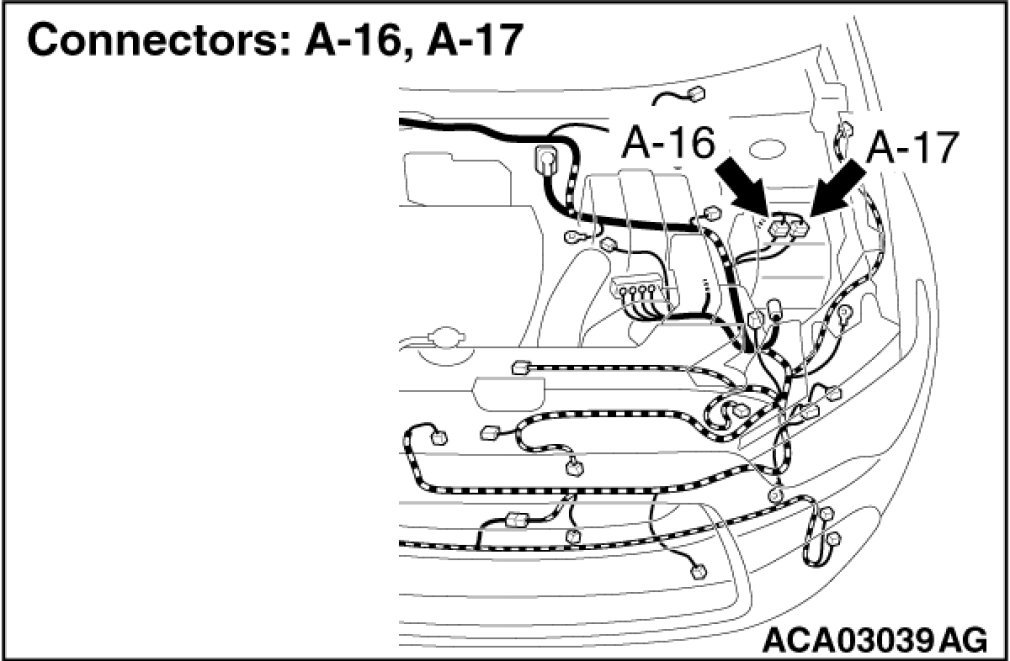

STEP 4. Check for open circuit in the wiring harness between the transmission range switch connector and the TCM connector
- Between B-122 transmission range switch connector (terminal No.2) and C-130 TCM connector (terminal No.32)
- Between B-122 transmission range switch connector (terminal No.5) and C-130 TCM connector (terminal No.45)
- Between B-122 transmission range switch connector (terminal No.8) and C-130 TCM connector (terminal No.34)
- Between B-122 transmission range switch connector (terminal No.9) and C-130 TCM connector (terminal No.33)
NOTE:
Prior to the wiring harness inspection, check the intermediate connectors A-16 and A-17, and repair that if necessary.
YES Go to Step 5.
STEP 5. Transmission range switch and control cable adjustment
Refer to See: Transmission Position Sensor/Switch, CVT > Adjustments > Transmission Range Switch and Control Cable Adjustment.
YES Go to Step 6.
NO Adjust the transmission range switch and control cable.

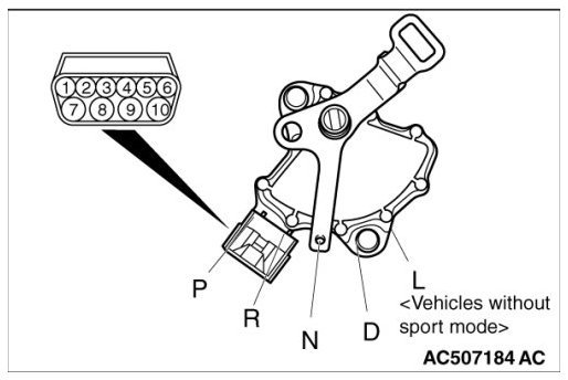

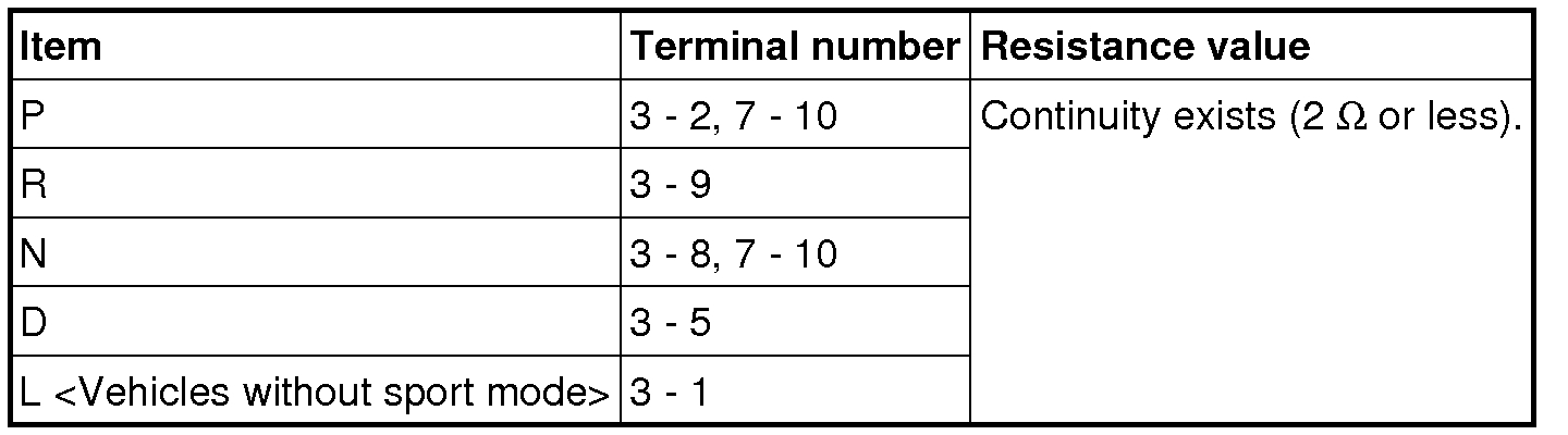

STEP 6. Transmission range switch continuity check
Refer to See: Transmission Position Sensor/Switch, CVT > Procedures > Transmission Range Switch Continuity Check.
YES Go to Step 7.
NO Replace the transmission range switch.
STEP 7. Symptom recheck after erasing diagnostic trouble code
NO Replace TCM.
Let me know if this helps.

Hi, continuity test for TRS (P,R,N,D ) was performed and results for all status equal 0.8 ohm,also continuity test from connector: B122 to connectors: A16,A17 was performed and there is no defect or loose connection.
I think TRS is good. Connectors is good.

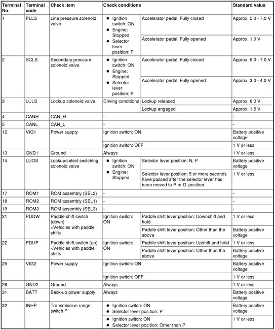

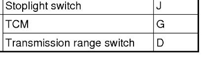

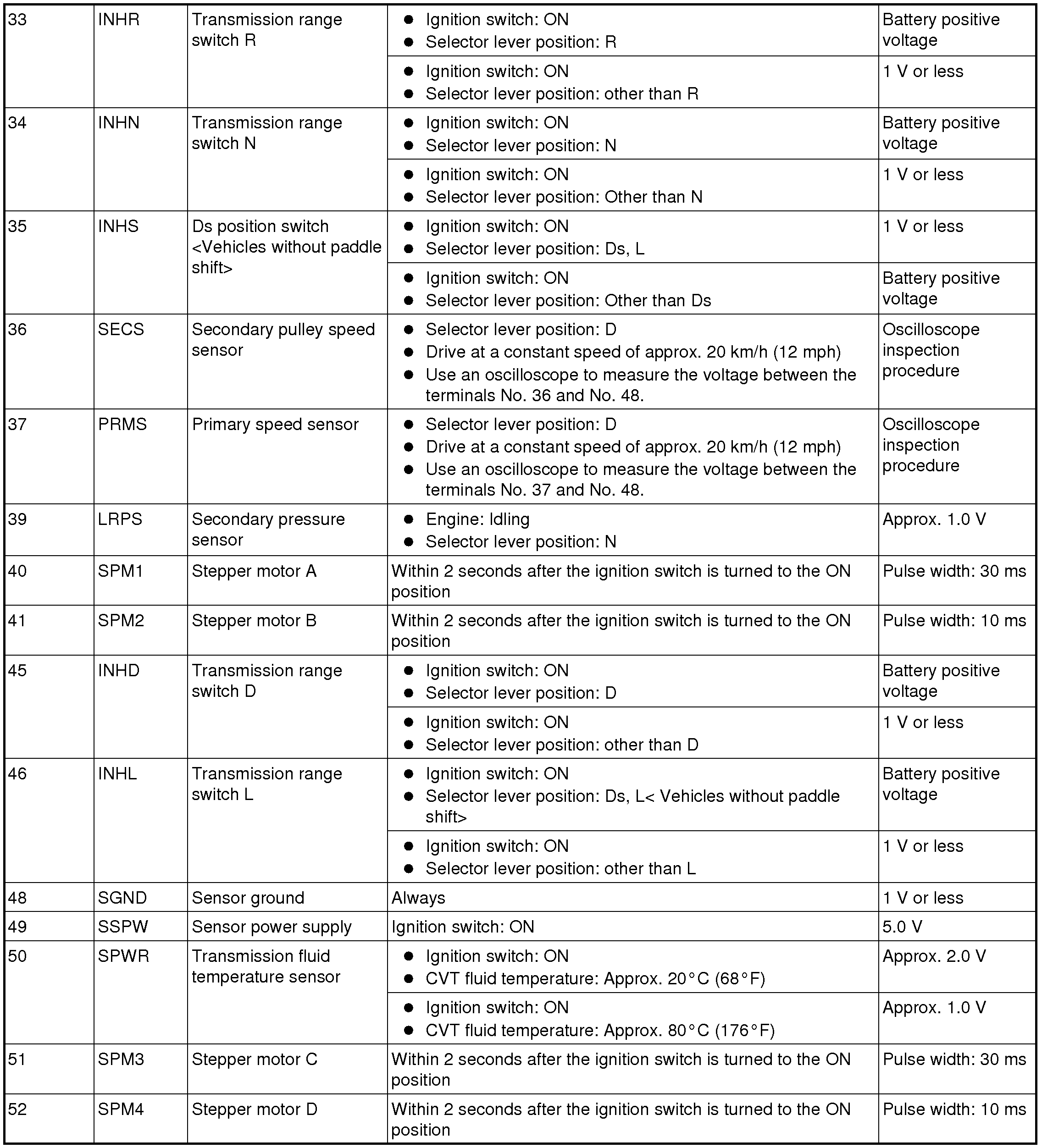

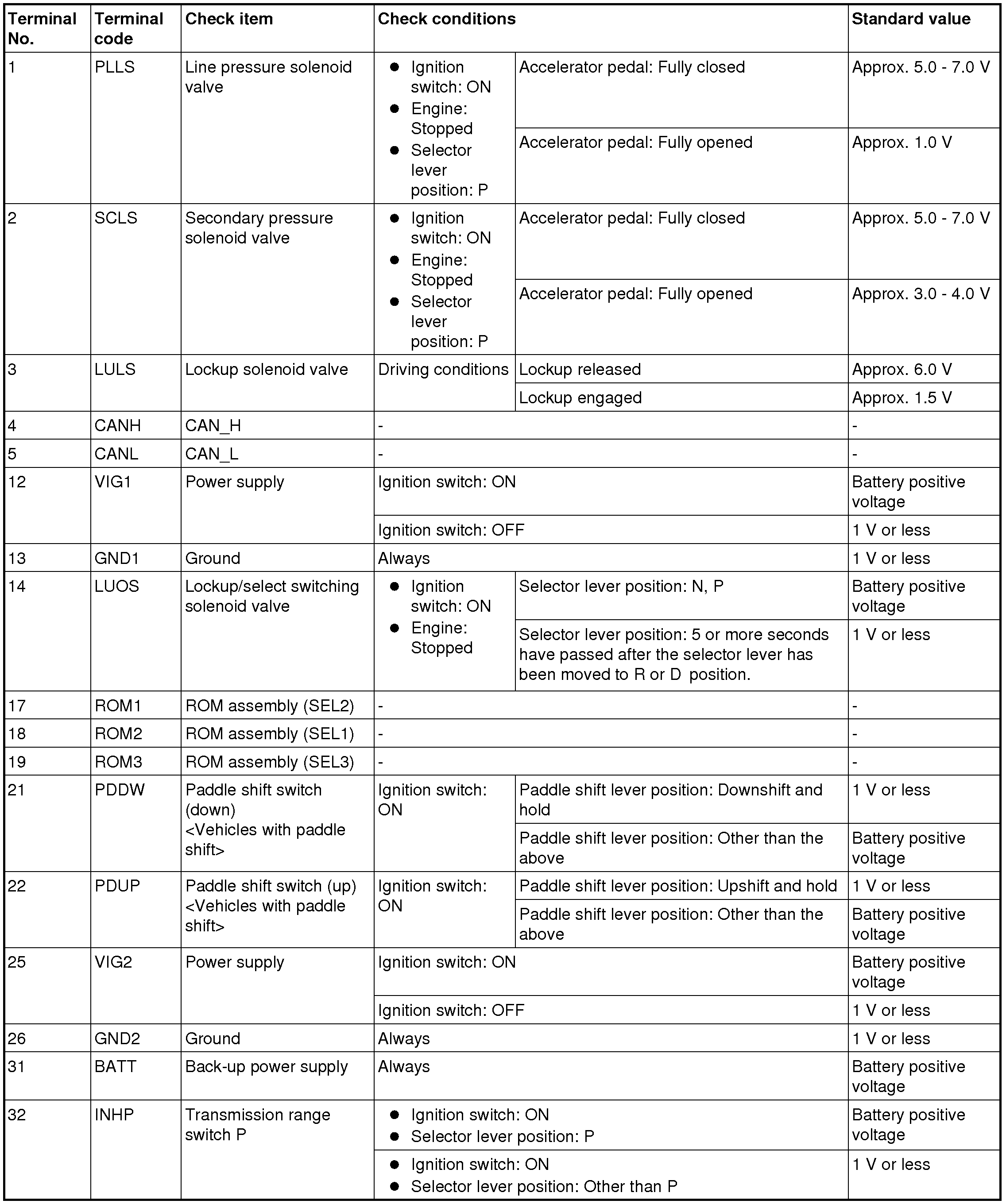

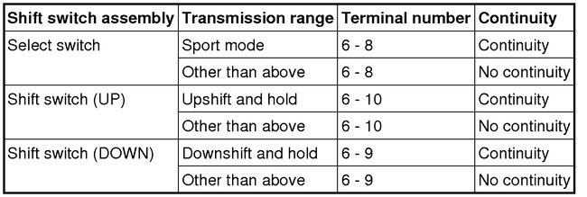

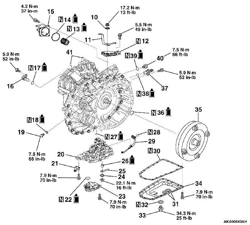

Please explain how to test the TCM or valve body with exploded view drawing.
Mar 27, 2019 at 4:21 AM
  • 110,244 POSTS
The directions for testing and checking the TCM are all in the attached picture.
Mar 27, 2019 at 12:43 PM

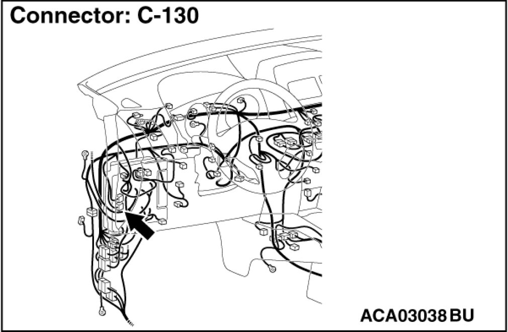

PETROYADA
  • 66 POSTS

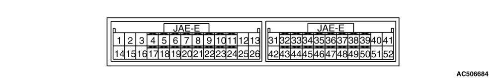

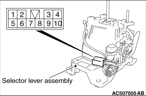

Where is location for terminal?
Could you please send location?
What meaning for battery positive voltage?
Do you mean 12 volts?
Mar 27, 2019 at 5:02 PM
  • 110,244 POSTS
Welcome back:
The terminal is plugged into the TCM. As far as location, see picture 1. Battery voltage is just that, 12 volts.

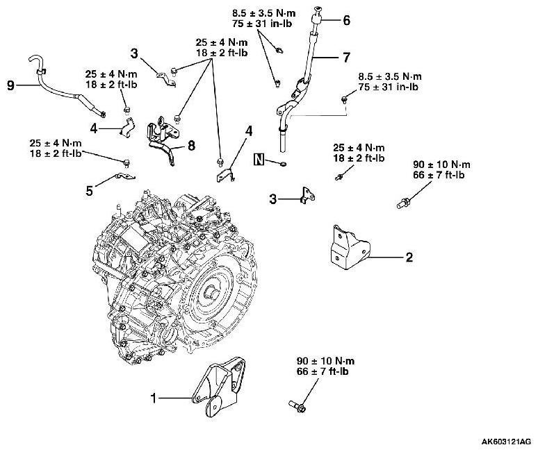

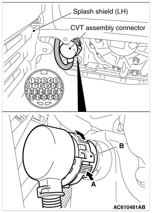

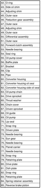

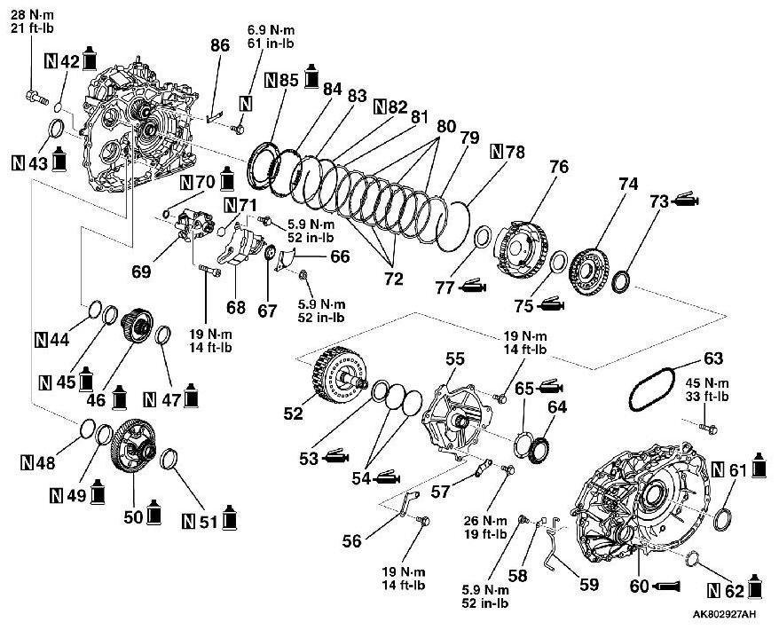

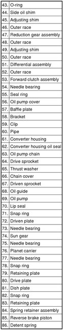

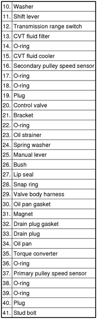

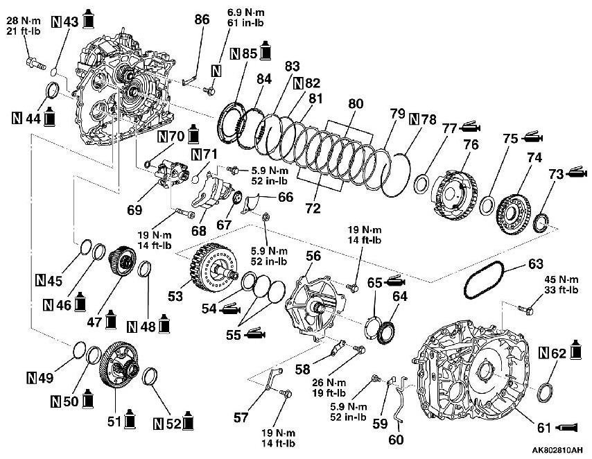

PETROYADA

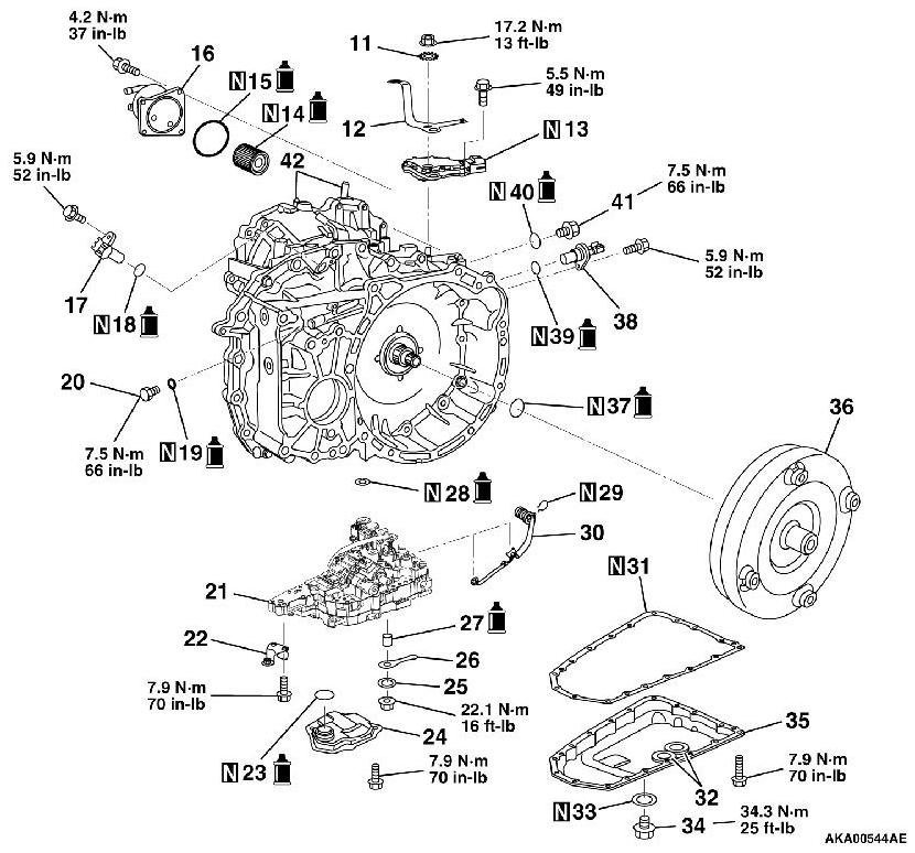

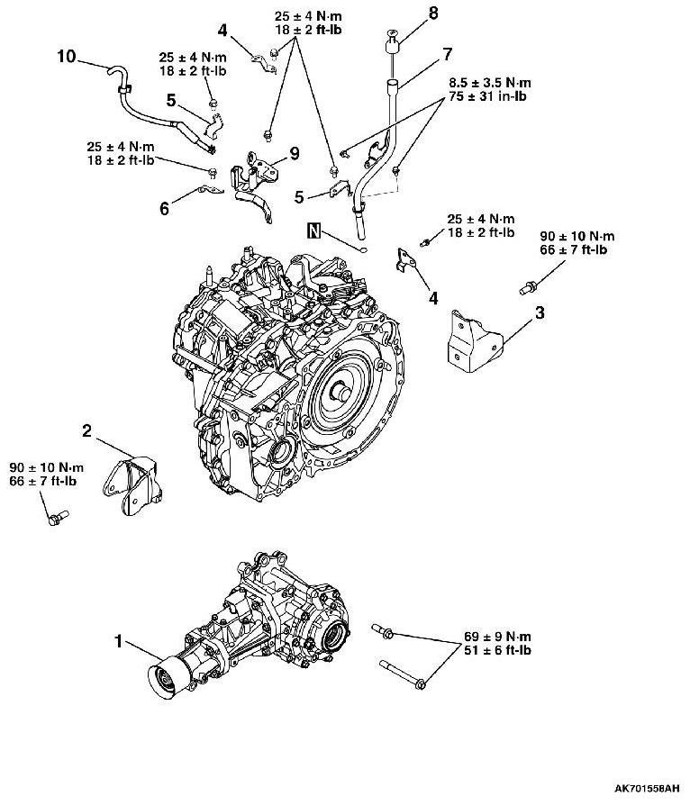

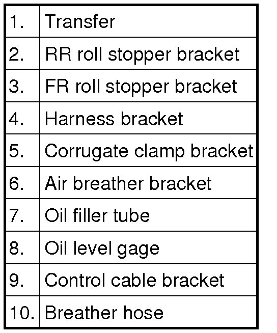

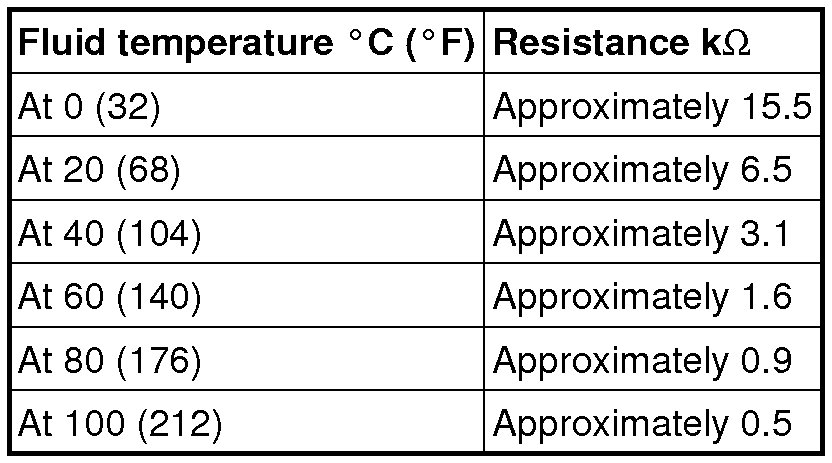

  • 66 POSTS
Dear,
Could you please send to me exploded drawing for CVT gear box?
In start up less than 5 km/h gear box has noise, and after 5 km/h, its normal.
Mar 31, 2019 at 10:53 PM
  • 110,244 POSTS
Welcome back:
I attached all components and the legends with descriptions. First you will see a picture. The legend which follows each picture correlates with the picture.
Apr 1, 2019 at 10:05 AM

  • 110,244 POSTS
Welcome back:
Most all sensors are checked by testing for resistance. Here is a link that shows how to use a multi meter:
What sensor in particular do you want to test? There are sensors everywhere. lol Also, is there any way you could record the noise and upload it? I would be more than likely able to tell if it is from a sensor or not.

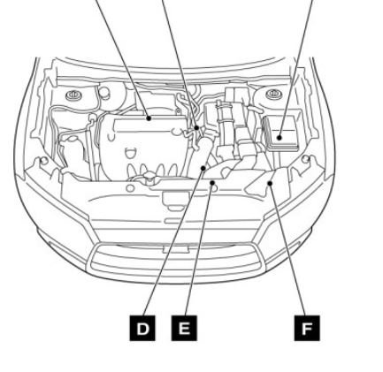

  • 110,244 POSTS
Welcome back:
I have attached information for testing all sensors / switches related to the CVT transmission. The first two are related to the shifter switch. Pictures 3,4, and 5 are for the range sensor. The next 4 pics are related to speed sensors and provide locations. The last three pics are for the CVT temp sensor. Here are the directions for testing.
TRANSMISSION FLUID TEMPERATURE SENSOR CHECK
pic 6
1. While pressing A in the figure, turn B counterclockwise to unlock the CVT assembly connector, and disconnect the connector.
pic 7
2.
CAUTION:
Insert a thermometer which is made of metal or is put in a metal case (overall length: approximately 150 - 200 mm) into the transaxle case hole approximately 80 mm.
Remove the oil filler tube assembly (Refer to Transaxle Assembly), and insert a thermometer into the transaxle case hole.
NOTE:
If a radiation thermometer (noncontact thermometer) is available, use it to measure the surface temperature of the oil pan.
3. Measure the resistance between the sensor-side connector terminal No.17 of the CVT assembly connector and ground (terminal No.19).
Standard value:
pic 8
NOTE:
In the information screen on the multi-information display, the fluid temperature warning comes on when the transmission fluid temperature is approximately 140°C (284°F) or higher, and automatically goes out when the transmission fluid temperature dropped below approximately 137°C (279°F).
4.
CAUTION:
The transmission fluid temperature sensor cannot be removed or replaced as a single unit. When the transmission fluid temperature sensor needs to be replaced, replace the valve body assembly.
When the resistance of the transmission fluid temperature sensor is outside the standard value, and the fluid temperature warning comes on/goes out at other than the specified temperatures, replace the valve body assembly and the harness.
Let me know if they help.
