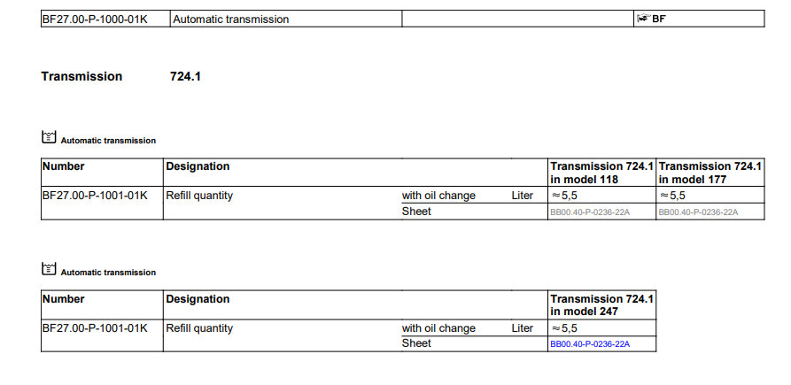

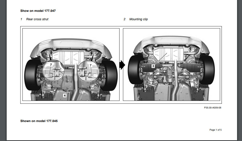

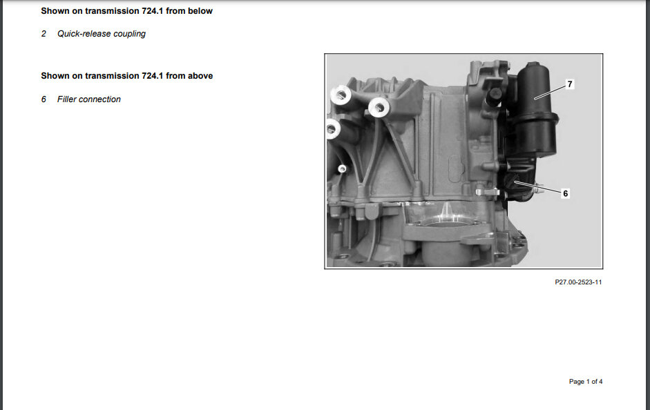

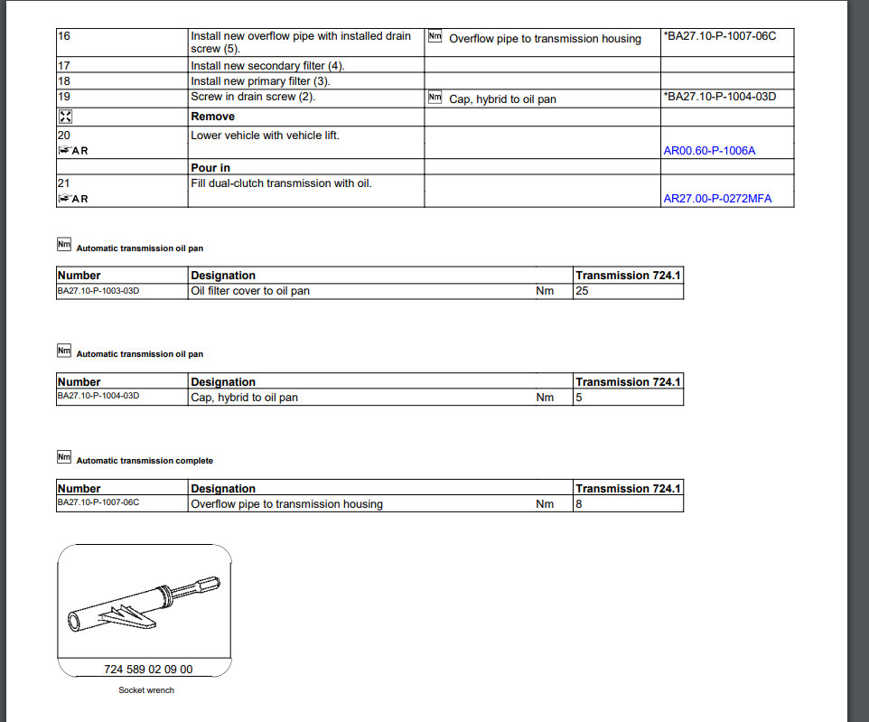

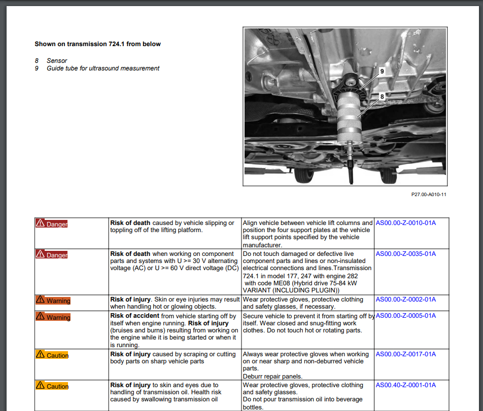

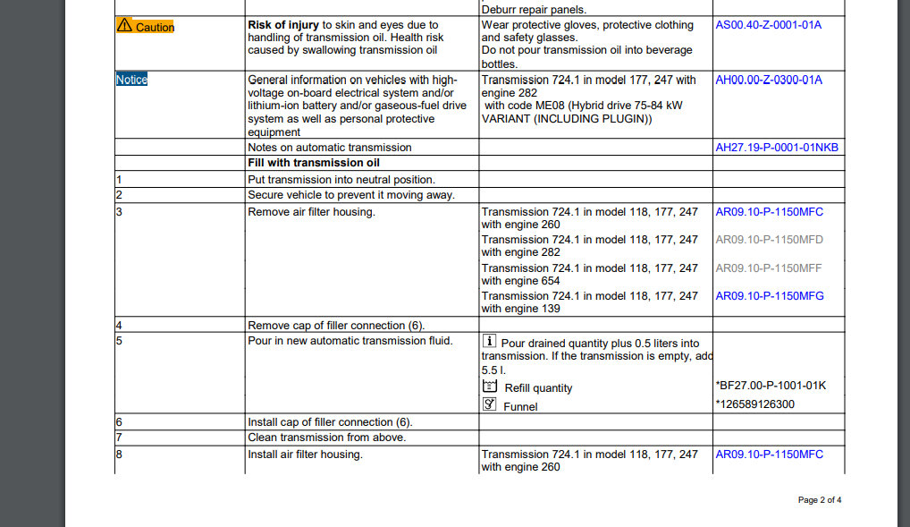

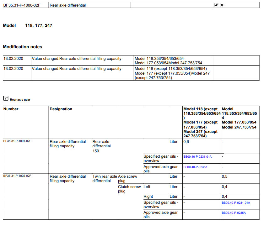

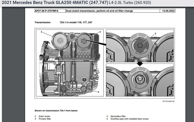

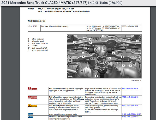

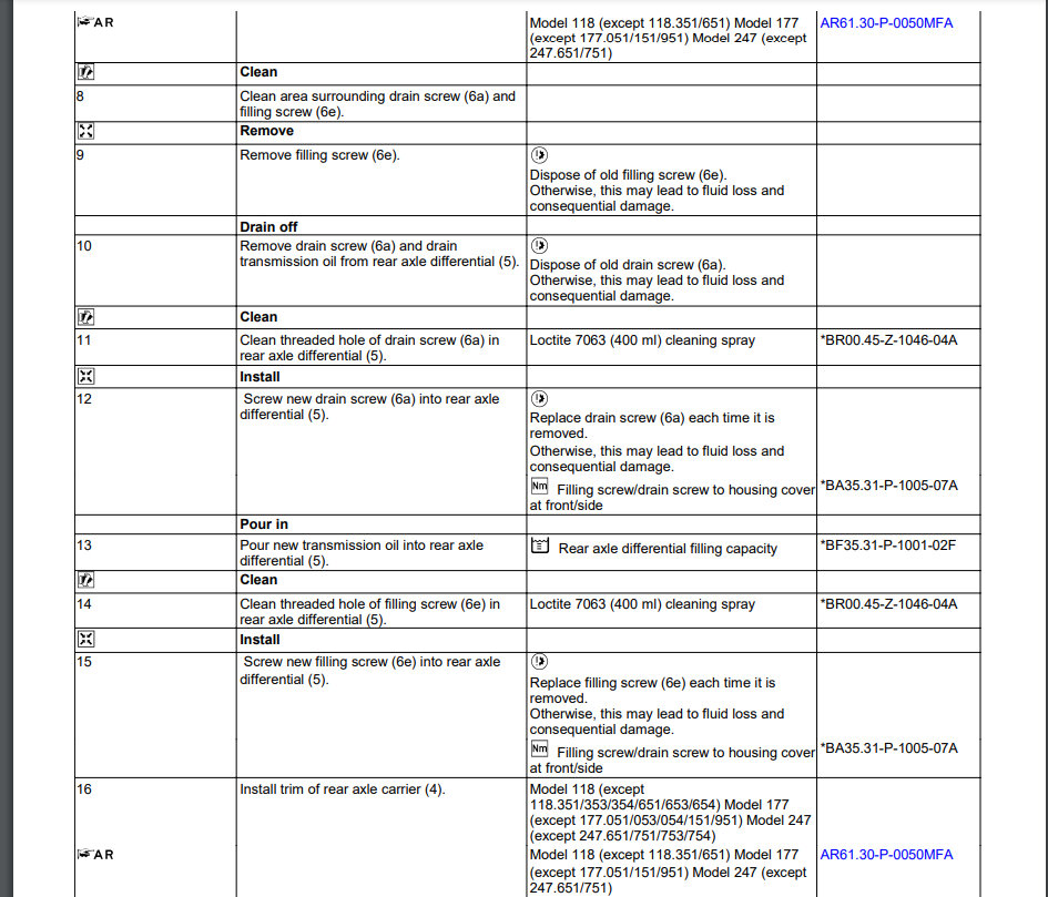

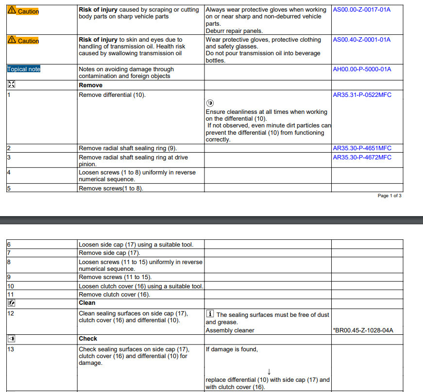

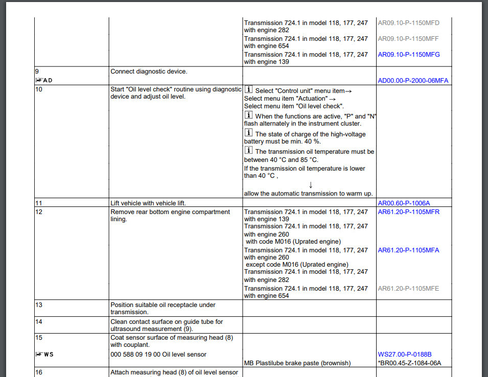

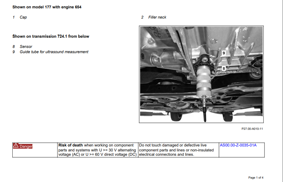

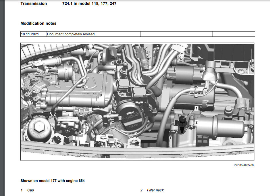

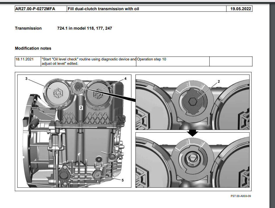

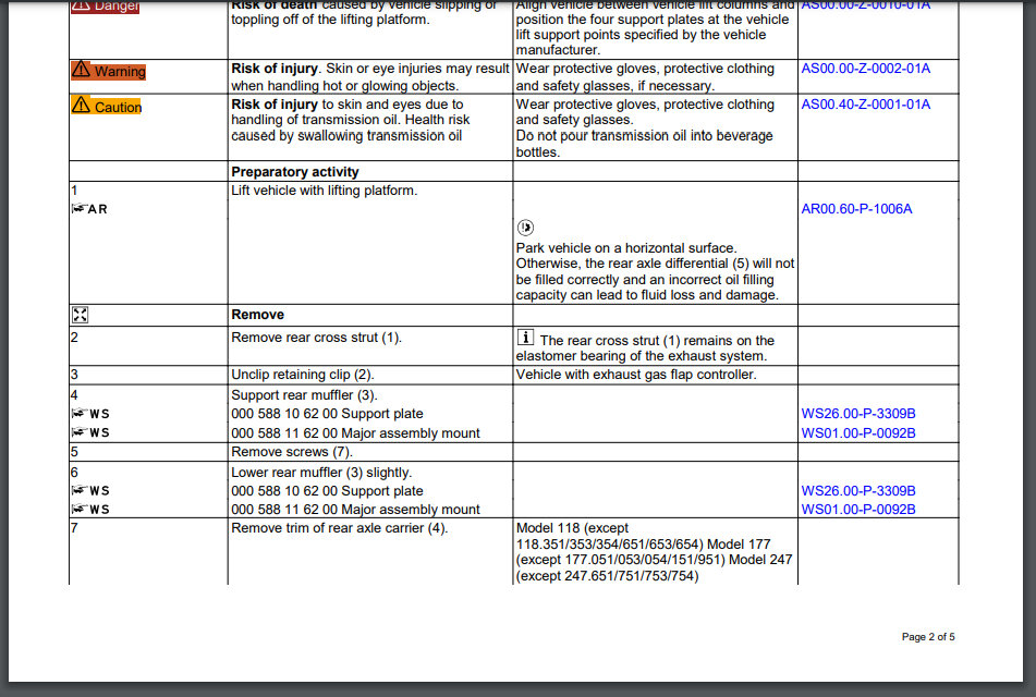

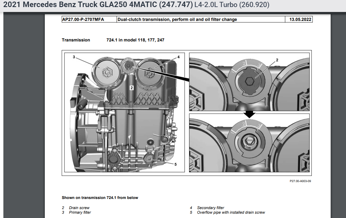

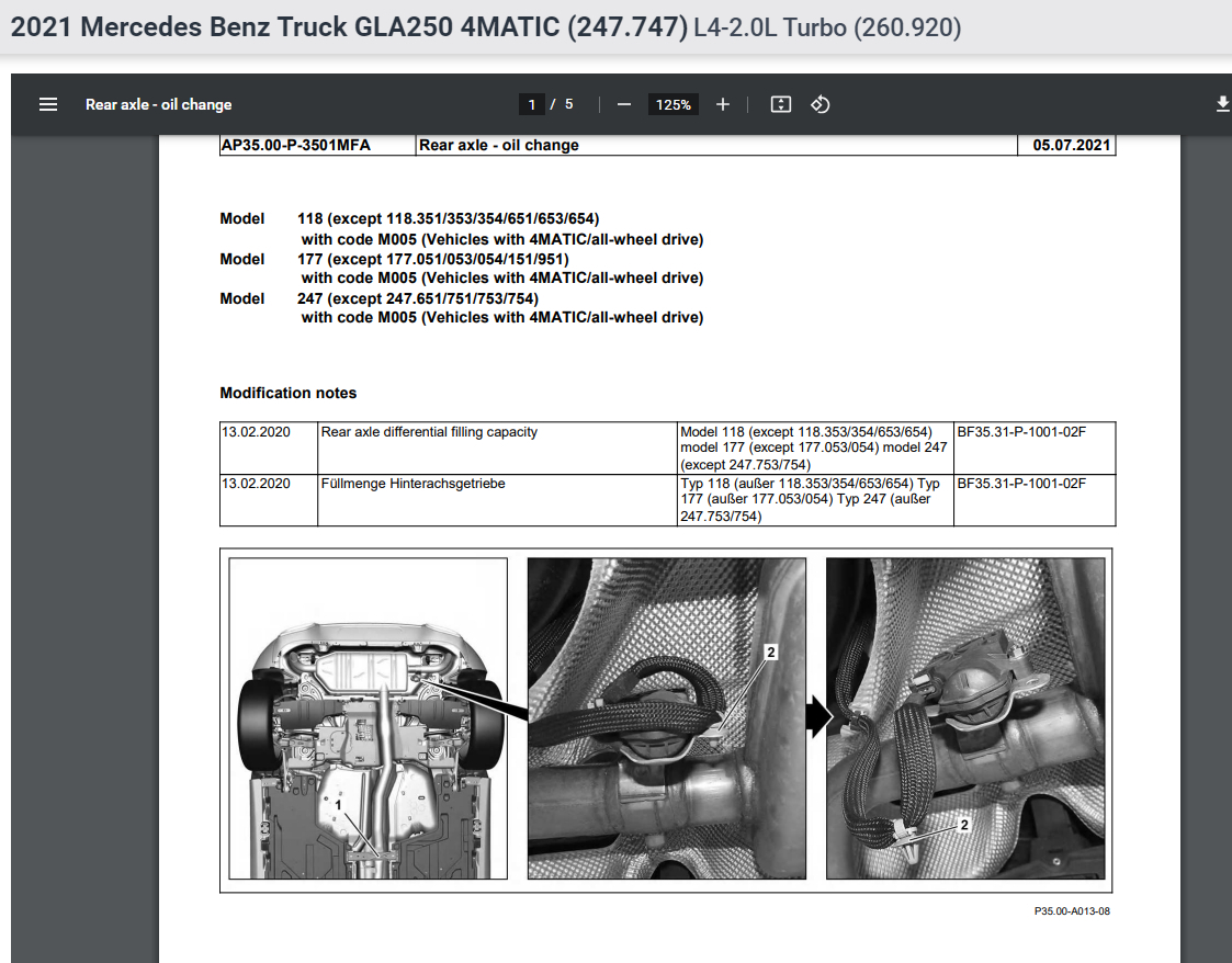

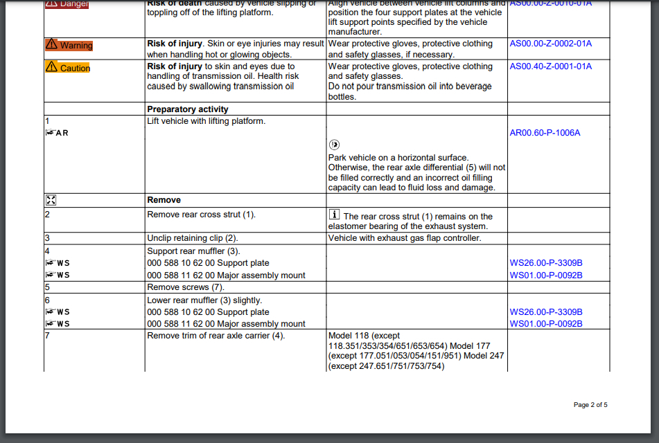

I have a 2021 GLA 45 AMG it’s due for a transmission service and rear differential fluid.

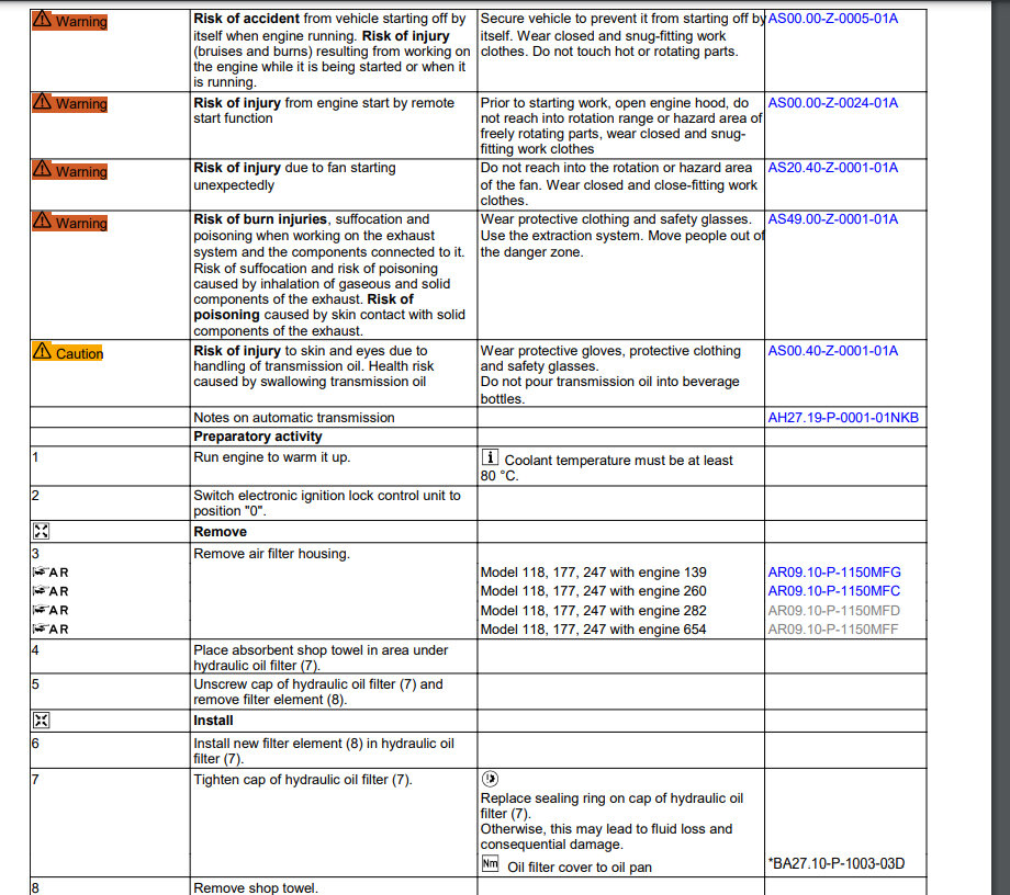

I believe the transmission has to be brought up to a certain temperature for the ATF liquid flow all over the transmission.
VIN W1N4N5DBXMJ216572
I was wondering if there was video or step by step PDF that could help to get the job done. I appreciate your assistance.
Jun 23, 2023 at 10:45 PM
  • 55,456 POSTS

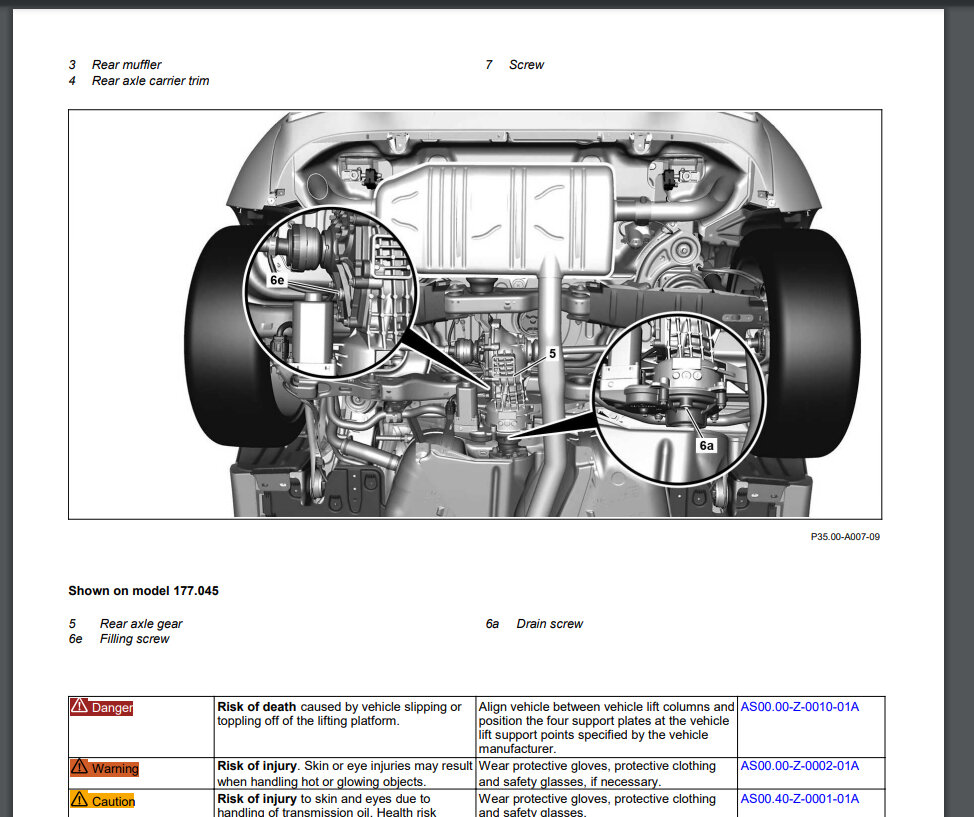

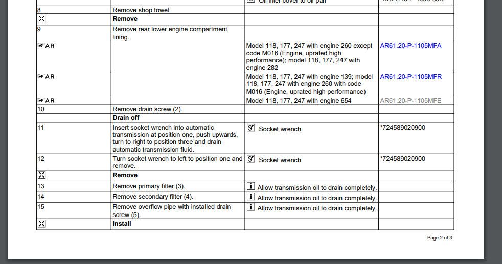

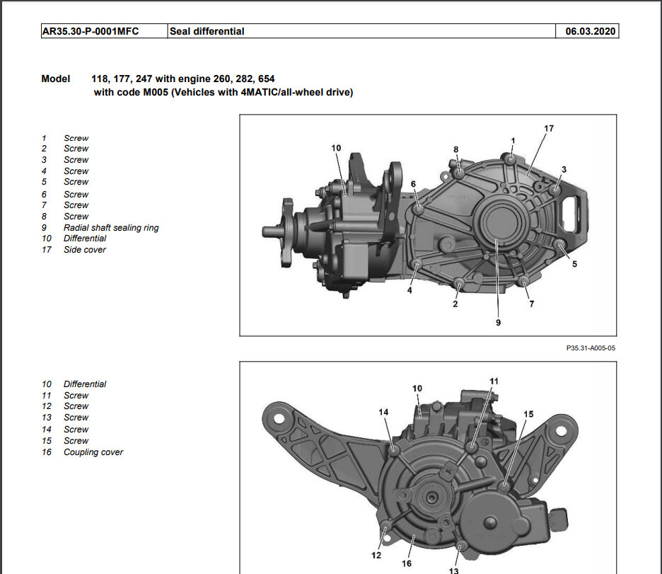

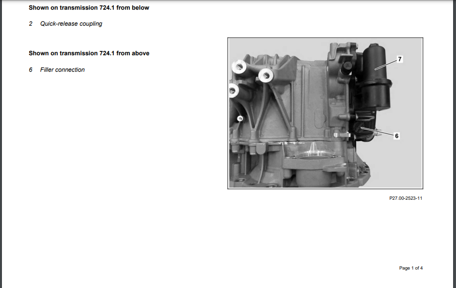

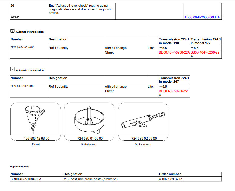

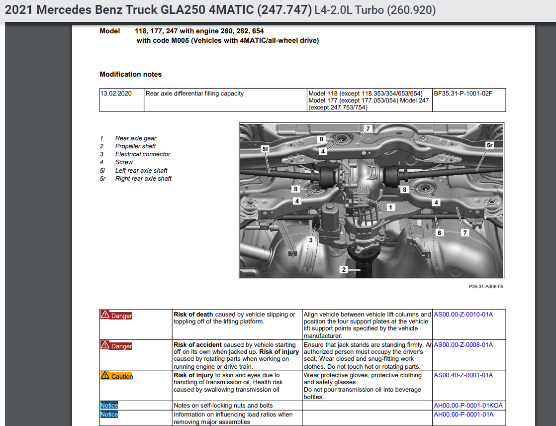

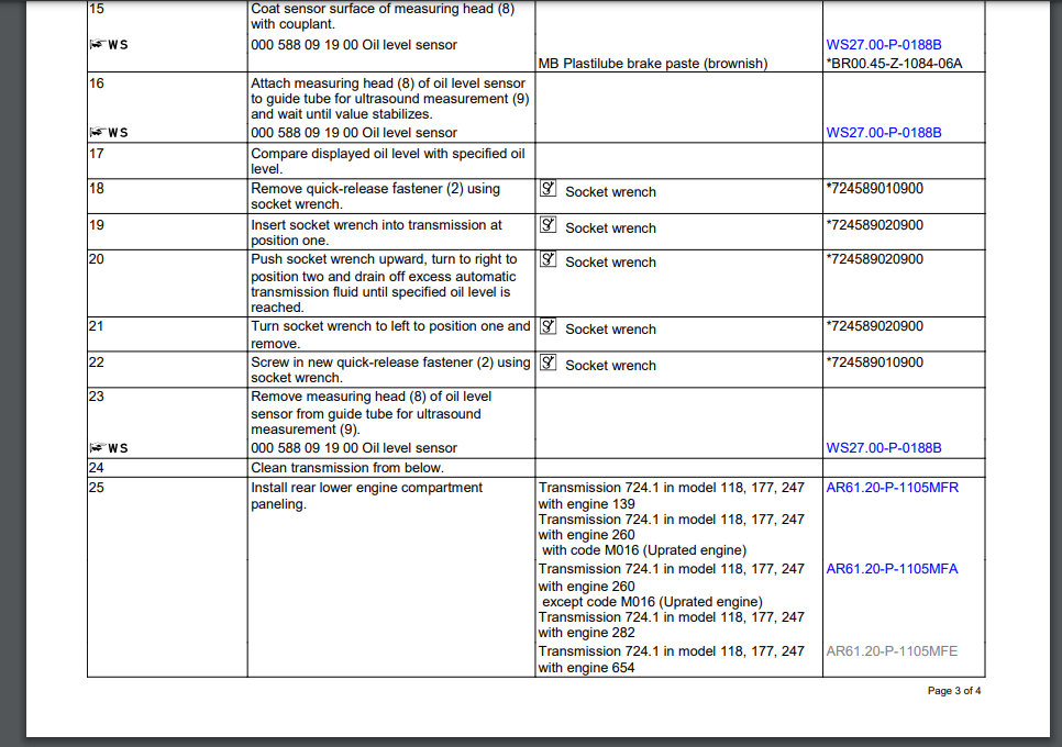

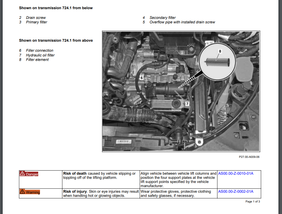

Sure, here are the instructions on how to change out the oil in the transmission and differential. Here is a generic guide to help you step by step with instructions in the diagrams below to show you how on your car:
and
https://www.2carpros.com/articles/differential-service
Check out the images (below). Please let us know if you need anything else to get the service completed.
