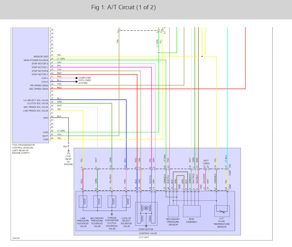

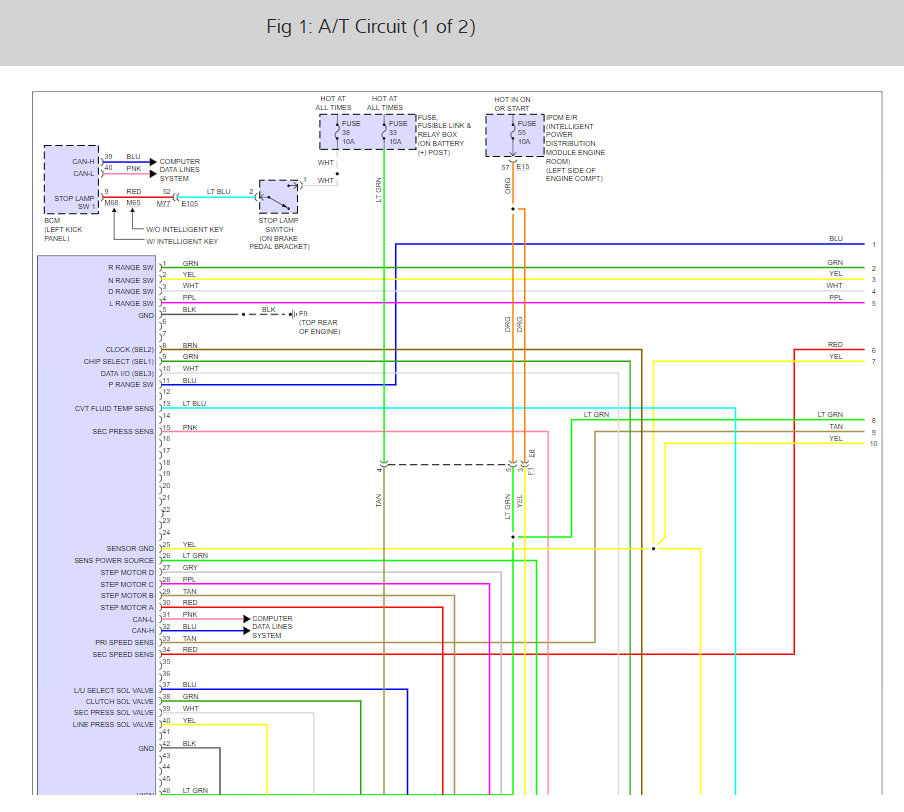

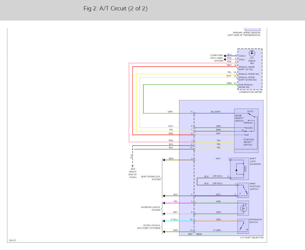

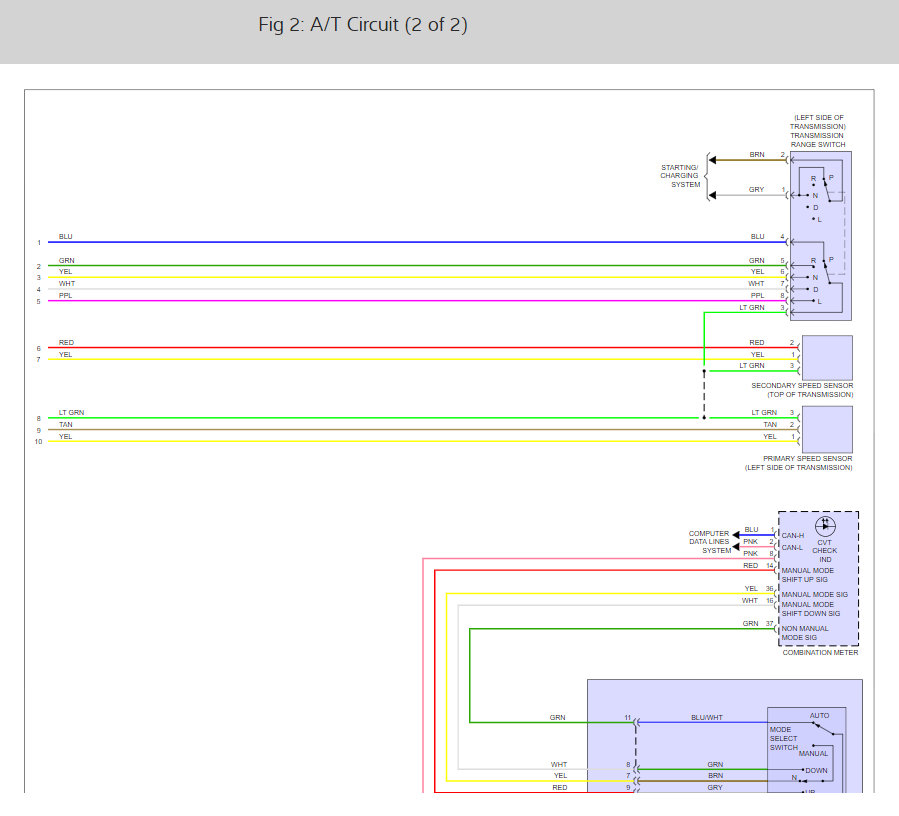

The malfunction light cam up with code p0846 fluid pressure sensor switch b transmission central. It has been changed twice. Few days driving it comes back on. The gear change becomes lumpy.
Jun 20, 2019 at 1:58 PM
  • 55,676 POSTS
This code is for the circuit which we need to check next. here is the wiring diagrams and a guide to help toy fix the problem. Check the pressure sensor wires to the PCM
