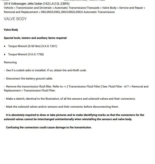

Hi , i got this code in my car (listed above 1.8) p072100 for output transmission speed sensor. i can't find the sensor. it's inside the transmission or outside? thank you.

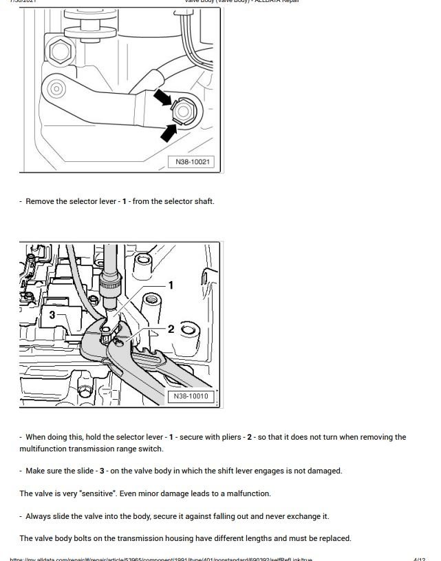

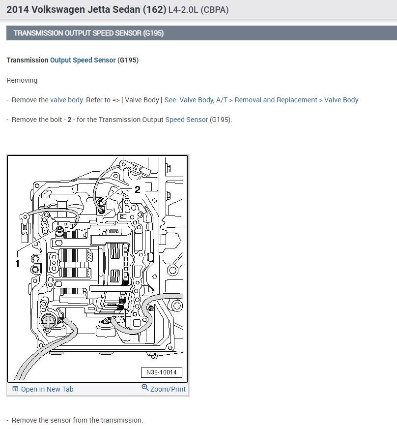

Hi, my name is Dan. The output speed sensor for your car is located above/inside the valve body inside the transmission. The lower transmission pan and the valve need to be removed in order to gain access to it. See below.
Jul 30, 2021 at 6:07 AM
MASTER ASE TECH
  • 82 POSTS

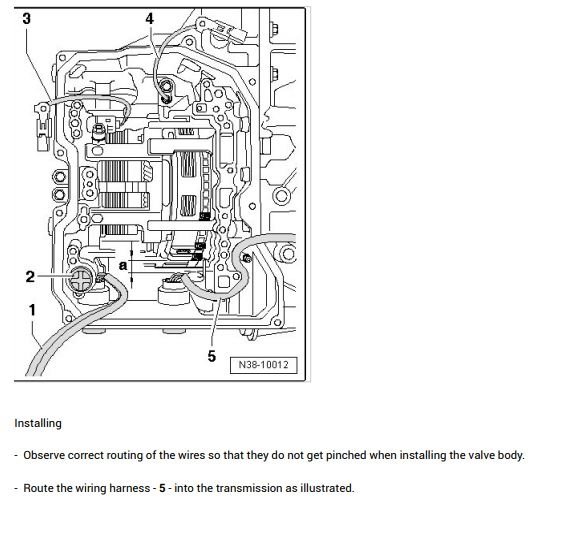

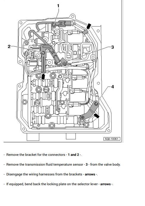

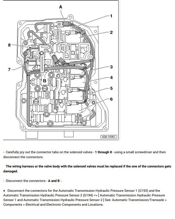

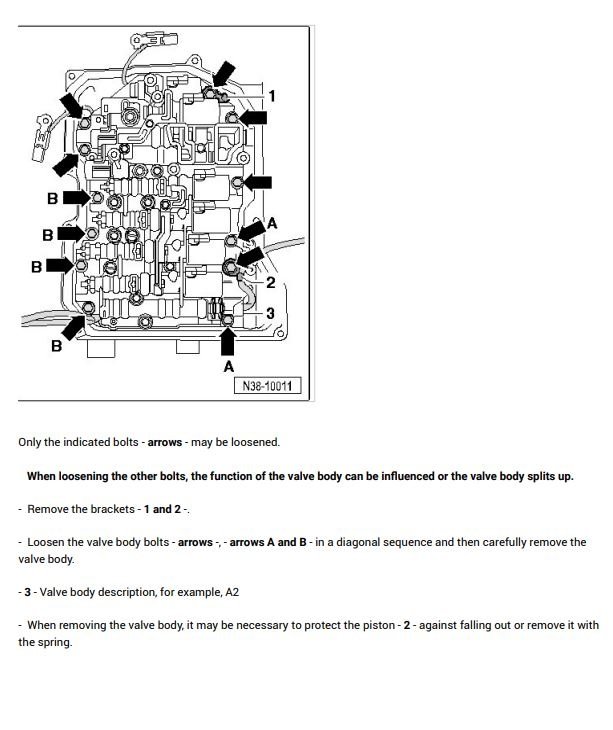

Here is the procedure to remove the valve body. The installation is just the reverse order.
