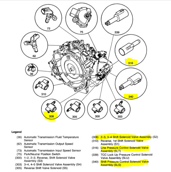

My car will shift from 1st to 2nd but not from 2nd to 3rd and it stays stuck in 3rd gear always. What replacement part would I need? I have asked every place around and no one can tell me.
Sep 3, 2024 at 4:28 PM
  • 110,190 POSTS

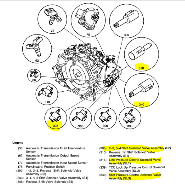

We need to have the computer scanned for diagnostic trouble codes, so we know approximately where the cause is coming from. I say that because there are different solenoids that can cause shift issues. See pic below. Note: These are all on the transmission valve body.
Let me know if this has already been done. If it has, what code was retrieved?
See pic below.
