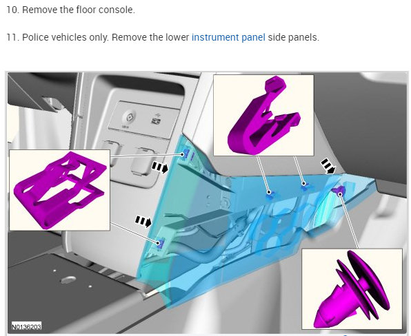

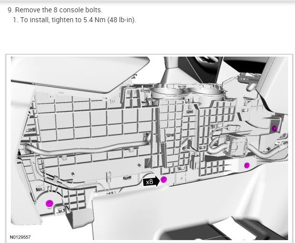

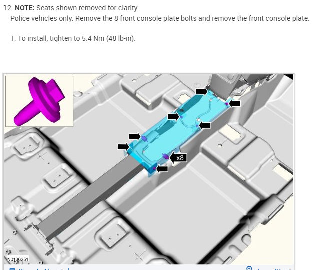

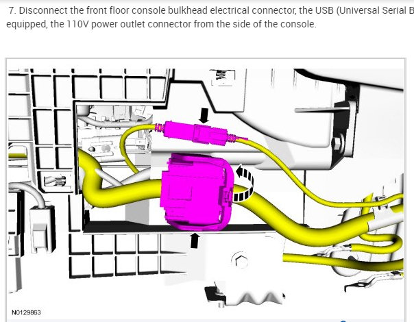

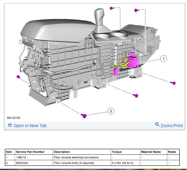

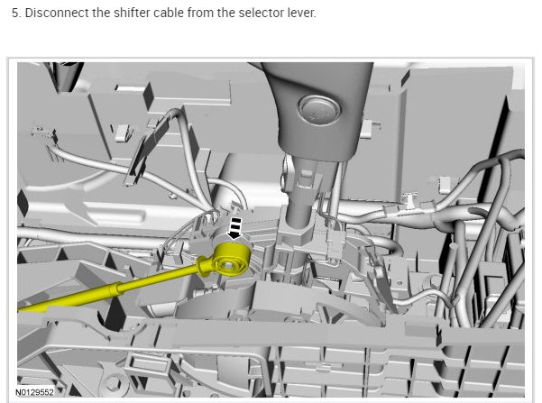

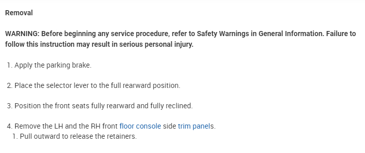

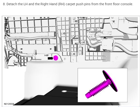

Shift into park the selector on gauge panel does not light up,the computer thinks it’s not in park and will not start. Micro switch is bad. Need instructions how to take console apart to replace micro switch.
Sep 25, 2019 at 8:01 PM
DANNY L
  • 5,648 POSTS
Hello, I'm Danny.

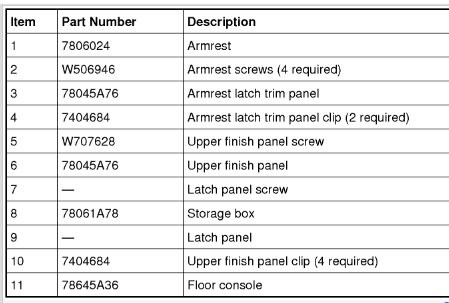

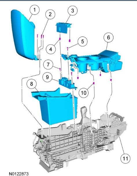

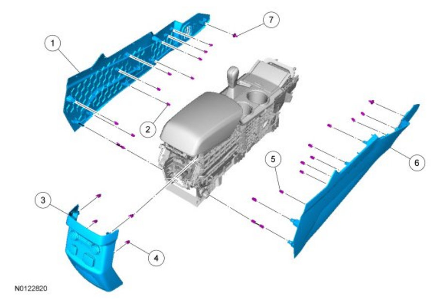

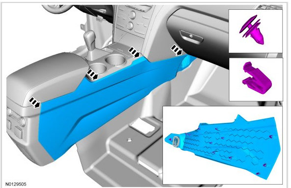

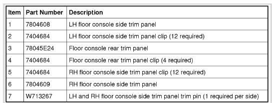

I've attached a series of step-by-step picture instructions below for your Explorer.Hope this helps and thanks for using 2CarPros.
