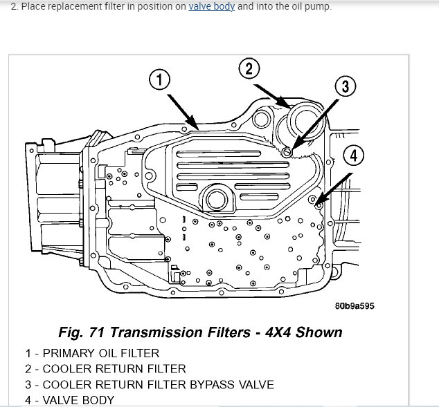

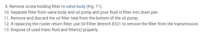

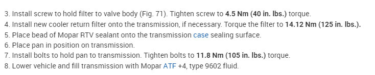

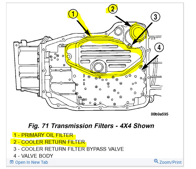

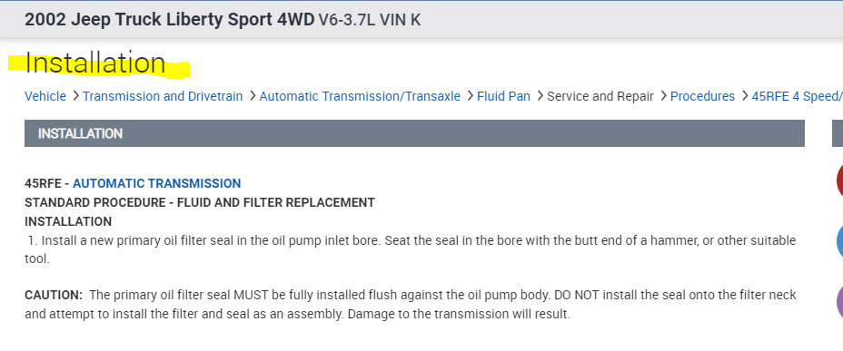

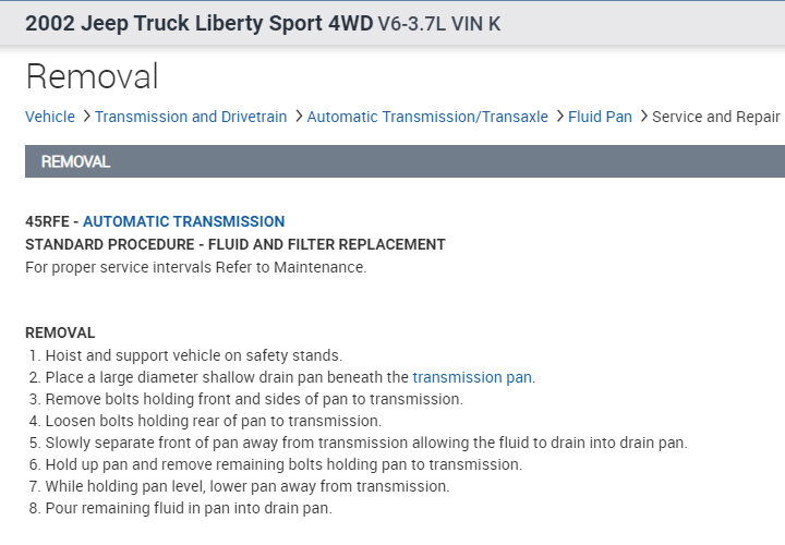

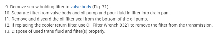

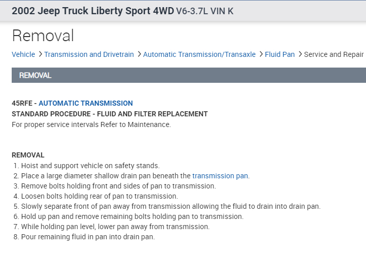

If the pan gasket is leaking, this is a good time to service the transmission. You will need to remove the transmission pan to replace the gasket and then refill the transmission fluid, so I would recommend replacing the filters as well.
If you look below, I attached the directions specific to this vehicle. Take a look through them and let me know if it helps or if you have questions,
take care,
joe
