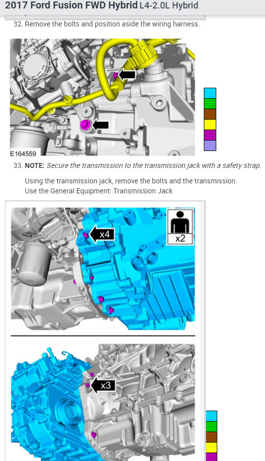

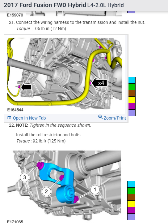

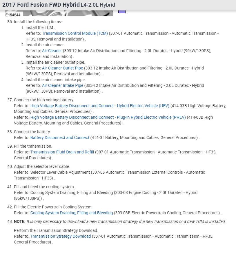

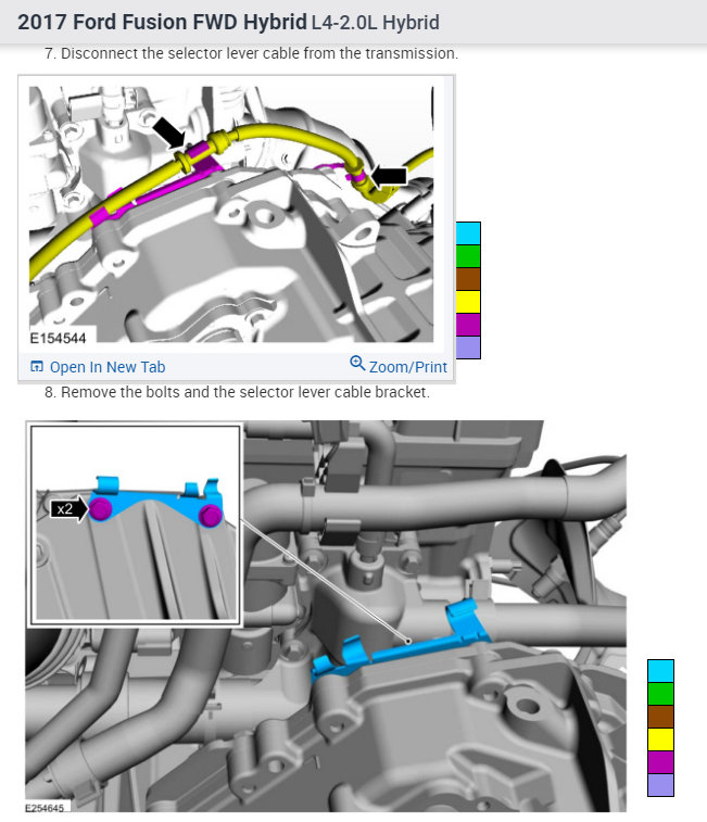

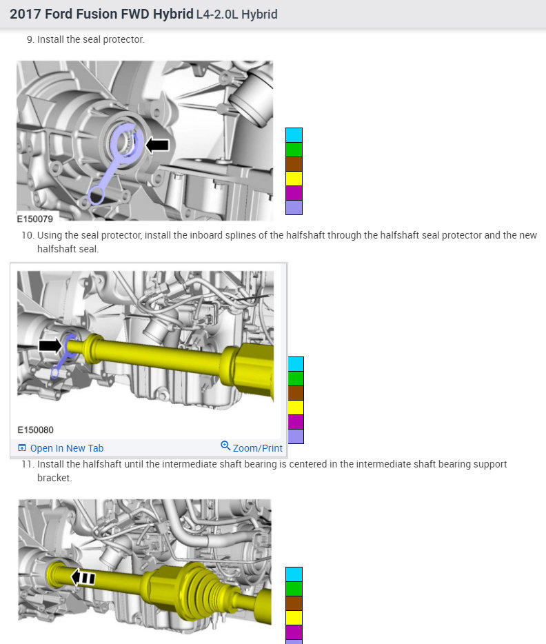

I am looking for free instructions on how to replace the transmission on my car. Any ideas?

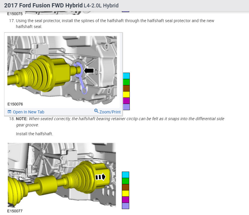

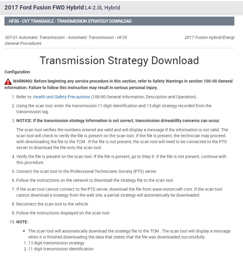

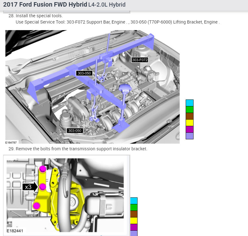

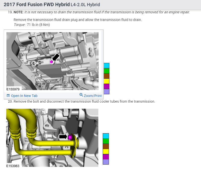

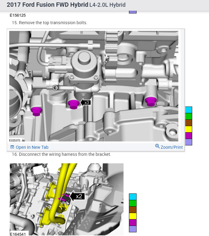

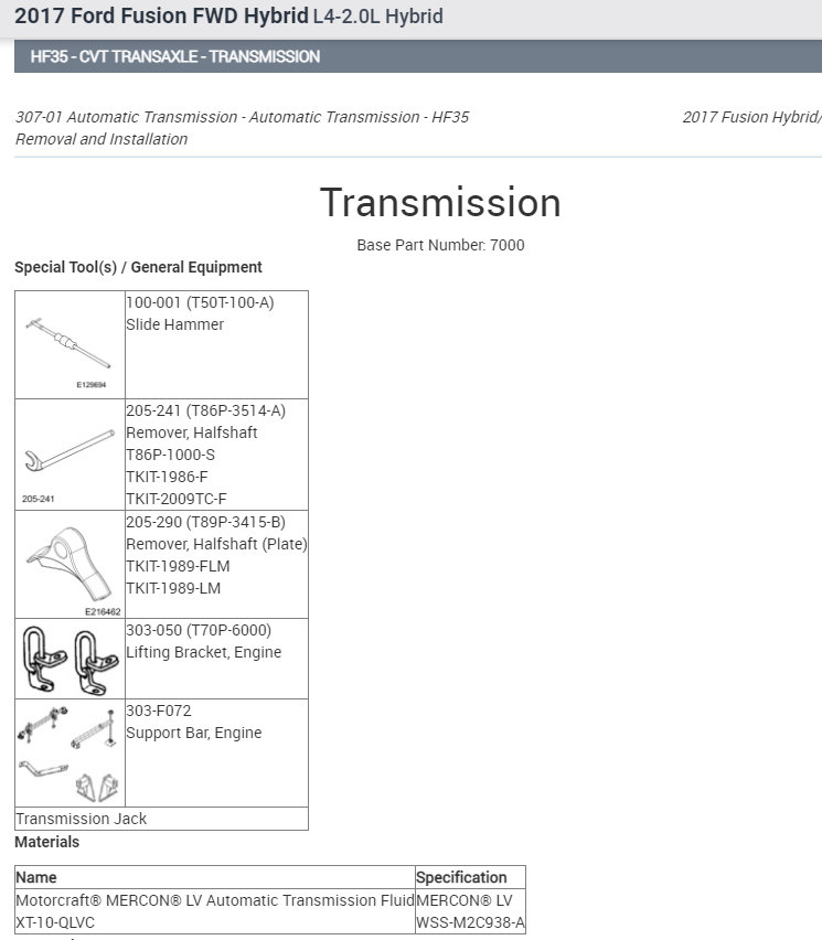

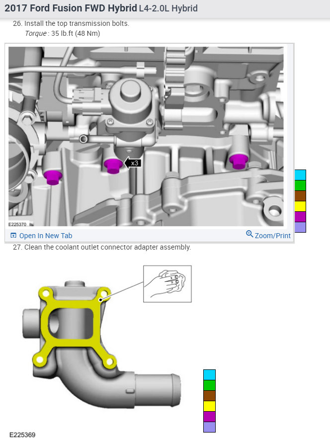

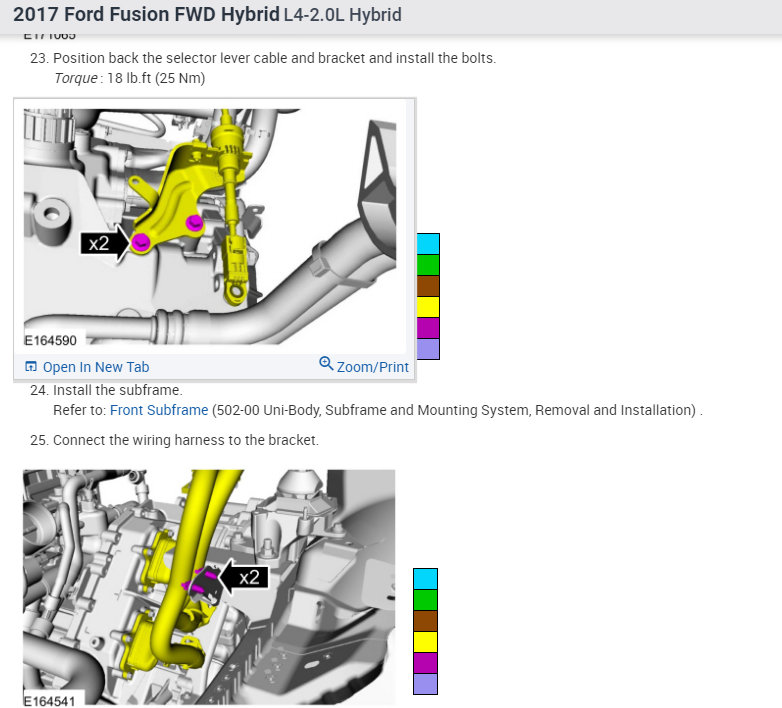

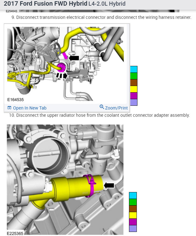

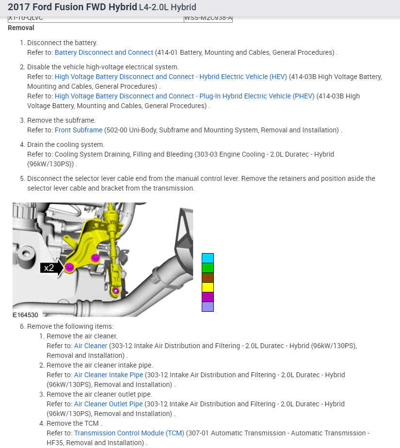

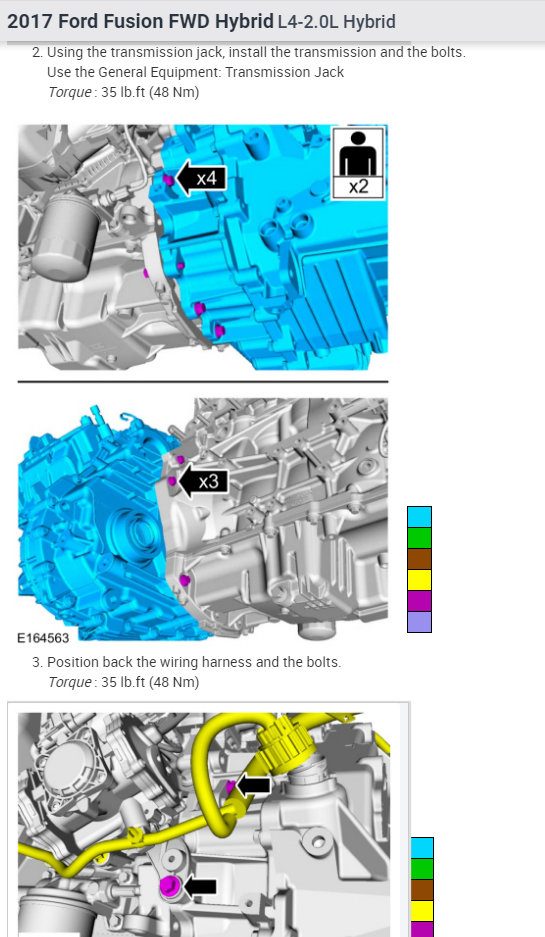

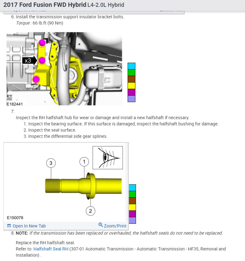

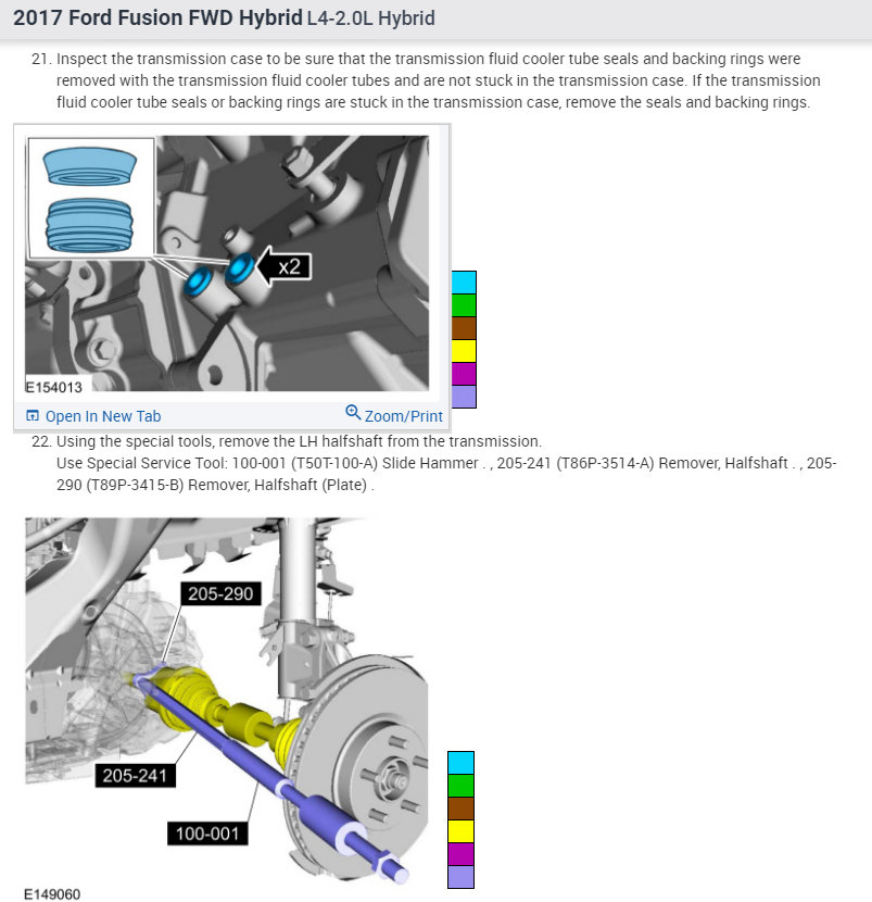

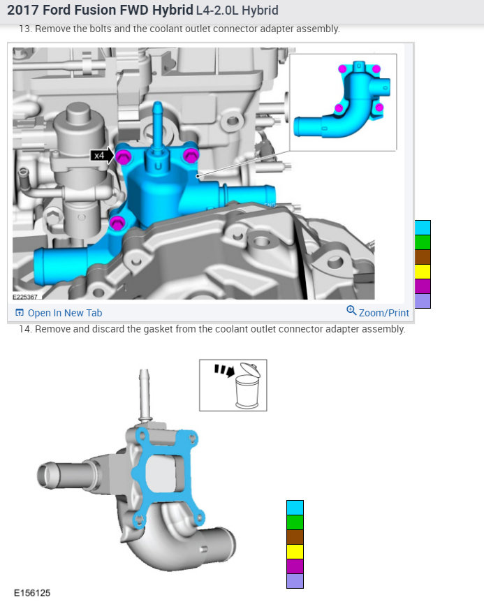

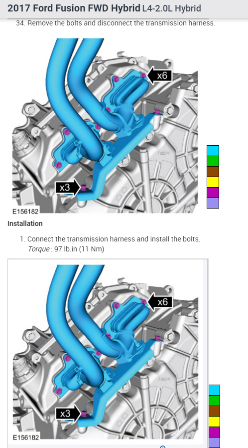

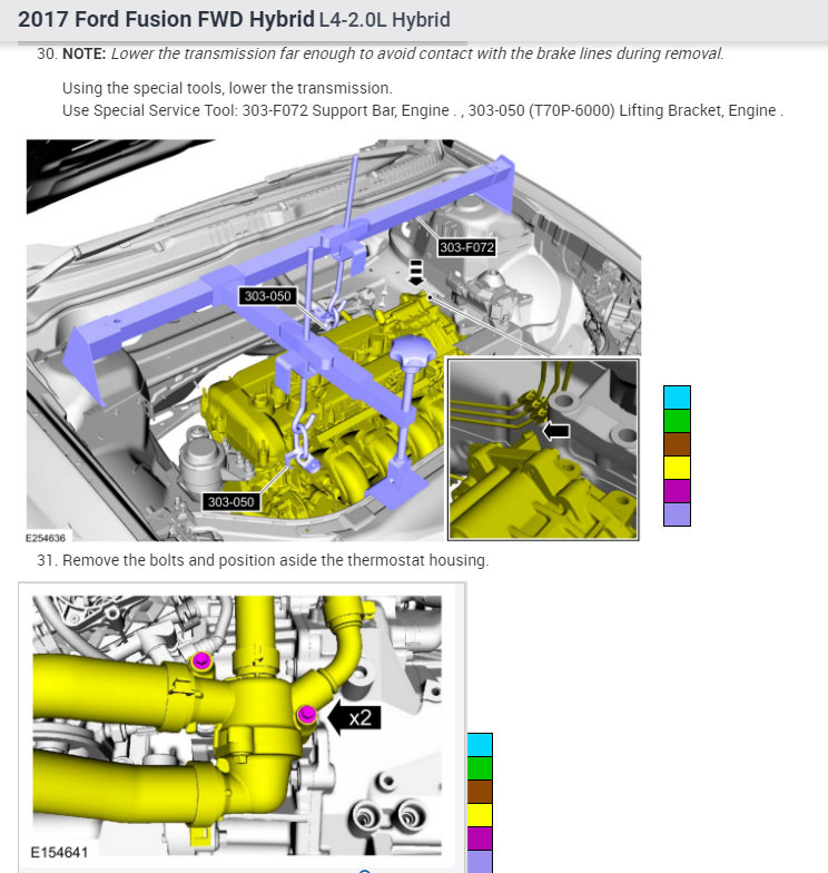

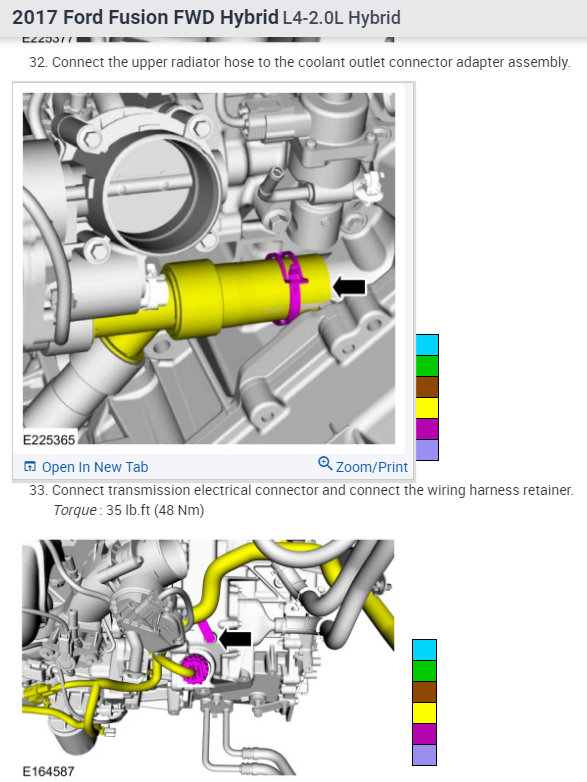

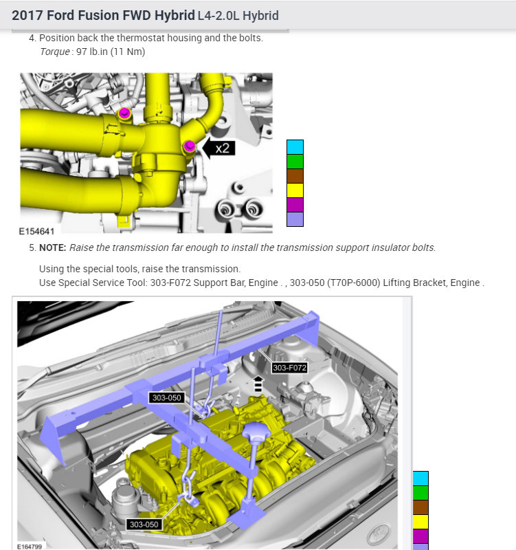

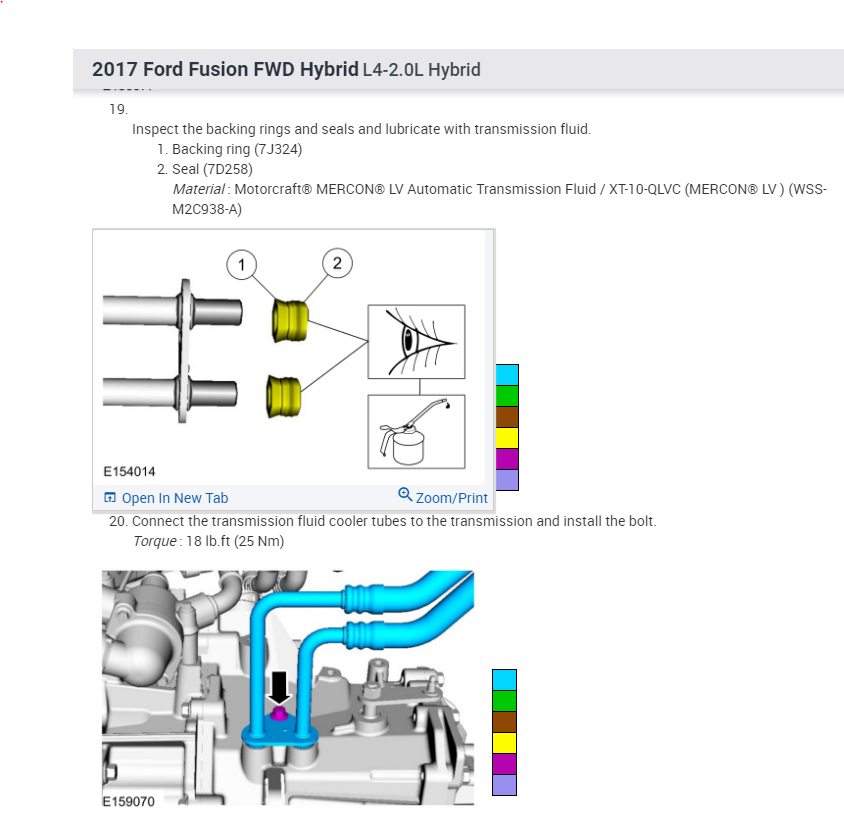

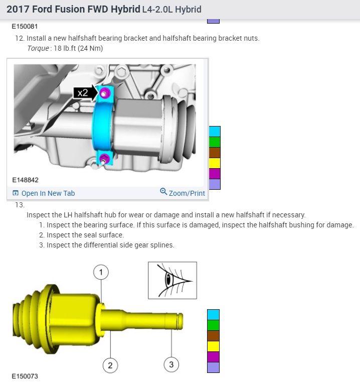

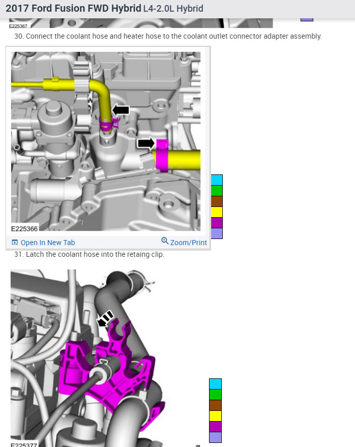

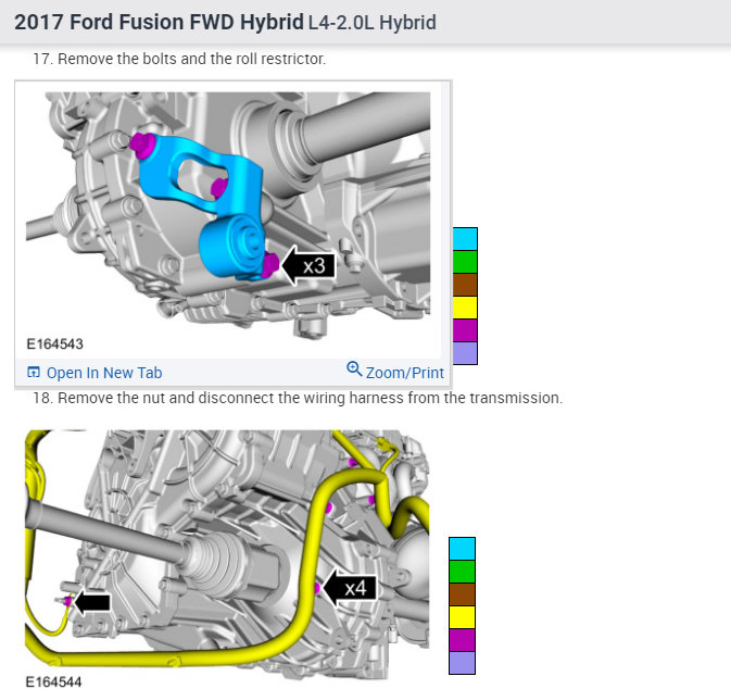

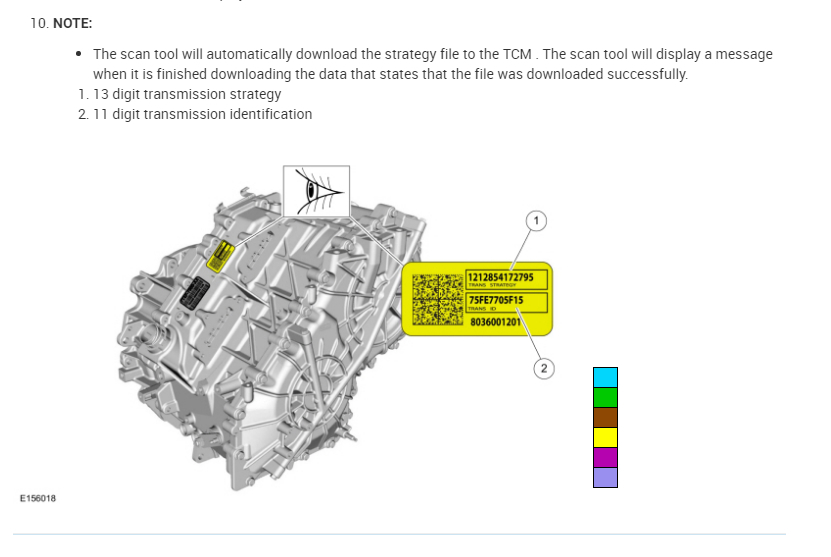

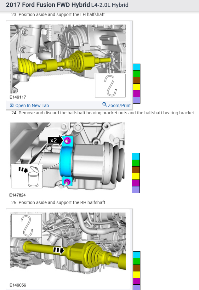

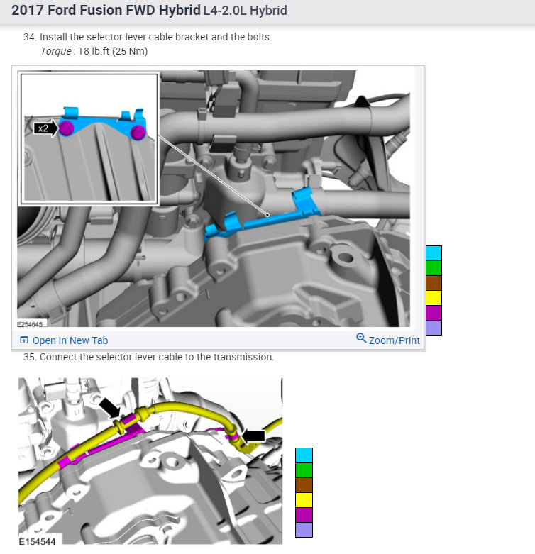

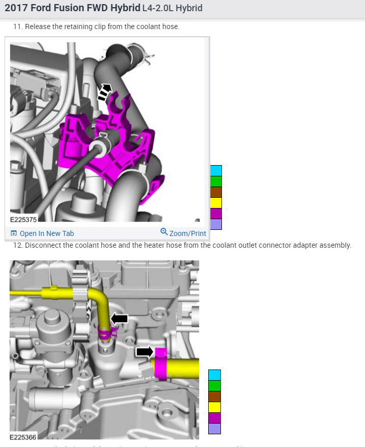

Attached are the transmission replacement procedure below for your reference. It has all the steps and the specifications and the special tools that will be needed.
Let me know of any questions.
https://www.2carpros.com/articles/how-to-remove-an-automatic-transmission-rwd

Anything specific to my car? 2013 Ford Fusion hybrid se?
May 18, 2022 at 4:09 PM
SQM
  • 6,383 POSTS
This procedure listed is specific to your 2013 Fusion Hybrid.
