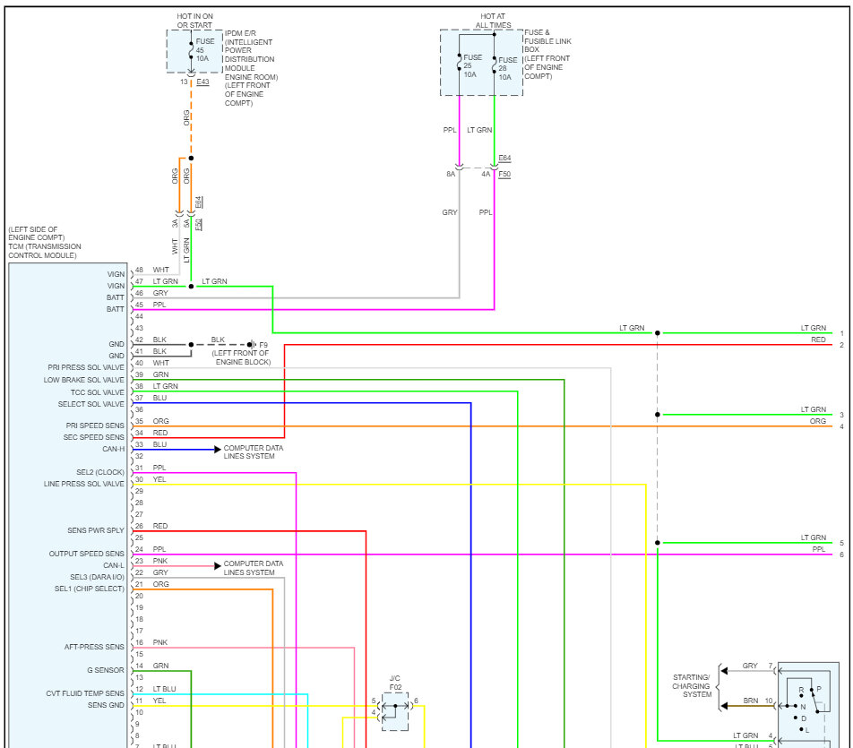

Transmission replaced three times, but vehicle drives slowly on forward and reverse?
2014 NISSAN SENTRA
45,678 MILES • 2.5L • 4 CYL • 2WD • AUTOMATIC
MALLYBOY
  • 329 POSTS
Fault codes:
P0890-TCM POWER RELAY SENSE CIRCUIT LOW,
P0744-TORQUE CONVERTER CLUTCH INTERMITTENT,
P0603:ECM KEEP ALIVE MEMORY(BACK UP CIRCUIT),
U0100:LOST COMMUNICATION WITH ECM/PCM A,
P0868:FLUID PRESSURE LOW

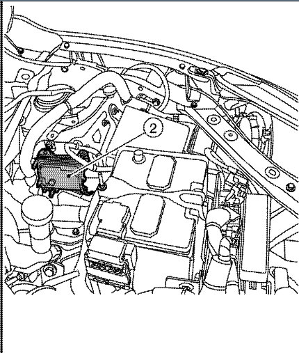

How do I troubleshoot these and where's TCM relay located?

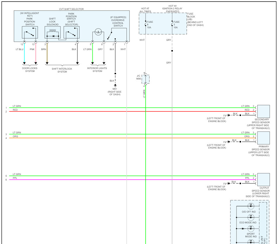

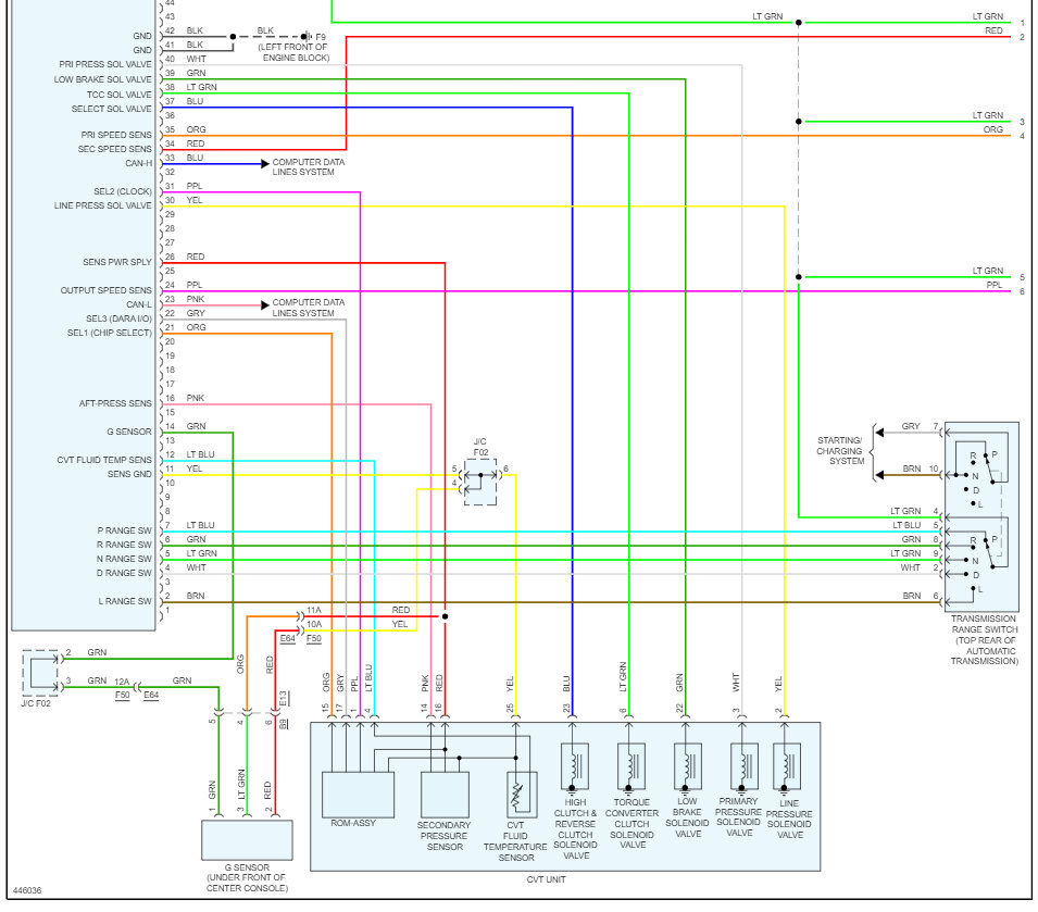

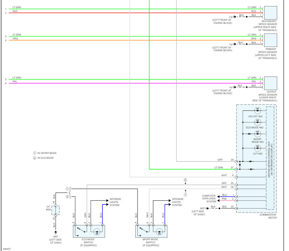

Here is the transmission wiring diagrams and there is no TCM control relay. I would think the problem is with the TCM itself, did you check the power ground and fuses?
This guide can help:
Aug 1, 2023 at 3:50 AM

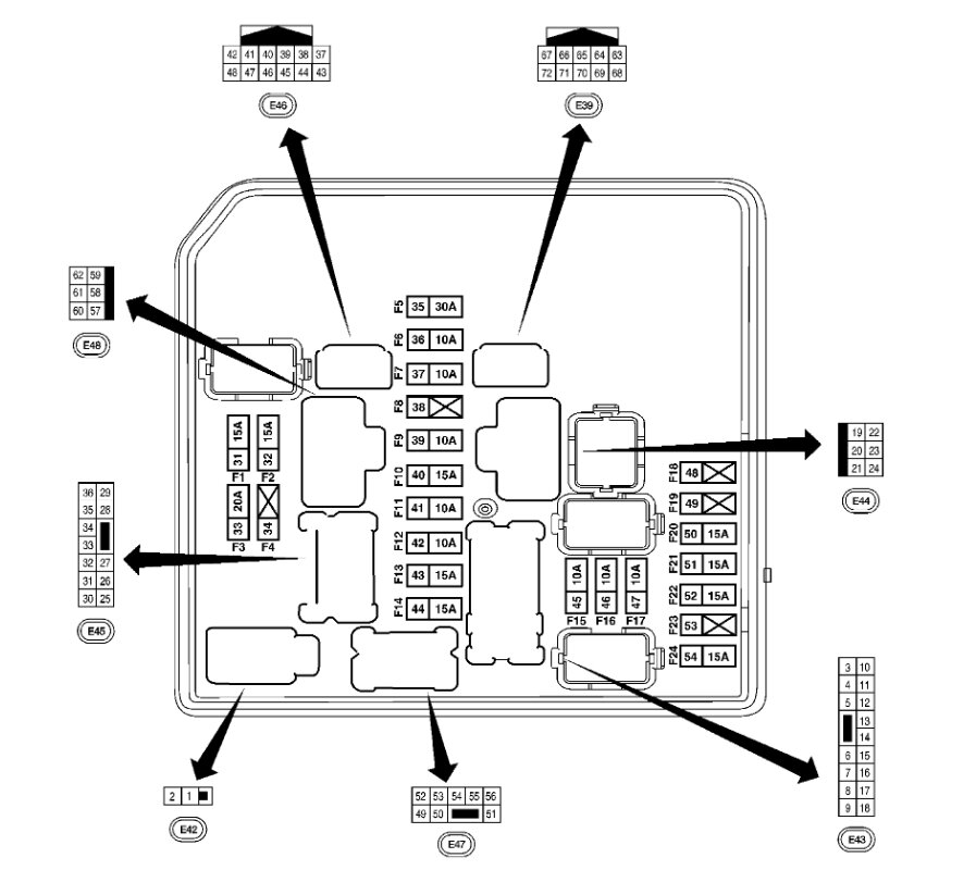

MALLYBOY
  • 329 POSTS

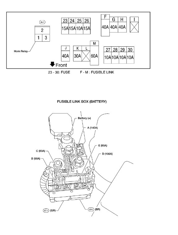

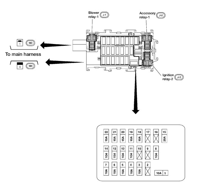

Please send me fuse box diagram complete, so that I can locate the TCM power relay sense circuit.
Aug 2, 2023 at 7:48 AM
  • 55,432 POSTS
I don't see a TCM power relay? Here are the fuse panels. Check out the images (below). Please let us know how it goes.
