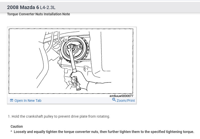

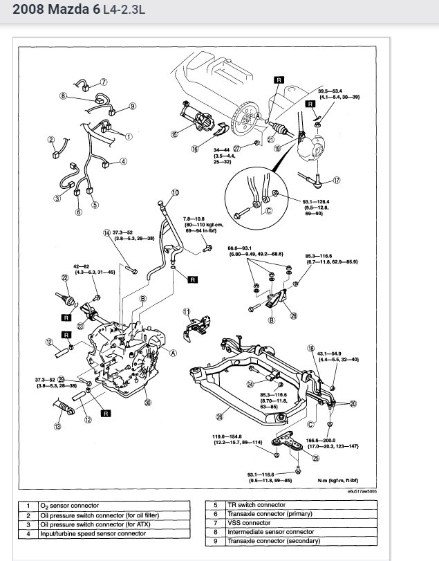

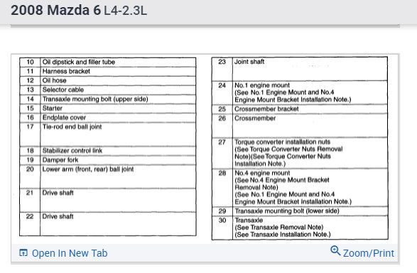

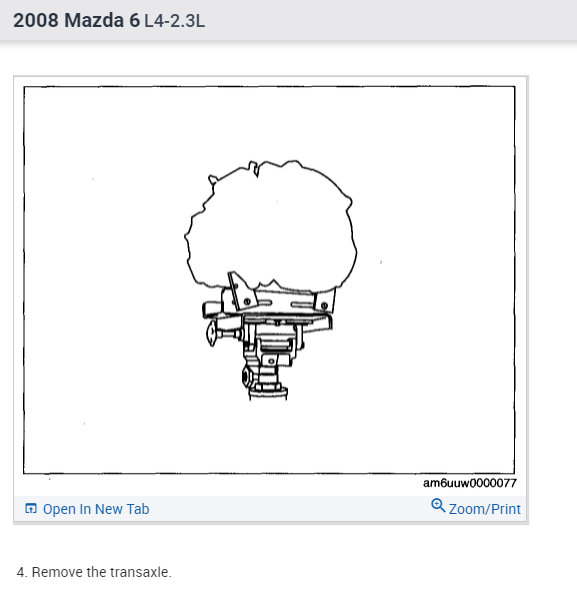

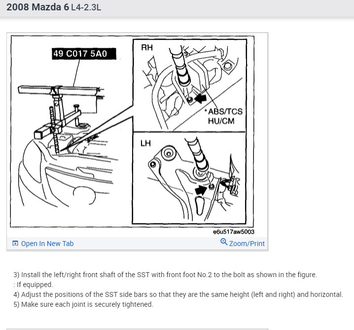

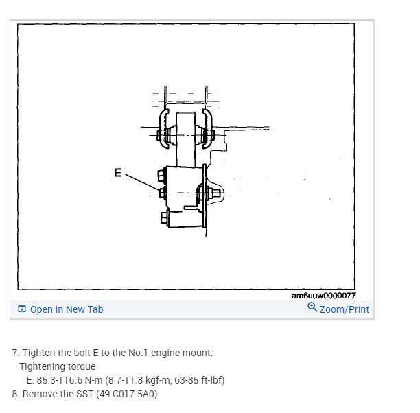

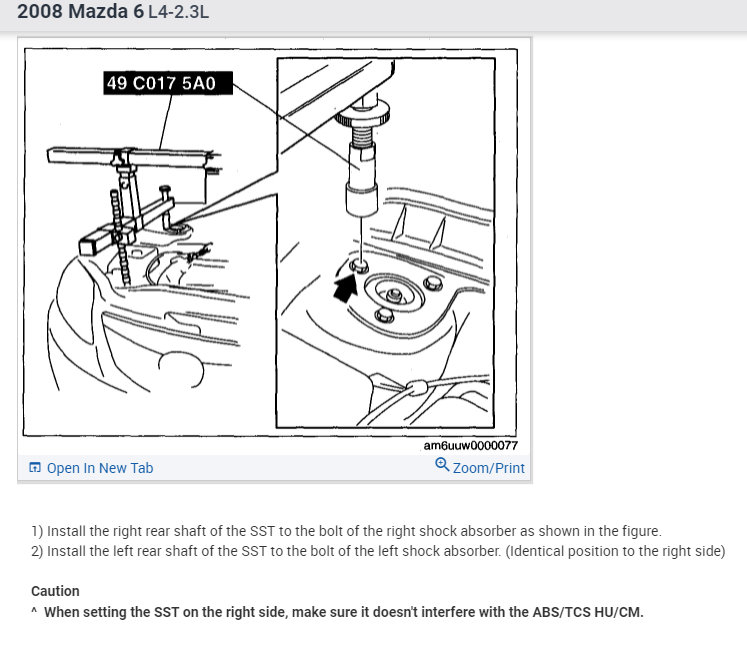

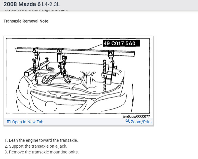

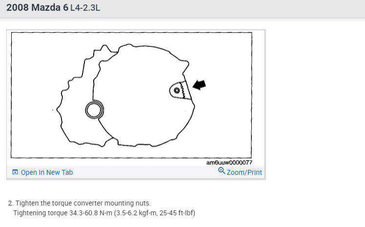

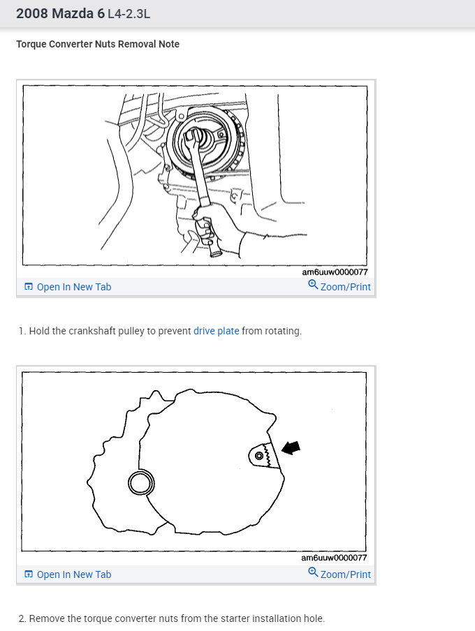

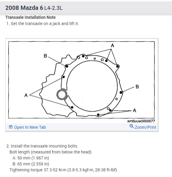

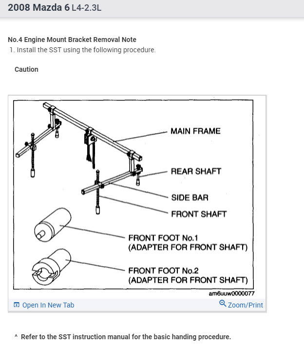

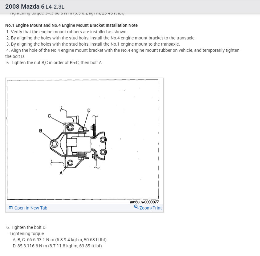

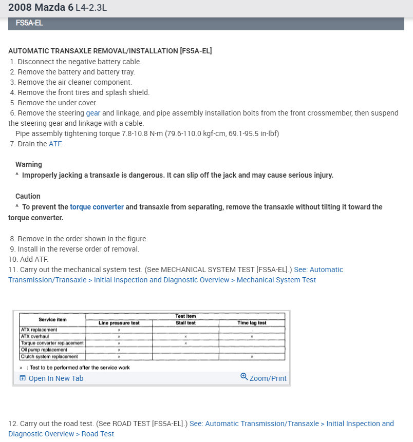

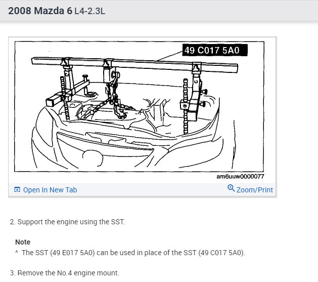

I am replacing the front seal and I was trying to see if there was a step-by-step removal of the transmission that you could provide for me.? I have removed and installed a transmission in a 2003 Lincoln LS before, but I have never removed a transmission that is on a sideways motor.
Feb 18, 2022 at 7:23 AM
SQM
  • 6,383 POSTS
Do you know if this vehicle has a five speed or six speed automatic transmission?
I have attached the replacement procedure for the five-speed automatic transmission below.
If it is the six-speed automatic the replacement procedure is mainly the same with some differences, if that is the case just let me know and I will provide that info as well.
https://www.2carpros.com/articles/how-to-remove-an-automatic-transmission-rwd
