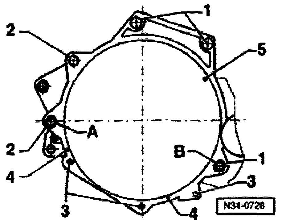

Can't seem to remove transmission from engine to replace clutch.

I have a front wheel drive, 5 speed transmission and when try to pry from engine to replace clutch transmission gets stuck on sub frame. any easy tips to pull transmission away from flywheel and old clutch plate? do i have to rotate transmission in a upward motion to remove?

Here are the directions for removing and installing a 5-speed manual transmission from this vehicle. The attached pics correlate with the directions.
______________________________________
2001 Volkswagen Jetta GL Sedan (9M2) L4-2.0L (AVH)
Transmission Removing and Installing
Vehicle Transmission and Drivetrain Manual Transmission/Transaxle Service and Repair Procedures 5 Speed Manual 02J Transmission Removing and Installing

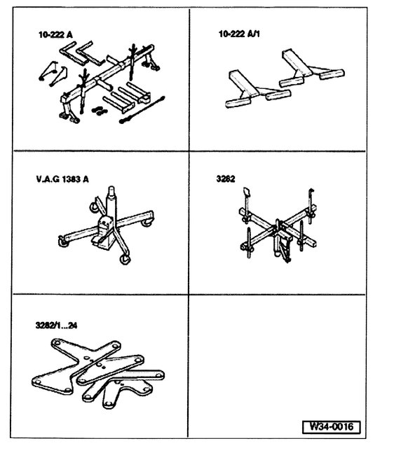

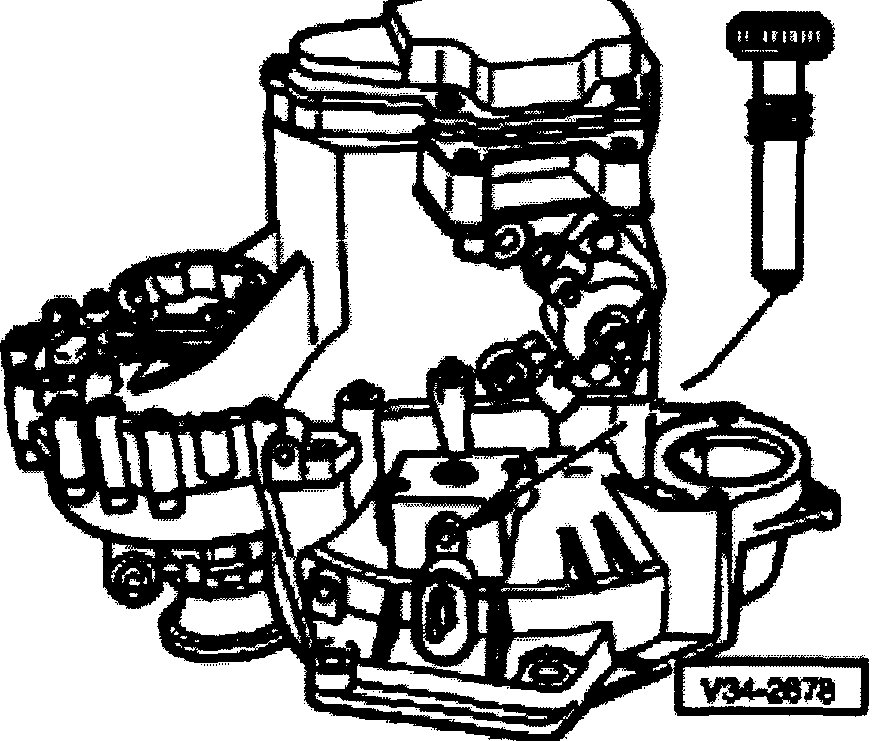

TRANSMISSION REMOVING AND INSTALLING
5 Speed Manual 02J

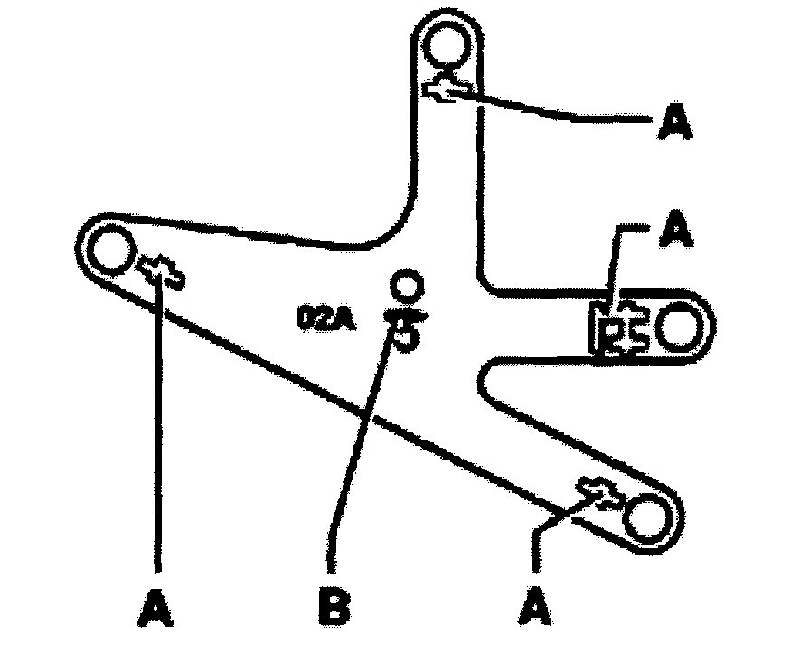

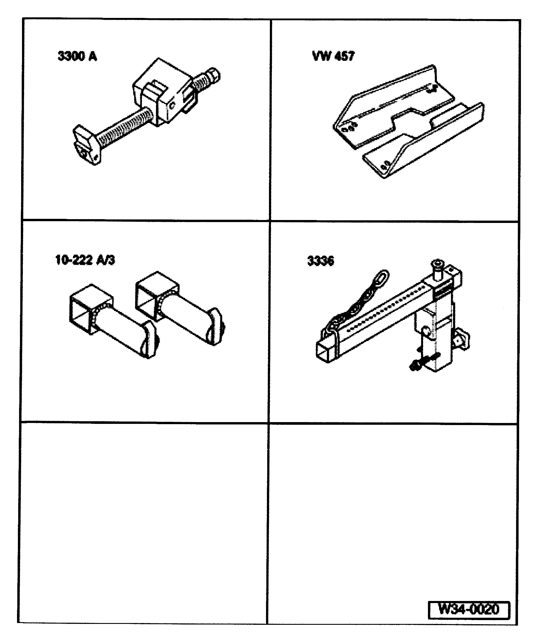

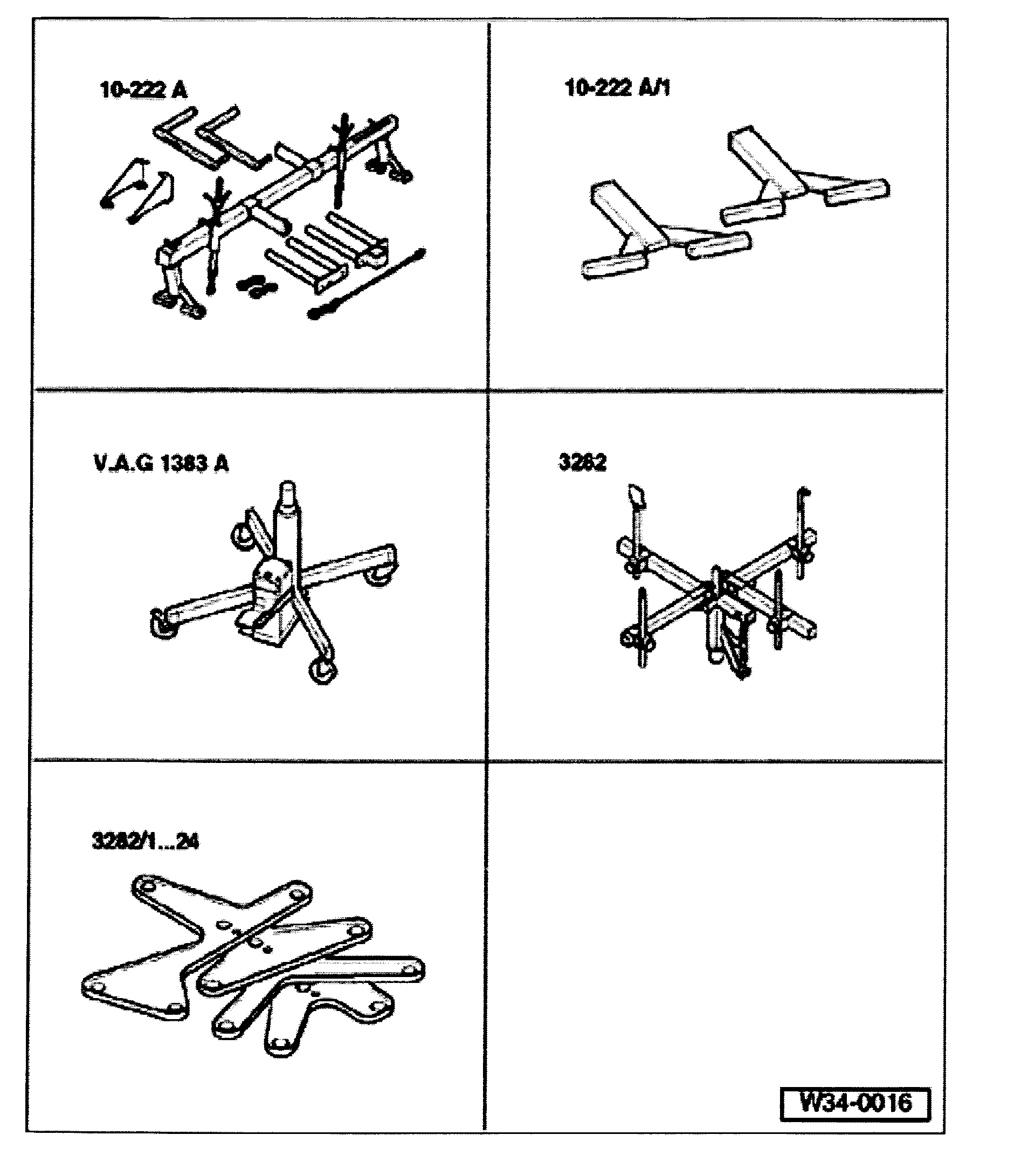

Special tools and equipment
- 10-222 A Support
- 10-222 A/1 Support
- V.A.G 1383A Transmission jack
- 3282 Transmission support
- 3282/8 Adjustment plate
- 3282/40 Pin (3x)
- 3282/59 Support
pic 1
- 3300 A Engine support
- VW 457/1 Support rails
- 3336 Transmission lifting beam
Additionally for vehicles with 6-Cyl. engines
- 10-222 A/3 Adapter

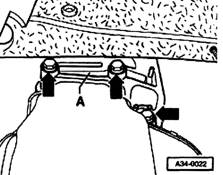

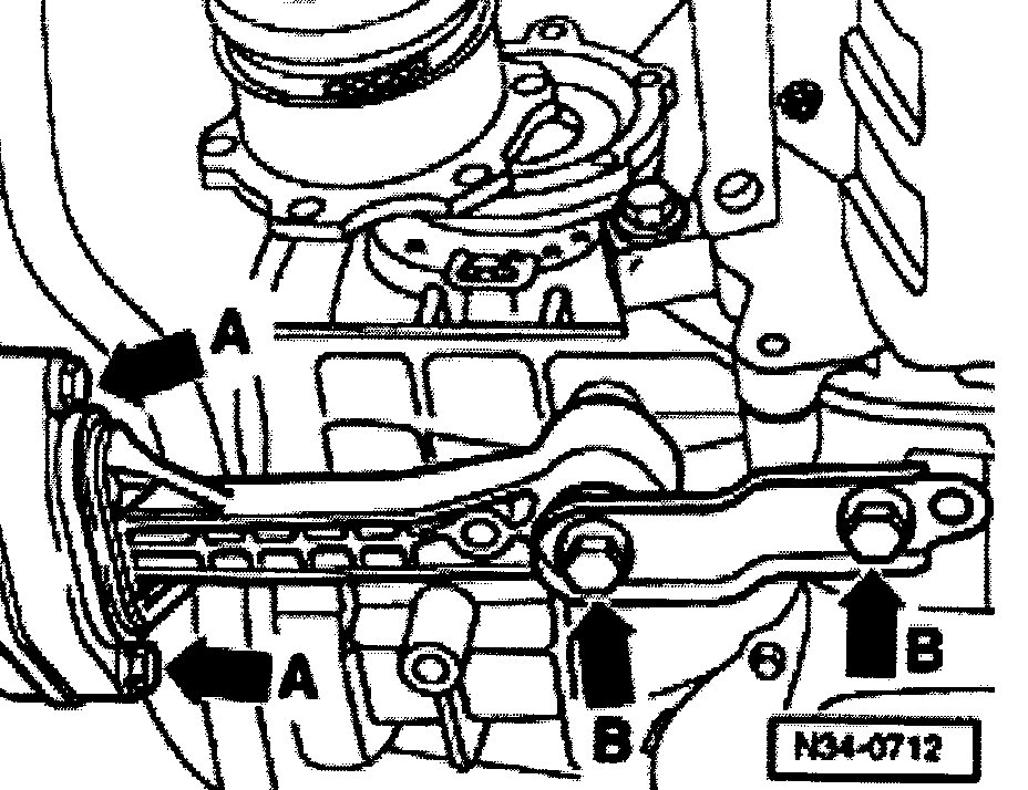

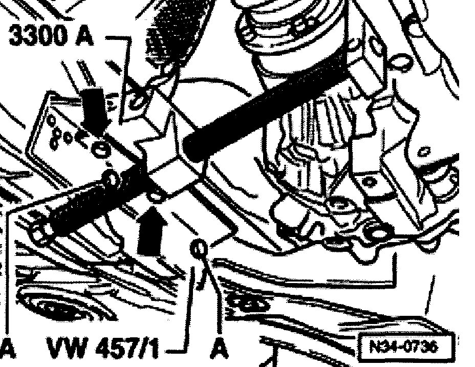

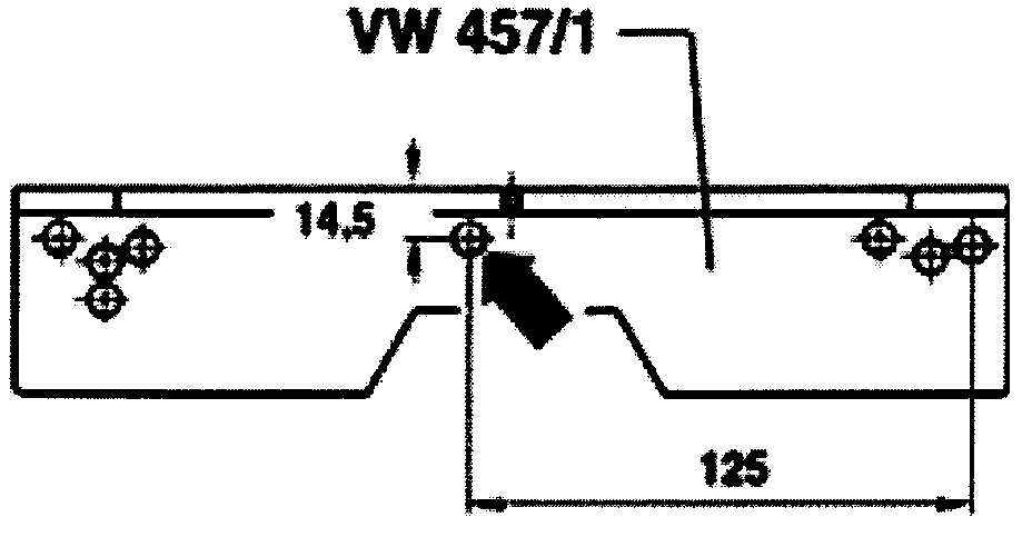

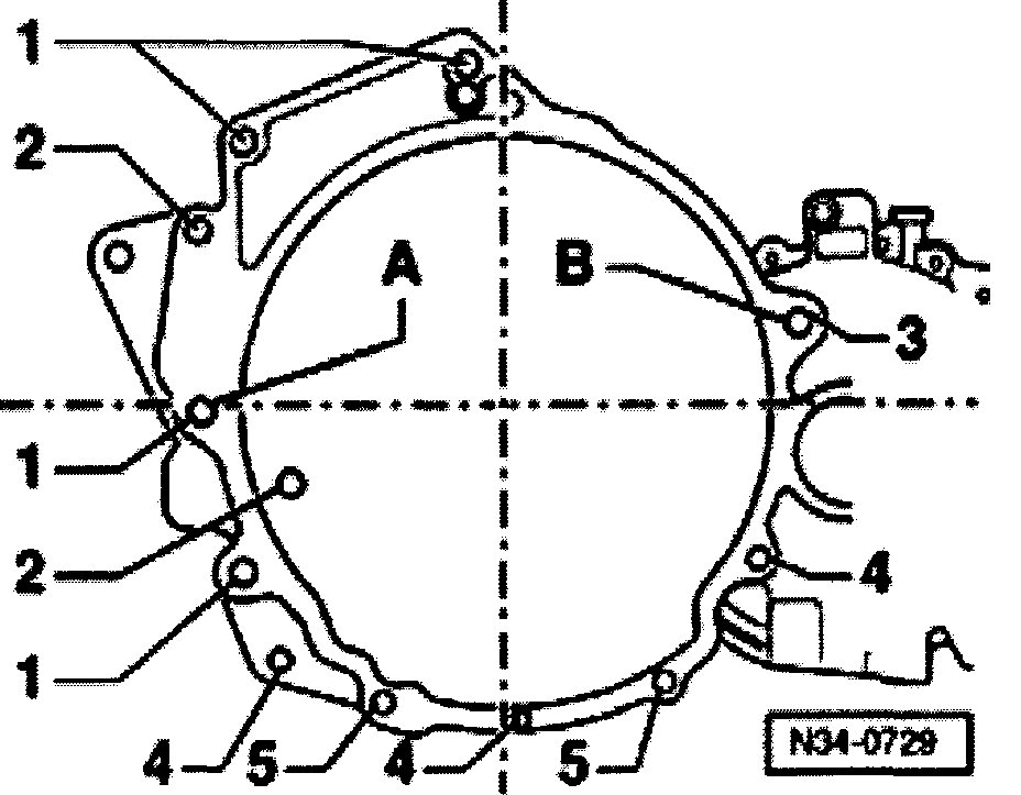

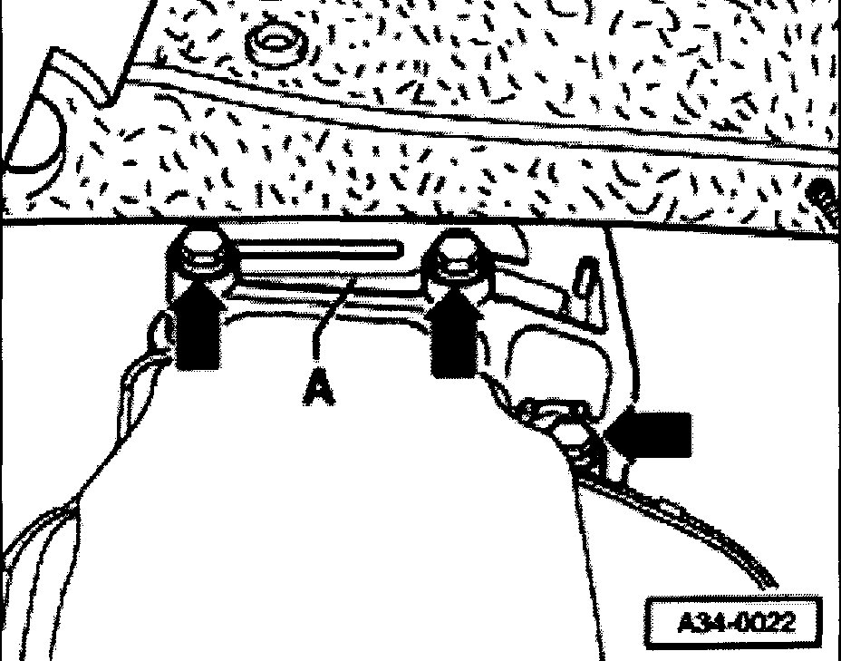

Modifying Support Rails VW 457/1
- Support rails VW 457/1 are required to remove and install the transmission.
pic 2
To secure support rail VW 457/1 to the subframe a new hole is required.
Dimensions given are in mm.
- Drill an 8.5 mm (0.335 inch) diameter hole (arrow) in 5upport rail VW 457/1.

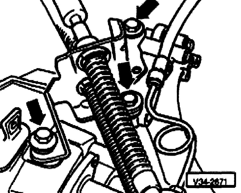

- With ignition switched off disconnect battery ground strap.

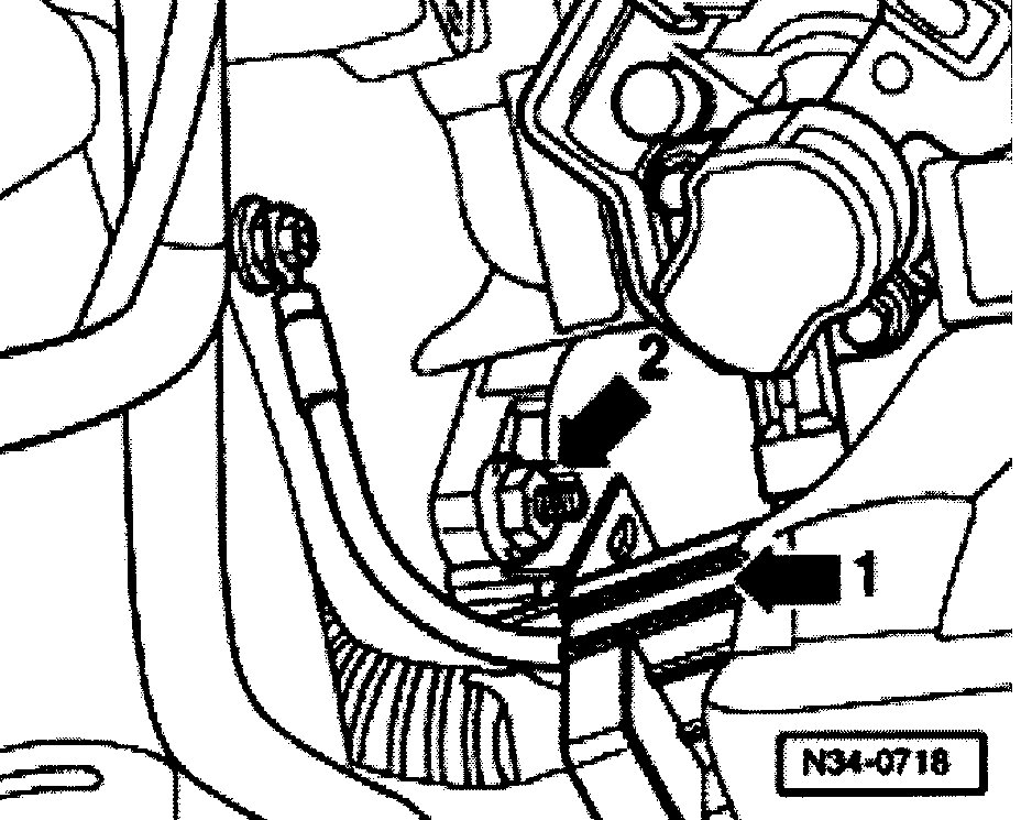

pic 3

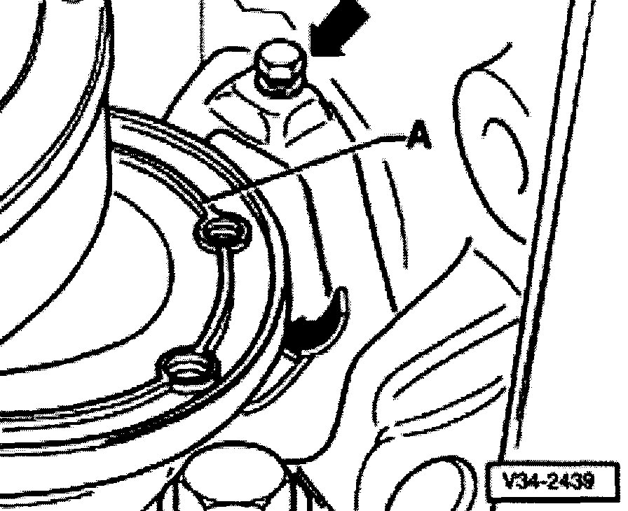

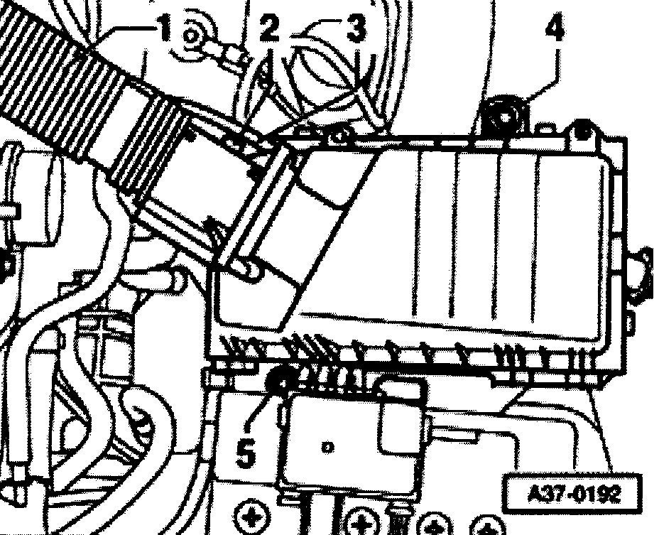

- Remove intake hose -1 -, connector -2- and hose -3- from Mass Air Flow (MAF) Sensor.
- Remove complete air cleaner housing by unscrewing bolts -4- and -5-.
- Refer to; Powertrain Management.

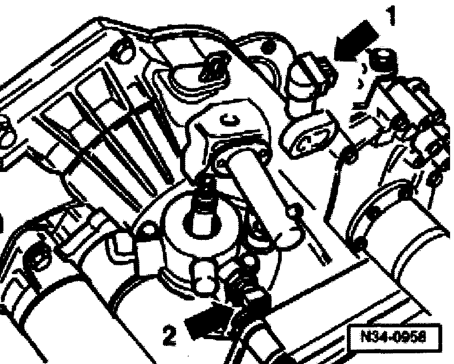

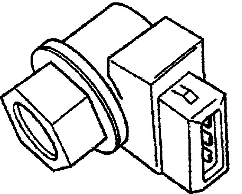

Transmissions up to 05.99
pic 4

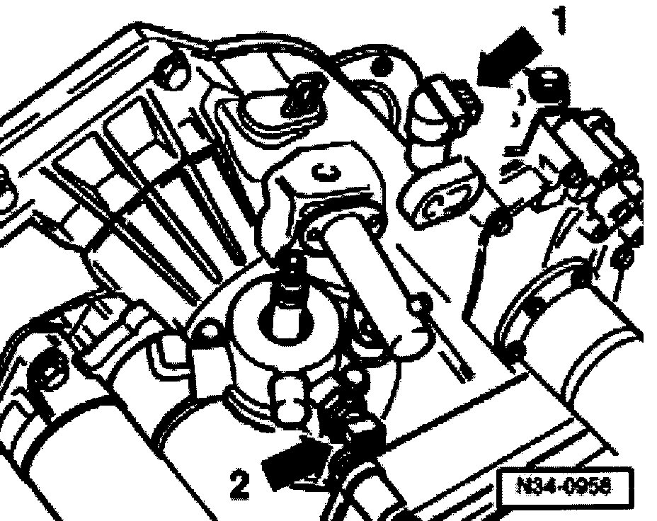

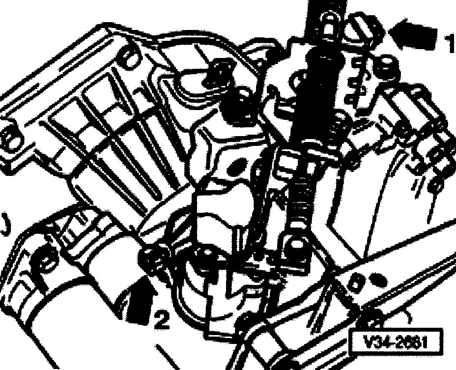

- Pull connector off vehicle speed sensor (arrow 1).
- Disconnect reverse light connector (arrow 2).

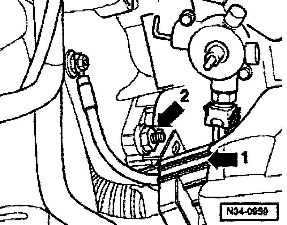

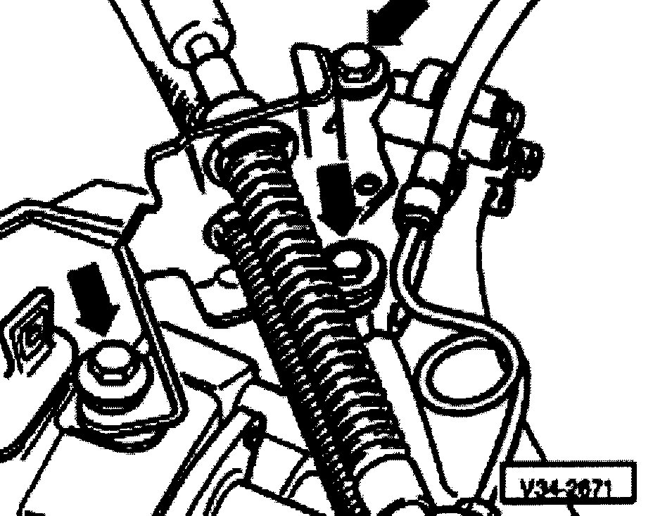

pic 5

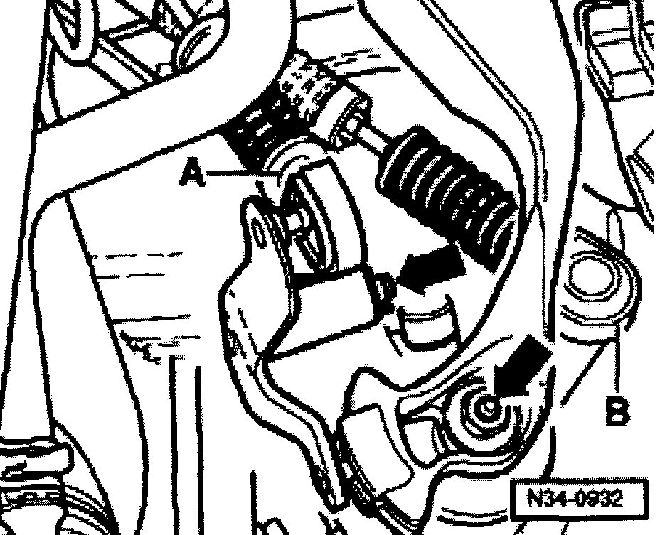

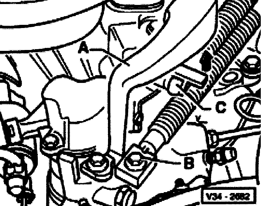

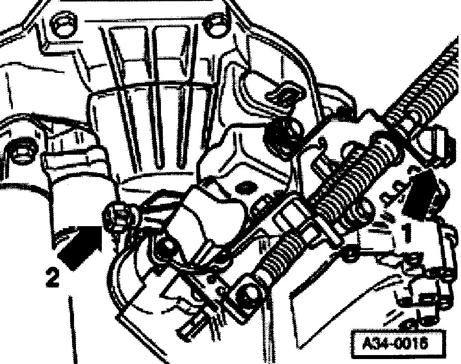

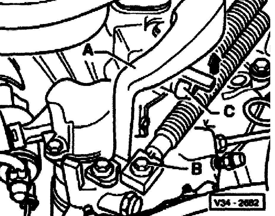

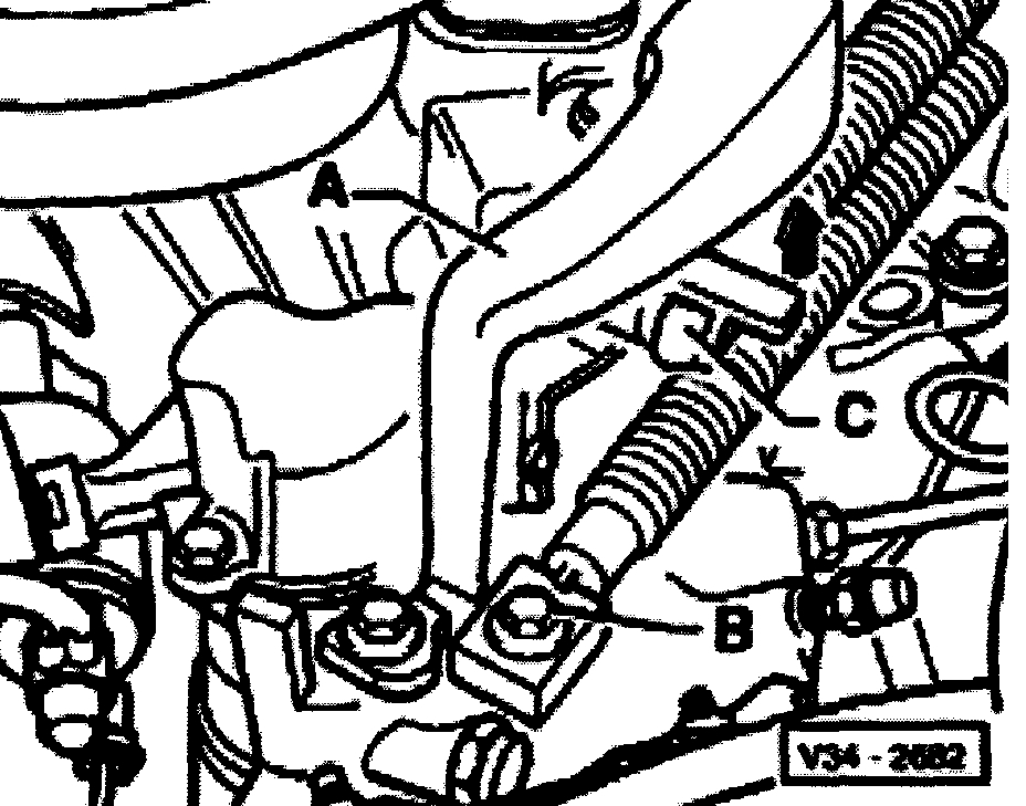

- Remove balance weight -A- and gear selector cable -B- from gear selector lever.
- Remove gear selector cable with washer and square nut (self-locking).
- Lift tab in direction of arrow and pull gate selector cable off actuating arm/relay lever -C-

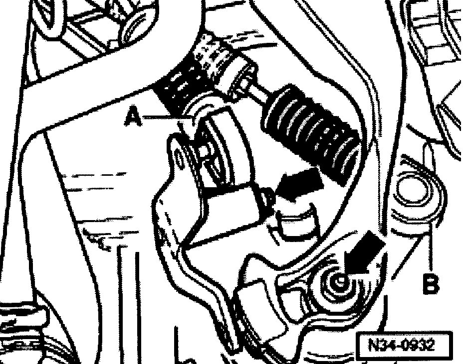

- Remove cable support bracket from transmission (arrows), if necessary unclip hose at cable support bracket first.

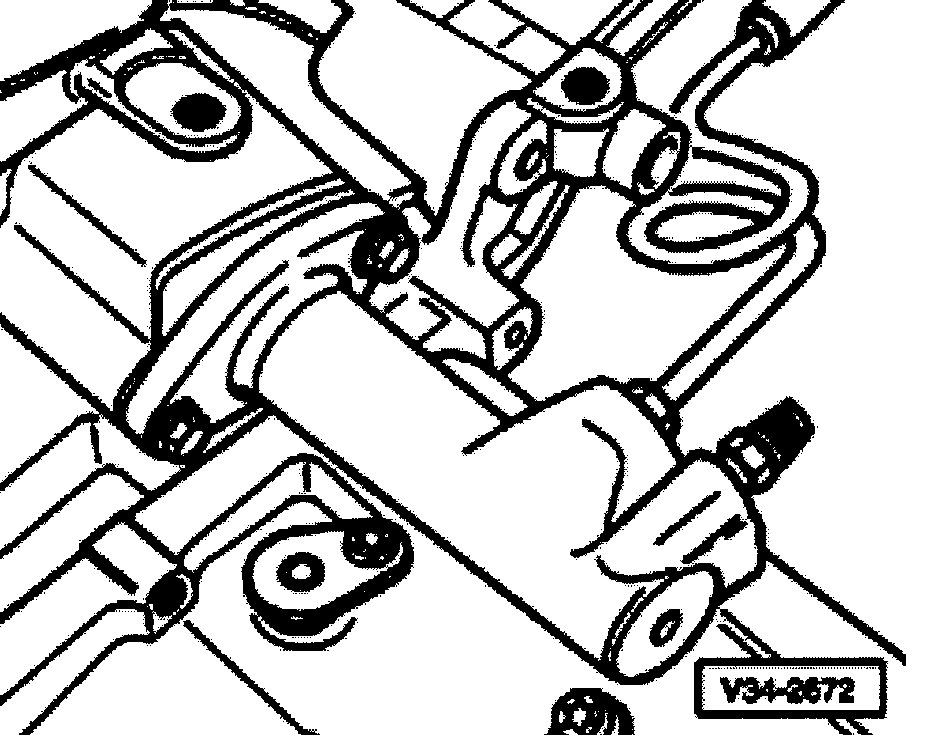

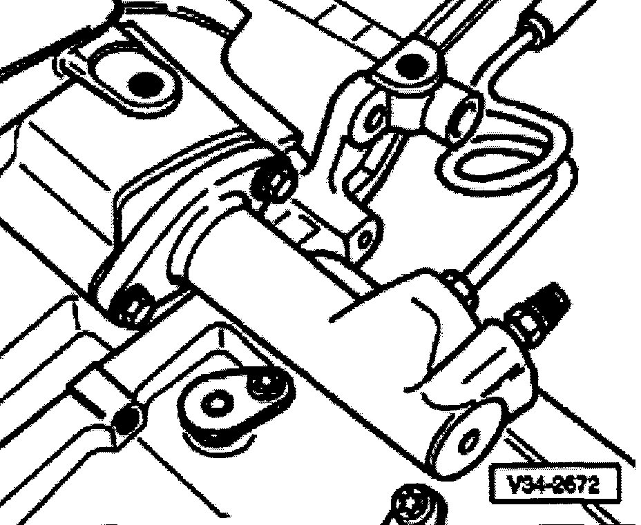

- Remove slave cylinder place to side and secure with wire, do not disconnect lines.
Note: Do not depress clutch pedal.

- Remove cable retainer (arrow -1-) on starter.
- Remove upper securing bolt (arrow -2-) on starter.

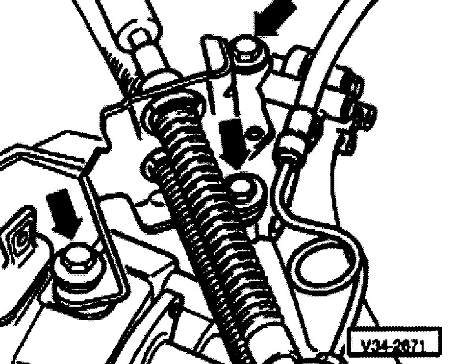

- Remove cable support bracket from transmission(arrows). If necessary unclip hose at cable support bracket first.

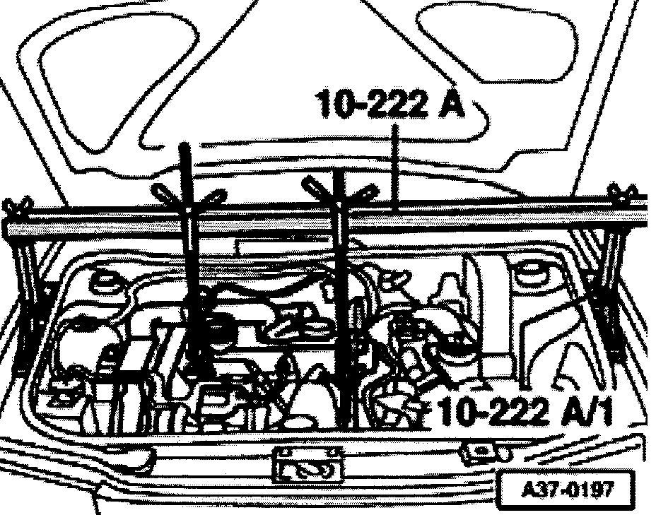

- If there are hoses and cable connections in area of engine mounting eye for support 1 0-222A, remove these now.
pic 14
Continued for vehicles with 4-Cyl. engine
- Fit support bar 1 0-222A together with legs 10222 A/1.
pic 15

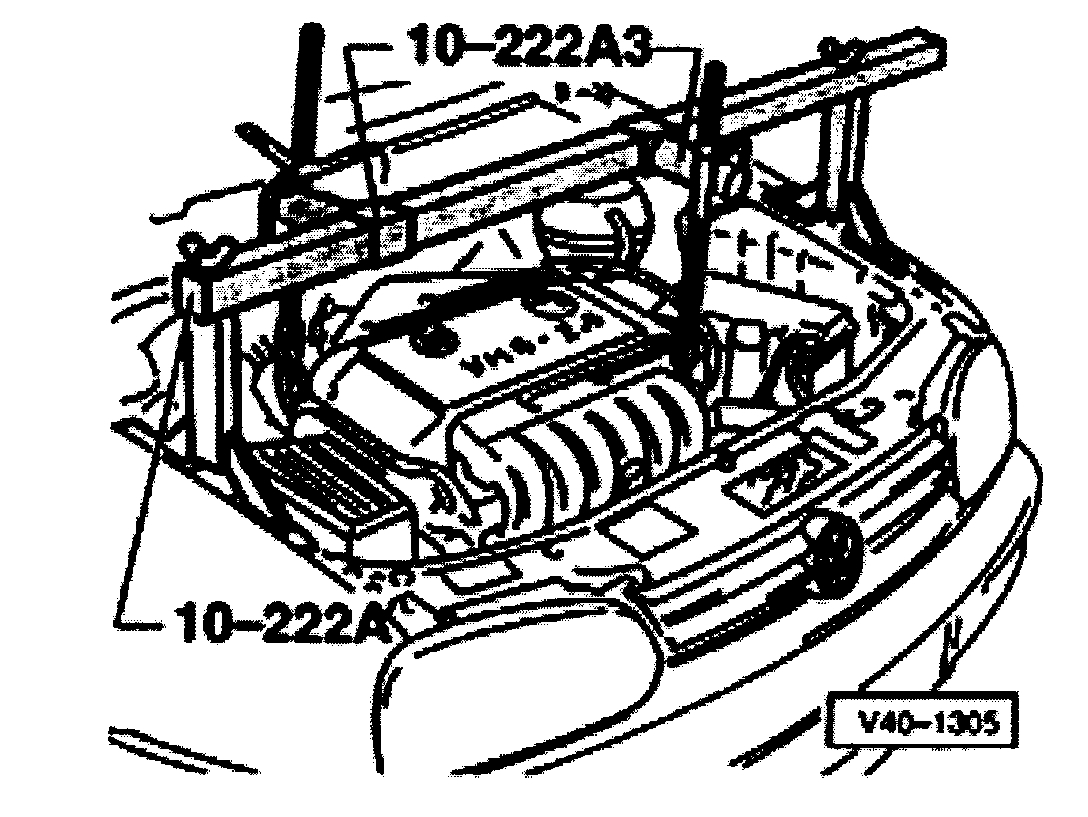

Continued for vehicles with 6-Cyl. engines
- Fit support bar 10-222A together with legs 10222 A/1 and adapters 10-222 A/3.
Continued for all vehicles
- Take weight of engine/transmission assembly on spindles.

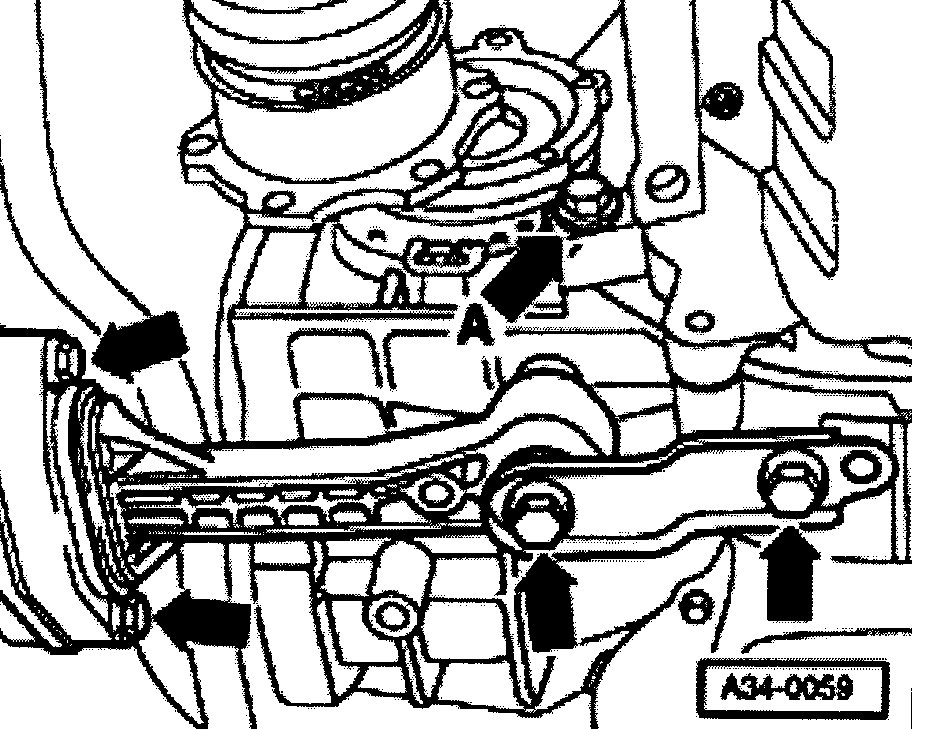

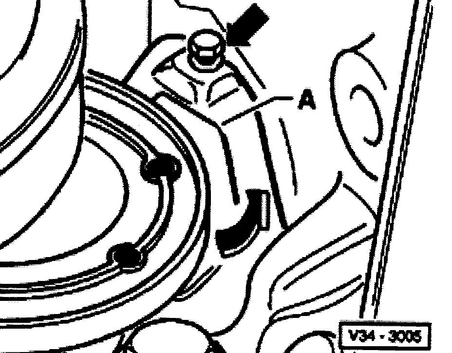

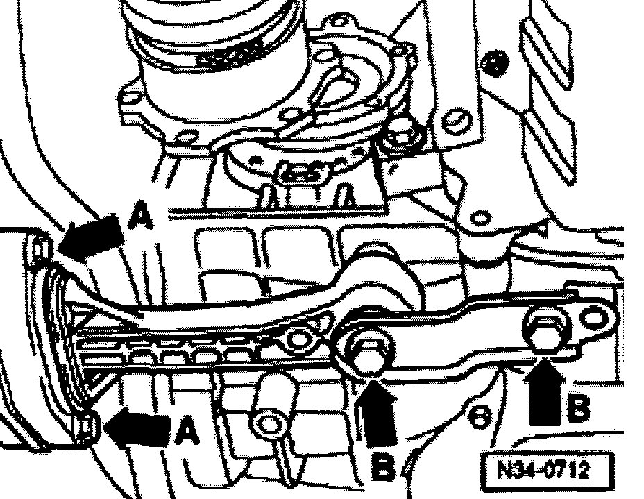

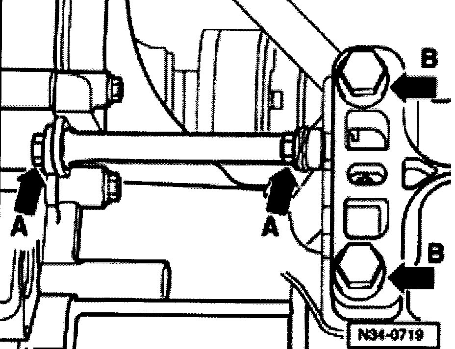

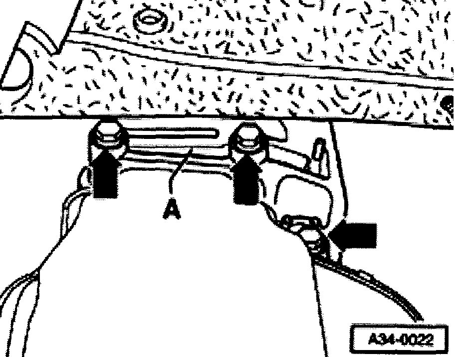

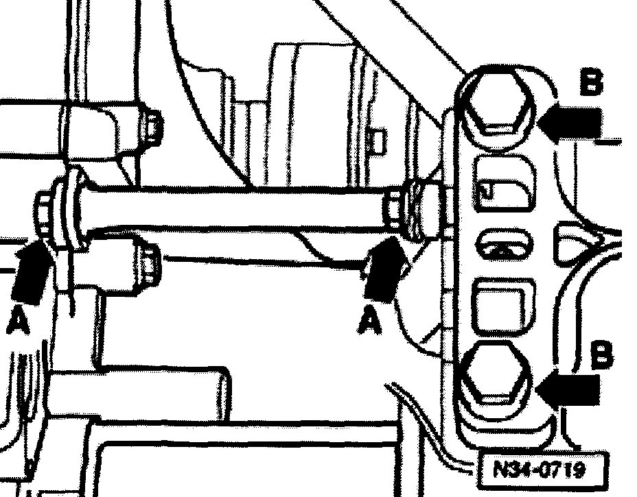

- Remove pendulum support (arrows A and B).
pic 18

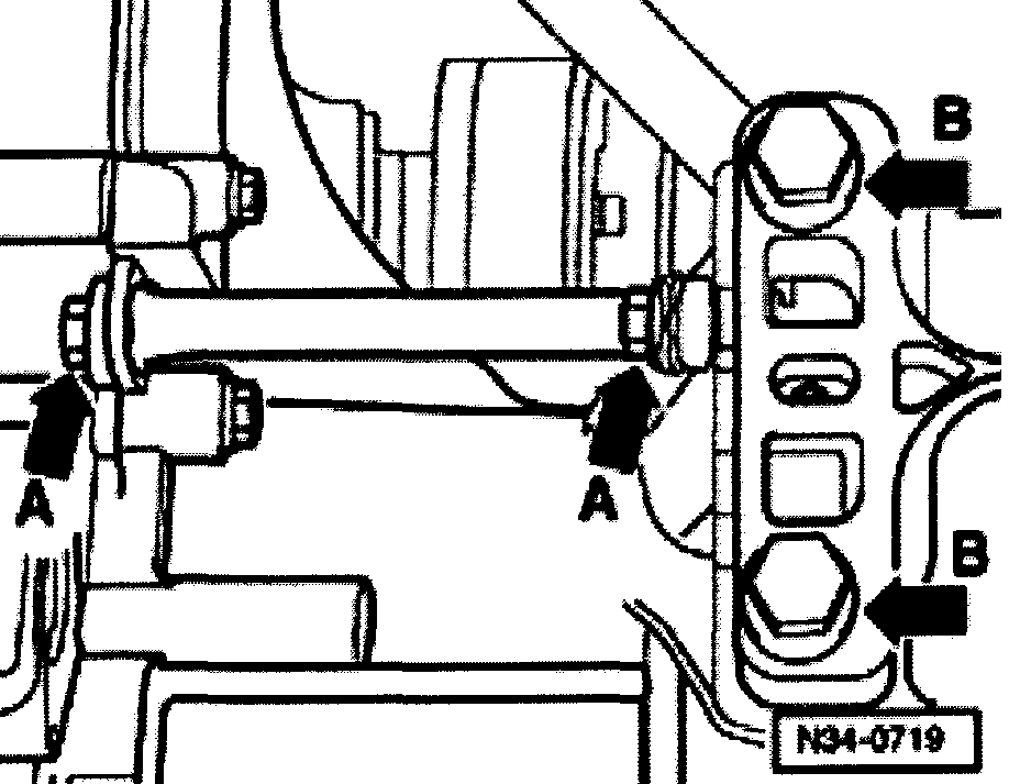

- Remove transmission support (arrow A) from transmission.
- Remove hex bolts (arrows B) from left-hand hand assembly mounting.
- Incline engine/transmission assembly by lowering it via left spindle of support bar 10-222A.
- The transmission mount -A- securing bolts (arrows) must be accessible.
pic 19
- Remove transmission mount -A- (arrows).

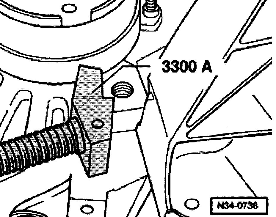

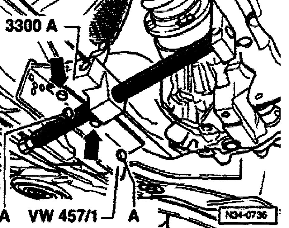

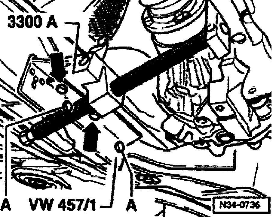

pic 20

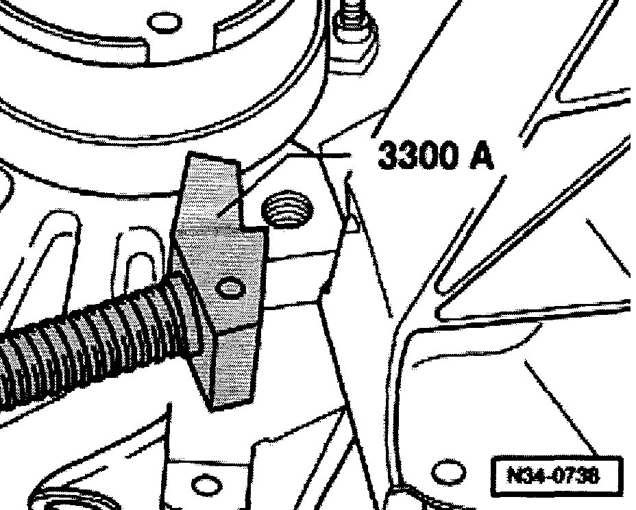

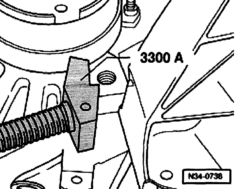

- Bolt support rail VW 457/1 to both pendulum support securing holes on subframe.
- Insert spacers totaling 6 mm between subframe and support rail VW 457/1.
-A- Qty. 2 hex bolts M 8 x 25
- Fit support 3300 A and secure (arrows).
pic 21
Vehicles with 5 valve engine
- Remove a lower engine/transmission securing bolt so that support 3300 A can be installed.
The support 3300 A must be installed directly next to the transmission on the engine.

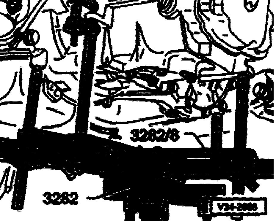

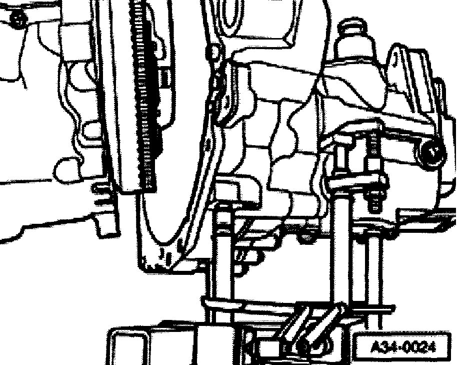

- Assemble transmission jack with transmission support 3282, adjustment plate 3282/8 for "02A" transmission and support elements as follows:
- Place adjustment plate 3282/8 on transmission support 3282 (adjustment plate only fits in one position).
- Align arms of transmission support according to holes in adjustment plate.
pic 22
- Bolt support elements -A-, as illustrated, on adjustment plate.
pic 23
- Place transmission jack under vehicle.
- Align adjustment plate parallel to transmission and lock safety supports on transmission.
- Remove lower engine/transmission securing bolts.
pic 24
- Press transmission off dowels and carefully swing towards subframe.

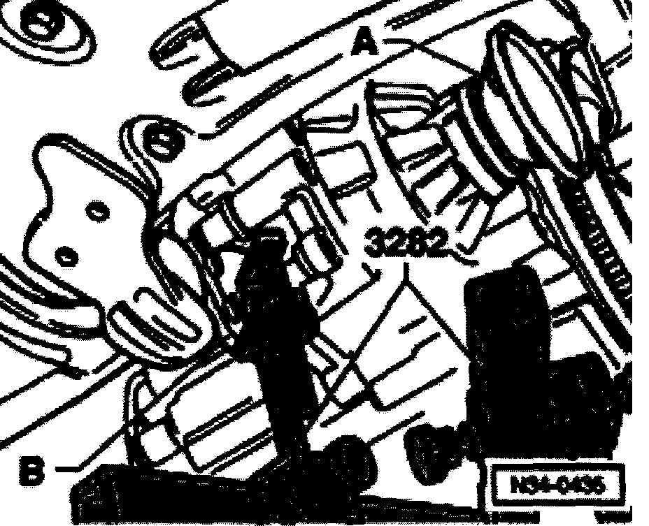

- Lower transmission slightly and incline to left via spindles of transmission support 3282.
pic 25
- Lower transmission carefully guiding right-hand flange shaft -A- in area of flywheel as illustrated. Guide left-hand flange shaft -B- in area of subframe.
Note:
- When lowering, change position of transmission using the transmission support 3282 spindles.
- Do not damage power steering line when lowering transmission.

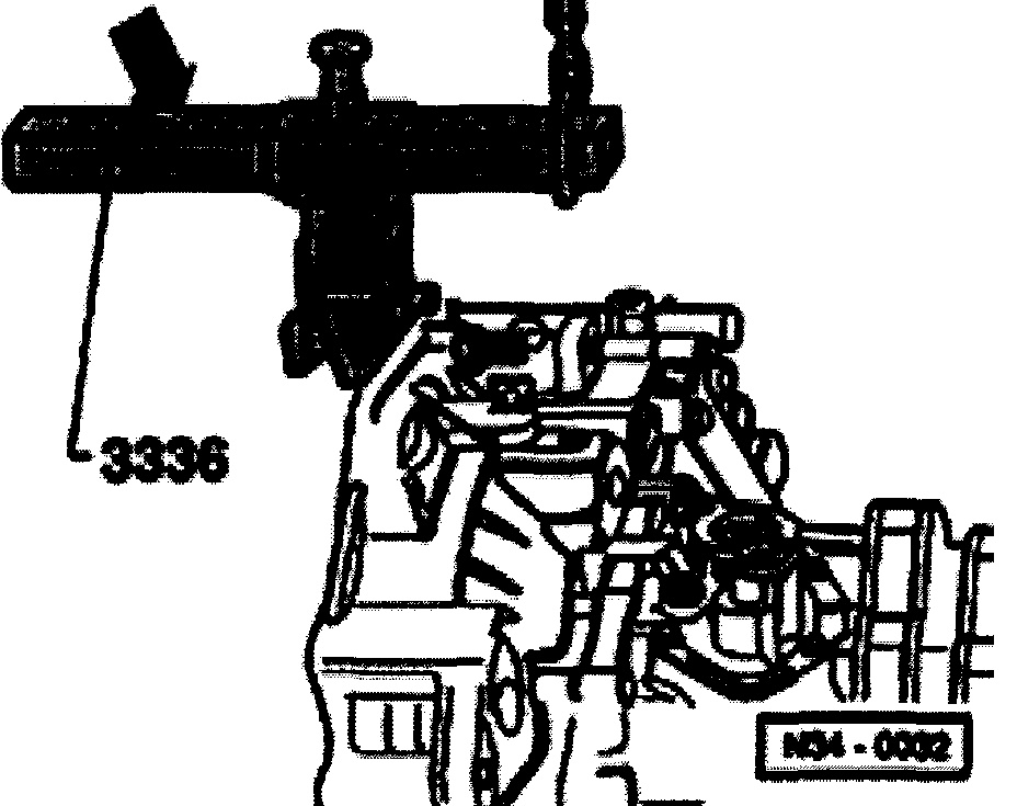

Transporting the transmission
pic 26

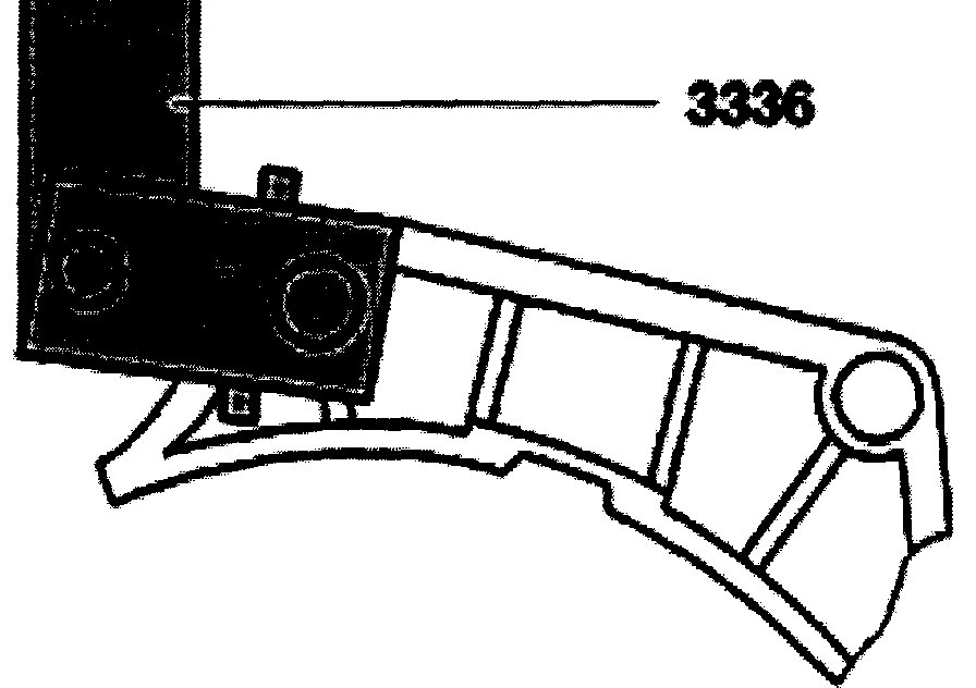

- Bolt transmission lifting device 3336 to clutch housing.
pic 27
- Set support arm on sliding piece with locking pin (arrow).
No. of holes visible = 5
- Lift transmission with workshop crane and transmission lifting device 3336.
- Place transmission, for example, onto transport container.

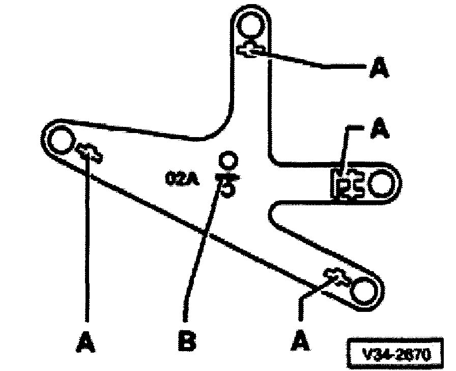

- Align adjustment plate and transmission parallel with one another and lock safety supports on transmission.
pic 33
- Place transmission jack under vehicle, arrow symbol -B- (= Illustration V34-2670) on adjustment plate points to front of vehicle.
- Incline transmission to left via spindles of transmission mounting 3282.

- Install cable support bracket on transmission (arrows), if necessary push hose onto cable support bracket.

- Install gear selector cable -B- and balance weight -A- on gear selector lever.
- Lift tab in direction of arrow and fit gate selector cable on follower/relay lever -C-.

- Attach reverse light connector (arrow 2). Attach all other electrical connections and ground wires to transmission and to engine/transmission securing bolts.
- Attach connector to speedometer sensor (arrow 1).
- Assemble air intake duct.

- Fit gear selector cable -B- with transmission selector lever (arrow).
- Fit gate selector cable -A- with relay lever and secure (arrow).

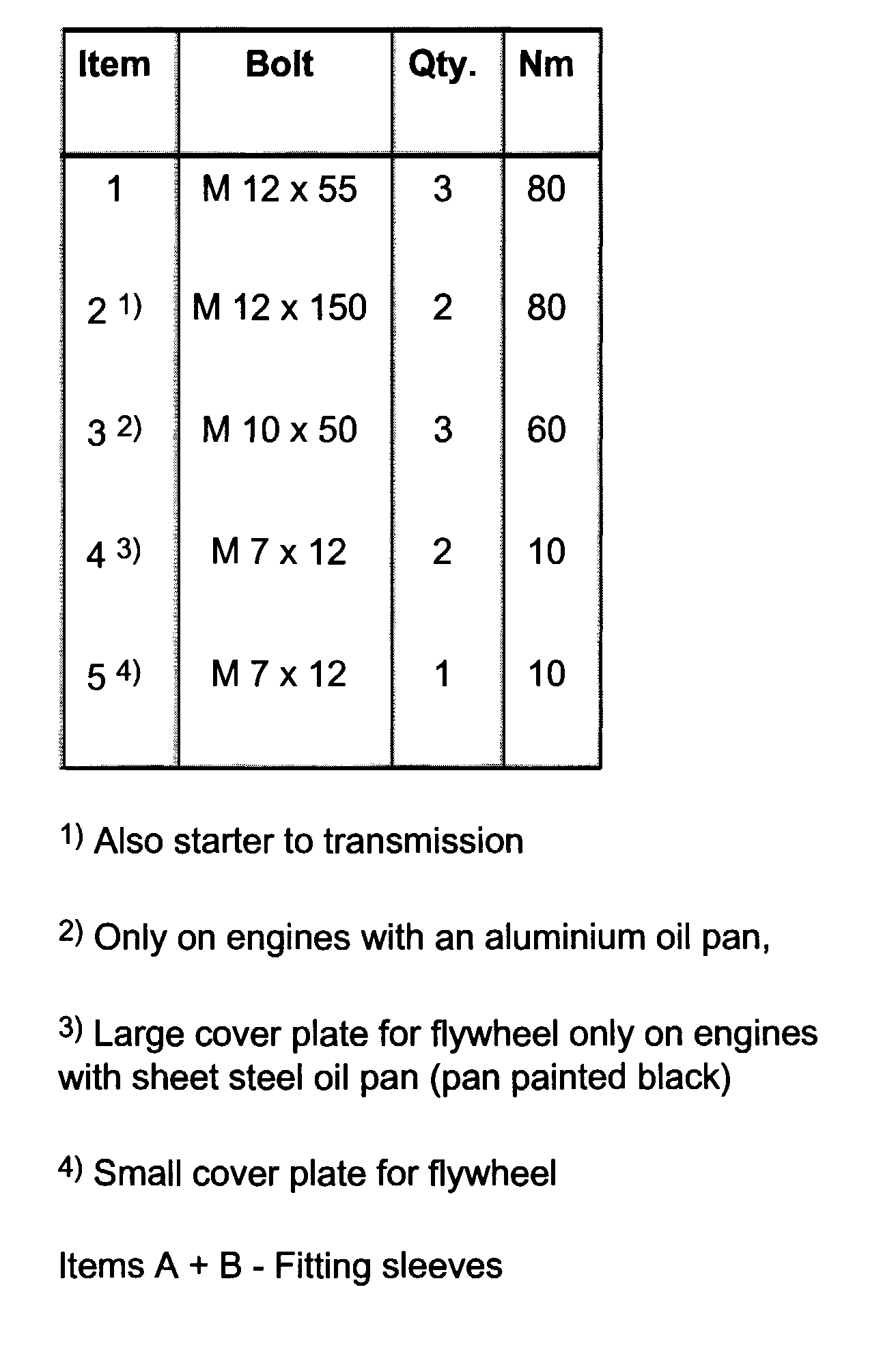

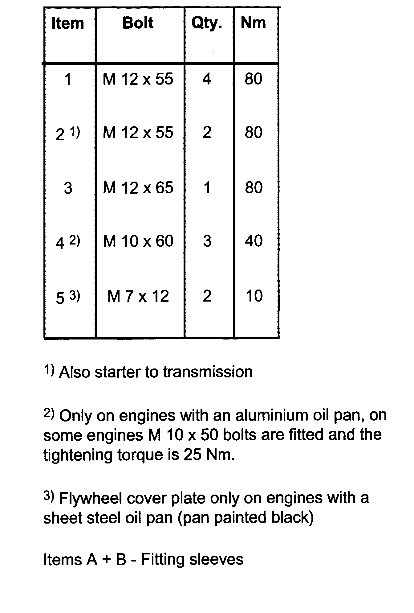

Tightening torques
Transmission to engine
pic 46
pic 47
Vehicles with 4-Cyl. engine
1. Also starter to transmission
2. Only on engines with an aluminum oil pan,
3. Large cover plate for flywheel only on engines with sheet steel oil pan (pan painted black)
4. Small cover plate for flywheel
Items A + B - Fitting sleeves
pic 48
pic 49
Vehicles with 6-Cyl. engine
2. Only on engines with an aluminum oil pan, on some engines M 10 x 50 bolts are tiffed and the tightening torque is 25 Nm.
3. Flywheel cover plate only on engines with a sheet steel oil pan (pan painted black)
pic 50
Transmission mount -A- to transmission 50 Nm + 90°
- Replace bolts.
pic 51
Transmission to body
Bolts -A- 25 Nm
Bolts-B- 100 Nm
pic 52
Rear transmission mounting
Bolts -A- 20 Nm + 90°
Bolts-B- 40 Nm + 90°
- Replace bolts
Note: Install engine transmission mountings stress free.
Selector cable support bracket to transmission 25 Nm
Selector cable bolt to transmission selector lever 25 Nm
Balance weight to transmission selector lever 25 Nm
Transmission selector lever to transmission 20 Nm
