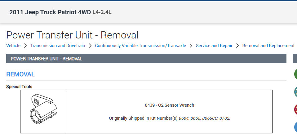

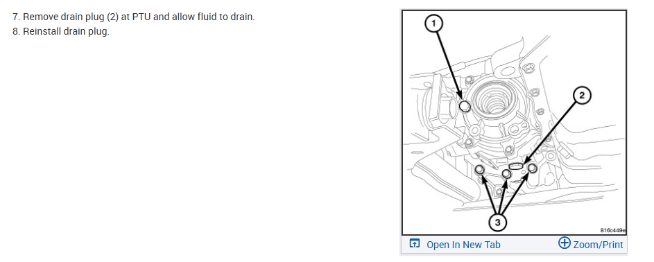

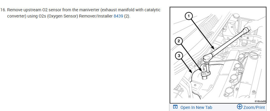

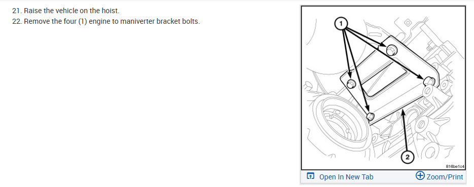

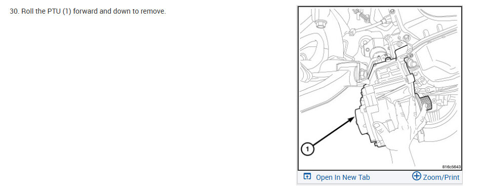

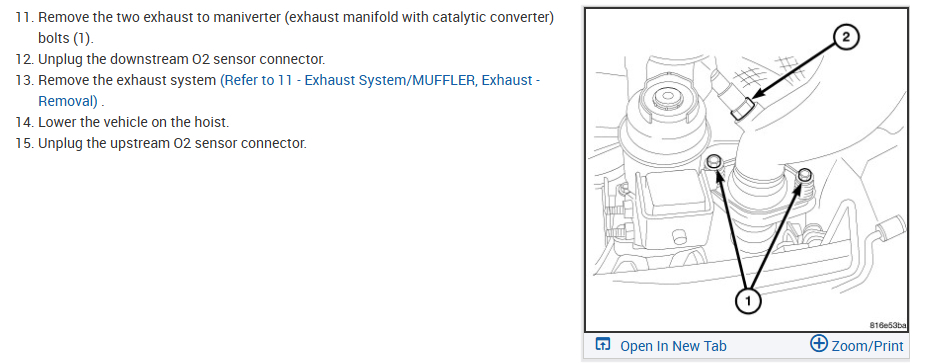

Hi:

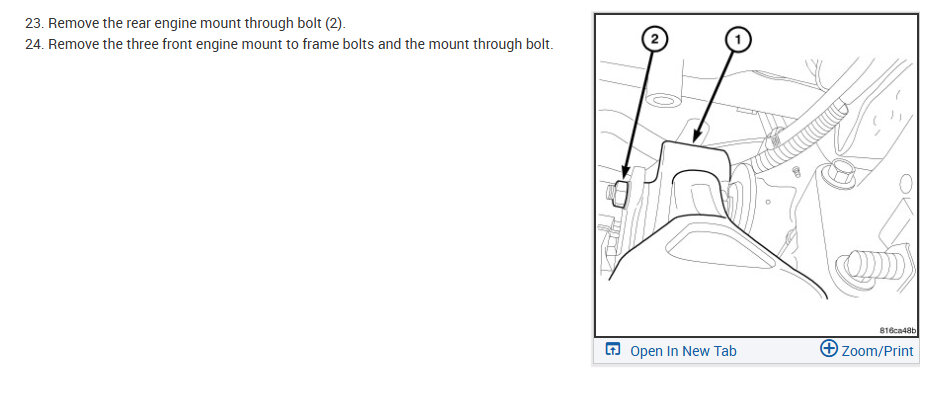

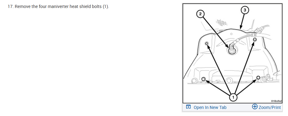

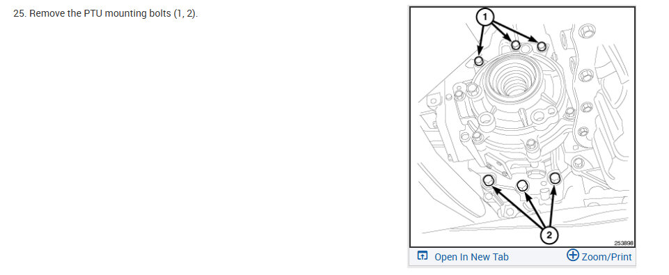

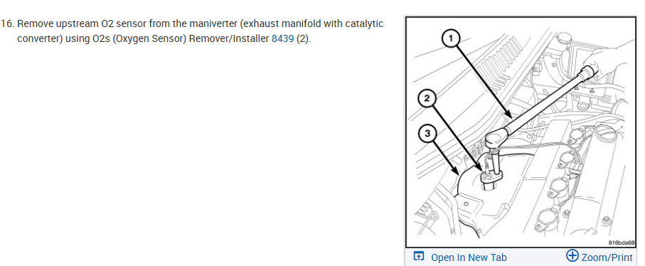

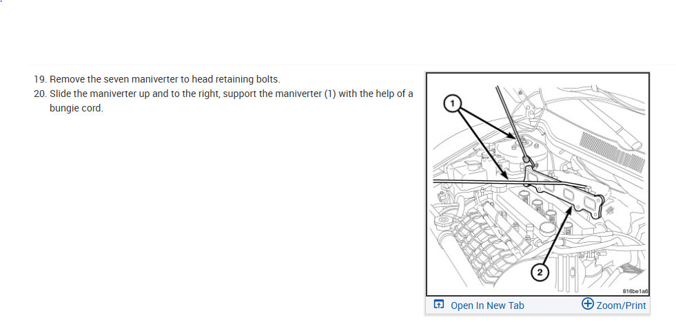

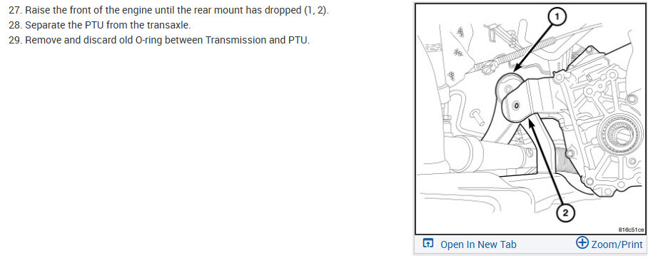

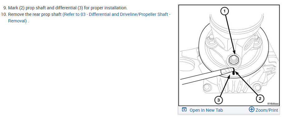

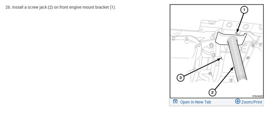

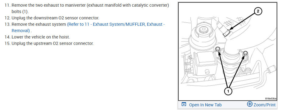

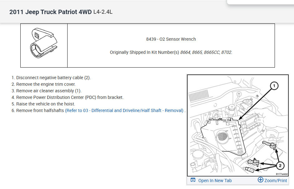

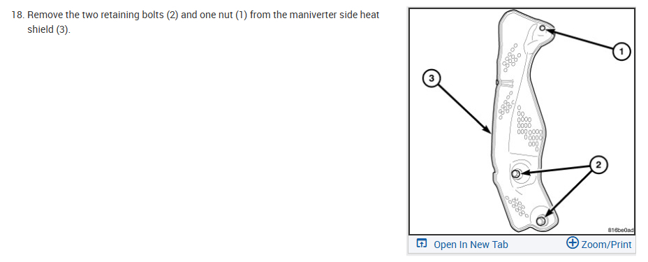

Below, I have attached the directions for removing the transfer case from the vehicle. I believe this is what you are looking for. If that isn't correct, please let us know.
Take your time when doing this. You will need to support the engine at different points. Additionally, the exhaust manifolds must be removed. Lubricate them to prevent damage or one breaking.
Let us know if you have questions.
See pics below
