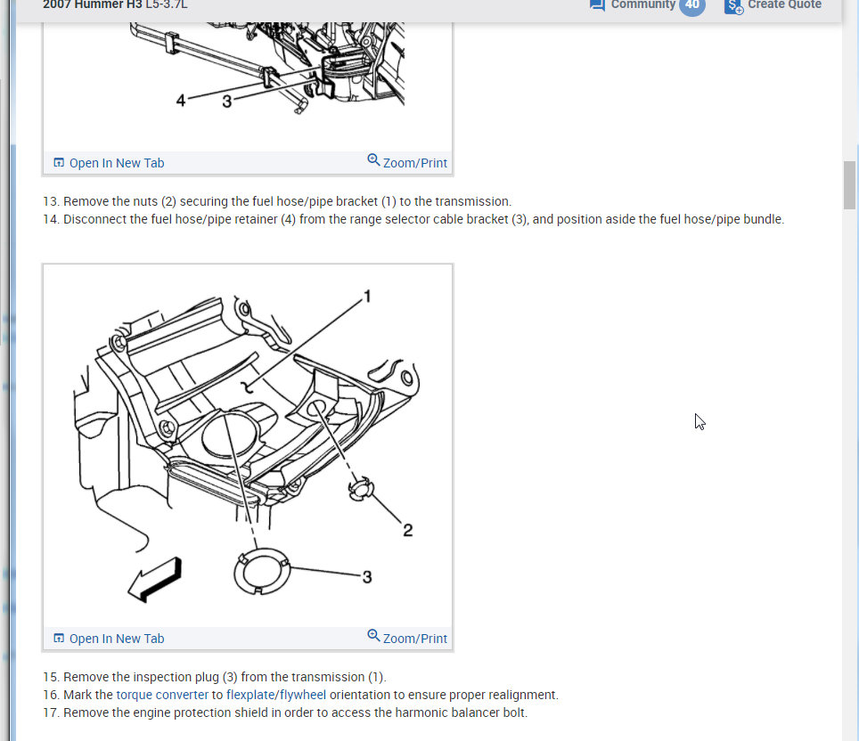

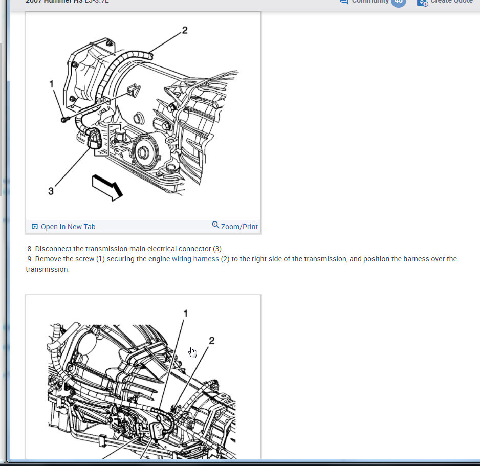

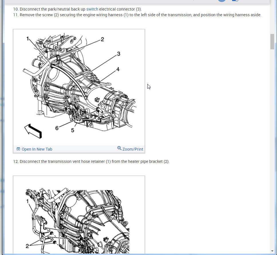

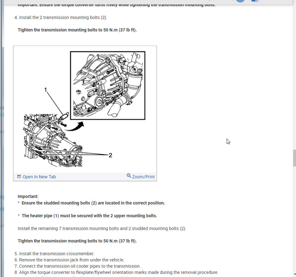

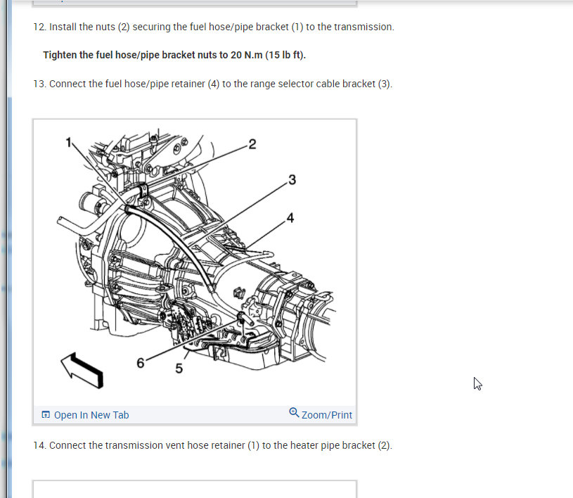

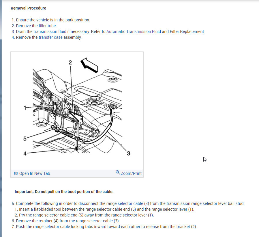

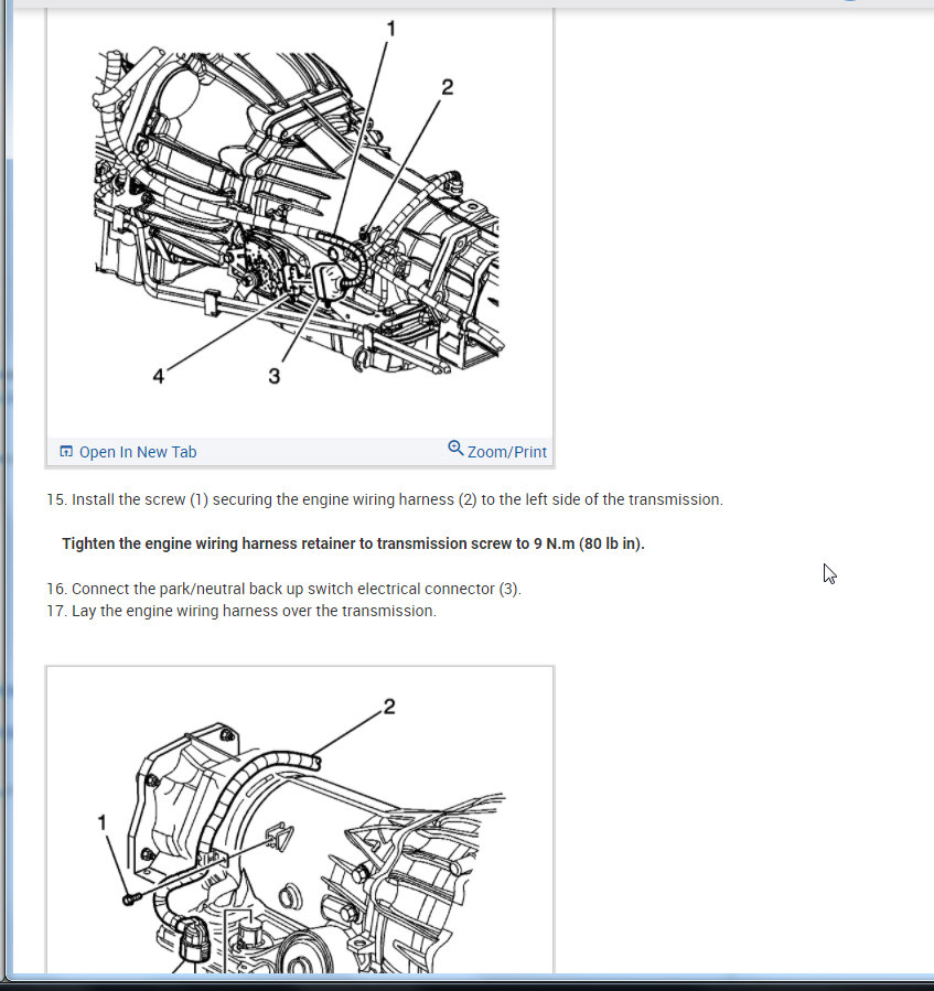

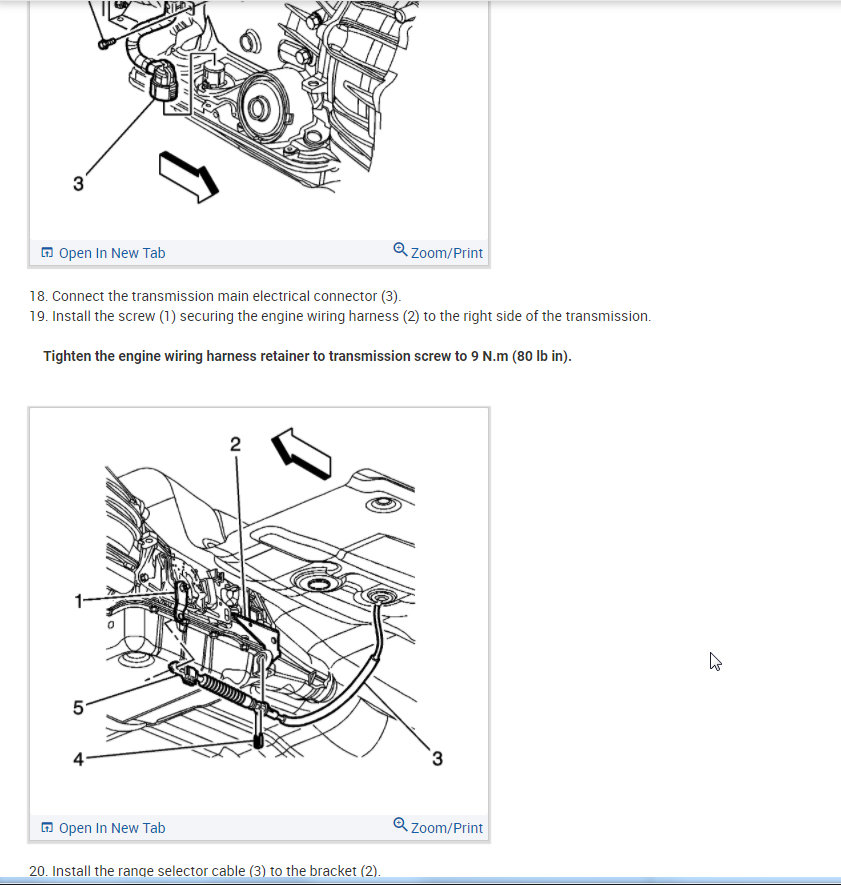

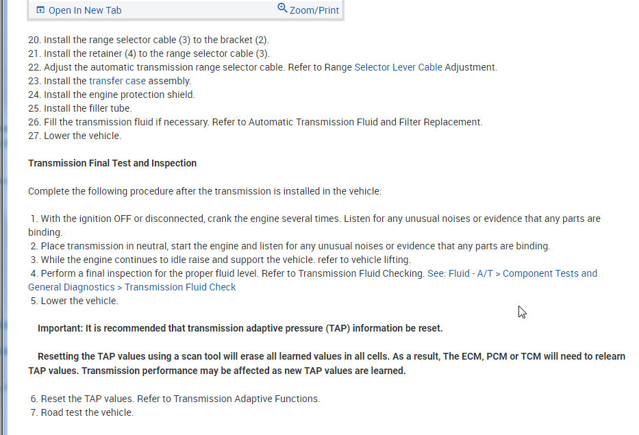

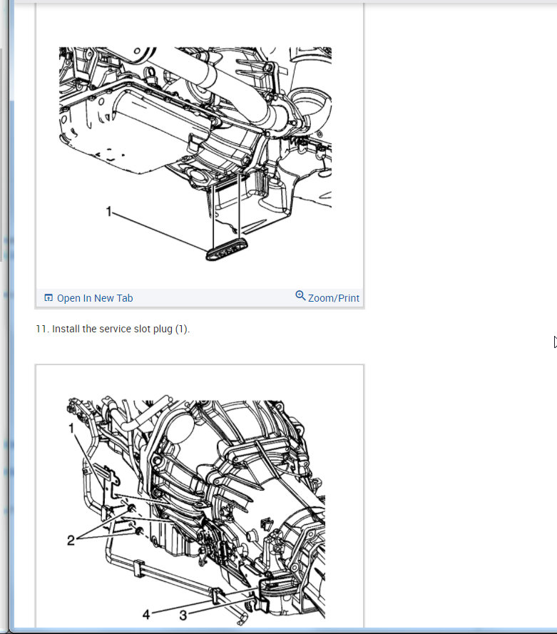

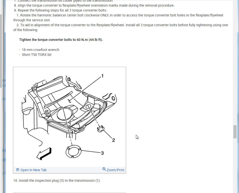

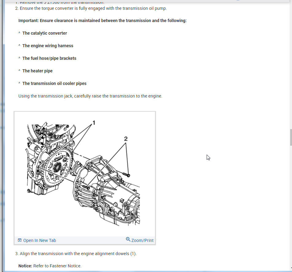

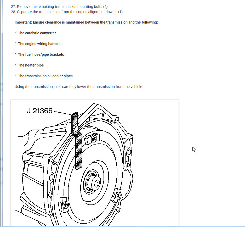

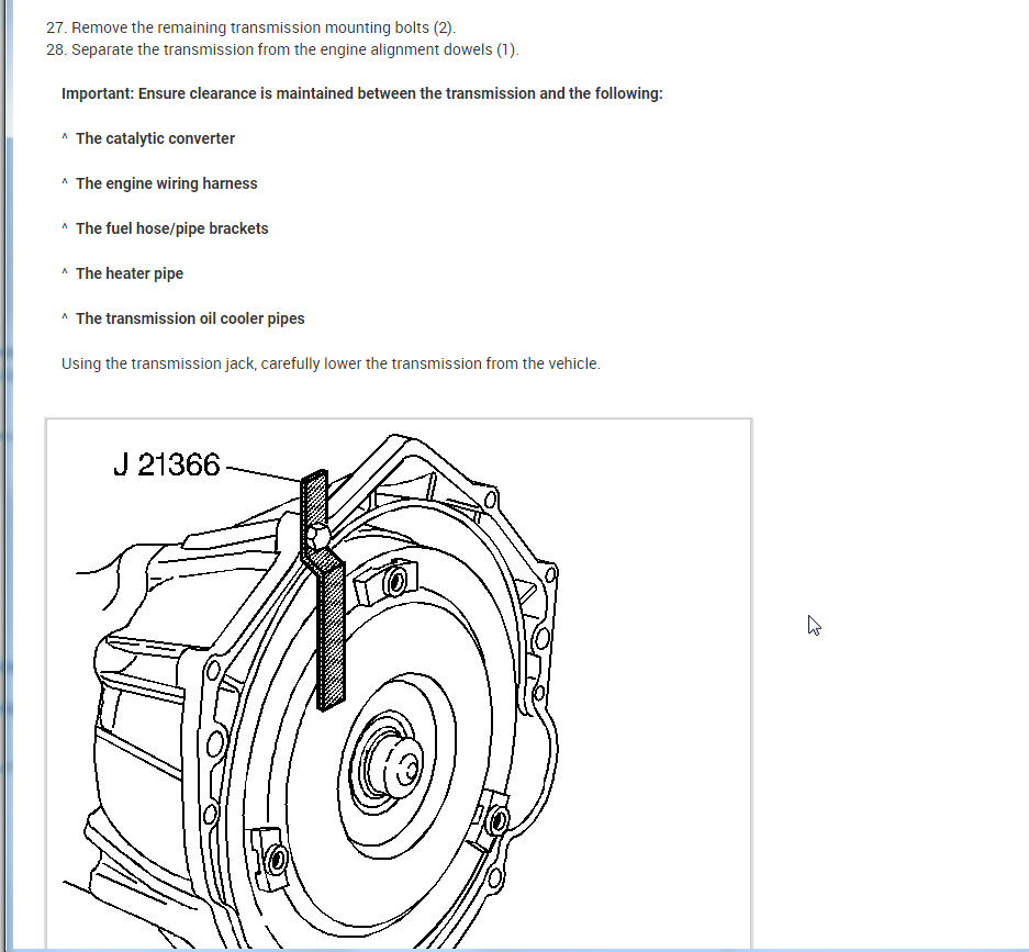

Does the starter need to be removed in order to remove the transmission?
Dec 11, 2020 at 5:38 AM

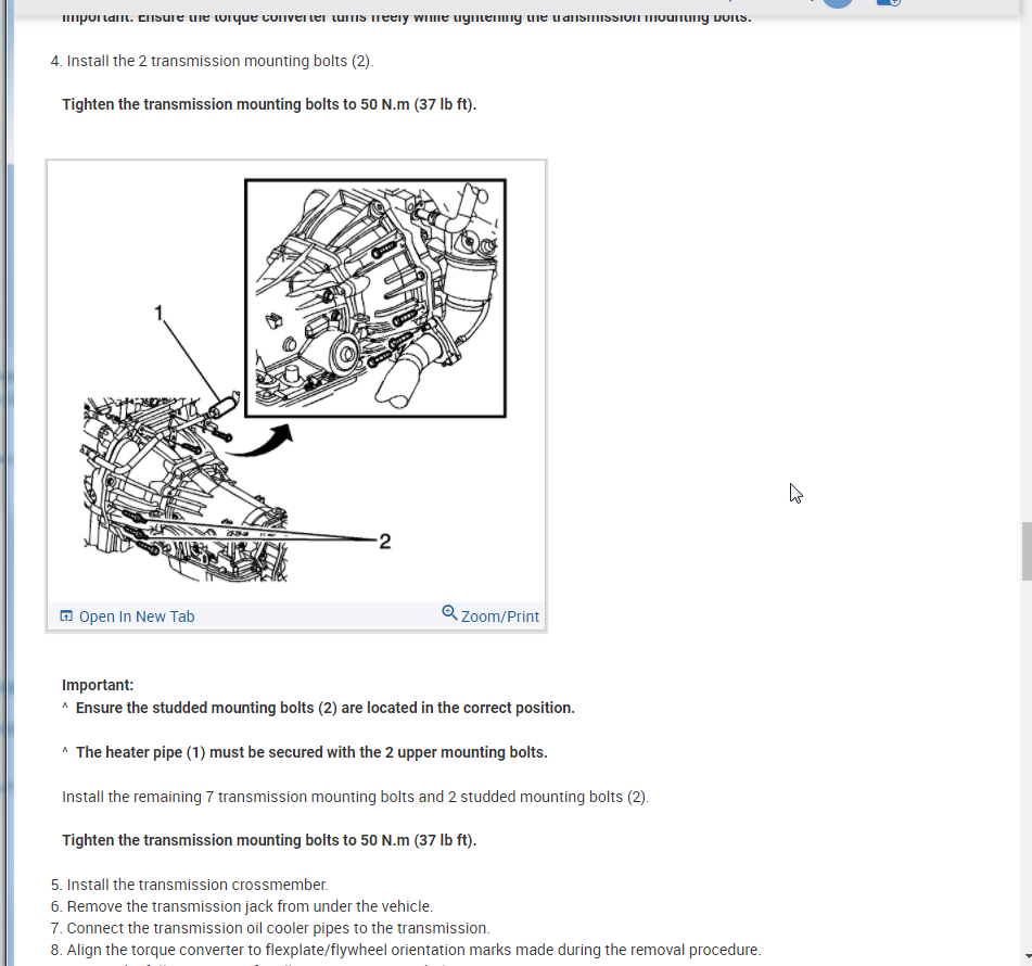

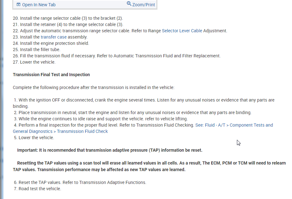

Usually the starter is mounted on the engine side of where the engine and transmission mount. If this is the case then you do not need to remove it. It will stay on the engine. Here is a video that shows how to remove a transmission in case you need this:
https://youtu.be/3vJAojsrfuU

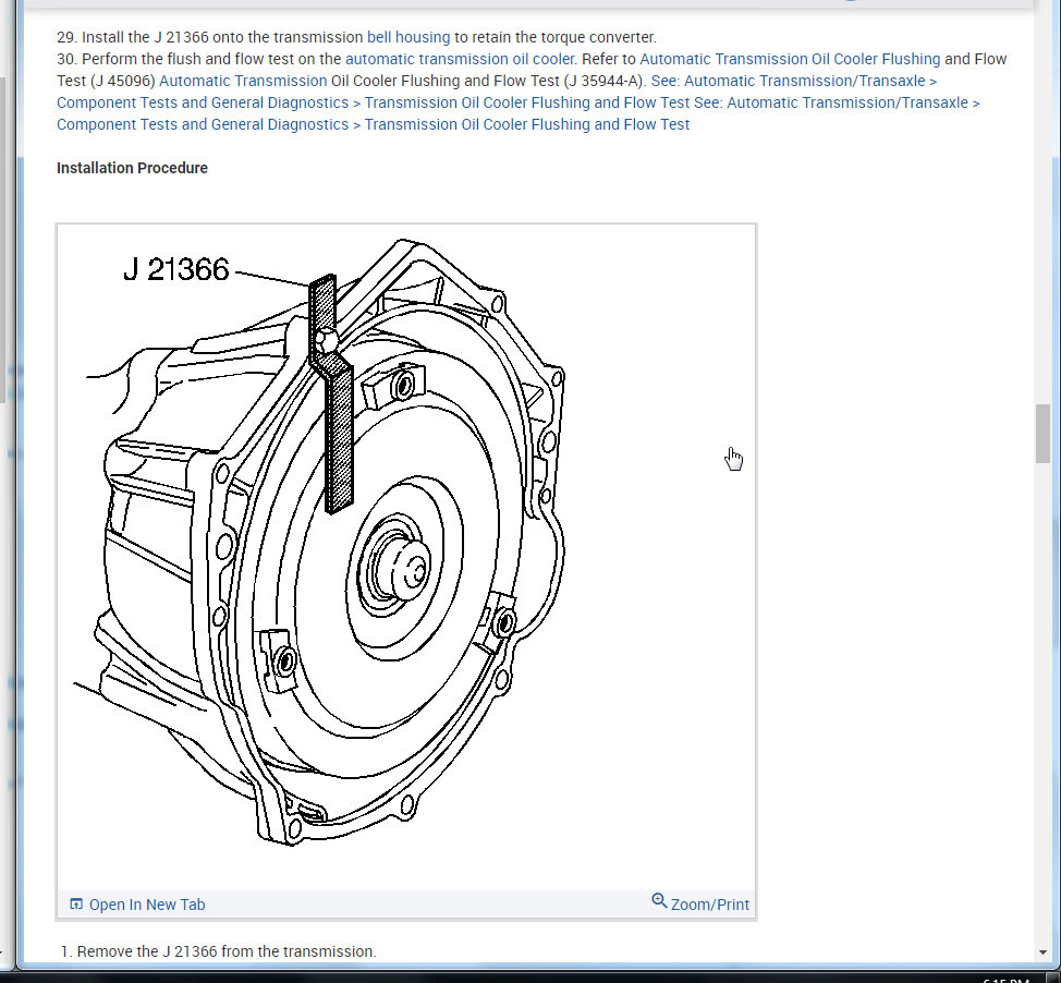

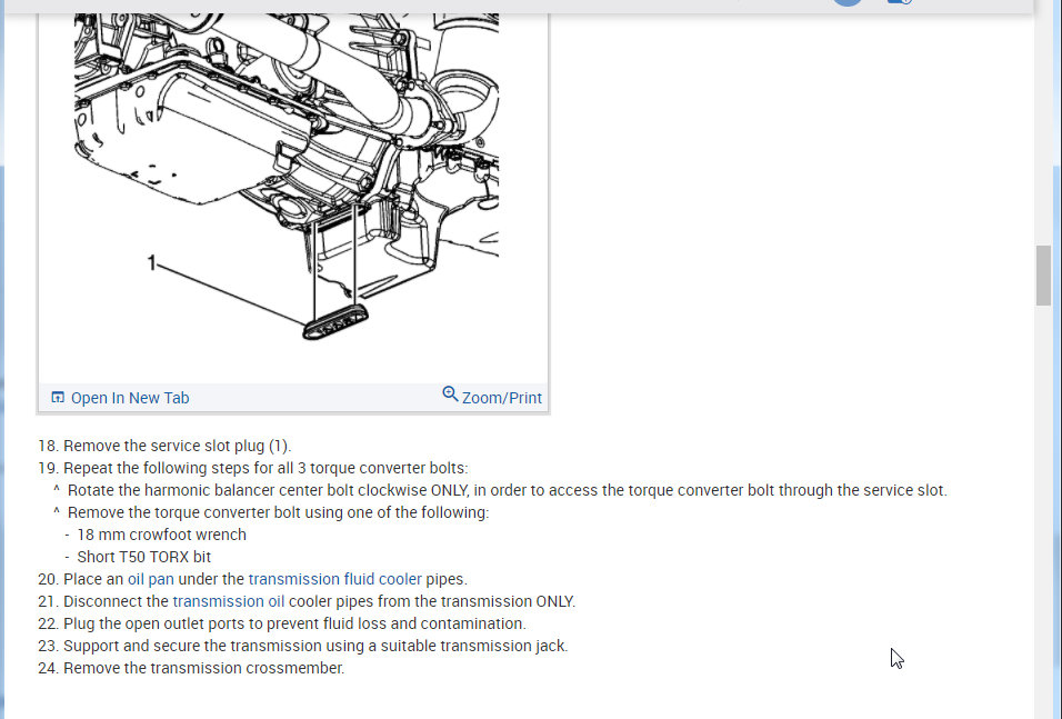

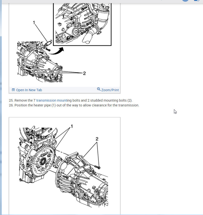

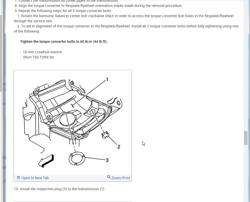

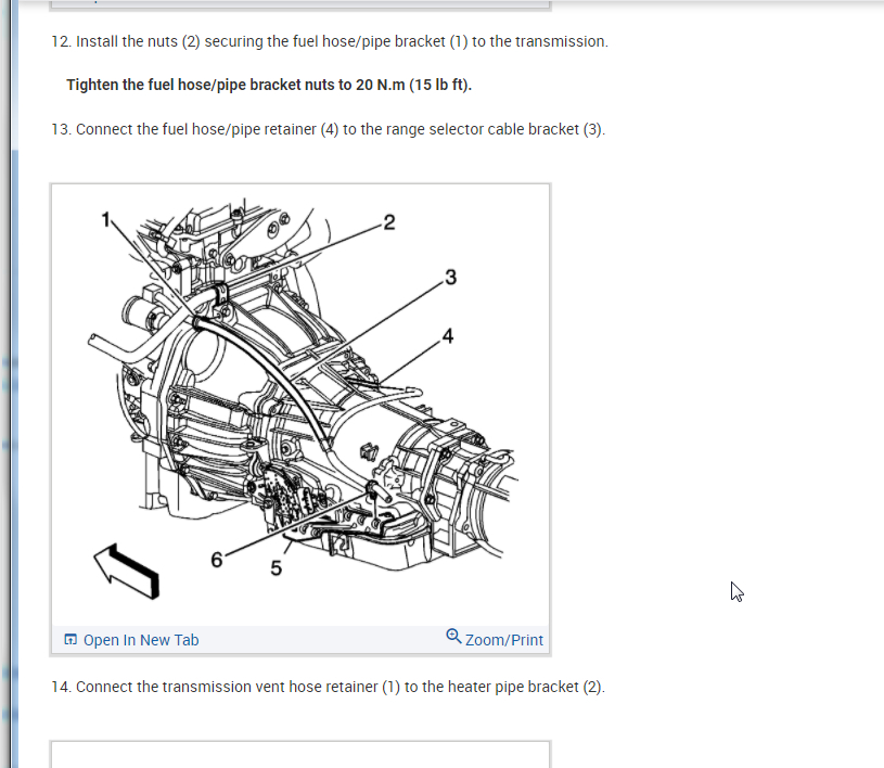

Also, I attached the entire process from the manual for this vehicle in case you need that as well. Thanks
Dec 11, 2020 at 7:20 AM
