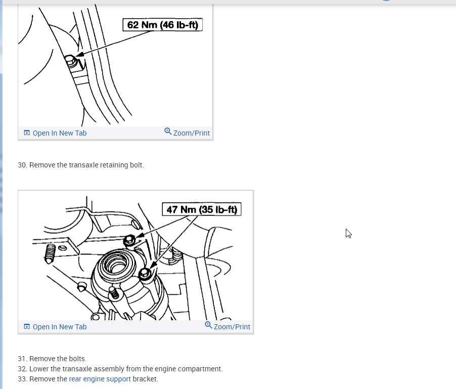

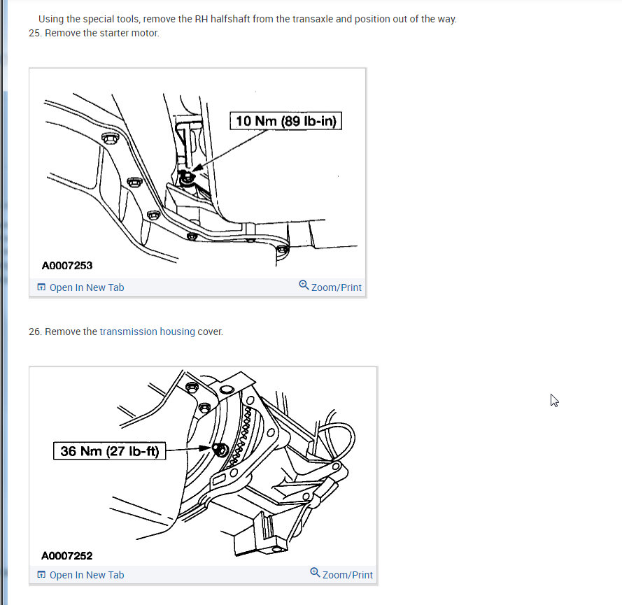

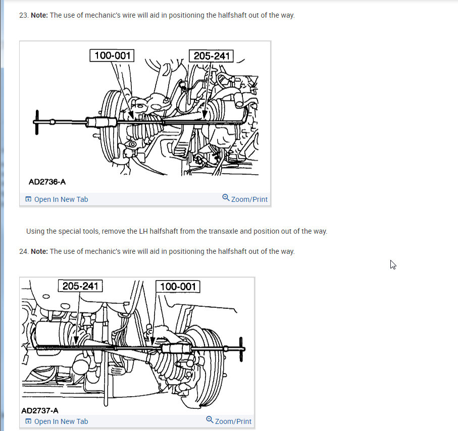

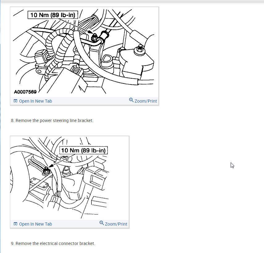

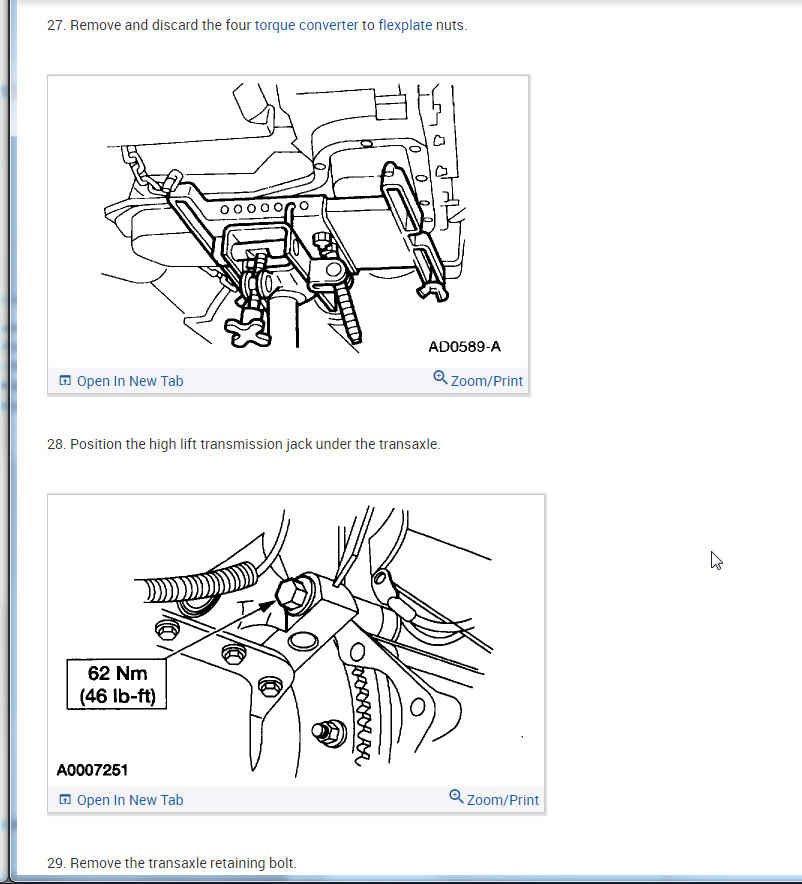

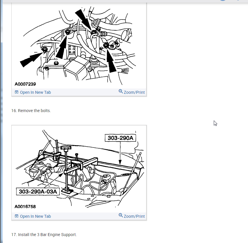

Which replacement parts in the car listed above se ohv sedan with an ax4s transmission require the removal of the transmission to get to/at?
Jul 26, 2019 at 2:30 AM
Experienced Mechanic
18,907 POSTS
Here is a guide that will help with this:
https://youtu.be/3vJAojsrfuU
Plus below is the complete process on this which will give you all the detail that you need to complete this.
Please let us know what questions you have and we can go from there. Thanks
