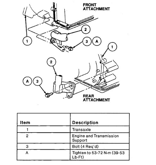

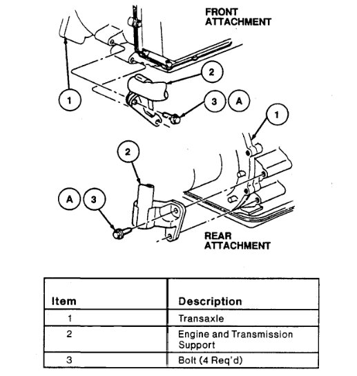

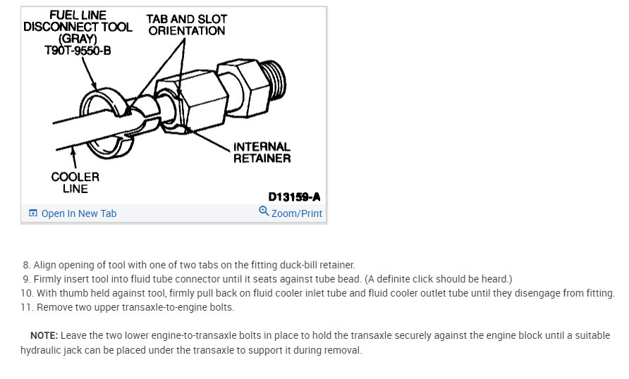

I cannot find the manual to remove the transmission on the vehicle listed above. Can anyone source me a good, detailed informational manual please?
Oct 6, 2023 at 12:42 PM
  • 110,251 POSTS

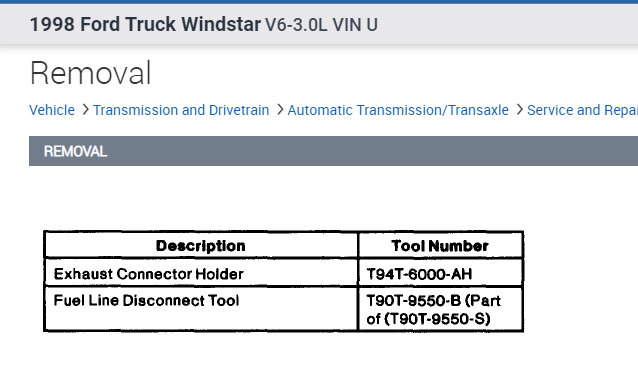

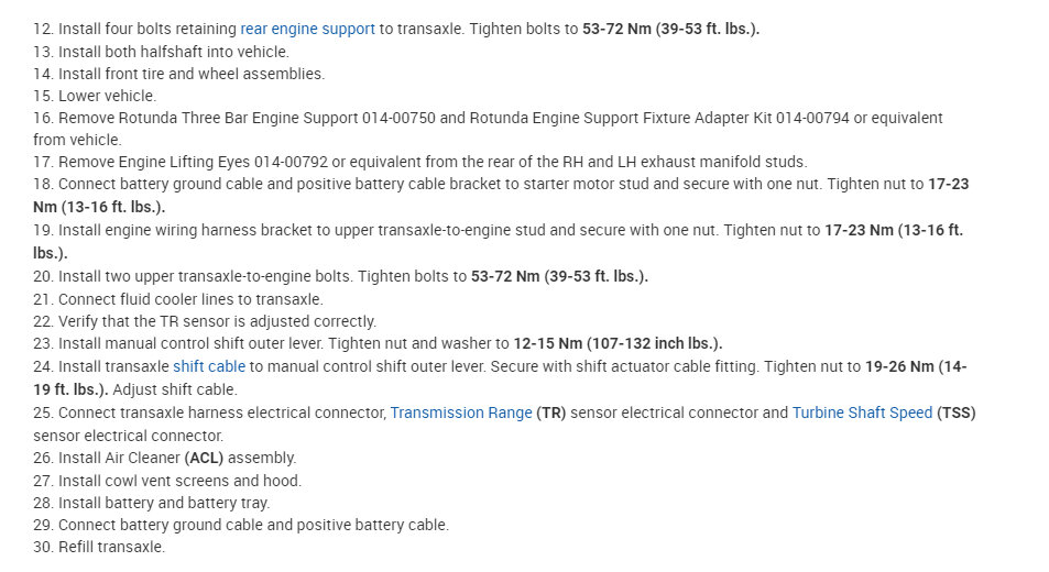

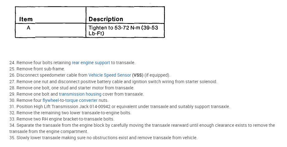

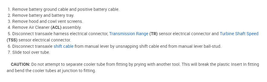

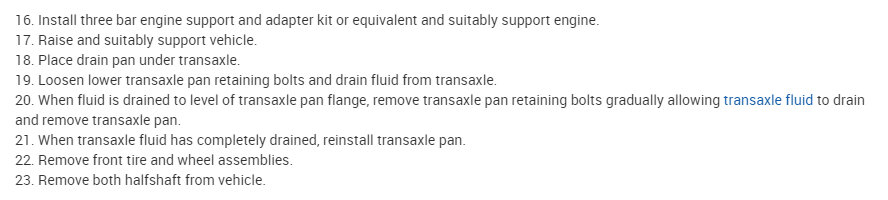

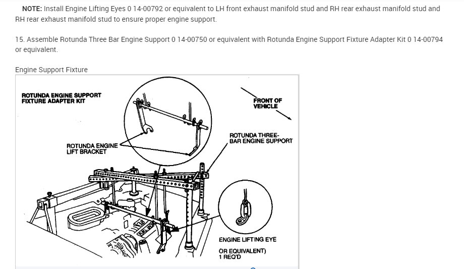

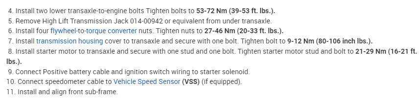

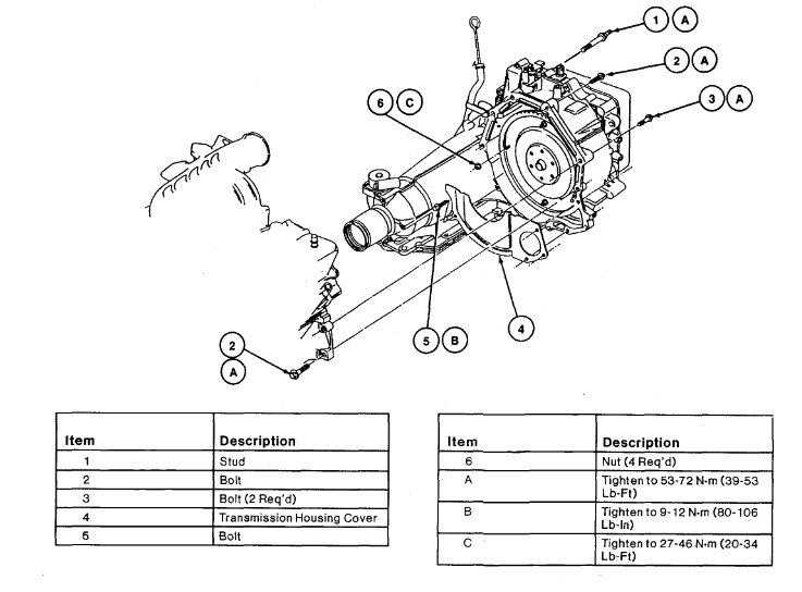

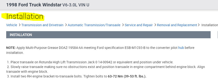

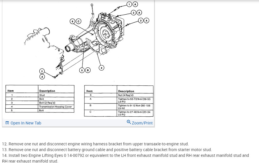

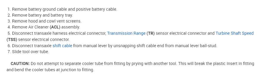

When you do this, it will require a few special tools. Specifically, you will need an engine support. If you look below, I attached the directions for both the removal and installation of the transaxle.
Take a look through the directions and let me know if you have questions or if they help. These directions are from Alldata which is one of the best.
I hope this helps.
