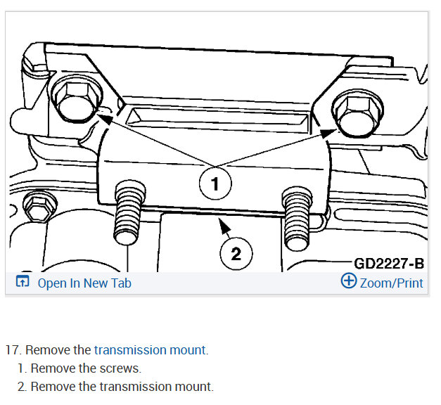

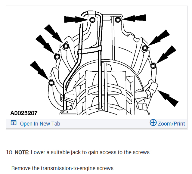

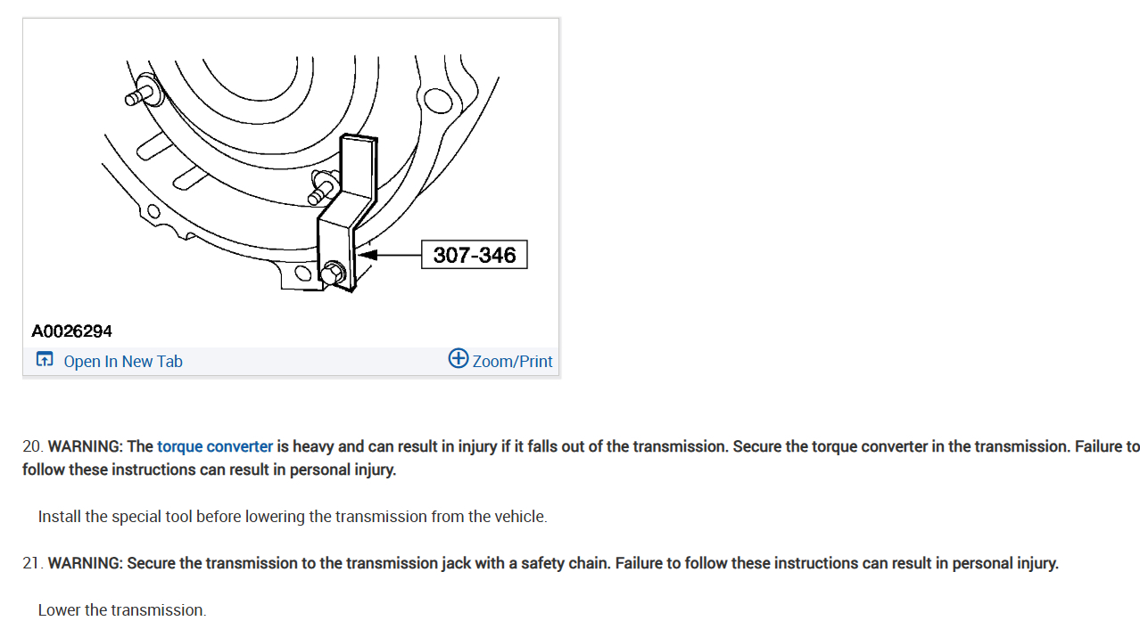

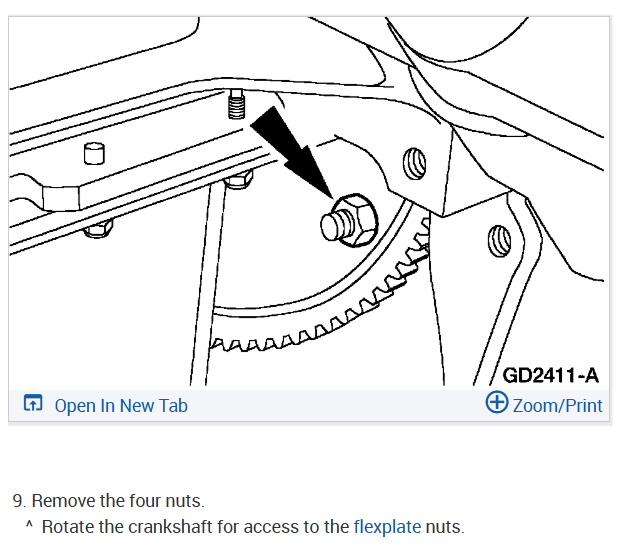

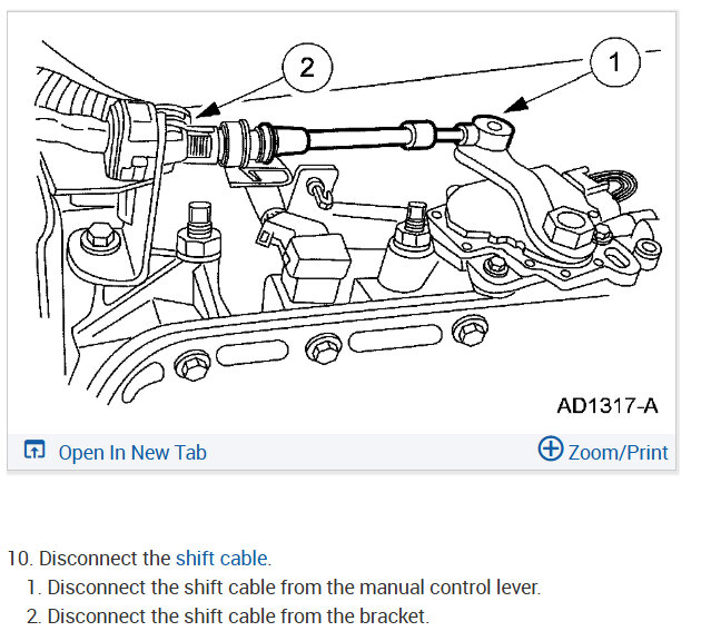

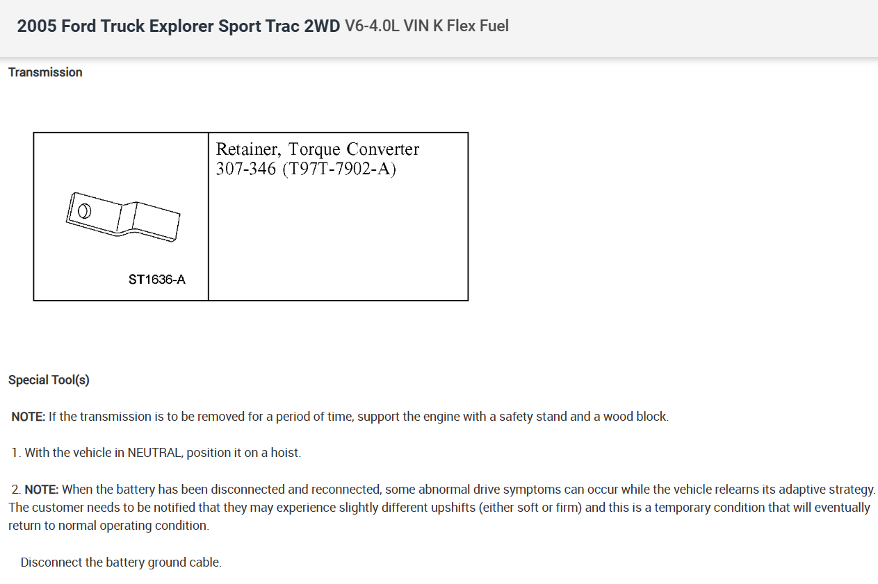

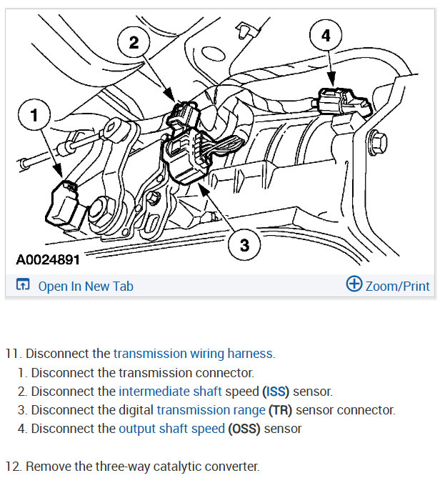

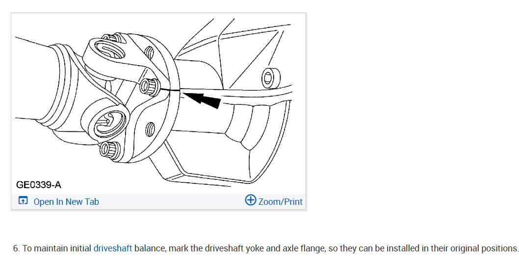

Good afternoon esteemed geniuses, wondering if you have the info for replacing the transmission in my vehicle listed above.
Thanks much.
Nov 22, 2024 at 2:27 AM
  • 55,604 POSTS
Yep, we sure do! Also, here is a video of the job being done on a similar vehicle which can give you an idea of what your job will entail.
https://www.youtube.com/watch?v=3vJAojsrfuU&t

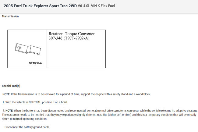

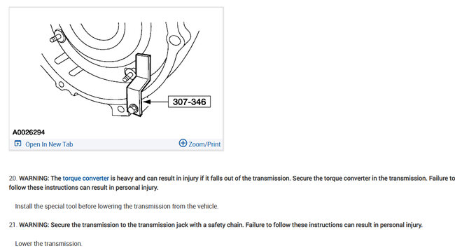

I would watch this video as well so when you reinstall the transmission you get the torque converter installed correctly. If you don't it will damage the front pump of the transmission and it will need to come back out for repairs.
https://www.youtube.com/watch?v=ZC7xHVMKLRw

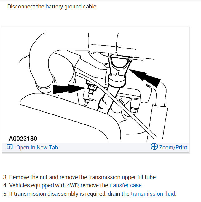

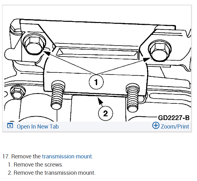

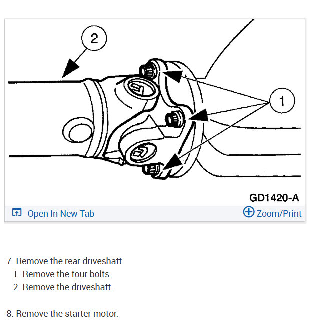

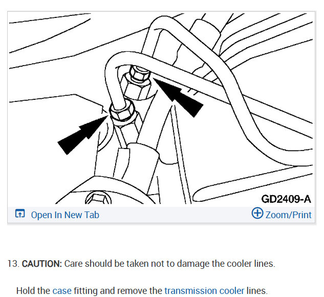

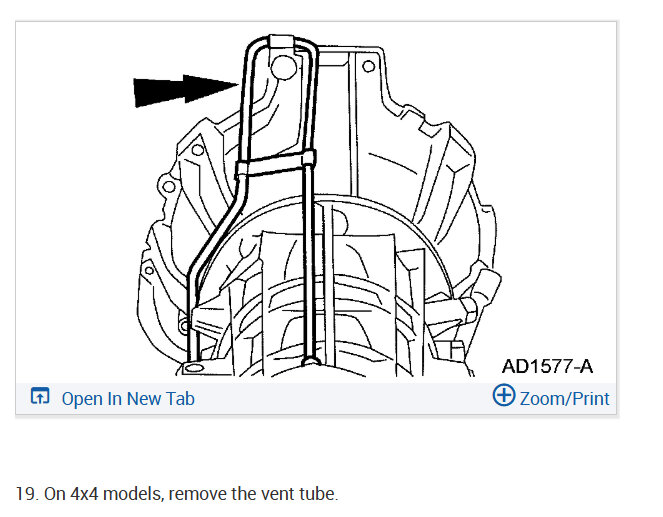

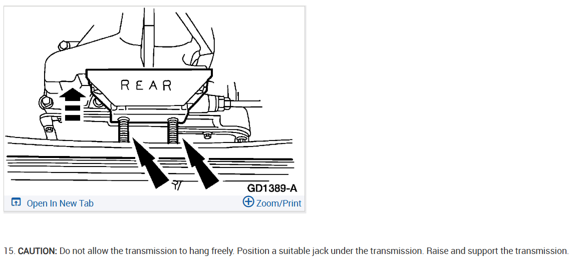

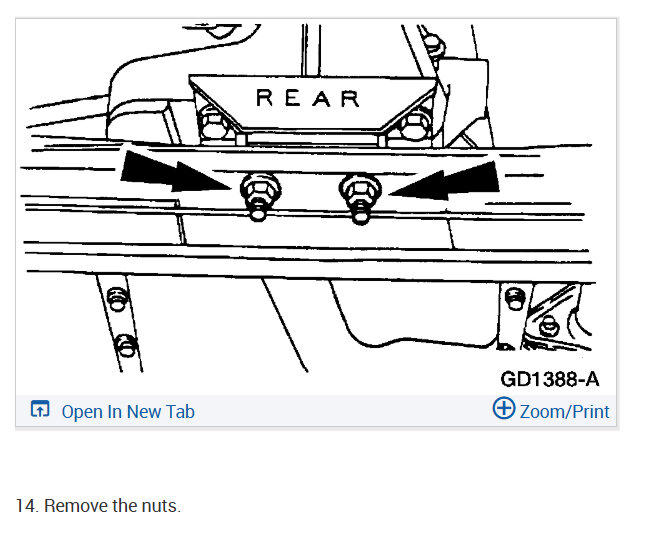

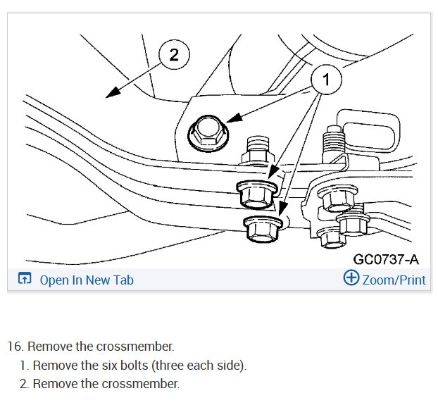

Here are the instructions for your car to help remove the transmission. Check out the images (below). Let us know if you need anything else.
