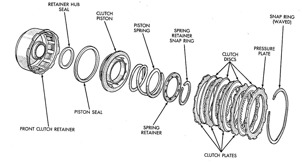

This is just one example of a clutch pack that has to be build and air tested.
NOTE: The 42RE transmission uses four plates and discs for the front clutch. The 44RE transmission uses five plates and discs for the front clutch. The front clutch retainer is not interchangeable between the 42/44RE transmissions.

DISASSEMBLY
1. Remove waved snap ring and remove pressure plate, clutch plates and clutch discs.

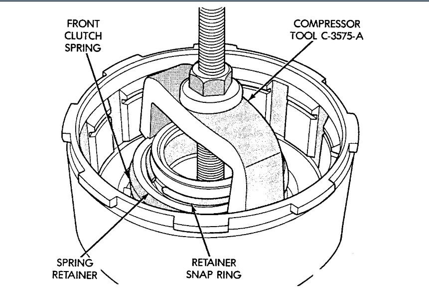

2. Compress clutch piston spring with Compressor Tool C-3575-A, or equivalent. Be sure legs of tool are seated squarely on spring retainer before compressing spring.
3. Remove retainer snap ring and remove compressor tool.
4. Remove spring retainer and clutch spring. Note position of retainer on spring for assembly reference.

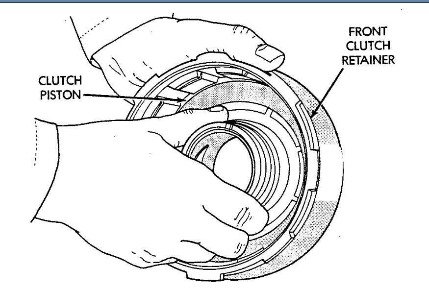

4. Install clutch piston in retainer. Use twisting motion to seat piston in bottom of retainer.
CAUTION: Never push the clutch piston straight in. This will fold the seals over causing leakage and clutch slip.

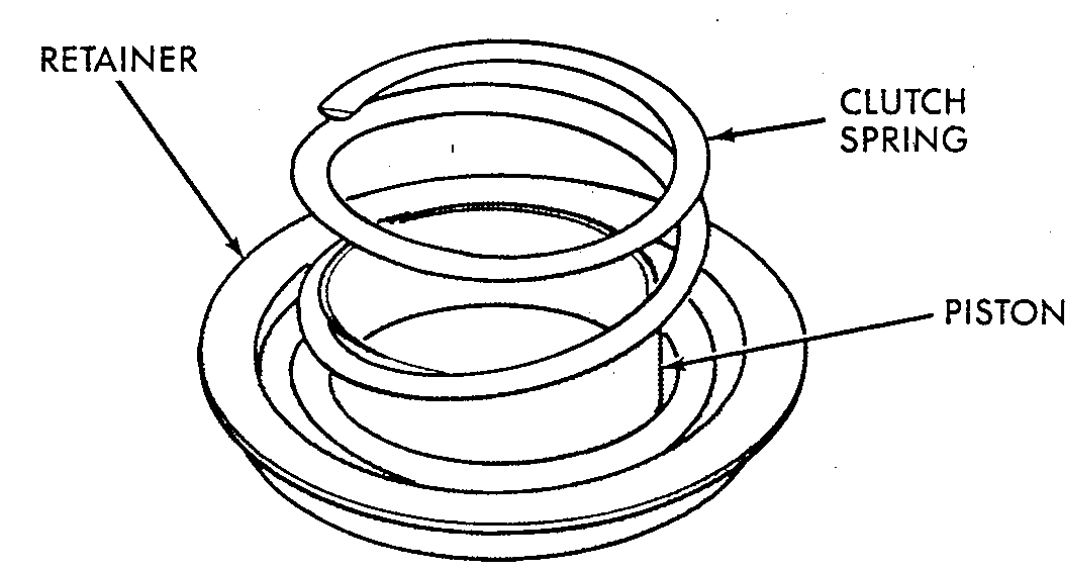

5. Position spring in clutch piston.

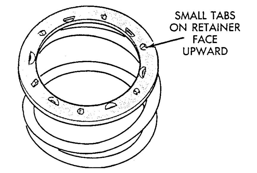

6. Position spring retainer on top of piston spring. Make sure retainer is properly installed. Small raised tabs should be facing upward. Semicircular lugs on underside of retainer are for positioning retainer in spring.
7. Compress piston spring and retainer with Compressor Tool C-3575-A, or equivalent. Then install new snap ring to secure spring retainer and spring.

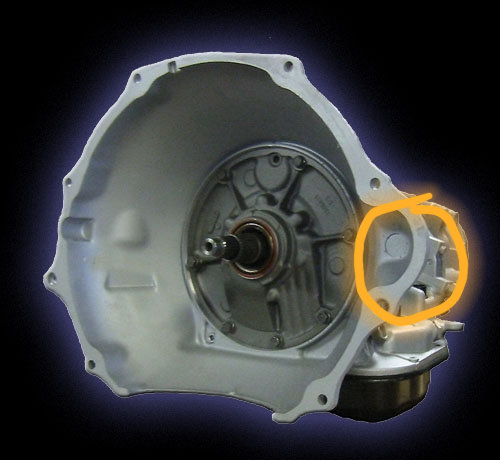

This is a transmission guy that my engine guy recommended. Lol, I don't trust anyone working on my stuff. I will call him in the morning. If he doesn't come down I'm either going to take it to the first guy or try to flush it out and put it back in. Only thing I don't understand is what broke that piece off and is that what was causing the noise I heard going down the highway? I'm sending a pic, blew it up and half of the inside of that hole is missing.

  • 52,797 POSTS
That is case damage. You cannot repair that part. You will never get back the strength back on the part.
That, I believe is the mounting for the starter.
That breaks when the starter kicks back and all the torque breaks it off.
