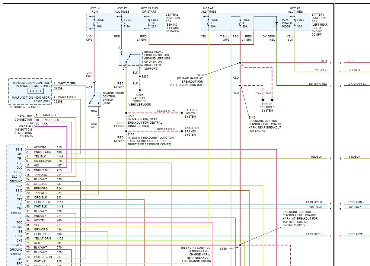

Transmission range sensor wiring diagram for sensor and the PCM pin location?
2003 FORD RANGER
195,000 MILES • 2.3L • 4 CYL • 2WD • AUTOMATIC
ROGER03

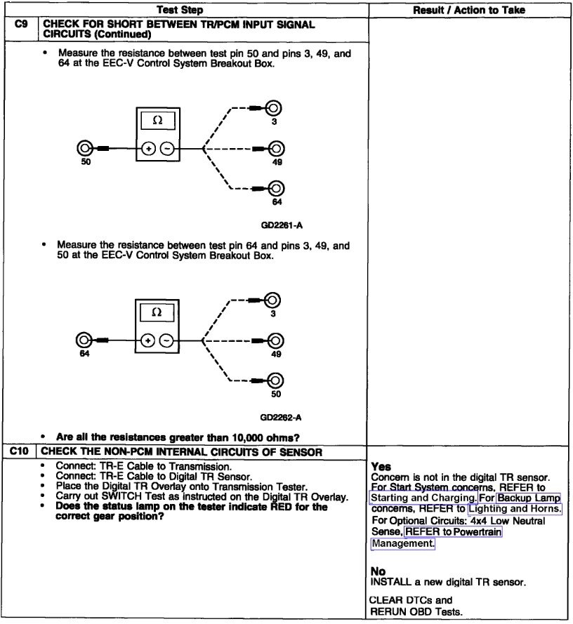

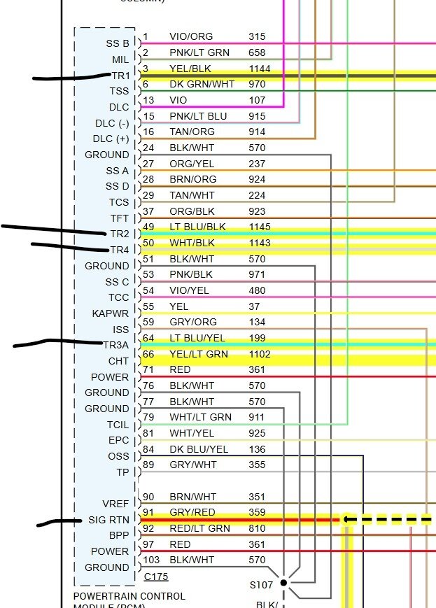

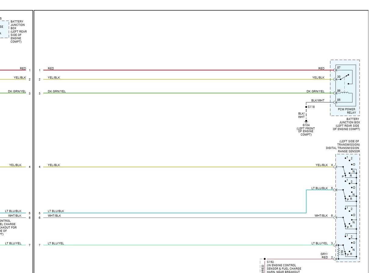

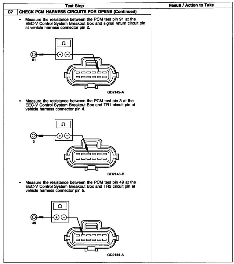

2003 Ford Ranger XLT 2.3 automatic 2x4. Keep getting po705. Replaced TRS worked great for about 2 months and the code is back. Replaced the TRS again cleared codes and the po705 comes back soon as I start the truck. If I push O/D OFF button I can manually shift it up thru the gears and when up to speed turn on O/D and it does at should. Truck starts in park, goes into reverse but barely wants to pull. Looking for a TRS plug in wire diagram and a PCM pigtail diagram so I can test both for signal, broken wire,or corroded wire, bad TCM. If I end up having to replace ECM will my PATS system still work or is it a trip to Dealership to get it all programmed? New to this forum and help would be appreciated.

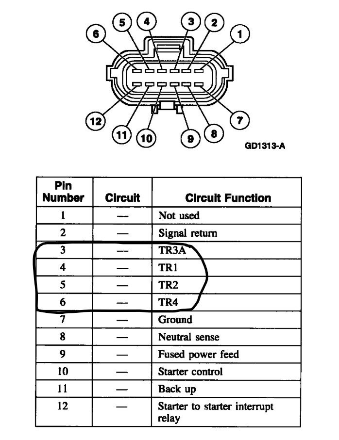

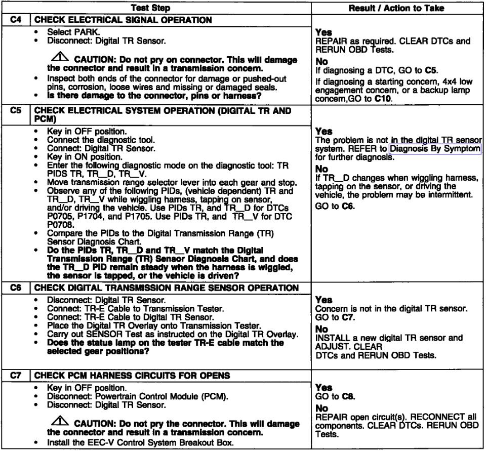

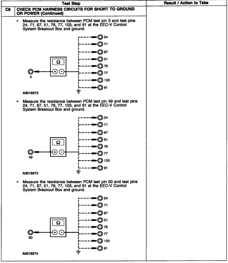

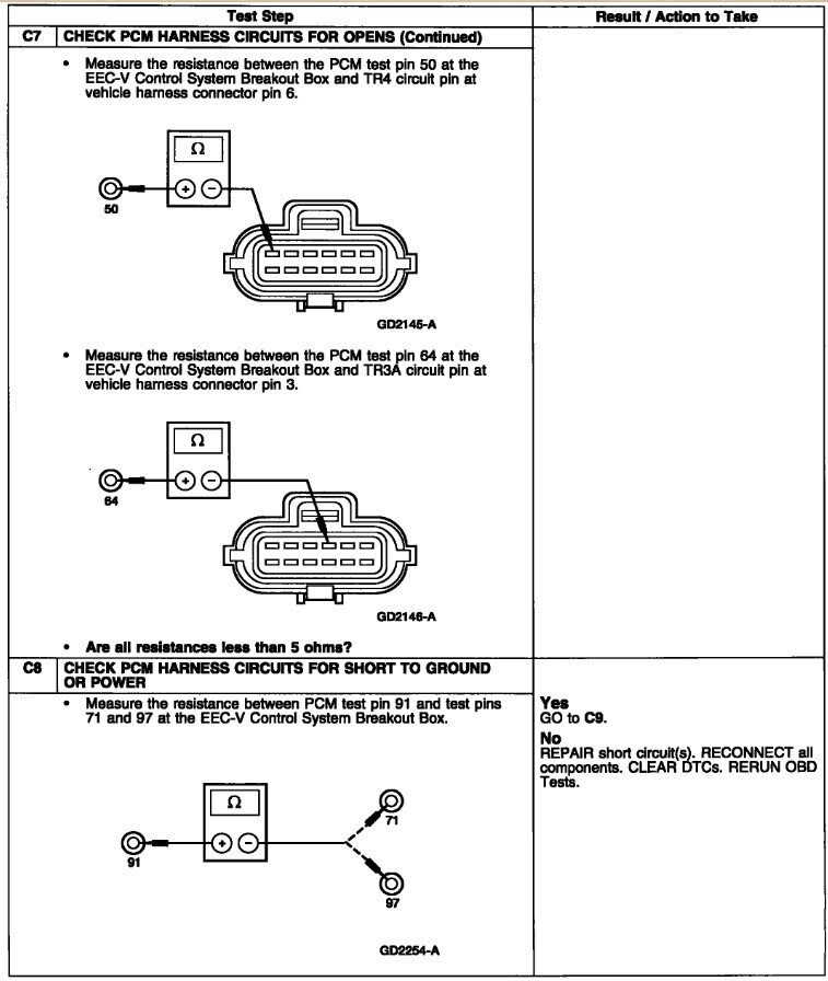

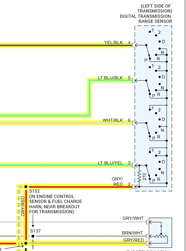

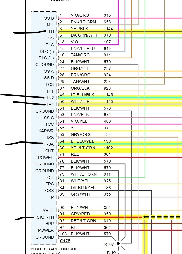

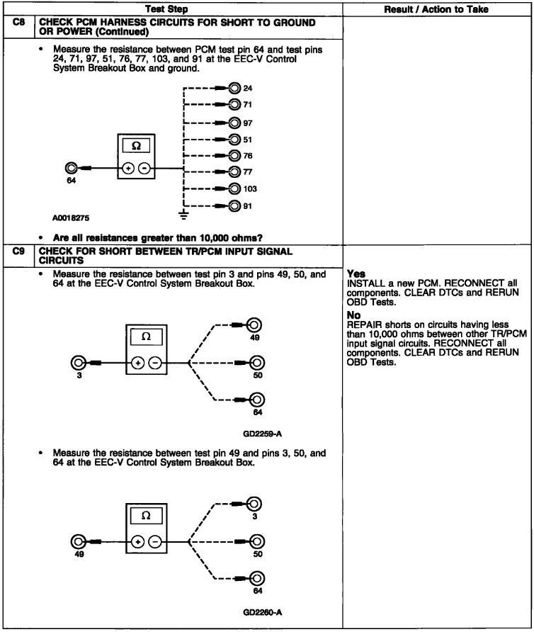

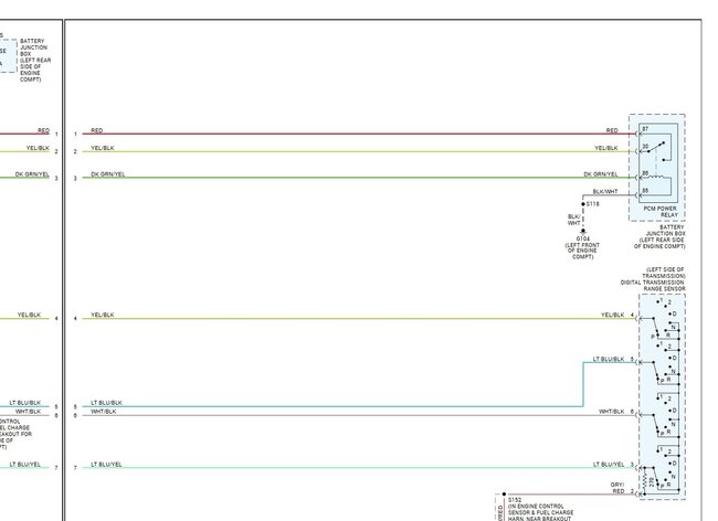

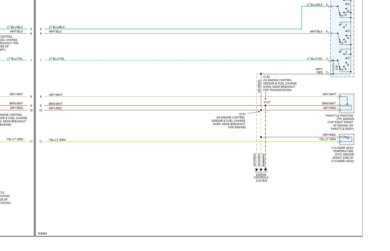

That is a circuit code, caused by a short to ground or an open in the wiring to the sensor. These are the OE tests for the wiring as well as the wiring. The likely issue is in the 4 signal wires and not the Gray/red wire as that is a signal return (ground) for other sensors that are not showing errors. So the wires in 3,4,5 and 6 I would check the connector for corrosion or damage first. Then test the wires.

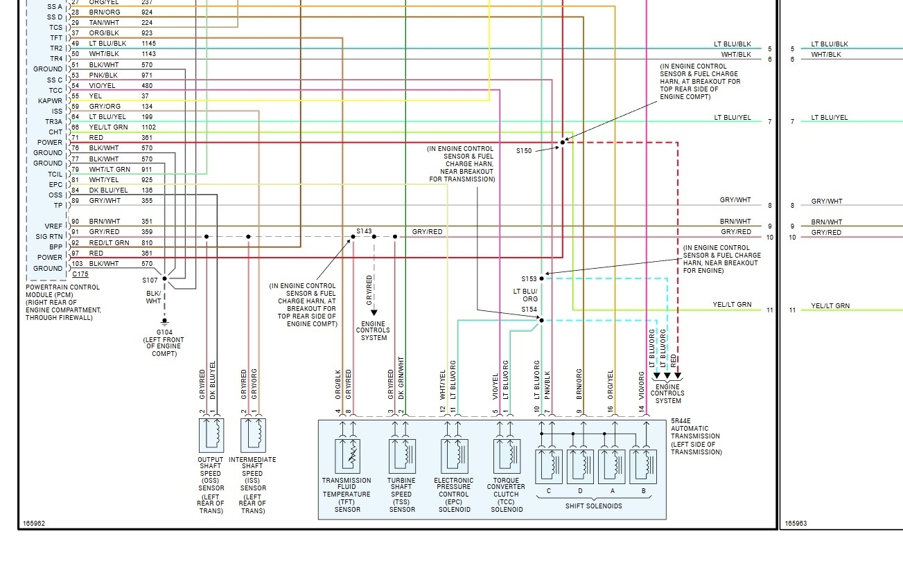

Checked the TRS connection and it was a bit loose, i got a pigtail & replaced. Still getting the po705. The diagram of the pigtail you sent me has me lost. The diagram of 12 pin connector only shows 1 pin that's not used. My truck's connector has 3 empty slots. So I was wondering if there's a difference between 4wd TRS & 2wd TRS. Any help will be greatly appreciated.
Jan 21, 2026 at 6:55 AM
STEVE W.
  • 15,348 POSTS
Range sensor is the same part# for both as is the wiring. Which ones are you missing?
