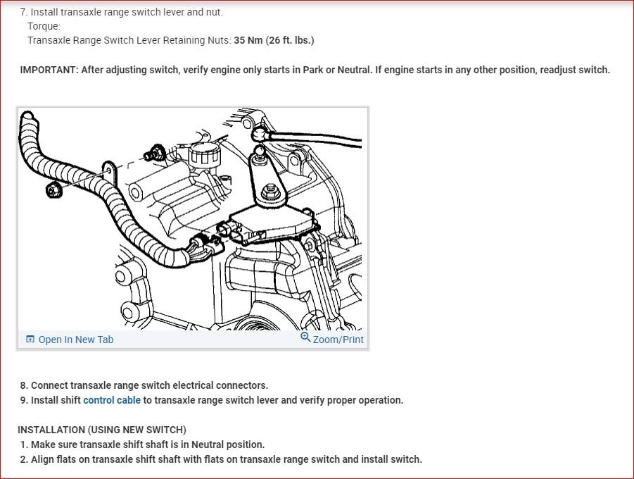

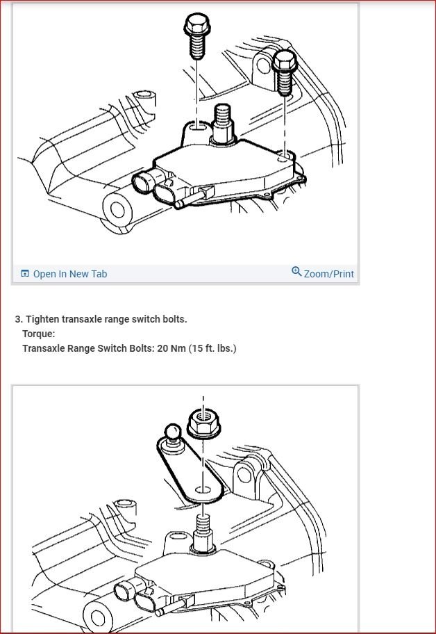

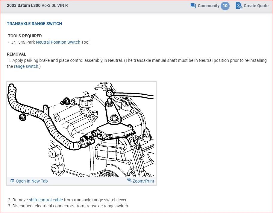

I am trying to locate my transmission range sensor so i can replace it.
Jun 8, 2019 at 10:09 PM
  • CAR REPAIR CONTRIBUTOR

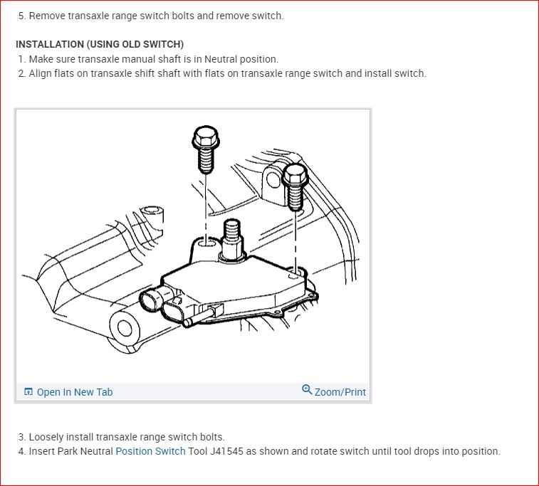

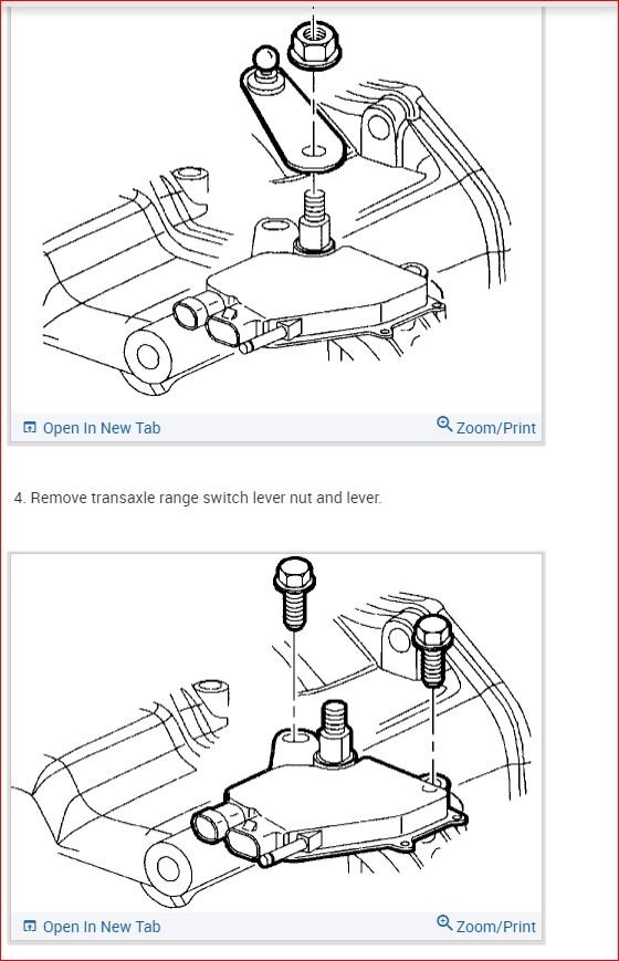

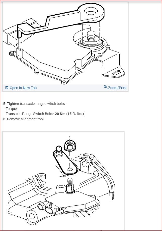

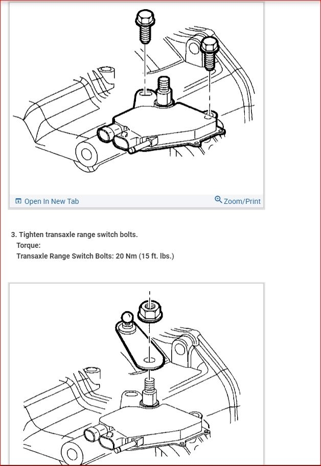

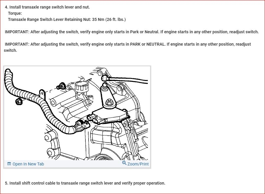

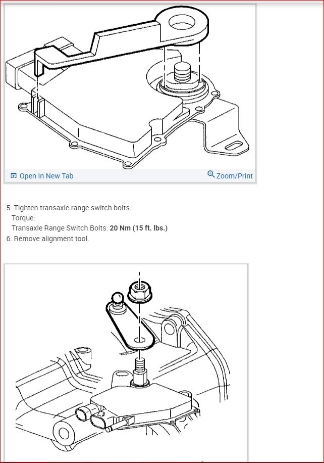

I attached the procedure. It is on top of the trans-axle under the shift lever.
Just make sure you get the alignment tool needed to install it so that you make sure you have aligned properly. If you don't then I you may have engagement issues or even shifting issues.
Let me know if you have questions. thanks
