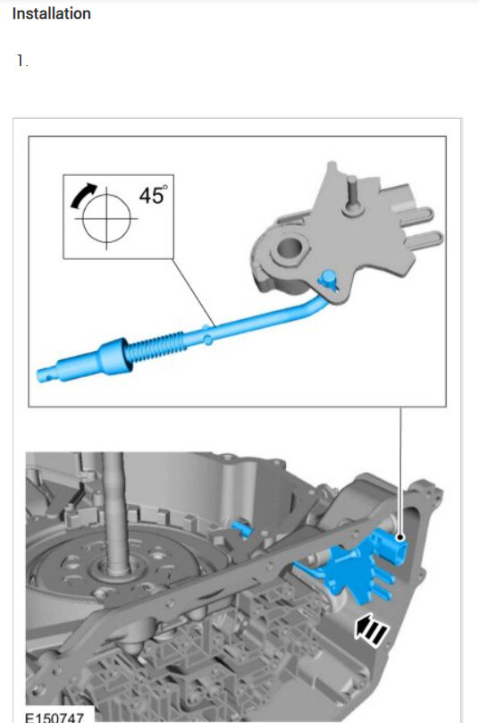

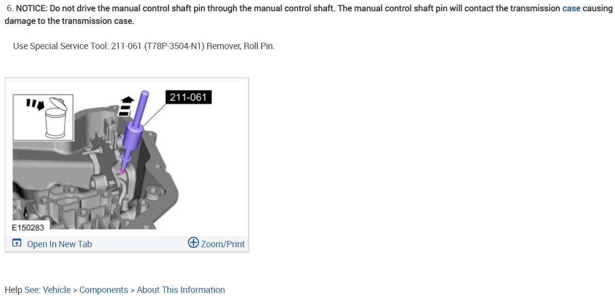

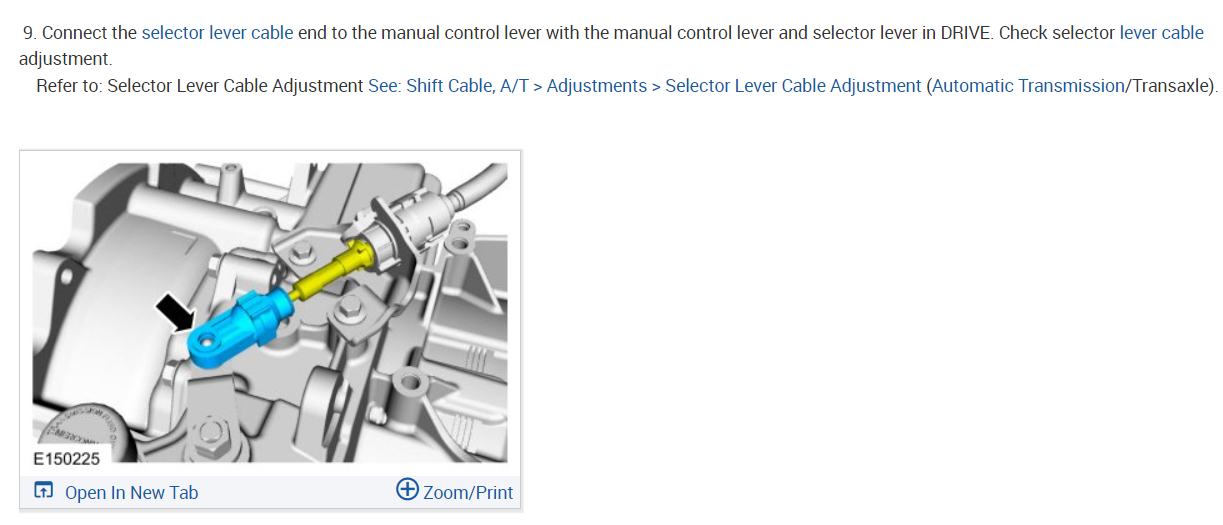

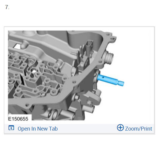

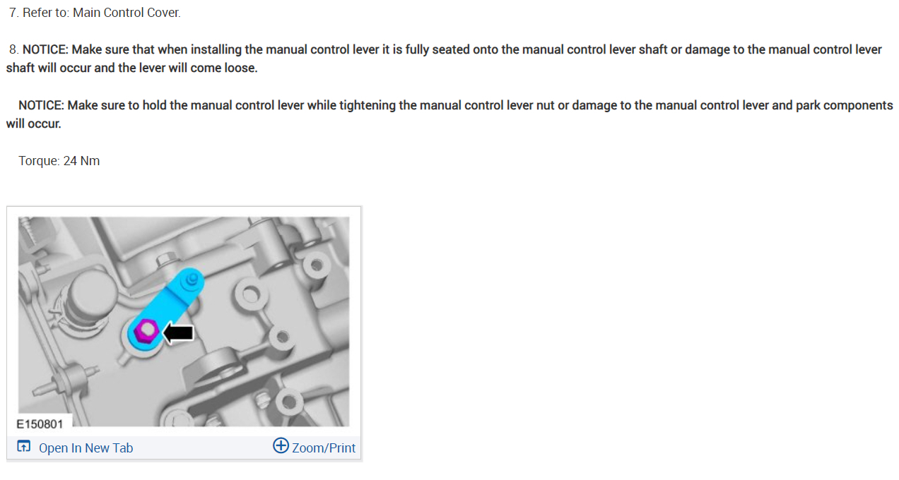

Hi there, I took the TRS out with parking pawl and I put it back after that I connect the wires to check if there are no issues. The check engine comes on and there are two codes showing p0707 and p0706 and the car does not crank or start at all. I did all of that before I put in the fluid.
Feb 7, 2024 at 9:04 AM
  • 55,447 POSTS

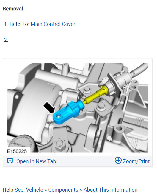

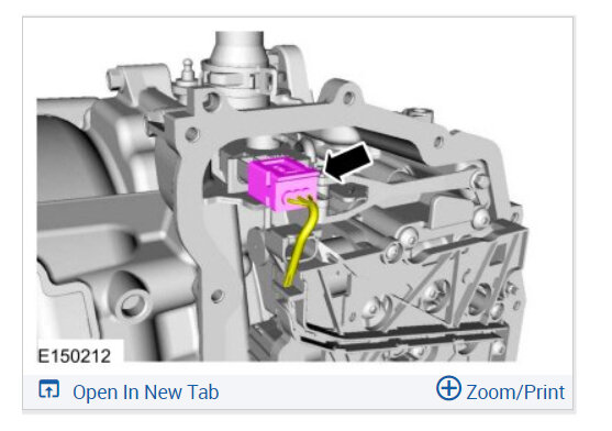

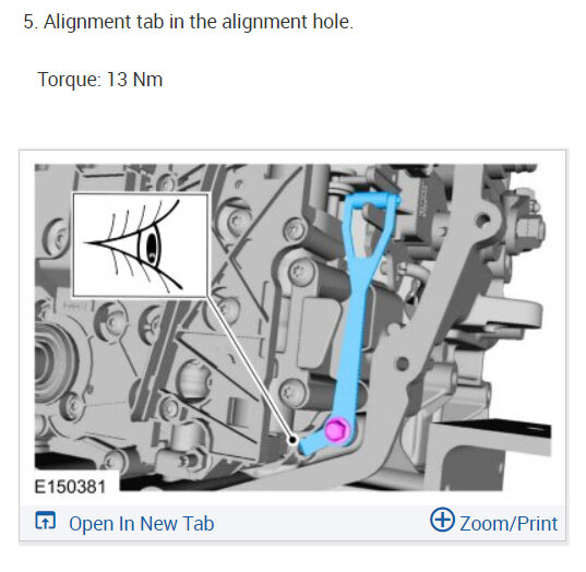

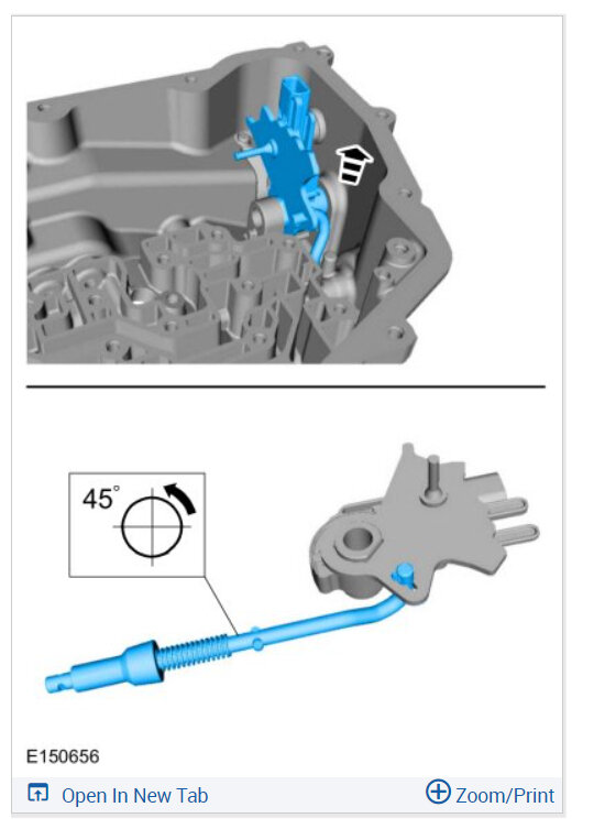

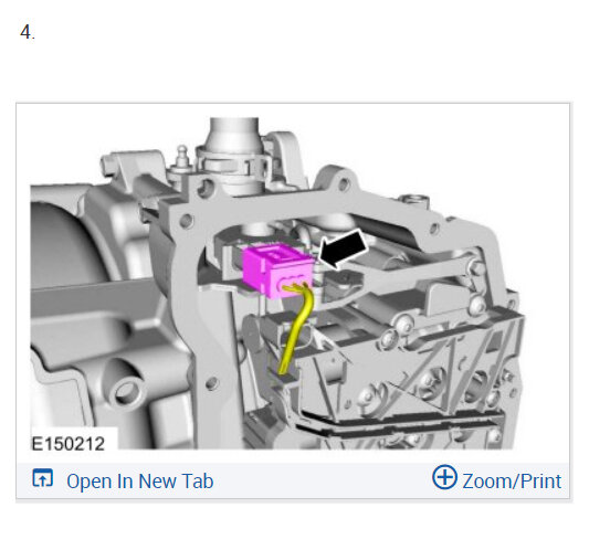

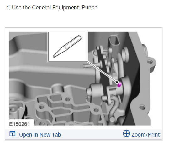

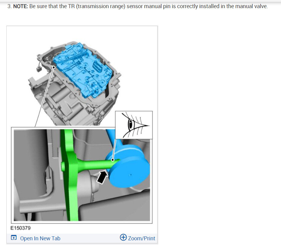

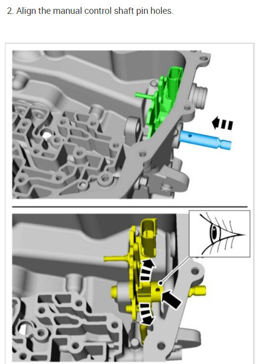

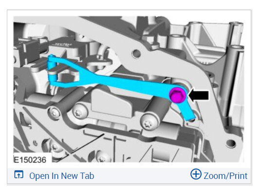

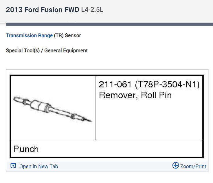

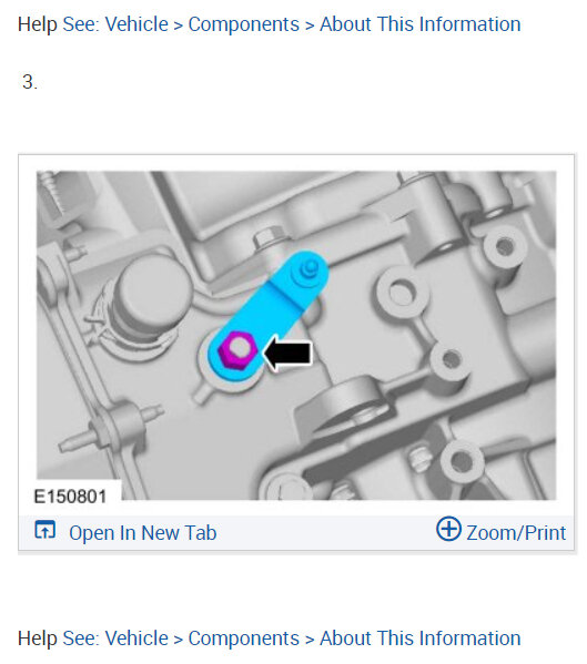

Yep, it sounds like the transmission range sensor is bad or not installed correctly.
P0707 - Transmission Range Sensor "A" Circuit Low
P0706 - Transmission Range Sensor "A" Circuit Range/Performance
Here is how to replace the sensor correctly. Check out the images (below). Please upload pictures or videos in your response to the problem so we can see what's going on.
